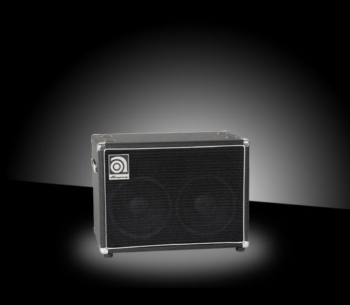

Build a box something like the picture and build it as large as you are happy to carry around (it will be very heavy), just make it strong and use composite wood (particleboard or MDF 18mm+ thick). Once you have built the box you can either leave it sealed (safer and smoother bottom end response) or you can port it to give more efficiency (louder) at the bottom end.
If you can find the T/S parameters it could help you to build the right box, but don't worry too much because the box can still be "tuned".
I have built things before on a budget and you will be surprised at what can be achieved and how good it will sound.
Cheers

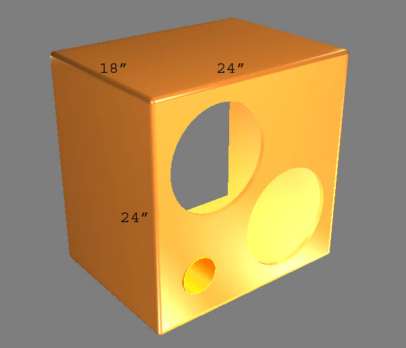

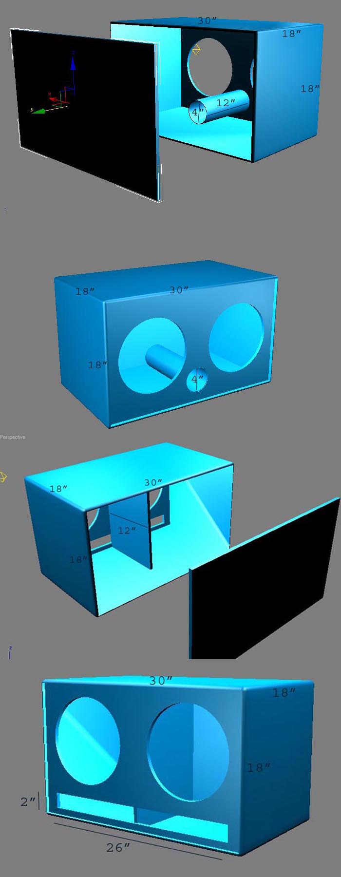

i desgined too diffrent cabinet ...both are 18"*30"*18" ...
first one w one (or two) 4" hole & a 12"pipe !!! lol .. i just draw it cuz i saw this hole in most cabinets 😛 .. i have no idea bout this hole & pipe dimensions .. or what does it doin 😛 ...
the second draw , is a same cabinet but i divisioned the inner space by a 12" wall .. & put a 26"*2" hole at the bottom of the cabinet ... ( just like some cabinets i saw ) lol .. as i told i have no idea bout this hole too .. !!!!!!! lol
i just put these there as i saw in some cobinets ... any idea ?
is this box enough ? or i need a bigger one ? ...
and is this hole is nessecary ? or better if i make front panel seald ?
or if this holes are good which design is better ? . the cabinet w one(or two) hole in it or the cabinet as my second design ? ..
and plzz with which dimensions is good for them ? 😛
thank u so much ...

First, you should try a box with no hole. If you think the low frequencies are not loud enough, then you can make a hole. In that hole, you put a pipe. Longer is the pipe, lower the box will be tuned.
Remember to seal well your box, no air should come out of anywhere except air moved by the speakers. If you put a pipe in it, seal it tightly in the hole, the air should be only coming from inside the pipe.
If you go with the pipe, try a 3 inch diameter pipe first. If the pipe is making too much air noise, get a 4 inch diameter pipe. Remember that if you go with a larger diameter, you need to make it longer to tune at the same frequency.

i wanna order this box to a carpenter , i dont want to build it my self ... so it s maybe better if i order it w a 4"hole and ( or may be two holes ,, what do u think ? 🙁 ) and for the first try seal the hole ( or holes ! ) lol ,, and then if i see the freq is not good open the holes ,,, do u think it s may be better ? ...
and what do u think ? one hole is enough or i should design the box w 2 holes ?
i draw another cabinet ,,, plzz take a look at it ...
it s so much bigger ... thnx a lot
Yes you could order it with a 4" hole and seal it, then test the box, then put a pipe into it and test it again.
I suggest only one hole since these Sony subwoofer drivers are not moving that much air. Two holes need pipes alot longer to tune it at the same frequency.
The bigger your cab can be, the best it will be with a bass guitar. But it's harder to move hehe!
You could start with a 14 inches long port, then cut it inches by inches to see where you like the sound.
14 inches would tune this box around 20-25 Hz, then you can choose the tuning between 20-25 Hz up to 45-50 Hz with no pipe, only a hole. To tune around 30-35 Hz, you need a 6 inch long pipe, and so on.

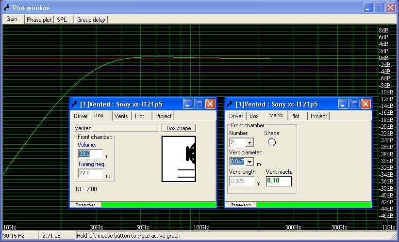

These are exactly what we are looking for. The T/S parameters.
These are the T/S parameters of your 12 " sony xs-l121p5 car subwoofer ???
If yes, then we will be able to help you design a good vented box with a pipe.
Edit: Just checked, you found out the parameters, I'll check how it's looking in WinISD...
It's looking quite good, I tried a 4 cu.ft internal net volume with a 12" long 4" diameter pipe.
The maximum power you can put into your box for both woofers is 325W RMS, so you'll need a 325W RMS into 8 ohms or a 325W RMS into 2 ohms amplifier.
112 dB on the Low B string and 113 dB on the low E string, very flat frequency response curve. Maximum SPL is 114 dB at higher frequencies.

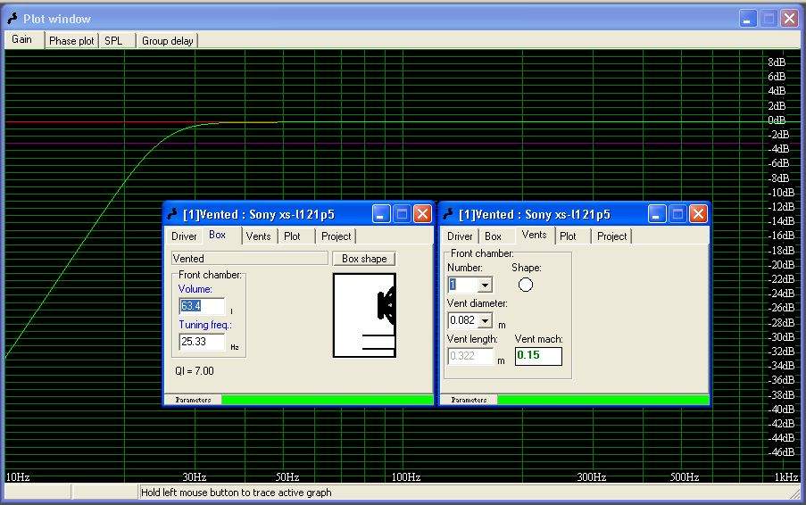

Dont worry Ahmad_tbp;
It seems that Simon5 has been helping you quite well. I am sorry I went quiet for a while but I was working on other stuff.
As Simon suggested your port is too short and I also think your box is too small even for only one woofer. Simon's idea of stuffing the box is a good one. This will help to stop echoes inside the box and also make the woofer think it's in a bigger box.
I ran the information you provided through WinISD as Simon did and came up with this.
A box of 63.4 litres (sorry I cant get my head around cubic feet) and a -3db point of around 25Hz. Pretty good.
If you plan to use two woofers then you will need to double the size of the box.
Cheers :drink:
