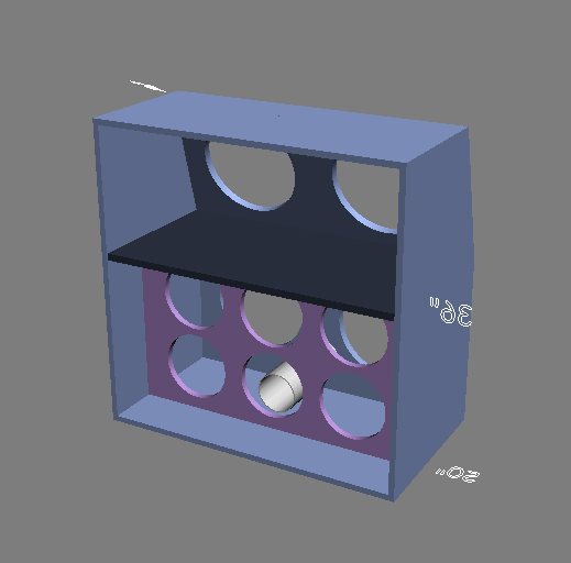

The idea of two vertical with two horizontal was to get a nice look.
I think you could still keep your 42" height.
You can also use two horizontal, no problems with that.
You should use your Sony subwoofers for the low bass. I think they are better for a 5-string bass guitar. As you said, you heard nothing between 20-40 Hz versus the Sony subwoofers.
If you go horizontal, it's a good idea too, because you could put your cabinet of the side for stage use, and on the bottom when you're playing for yourself.
Here's a picture I did for you.

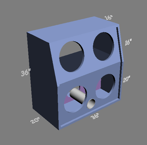

hi simon 🙂
thank u so much for designs 🙂 ur design gimme some ideas ! lol ... lemme try wat can i do w it !!! .. lol 🙂 ... thank u so much man 😉 ...
here is one of my old design i redraw it .. i gave it a 15 angel as one of ur designs ...
how is it ???
the port is 4"x12" ...
how is it ???
It's quite nice, but you said you don't want an angle hehe!
I think it's a bit too small for your Sony subwoofers. That's why I was leaving that much space only for the subwoofers. Like 2/3 for subwoofers and 1/3 for RCF speakers.
I would add some bracing in the lower part, to hold the front and the back with the middle brace, like this:

hi simon 😀 ...
no i didn t say i don want an angel
hehe ..
that cabinet was too tall and that s why i said i don want an angel 😛 lol ... and if this one become too taller i ll remove its angel 😉
lol .. so i ll make it bigger .. just one thing else .. i should seprate the woofer and subs section or i can put them together ???

hi simon again 😉 ...
in my previous cab design ( two subs & one full range ) the sub section volume was bout 12000 ( 27"*24"*18") ... in your last design if i built the cab w 18" length the whole cab volume will be 22680 ( 42"*30"*18" ) and if we divide it 1/3 for two woofers and 2/3 for subs , sub section volume will be bout 15120 and in my design the sub section volume is bout 14400 so its not too smaller than ur design ... lol . is n t it ??? and if i still should make it bigger what if i add 2 inches to height of subs section ? , it will be alright , is nt it ?? .. cuz the volume will be 15840 (36"*22"*20")
so what do u think ??? 🙂
You should separate the woofer section and the subwoofer section, because the woofer section will be stuffed and the subwoofer section will not be stuffed.
I'll recalculate the volume to see, maybe I made a mistake yes!
EDIT : Just rechecked the volume and you are right, your last design is perfect. Just add a bit of bracing like I showed you hehe! Sorry for the mistake.
