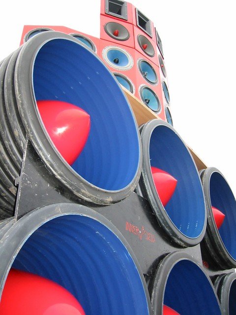

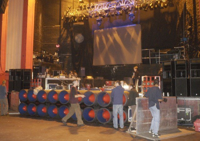

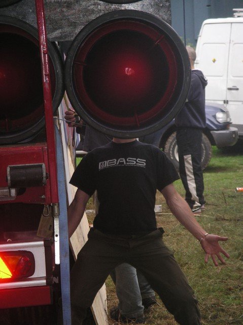

I actually considered using a sewer pipe at one point. A few friends of mine, work in construction, and sometimes have a piece left after a job. They are seriously strong and solid. So a glued in thick wooden panel in each end, and you would have a bit of unique look, with that color and ribbed shape 😀
There was a soundsystem in the early 2000's in the UK called Innerfield - their website is still up to this day Innerfield.co.uk
Here's some photos of the subs - I don't know much about them but they definitely have a presence to them!

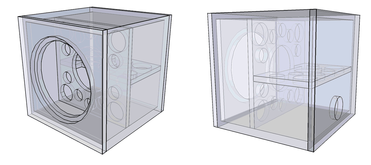

Key to this design is the woofer magnet braced against 3 panels +nthe brace.

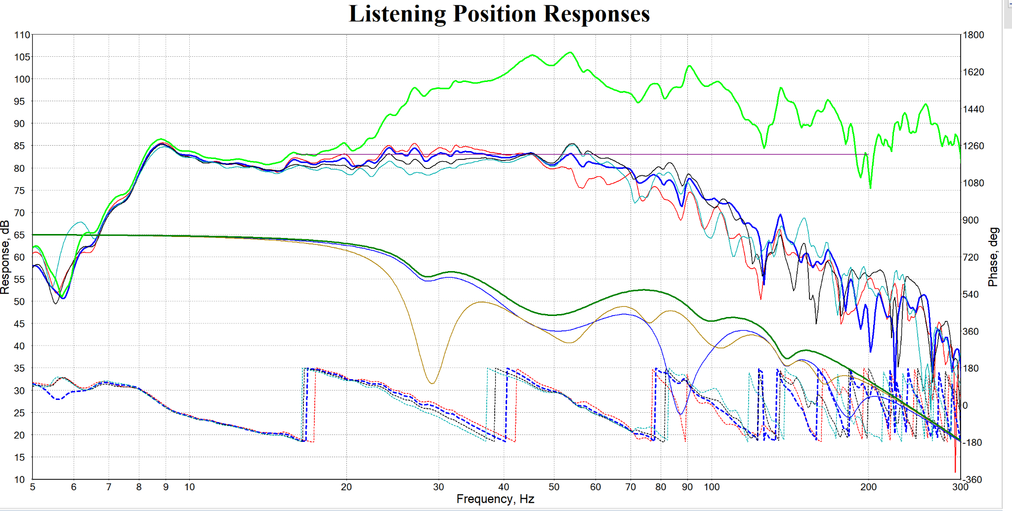

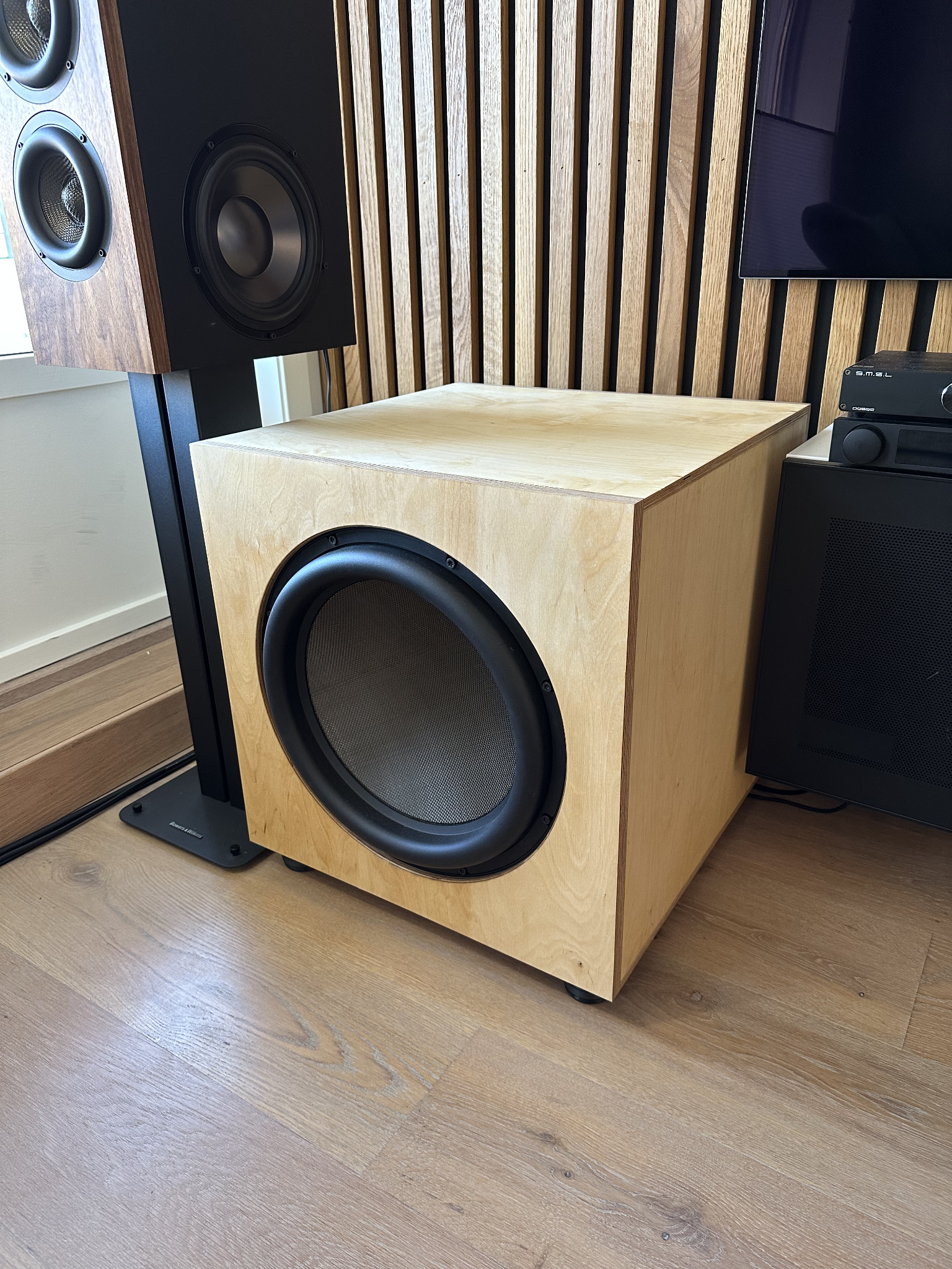

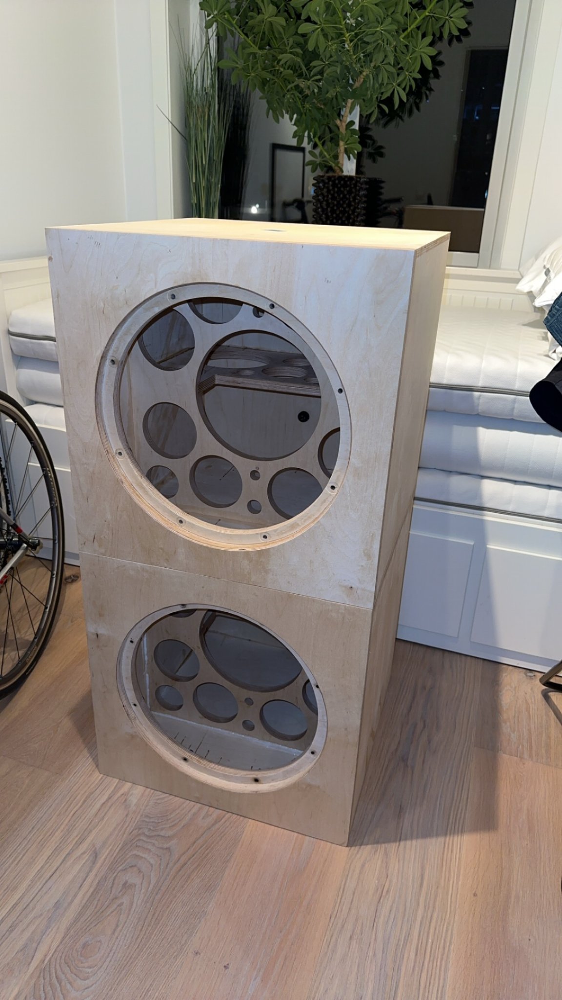

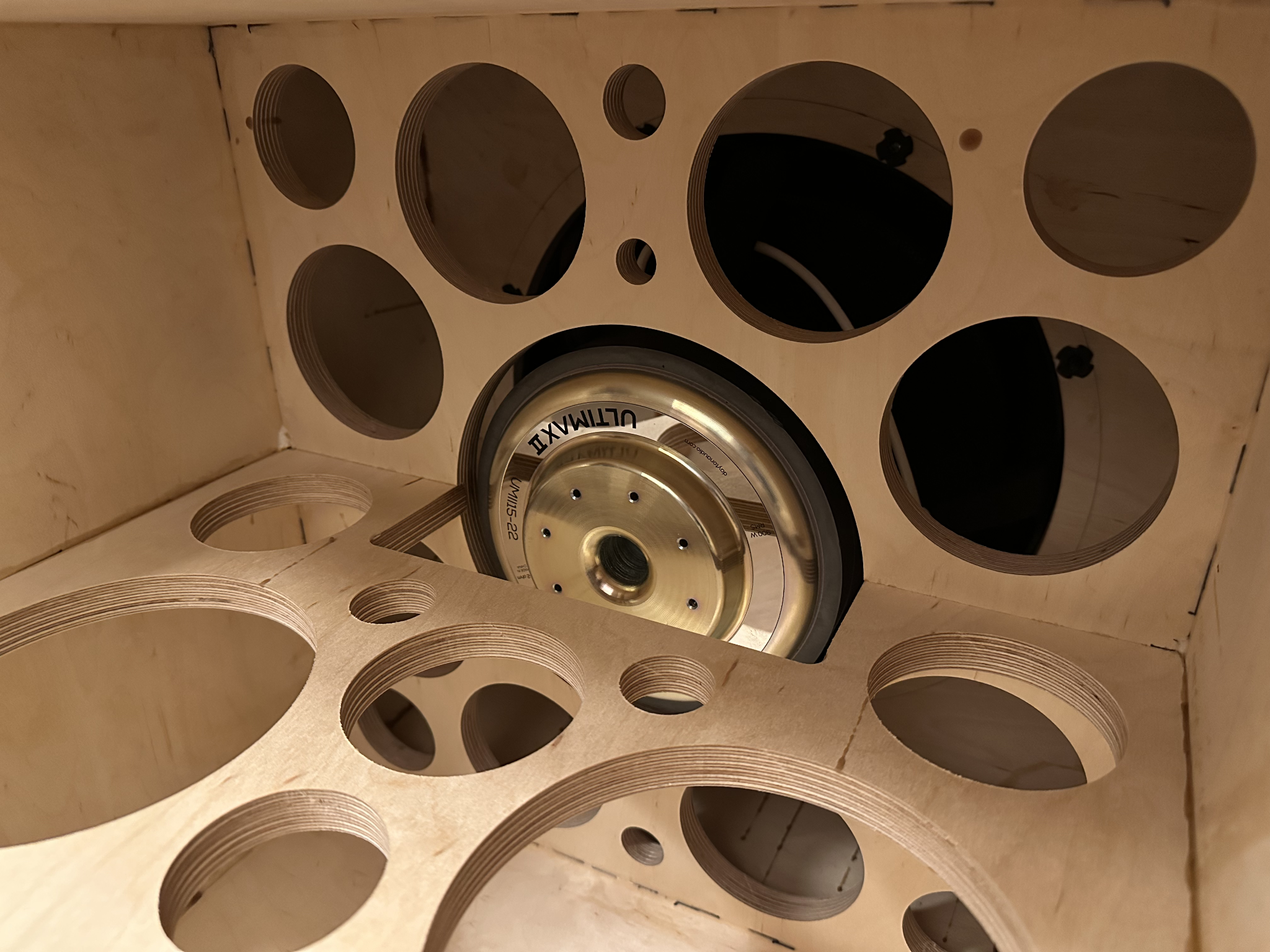

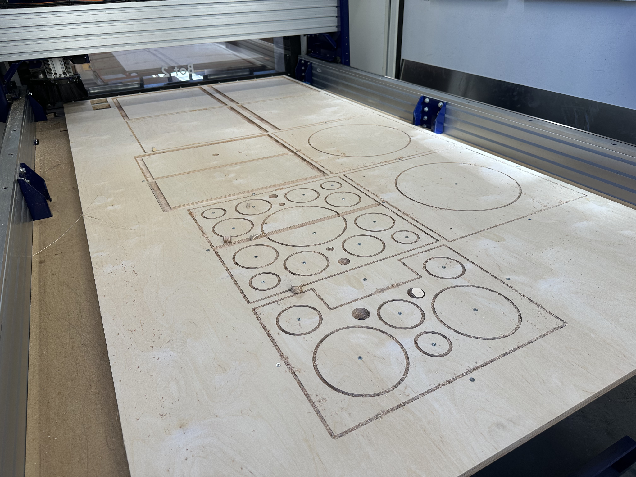

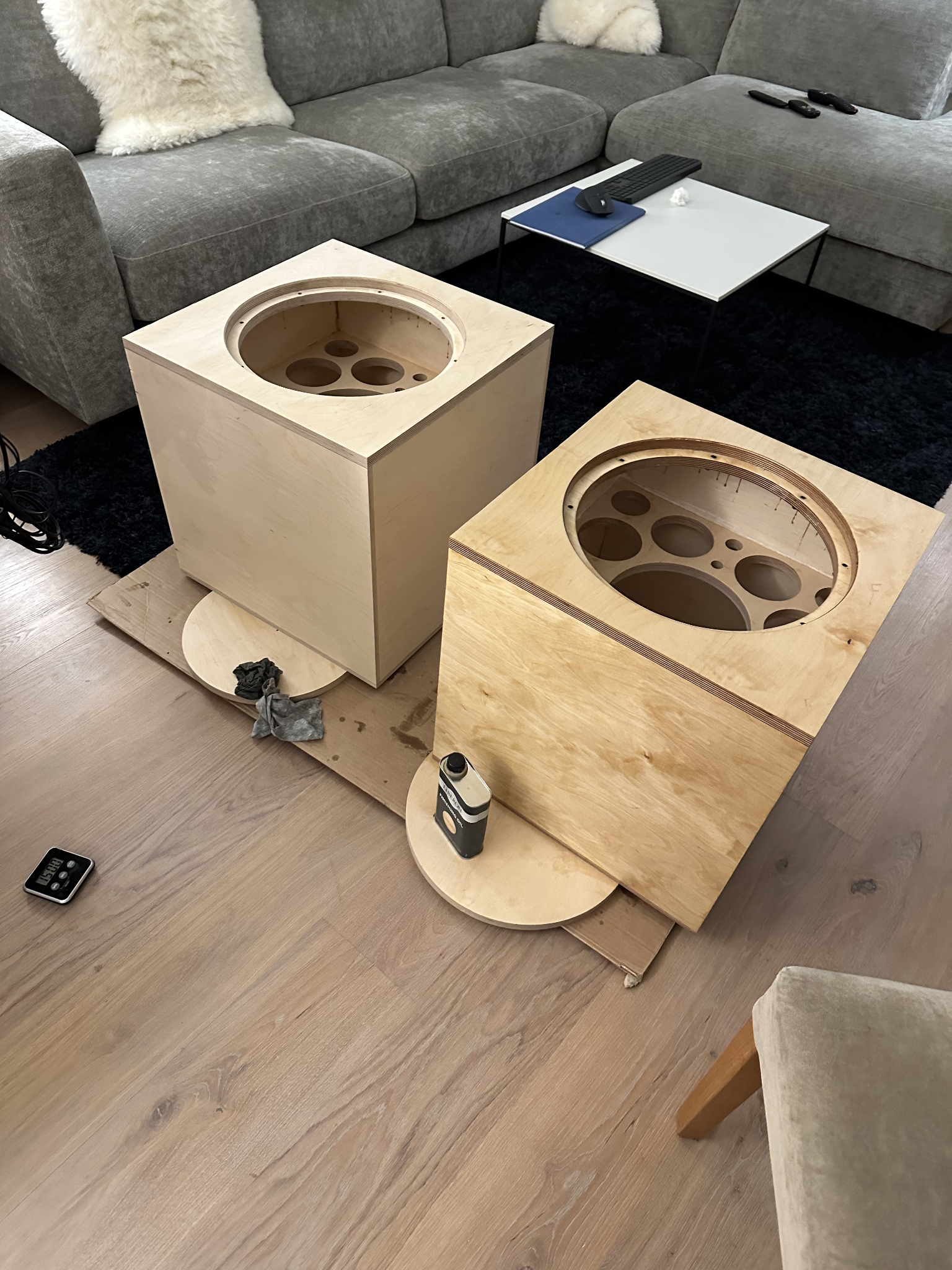

Hi @planet10, thanks for the inspiration, I went and built it.
18 mm baltic birch plywood, external dimensions: 0.5 m³, internal volume: approx. 90 L (just over 3 cubic feet)
Driver: Dayton Ultimax UMII15-22
T30 screws, M6 x 35mmwith tee nuts
Half-stuffed with polyfill (behind the vertical brace)
Diagonally placed, front left and rear right.
The natural response is approx. -18 dBFS before the amplifier starts objecting, Hypex NC502MP, neon curve (MSO pic.) LR24 @ 80 Hz
There is very little back panel resonance. If both subs are placed front to front, one being inverted, volume can be raised quite high before hearing anything. Used this trick to soften the suspension without too much sound escaping. But the moment one sub is toed slightly the room starts shaking. Accidentally switching to same phase in this config is a powerful reminder.
