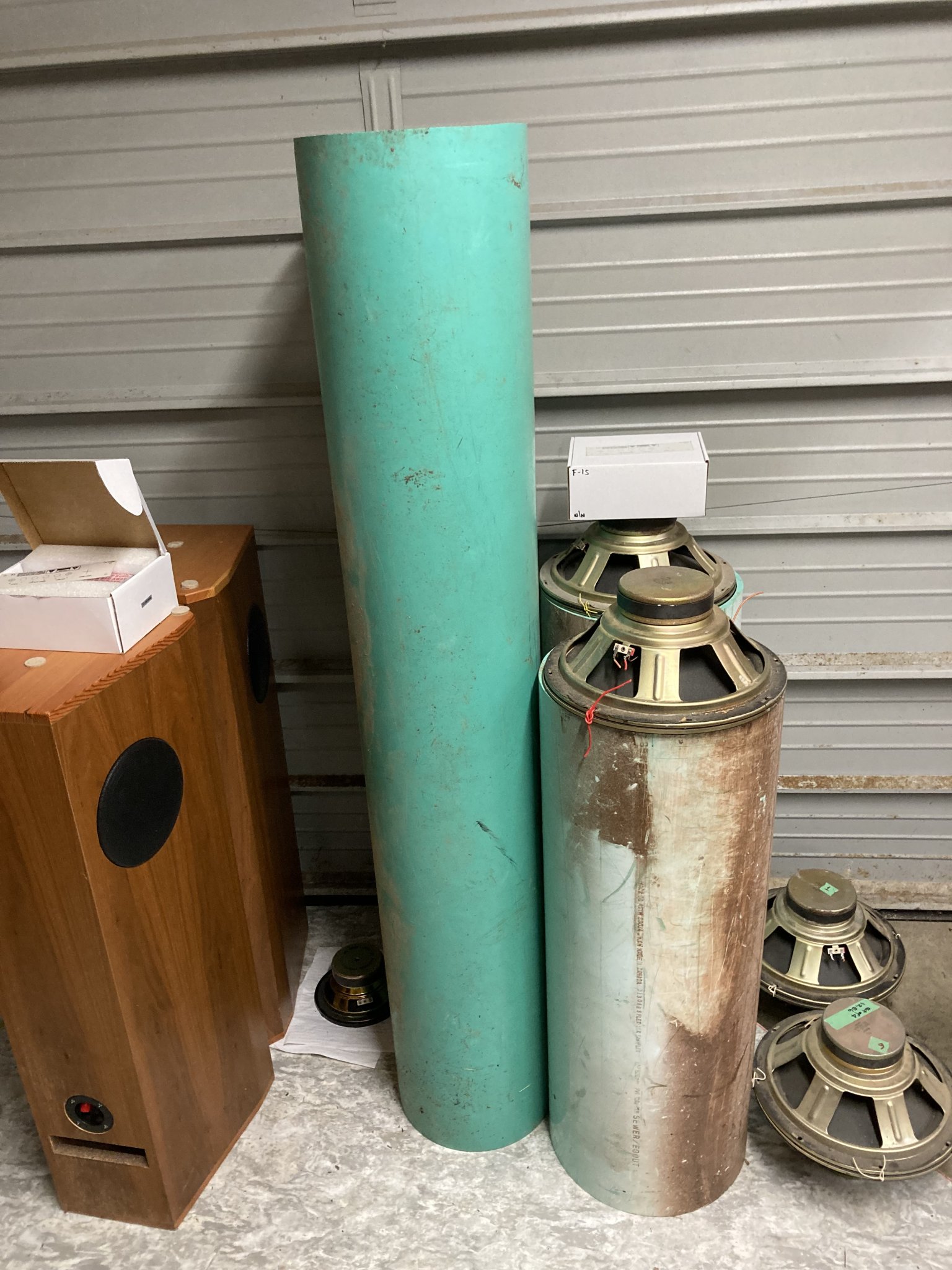

For a box that size seems reasonable if the quality is good (plywood et al), and if finished nicely, cheap.
An inexpensive approach would be to use a cardboard concrete form or a PVC drain pipe.
The short ones are intetended to be push-push push-pull (Foster 12”) woofers. Isobarik because the woofers are old, want a big box, i have lots of them (17 IIRC) and the piece of pipe was only so large. Each pipe uses 4 woofers.
The tall ones are (intended to be) ML-TLs with Eastech 7” woofer.
dave

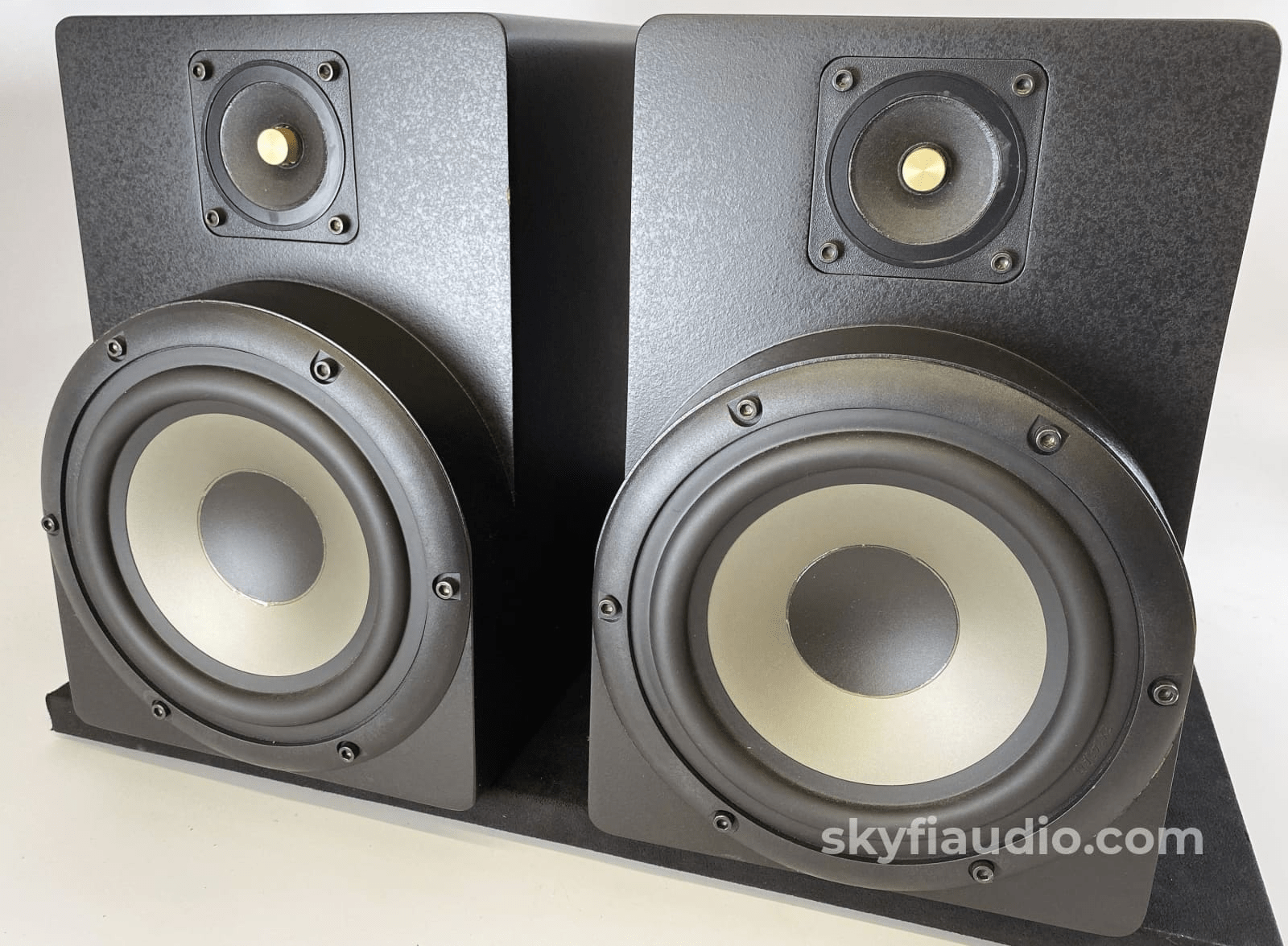

Hi yes They are the Sequerra Metronome I also love the Infinity of courseThey look like the infinity modulus
I decidely prefer front firing drivers Very very much And reflecting surface will emitt a sound out of phase with the direct one
I know it is trivial I would experiment with some cones covered with absorbing layers and placed on the tweeter
I prefer absorbtion than reflections

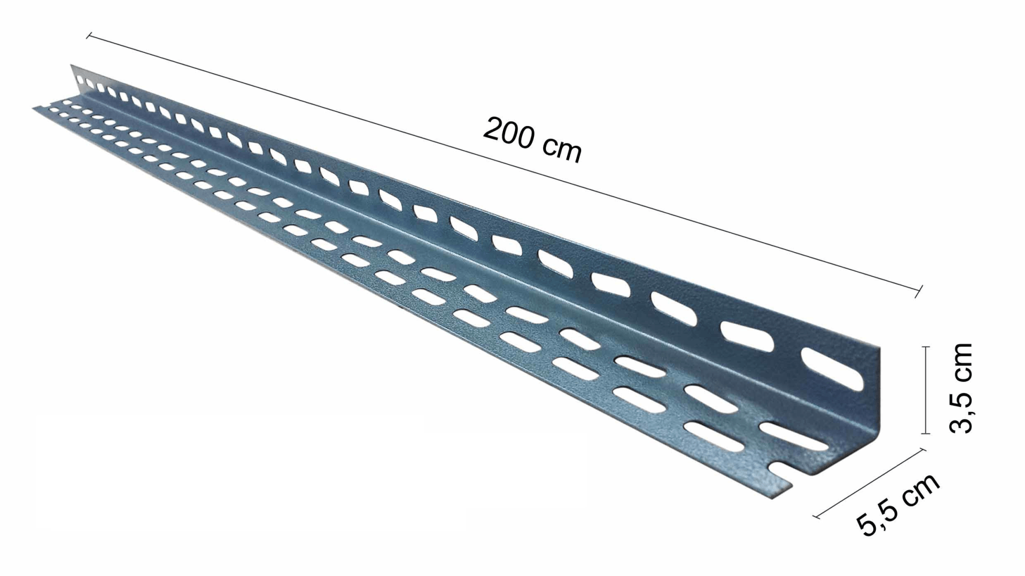

So a bolted frame made with element like this could work
It could. Getitng it sealed could be an issue.
dave
Also metal can vibrate in sympathy quite well
Metal should resonate at HF, and they will not be excited by the limited bandwidth of the subwoofer.
Sothere is no sympathy.
Note: i would use glue as well as bolts (unneeded if you have another way to hold things together while the glue dries).
