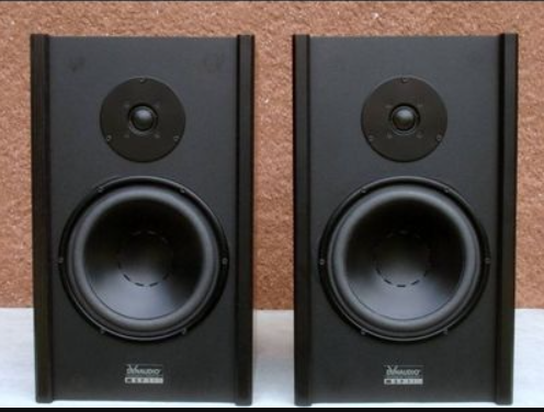

Hi my main goal would be to see any displacement of the front baffle
I guess that in the best case it should not move back and forth when the woofer is excited with strong signals
How any front baffle movement can affect the sound is a mystery to me
Maybe this is more impacting the sound when some domes are mounted on the same baffle
If I had a 2 ways speaker I would mount the tweeter in a separate enclosure mechanically decoupled by the woofer cabinet

The movement of the baffle (and any other moving part of the enclosure) can vary in from in phase to out of phase with the woofer's movement.How any front baffle movement can affect the sound is a mystery to me
In phase, it's contribution could slightly increase SPL, out of phase, slightly decrease.
If you were to compare the movement (displacement) of both you will notice that the baffle moves only a tiny amount by comparison, perhaps 0.1mm when the driver moves 10mm.
With a 100/1 ratio like that, it would take precise measurements to detect any difference in frequency response, which would at most be under 1/4dB, a fraction of the deviation in response of the best drivers available.
If the cabinet is well constructed, the sonic contribution of vibration is negligible.
Hi thank you very much for the very valuable advice
But only 0.1 mm is nothing indeed I was thinking much more
Does the same apply also to dome drivers that fwiu they move very little ?
I with a friend did an experiment with this speaker actually on the pair
we played some pipe organ tracks with powerful low Hz notes
Then we added lead sheets internally to the sides The resulting weight was about 20kg/each
we played again the same tracks The sound was so much better
much more out of the box more powerful defined better 3d effect
better in all aspects
Now the question
Is it possible that the vibrations of the unweighted cabinet have dirtied the tweeter's output, introducing distortions?
because if that were the case, even just removing the tweeter from the box and isolating it from the bass could give a similar improvement
without the need to use toxic lead

A floppy cabinet construction can impact it's sound, but those impacts are minimal for reasonably stiff enclosures.Any front baffle displacement caused by the woofer movement will not impact the woofer response
And this means for instance that design and build a subwoofer cabinet will not be that challenging
Have I got it right?
I doubt the cabinet vibrations in a reasonably stiff enclosure would cause audible smearing or distortion in the dome tweeter. It is possible large movements (which wouldn't occur on the cabinet in #227 with or without lead lining) could cause Doppler distortion, but the Doppler distortion always present in the woofer when low frequencies modulate high frequencies would be orders of magnitude greater than in the tweeter, and lead lining would have no effect on those.The situation could be different for dome drivers where the dome excursion is minimal and even small front baffle vibrations could smear the dome response and cause distortion
Right?
Your experiment with 20KG of lead lining would have reduced the cabinet's enclosed volume by almost 2 liters, which would raise it's resonant frequency, changing it's response, and reduce the woofer's excursion at a given drive level. Lead in close proximity to the crossover coils would change their inductance, also affecting frequency response.
Depending on the nature of that distortion, it might be objectionable.Imagine if an amplifier had 1% distortion.
Subwoofers driven to Xmax, the so-called linear range of excursion have 10% harmonic distortion.
Most don't notice that level of HD unless under controlled A/B conditions with sources lacking harmonics, like pure sine waves.
That said, amplitude modulation of high frequency signals by low frequencies when driven past Xmax can be quite noticeable, as lack of definition, gargling vocals, etc. and a good reason to limit the excursion of drivers that cover a wide range of frequencies, like the woofers in Ginetto61's cabinets.
Pipe organs may have strong response down in the 16Hz range, if a subwoofer was handling the lower octaves, the woofer would be unaffected by it's excursion, even if the subwoofer was driven beyond Xmax.

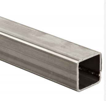

Thanks a lot Then i have to study how to design bracing I wonder if there are any guidelineWeight and stiffness are independent properties. Thick plywood is much stiffer than thin metal.
To be honest if i were a welder i would do it with these
like in the old racing car The frame was in welded metal
then the sides could be of cardboard plastic thin wood almost anything Aside bottom panel and front baffle of course

You could always get a blowtorch (or two) and silver solder it. But building a steel frame would add stiffness exactly where it already has stiffness - at the 90 deg joints.if i were a welder i would do it with these

But the idea would be to bolt the woofer directly to the rigid metallic frame and use the panels just to seal the cabinet
the metallic chassis would become the woofer basket No i will not weld the woofer to the frame

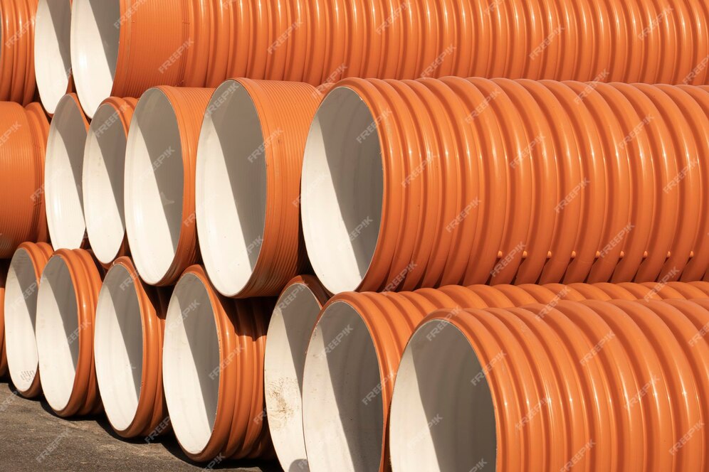

I actually considered using a sewer pipe at one point. A few friends of mine, work in construction, and sometimes have a piece left after a job. They are seriously strong and solid. So a glued in thick wooden panel in each end, and you would have a bit of unique look, with that color and ribbed shape 😀
