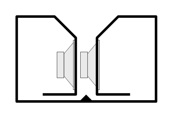

For the luxury of 100cm depth, I'd like to propose the attached design.
In fact it's more or less like I've mentioned previously, similar to the MB section, just somewhat bigger overall, and with a smaller slot-loaded throat.
For reducing the 1/4 wavelength resonance, 2 ramps in the throat chamber might help.
In the case of face to face, the ramps can even cover some of the cone area. As to the effect of such 2-stage compression, I'm not so sure...
The sketches are not to scale, of course. But if the driver is 18", then the overall width might approach 1.5m.

BTW, this has some other benefits:
1. time align with other sections of the system
2. coherent in the look with the MB section
3. there's still possibility to play with cardioid by the stuffing in the rear space
Have fun.
