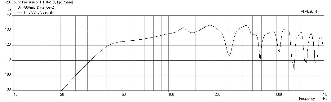

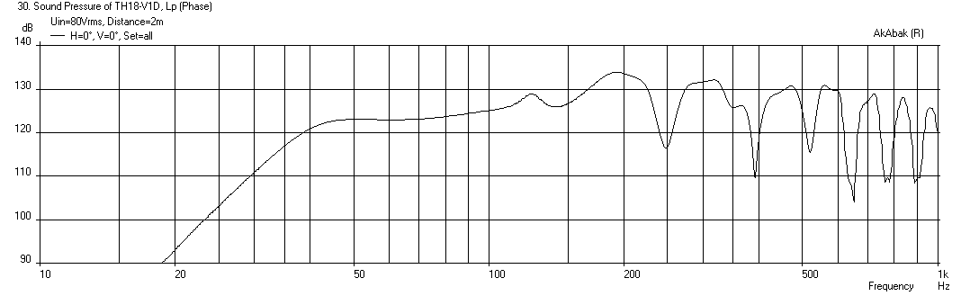

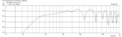

Here is the response at 2 m with cone driven to xmax for a single horn (mono-pole operation, no LPF but with 30 Hz HPF:

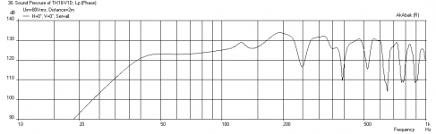

Here is the corresponding response for a di-pole TH, note the characteristic -6dB/oct fall-off associated with dipole radiation. This of course can be compensated in EQ, you certainly have the headroom given the max SPL this thing puts out:

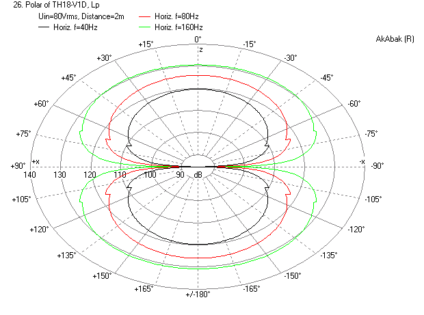

Here is the polar response for the above dipole TH over 360 deg at 2 m away. True dipole radiation pattern even for 40 Hz!

OK, just PPTH in monopole then. I did however verify that you can get true dipole behavior even at very low frequencies which are normally omni and non-directional. Here is a dipole TH using the TH-18 design (http://www.diyaudio.com/forums/subwoofers/190635-th-18-flat-35hz-xoc1s-design.html). It is 0.72 m deep x 0.53 m wide so when stacked back to back the depth is 1.44 m deep - too big. It could easily be folded differently to be taller and maintain the 1 meter depth. I know you do not require dipole anymore for the bass but I was curious so ran the sim anyway - it was an easy copy and paste of a single horn into two systems placed with mouths 180 deg apart and fired out of phase.

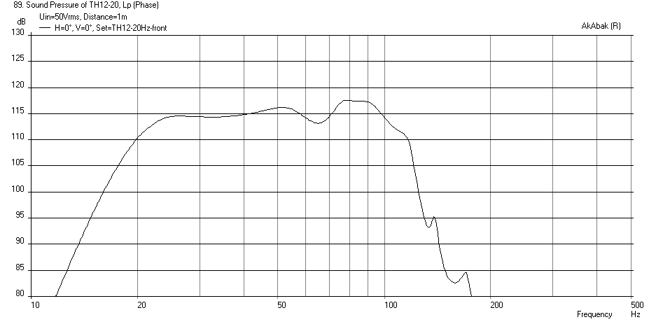

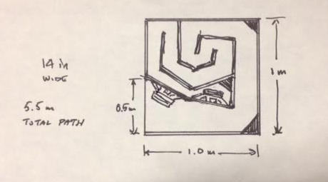

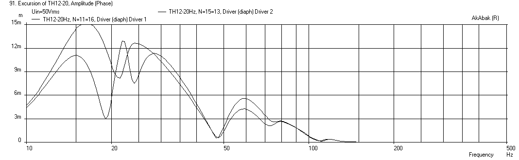

20 Hz PP Tapped Horn with dual 12 in drivers
I came up with a rough design for a push-pull TH using two 12 in drivers that fits in a 1.0 m x 1.0 m footprint that is 0.40 m tall. The total folded pathlength ended up at 5.5 meters which gets you down to 20 Hz. I ended up using some rather budget drivers but their specs seem to fit the bill (low fs, lowish Qts, moderate effficiency, long stroke). These are Infinity 1260W car audio subs (4 ohms) connected in series for 8 ohms. The nice thing is that these drivers are $62 (shipping included) from Amazon in the US 😀.
Here is the conceptual sketch which led to a simplified 7 segment horn model:
Here is simulation at 50 volts with an xmax of 13 mm (above 20 Hz), below that I am going higher than xmax but below xdamage. A 17 Hz -24dB/oct HPF and 95 Hz -48dB/oct LPF were applied:
As you can see, the bass extension goes to 21 Hz (-3dB) and is fairly flat up to 100 Hz where you are XO to the mid bass horn. This design has not been optimized at all so the efficiency is not very good for a tapped horn, but I wanted to see that a 5.5 m long path could be squeezed into a 1m square footprint with horn lying on its side.

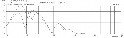

Here is cone displacement, which you can see is not symmetric given the fact that the drivers are located at different points on the horn - and I think this actually helps to smooth the output.

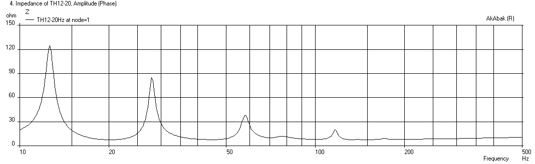

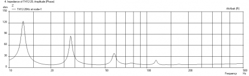

Here is the electrical impedance:

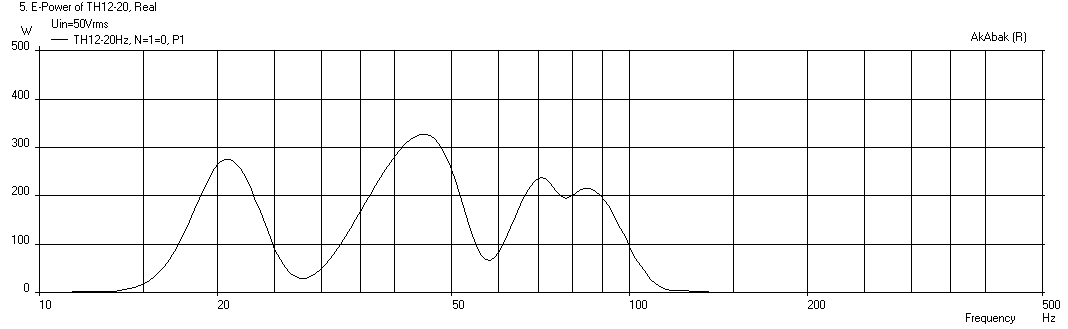

Here is the electrical power to reach xmax - need a 350 watt amp:

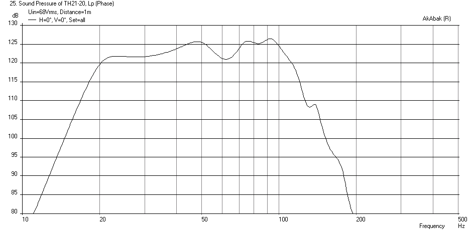

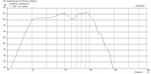

21 inch 20 Hz TH
I had to try it - I took the same exact design for the 12 in PPTH above and increased the width to 24 in to hold a 21 inch B&C 21SW152-4 driver. This monster of a driver has a Nd motor with a Bl of 32.5 and an xmax of 15 mm. Anyhow it worked out beautifully. Same 1 meter square footprint, it is just now is 25.5 in tall (0.65 m). Single driver rather than dual PP. Here is what you can get from it at 67 volts drive (about 1 kW) to hit xmax:

About the horn with 21", under 40Hz, less than 125dB @ 1kW. (And that's about 95dB @ 1W, right?) Hmmm... I guess the driver would give similar performance in a bandpass or vented box.
I'm afraid it's not worth the effort to build a horn, then. 🙁
Or, look at it in another viewpoint. Try making a sim with the same driver and an optimal horn profile, compare the results. It'll be stunning.

The TH sounds much cleaner though - the group delay and transient response is better than reflex. An optimized TH with this driver should be able to achieve higher efficiency. I just have not had time to optimize it - this is literally the first sim that came from the dimensions on my sketch. I never even touched HR which has sliders to optimize on the fly.
I had to try it - I took the same exact design for the 12 in PPTH above and increased the width to 24 in to hold a 21 inch B&C 21SW152-4 driver. This monster of a driver has a Nd motor with a Bl of 32.5 and an xmax of 15 mm. Anyhow it worked out beautifully. Same 1 meter square footprint, it is just now is 25.5 in tall (0.65 m). Single driver rather than dual PP. Here is what you can get from it at 67 volts drive (about 1 kW) to hit x-max.
