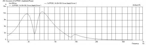

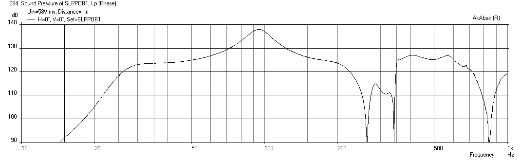

Here is a design for kind of an over-the-top SLPP vented back sub using the monster Faital Pro 18XL1600 drivers (http://www.faitalpro.com/products/files/18XL1600/4/18XL1600_datasheet_4.pdf)with 98 dB efficiency and 12.9mm of xmax. There are two drivers wired in parallel in a push-pull slot in a box with a very large rear facing vent that can be stuffed and damped if desired. The box is approximately 40 in deep x 36 in wide x 22 in tall with a 16 in wide x 20 in tall x 24 in deep slot that feeds a front horn expanding to 30 in wide over 15 in distance. The volume of the box is 470 liters and there is a 7 in x 13 in rear facing port that is 20 in long. The drivers are fed with up to 56 volts to hit xmax through a -24dB/oct HPF set at 21 Hz.

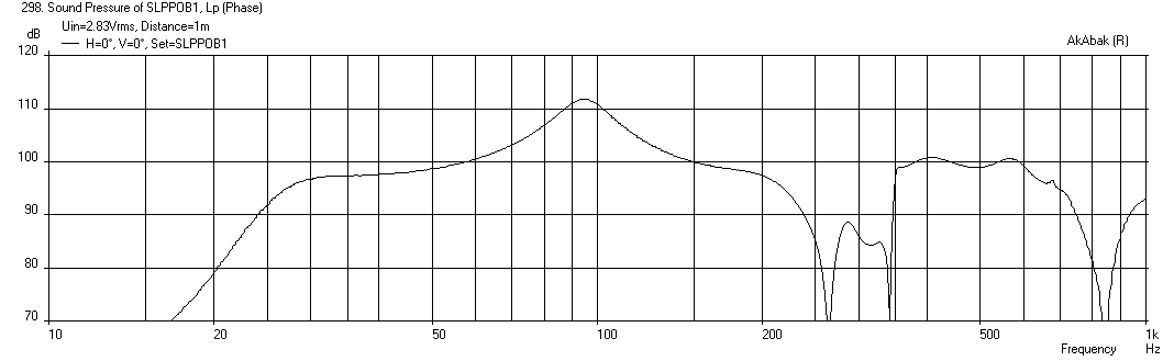

Here is the response at 2.83V and 1 meter on axis:
Some EQ'ing will be needed to flatten the 95 Hz peak characteristic of slot loaded designs.

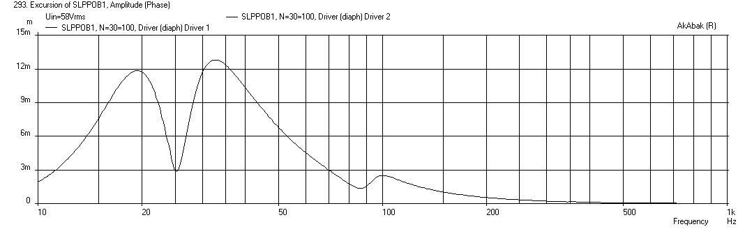

Here is the cone displacement at 56v to reach 12.9 mm xmax:
Here is the corresponding SPL at xmax:

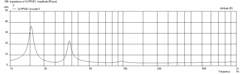

Here is the impedance:

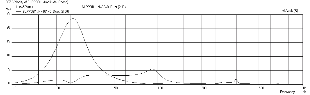

Here is the velocity in the rear vent and front slot at xmax:
If you enlarge the rear vent, the bass extension drops and you will have to apply EQ to increase the SPL at low frequencies. This driver is perfect for that though with 12.9 mm xmax. It wasn't my intent to use this driver to produce 120+ dB but to have the headroom there so that EQ can be applied if needed.

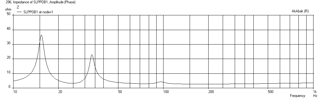

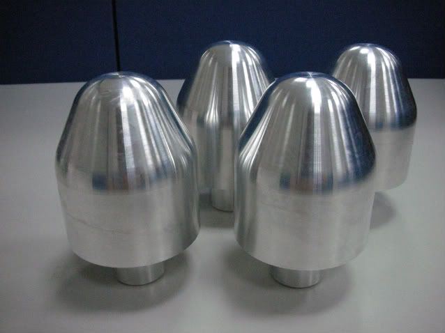

Legis,
I have similar phase plug for woofer which has a section at the bottom to fit in the ventilating hole in pole peice.
It's snug. And I just use a bit screw glue to secure it in place. Zero problem for years.
You can do simliar thing to your plugs and save the bolts.

Do you have a machinist custom make these? They look really nice and I guess also lowers distortion. You can probably just make the lower part where the voicecoil extends over for a shorting ring and the rest of the cone can be non conductive even (wood or plastic). Copper would work even better.
Yes, custom-made.
Distortion? Not feeling it and can't measure it. LoL.
I didn't even see reduction of inductance in higher frequency when run them on WT3 before and after.

I did not see it either, the inductance at the coil's resting place is approx. the same regardless of the plug. My theory is that Le(X) got better, the inductance variance got smaller depending on the voice coil's position. Depending on the motor's design, it might also get worse with metallic plugs.

Do the plugs come of if you have to take them apart? What are their size and mass? Mine are 2,8kg and 4" x 5,5" / 100mm x 140mm.
I have gotten the idea that DCR of the shorting ring matters the most. Basically the shorting ring/phase plug can be kept shorter (metallic base and wooden tip for ex.) and/or even hollow, but the DCR goes up compared to bigger plug.
Copper or brass plugs would look really nice (and weight a ton)! Maybe some day... 🙂

My phase plug is 3" O.D. Don't remember other numbers. There should be a drawing somewhere, I can't find it now...
Would it come off when needed? I suppose so. The adhesion of screw glue is not very strong. If it can't be pulled off from the front, I may use a long stuff to push it out from the rear end of pole piece ventilating hole.
Time flys. It's been 5 years and I can't think of any reason to take them apart.
