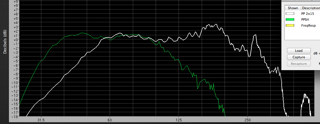

The 15" push pull (one driver has the magnet in the slot) slot loaded cabinets I recently built had around a 3 dB peak at 180 Hz, easily tamed with DSP, as can be seen in the green response compared to the raw white response. I'd expect an 18" slot to be no different other than the frequency. The PP arrangement is probably less peaky than a cone to cone arrangement, though.
Interesting idea Art, the PP would basically null out the driver induced expansion error ~4l volume in the pair of cones. It would be worth giving a try IMO.

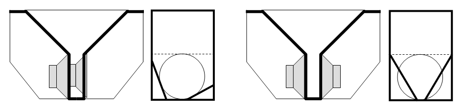

For the luxury of 100cm depth, I'd like to propose the attached design.
In fact it's more or less like I've mentioned previously, similar to the MB section, just somewhat bigger overall, and with a smaller slot-loaded throat.
For reducing the 1/4 wavelength resonance, 2 ramps in the throat chamber might help.
In the case of face to face, the ramps can even cover some of the cone area. As to the effect of such 2-stage compression, I'm not so sure...
The sketches are not to scale, of course. But if the driver is 18", then the overall width might approach 1.5m.

BTW, this has some other benefits:
1. time align with other sections of the system
2. coherent in the look with the MB section
3. there's still possibility to play with cardioid by the stuffing in the rear space
Have fun.

What's this monster?
Is it going to be an end-fire array in a horn?
ps. I wonder if the throat is missing in that drawing...

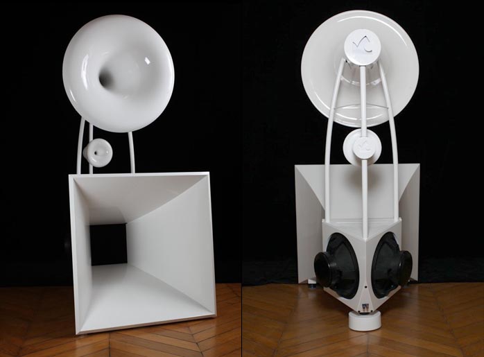

Elias, something like that. Midst googling I happened to come across the Cessaro horn speakers: Cessaro ::*Gamma I
Those desing choises give many ideas. I like the frame consept. Much less brutal looking than "piled-up PA system" -look. 🙂

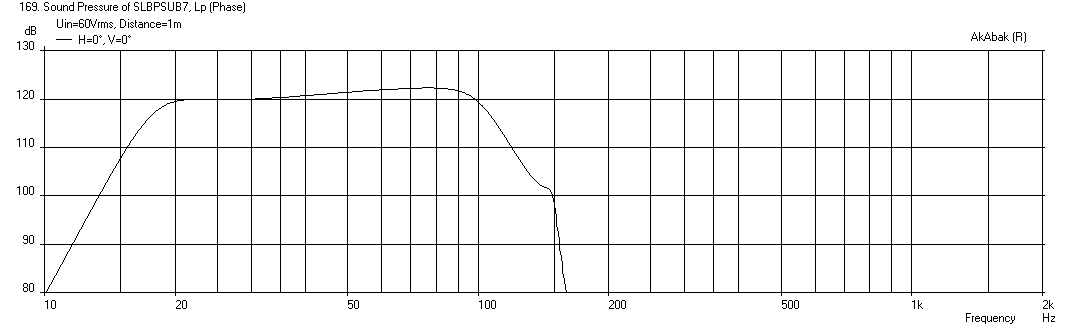

I could start with the sim I did for CLS's slot loaded push pull bandpass sub: http://www.diyaudio.com/forums/subwoofers/255959-sim-slbp_pp-maybe-more.html
Then simply close the vent leading to the slot and add resistive vents to the back and/or sides.

"What's this monster?"
Cerwin Vega bass horn with an extra driver added to convert it to cardiod bass, read the patent for more details (although I summerized).

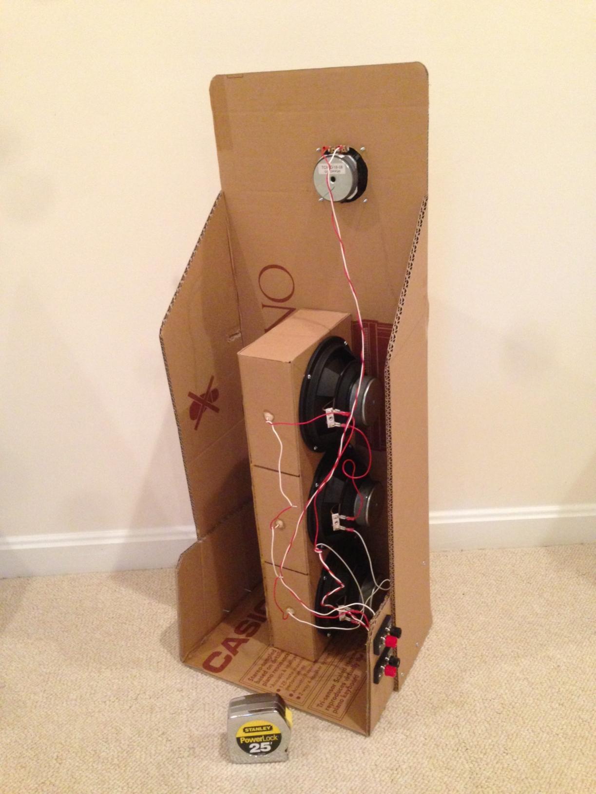

My one experience with a slot loaded push pull open baffle was very positive. I used 6 x 6.5 in high Qts cheap woofers. The bass is very natural sounding and actually digs deep without wall shake. If I were to build a wooden speaker my next build would indeed be a slot loaded push pull OB with maybe 8 x 8 in drivers each side for the sub woofers.
http://www.diyaudio.com/forums/full-range/249984-cheap-fast-ob-literally.html
