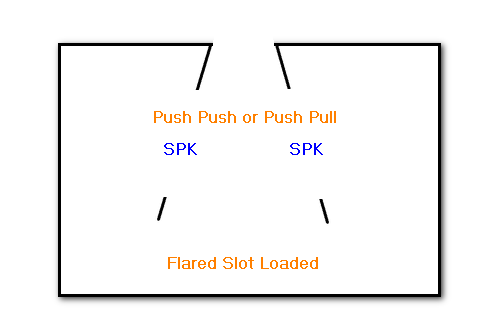

Here's the next iteration of PPSL. With detachable slot portion one could alter between closed PPSL and reflex/bandpass PPSL just by detaching one slot and attaching another. The slot would be attached with for example M6 bolts from the front.
The slot could be approx. 22cm x 50cm with 2 x BMS 18N860. This would result in compression ratio pretty close to 2:1.
In reflex situation the slot/vent could be ~90cm deep. The inner volume of the box would be around 430 litres and the 22x50cm vent's area corresponds to around 38,5cm dia round vent, and thus the tuning freq should be around 28Hz. However the tuning point should be around 20Hz to my liking (Also woofer's Fs is around 22Hz). I have to think more about the venting. Maybe the vent could be tapered at the start to lower the tuning point, but I don't know how to simulate this kind of vent.

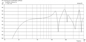

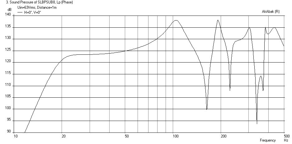

The design I came up with if you allow for the 400 liter box gives this:
You will have to use EQ to reduce the peaking near 100 Hz but that is good as it lowers distortion. Let me work on it some more as I think the peaking is a function of the default slot length which I assumed to be the depth of the box minus the vent and ply wall thickness so it imposed a peak. I need to make the slot only as long as needed (20 inches) and peak should be pushed up much higher for flatter response.

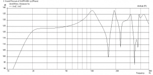

Reduced slot length PPSL

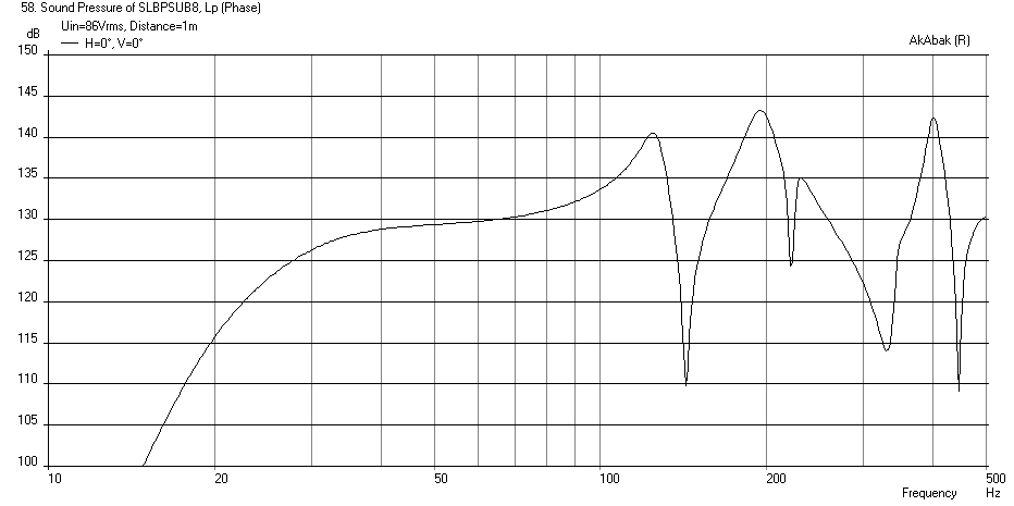

I made the slot as physically short as possible to still allow the driver to be mounted inside (47 cm deep). Retuned the vents which are now 5 cm deep x 57.4 cm high x 90 cm long (qnty2). The height corresponds to a 64 cm tall box with 18 mm ply tops and bottoms and qnty 2x 18 mm braces in the vents. The box volume is now 215 liters total which accounts for the volume taken up by one driver (assumed to be 15 liters) and the vents and the slot duct. The design generates 116 dB at 20 Hz which begins to falloff at about 40 Hz. So with EQ'ing you can get a flat response or let room gain bring it up. The shortening of the slot to 47 cm moved the 95 Hz peak over to 125 Hz.
Here is the frequency response with a 19.5 Hz -24dB/oct HPF driven to xmax at 86 volts:

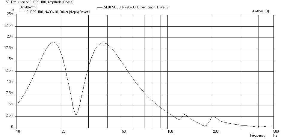

Here is the corresponding cone displacement at 86 volts (although you probably don't want to put that much power into them - but they can handle it as they are rated for 1.5kW ea) :

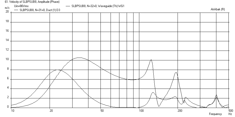

Here are the velocities in the vents and slot which is around 10 m/s max for minimal chuffing:

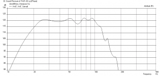

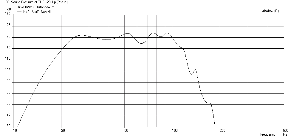

Here is the same TH design with the 18N862 and a 20 in wide speaker driven at xmax of 19mm:

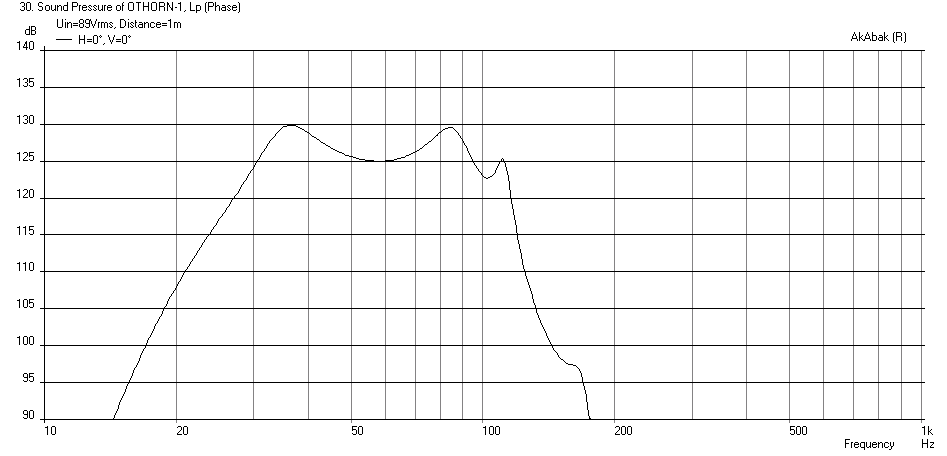

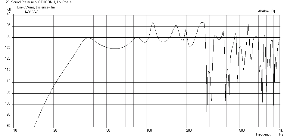

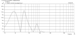

Here is the sim of the Othorn (script from AVS Forums) that I modified to allow scaling of the CSA of the waveguides. This let me apply a scaling of 19.5/22.5=0.867 to give the driver clearance similar to the original 21 inch driver. It is not as flat as the original 21 inch, but then it is not bad either and has 30 Hz reach with unspeakable SPL capability at 19 mm of xmax which requires 89 volts to reach with a 20 Hz -24dB/oct HPF. You could shake a house apart with this thing.
If you apply a -48dB at 95 Hz LPF you get this:

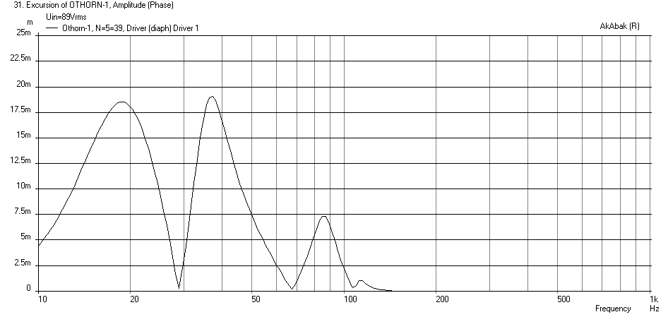

Here is the corresponding cone displacement at 89 volts drive:
