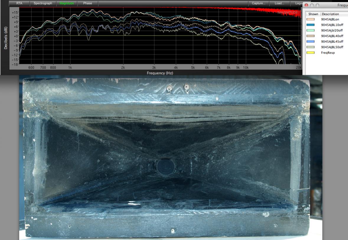

I have made several different conical horns approximating the Hughes Quadratic Throat Transition, they all sound good and have uniform horizontal dispersion. I have compared the same driver to a previous horn with diffraction issues, the HQTT sounded more "real".
The measurements below are of a HQTT 90 x 45A horn ("A" for asymmetrical, it points a bit downward when mounted flat) using a JBL 2420 (near the same throat angle as your JBL) with an aftermarket titanium diaphragm. The driver pictured on the 9045A is a BMS, not the JBL.

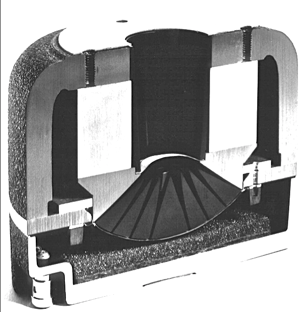

IIRC (we know how reliable that is 😉 ) the 244x all share the same narrow throat angle and depth to the diaphragm for compatibility, you can see the angle on this 2441 cutaway view:

With eye I would estimate that the phase plud ends/inner horn starts quite near where the top plate starts. Thus the inner horn might be around 59mm long in 2446: https://www.jblpro.com/pages/pub/components/2446.pdf
The angle can be calculated from that. It is around 11,5deg, if the inner horn is 38mm at the start 50mm at the end, and 59mm long.
