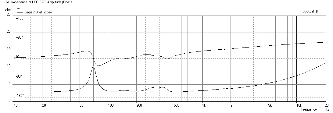

Edit: here is the impedance and phase for the dual Deltalites in the Synergy. It looks like the resonance peak is at 70Hz vs your measured value of 60Hz, but the feature of the small blip at 150Hz and the 300-400Hz are all there, there is even a tiny feature at 2kHz is showing up. Seems fairly accurate overall - I am actually pretty surprised how well this correlated. I adjusted the Q to simulate damping and when set at Q=0.12 (almost aperiodic) the impedance matches at 10 ohms. If set to Q=0.5 it is about 15ohms so still close.
Let me take a look at resonance freq. I was just thinking how you were saying the horiz polars are not as even and I think this may be due to two things: (1) the large holes on the side due to the injection ports for the Deltalites, (2) you have a rectangular apex and probably no reason this coils not have been a square to match the round CD output. Wood putty will do wonders though. For prototyping and checking if the rounded corners will help quickly is to use modeling putty/clay. Then use wood putty and sand if that works. Awesome speed of build though.
Yes, aperiodic was the word I tried to remember.🙂 That is quite remarkable similarity between sim & real thing for this kind of non-simple construction.

This should give credence to using Akabak to model a Synergy injection port horn. I am pretty happy with the result and now have more confidence that we can use this model to help guide the optimization of the design if you wanted to do more to it. You can do something crazy like re-route the exit of your TH to slots near the mouth of your Synergy for true 40Hz to 15kHz "Point Source". 😀

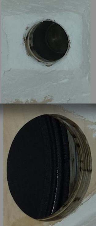

Here's a picture of the second (undried) transition treatment. With enough repetition and patience I try to land somewhere near smooth and linear expansion. I hope it does not screw up the sound I already got out from these 😀.
I also rounded the mouh of the horn yesterday and treated the injection ports. Have to use knife where the router could not fit.
Also did some testing with the RAL 3001 -colored speaker cabinet paint.
Third throat treatment. Already starting to feel like a smooth transition, but not the most linear/conical yet.
It can never be anything but a parabolic (or whatever shape you choose) transition to conical, unless you rebuild the horn, extending it to the driver exit dimension so the horn starts and stays conical.Third throat treatment. Already starting to feel like a smooth transition, but not the most linear/conical yet.
I see what you are saying Weltersys, the best wY to fix is to extend the vertex end farther back so that the CD throat starts at a smaller area and avoids the jump to the rectangular area discontinuity. Build a small piece to extend back may be best option.
