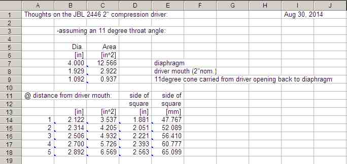

Hi Legis,
I don't know if any of this will help, so just take it as techno musing (not music). 🙂
I started looking at using 11 degrees in AutoCAD. Then I looked @ the respective square areas in 1" steps from the driver mouth. Your areas would be rectangular, but the same method should tell you where the horn cross-section matches the driver throat angle extension cross-section. For example I found, that w/ a 1"Dia. mouth/14 degree throat angle driver you get from the 1"Dia. circle to a 1" square mouth in about 1/2" distance; so the mounting plate can also become the shape transition.
Hi Legis,
I'm still thinking about the driver to horn adaptor problem. I'll attach a sketch of what might be about correct.
That looks really good transition to me, thanks! My horn adaptor is 30mm thick total (2x15mm). I have used a router to round the adaptor's exit to the horn (maybe the last 5mm or so). I have thought to make the whole adaptor with a small opening angle, close to 11deg (what the 2446 has) vertically and maybe slightly higher angle horizontally.
Managed to do a small flare to the adapter also, it was very good addition. This is how the throat is looking before I start finalize them by adding very small layers of wood filler and sanding it down to smooth surface. I'm very happy how they look and feel (very damped because of the thick layer of wood filler) and have no doubt the throat will sound very good.😉 The geometry does not show good until I have painted them I quess.
