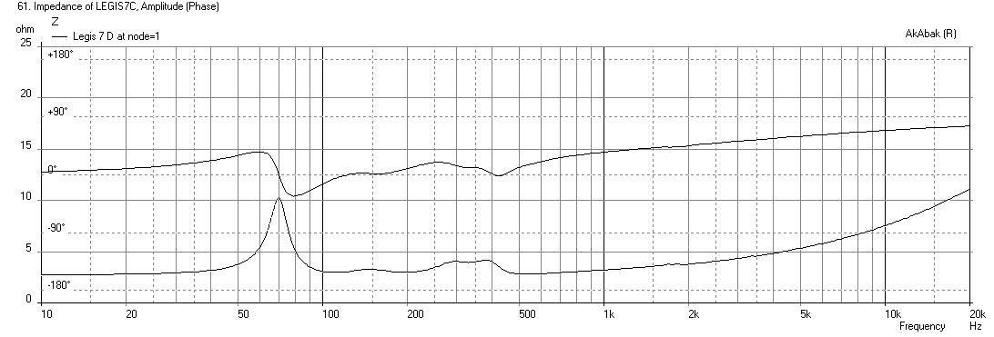

Let me take a look at resonance freq. I was just thinking how you were saying the horiz polars are not as even and I think this may be due to two things: (1) the large holes on the side due to the injection ports for the Deltalites, (2) you have a rectangular apex and probably no reason this coils not have been a square to match the round CD output. Wood putty will do wonders though. For prototyping and checking if the rounded corners will help quickly is to use modeling putty/clay. Then use wood putty and sand if that works. Awesome speed of build though.
Edit: here is the impedance and phase for the dual Deltalites in the Synergy. It looks like the resonance peak is at 70Hz vs your measured value of 60Hz, but the feature of the small blip at 150Hz and the 300-400Hz are all there, there is even a tiny feature at 2kHz is showing up. Seems fairly accurate overall - I am actually pretty surprised how well this correlated. I adjusted the Q to simulate damping and when set at Q=0.12 (almost aperiodic) the impedance matches at 10 ohms. If set to Q=0.5 it is about 15ohms so still close.

Yes, aperiodic was the word I tried to remember.🙂 That is quite remarkable similarity between sim & real thing for this kind of non-simple construction.
This should give credence to using Akabak to model a Synergy injection port horn. I am pretty happy with the result and now have more confidence that we can use this model to help guide the optimization of the design if you wanted to do more to it. You can do something crazy like re-route the exit of your TH to slots near the mouth of your Synergy for true 40Hz to 15kHz "Point Source". 😀

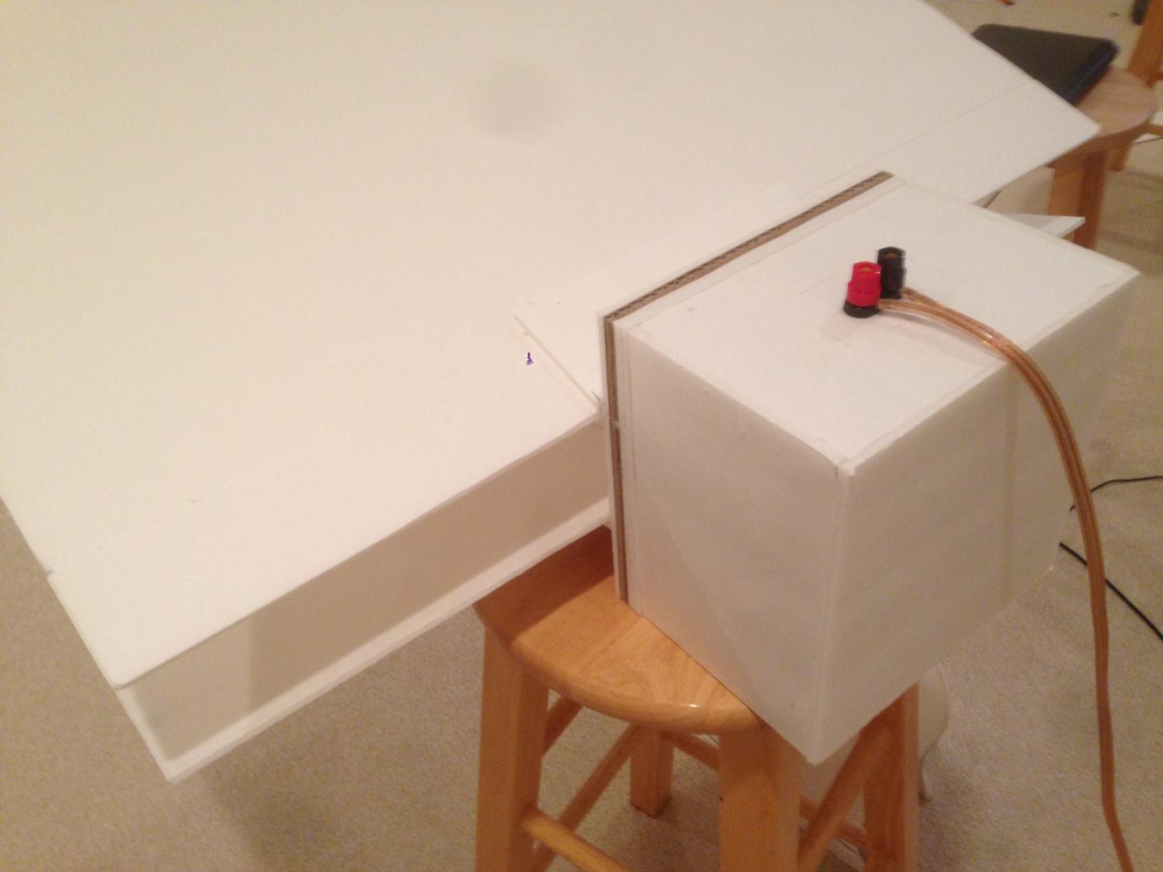

Here's a picture of the second (undried) transition treatment. With enough repetition and patience I try to land somewhere near smooth and linear expansion. I hope it does not screw up the sound I already got out from these 😀.
I also rounded the mouh of the horn yesterday and treated the injection ports. Have to use knife where the router could not fit.
