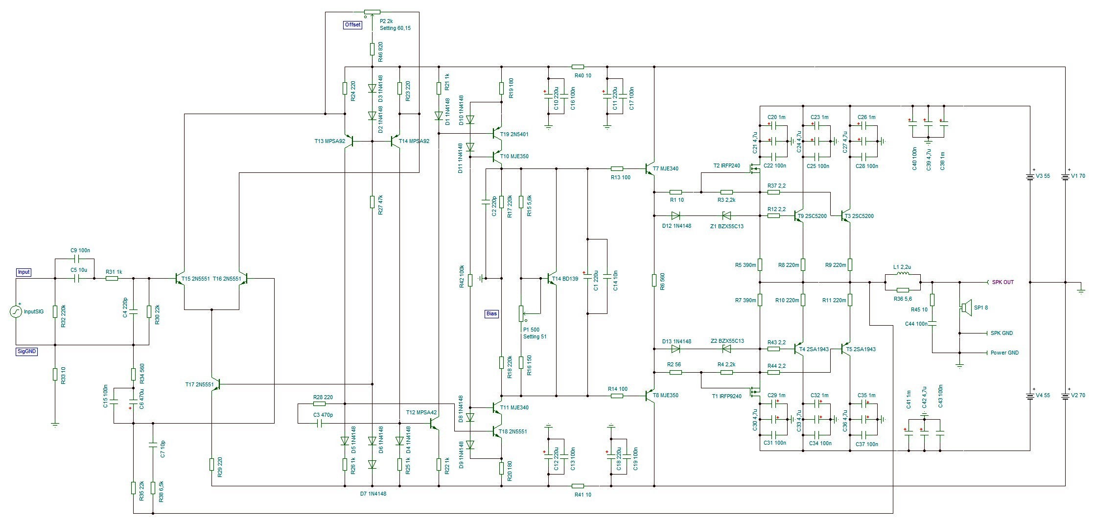

In attachments you will find TinaTI simulation files,

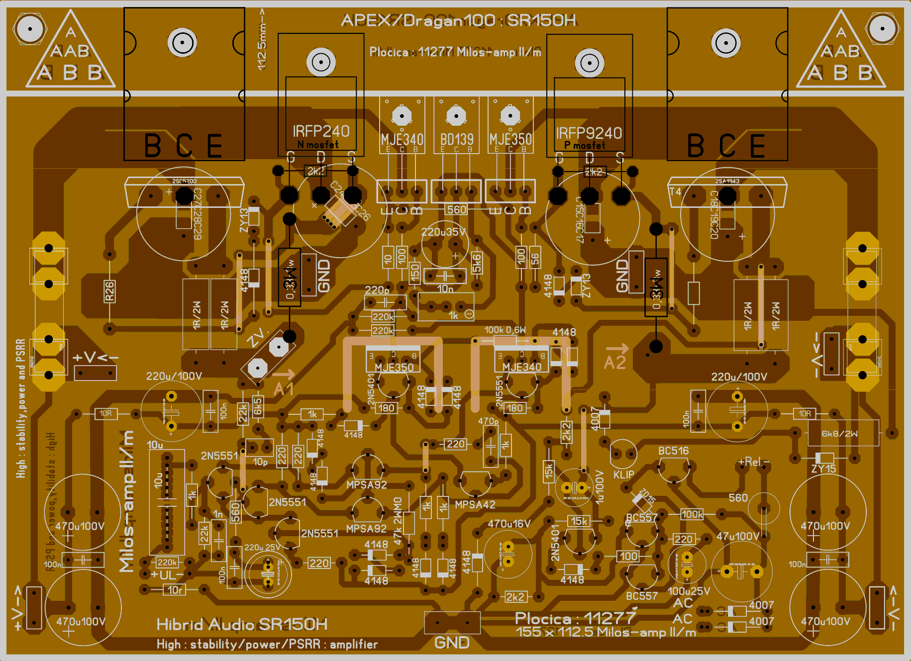

SR150, SR150H and the latest variations SR150LBH LinearBipolarHybrid
with Mosfet at the output,
together with the complementary pair 1943/5200.
They are biased: mosfet@250mA, bipolars@cca 50mA each,
and must be closely matched for even current distribution.
At Mosfet gates is a linearisation stage in some current mirror variation
which design is from our forum member MacolaKG here at local forum DIY Audio Projects
The whole output stage is in the very strong local FB
and output stage curve parameter from such type output is pure line y = K * x,
The predrivers are biased also in ClassA@25mA,
Feel free to take a journey with doose files into simulation world and look at amps parameters...
Regards
Dragan100

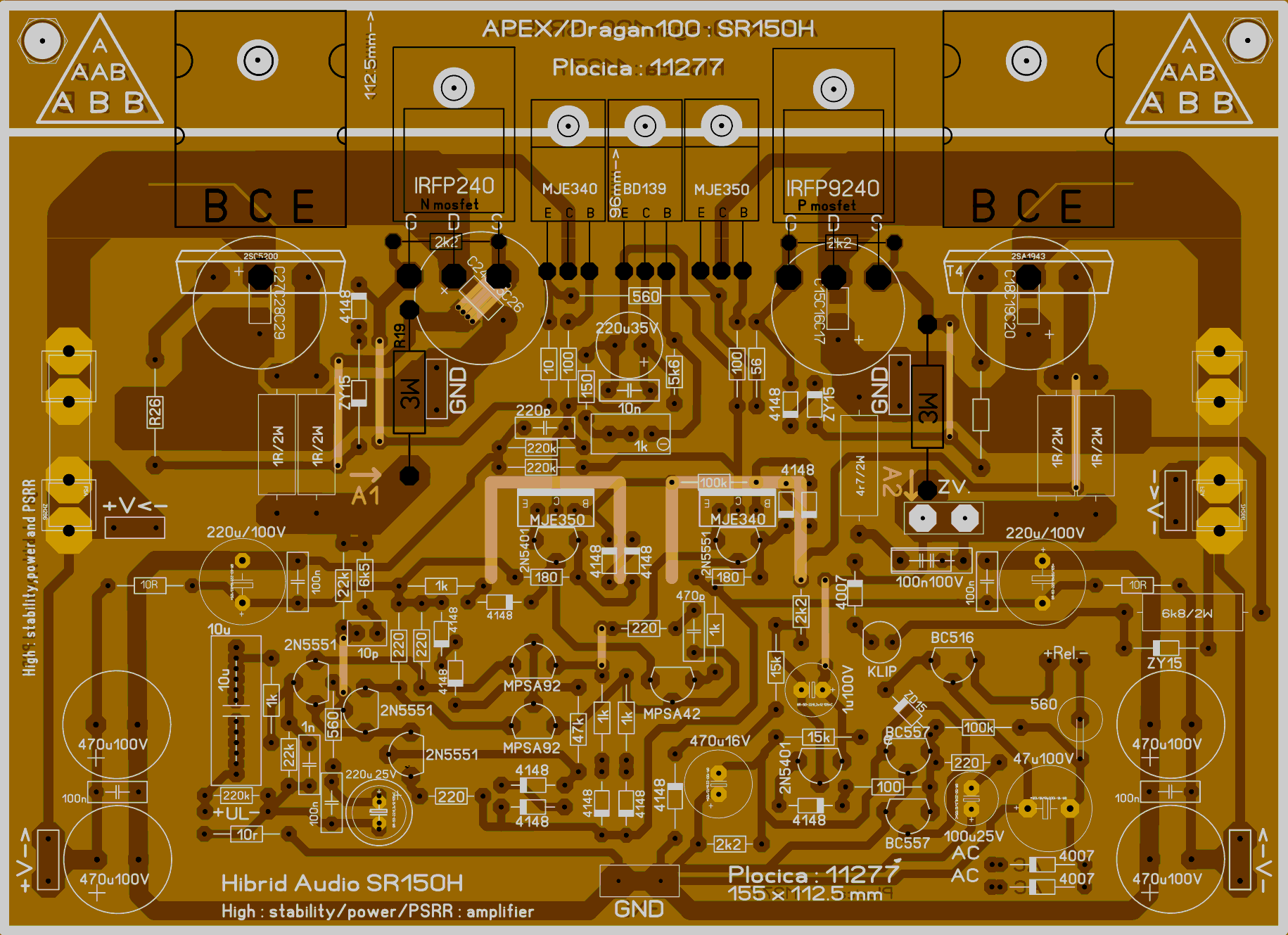

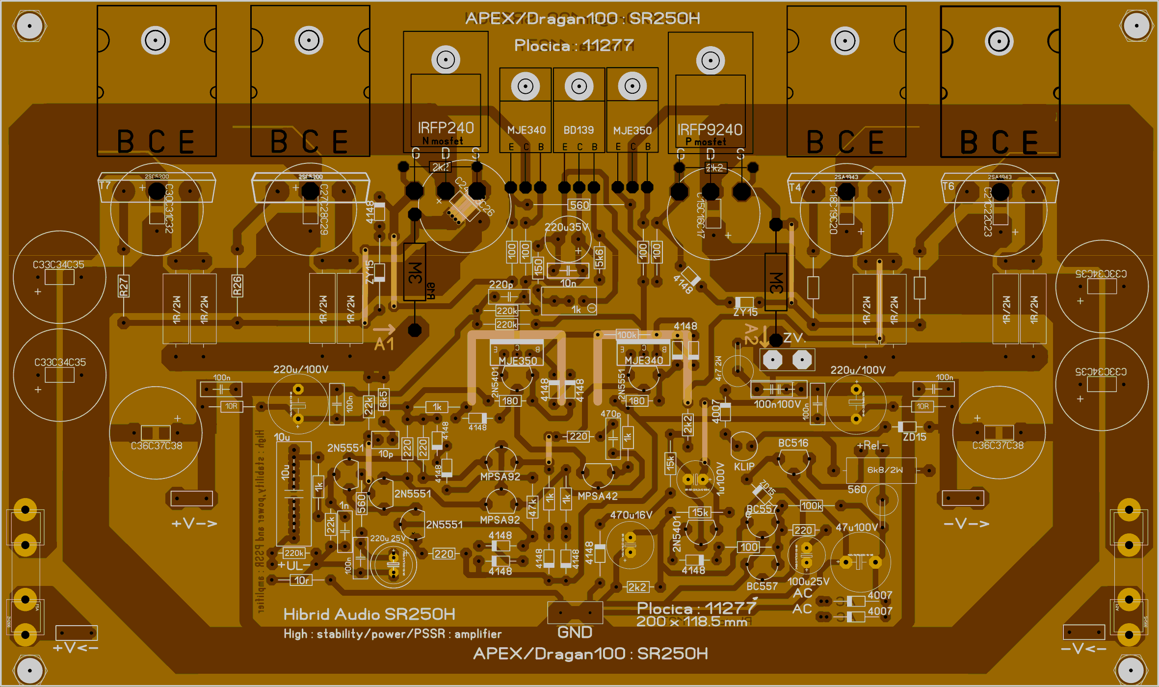

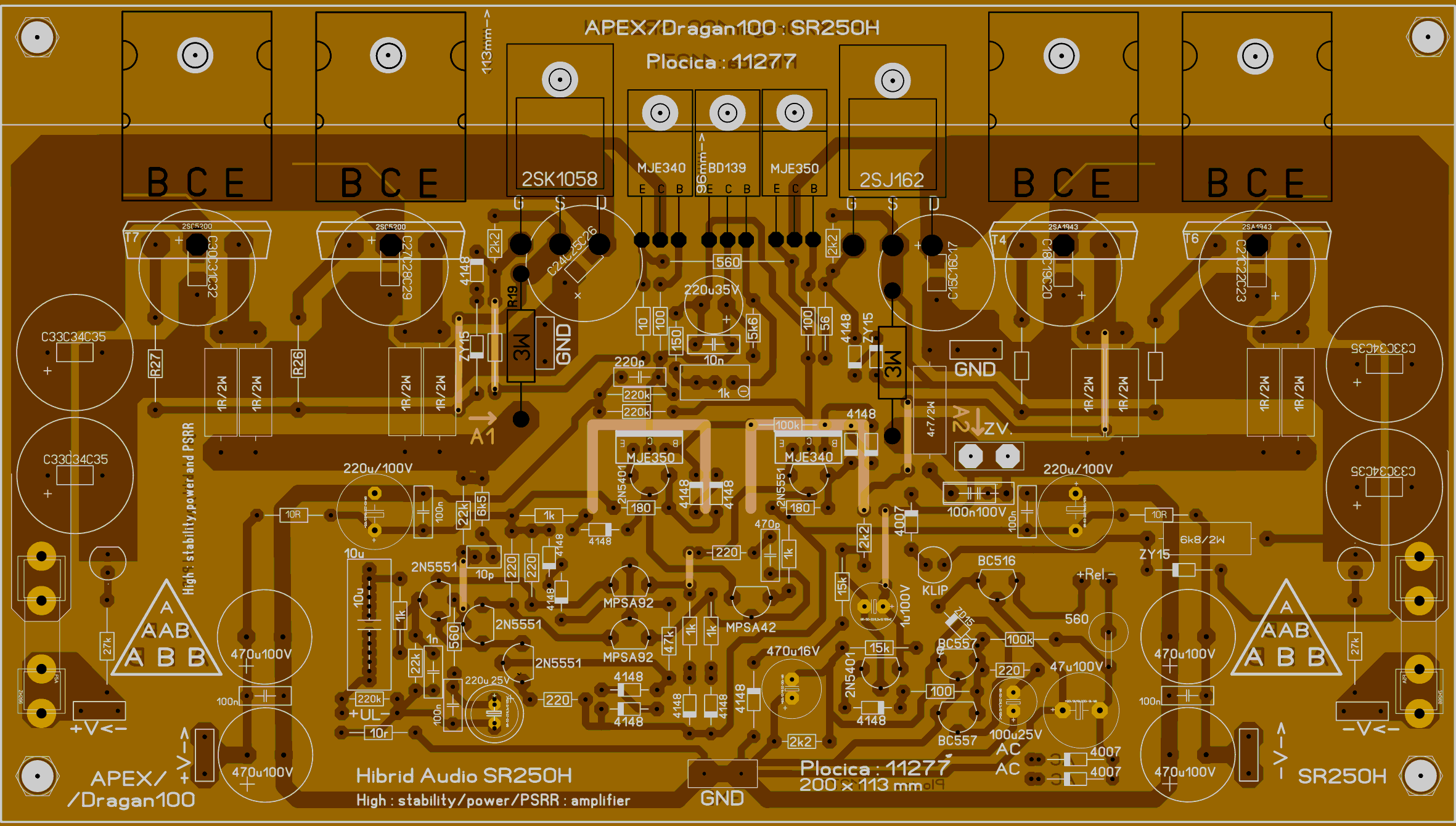

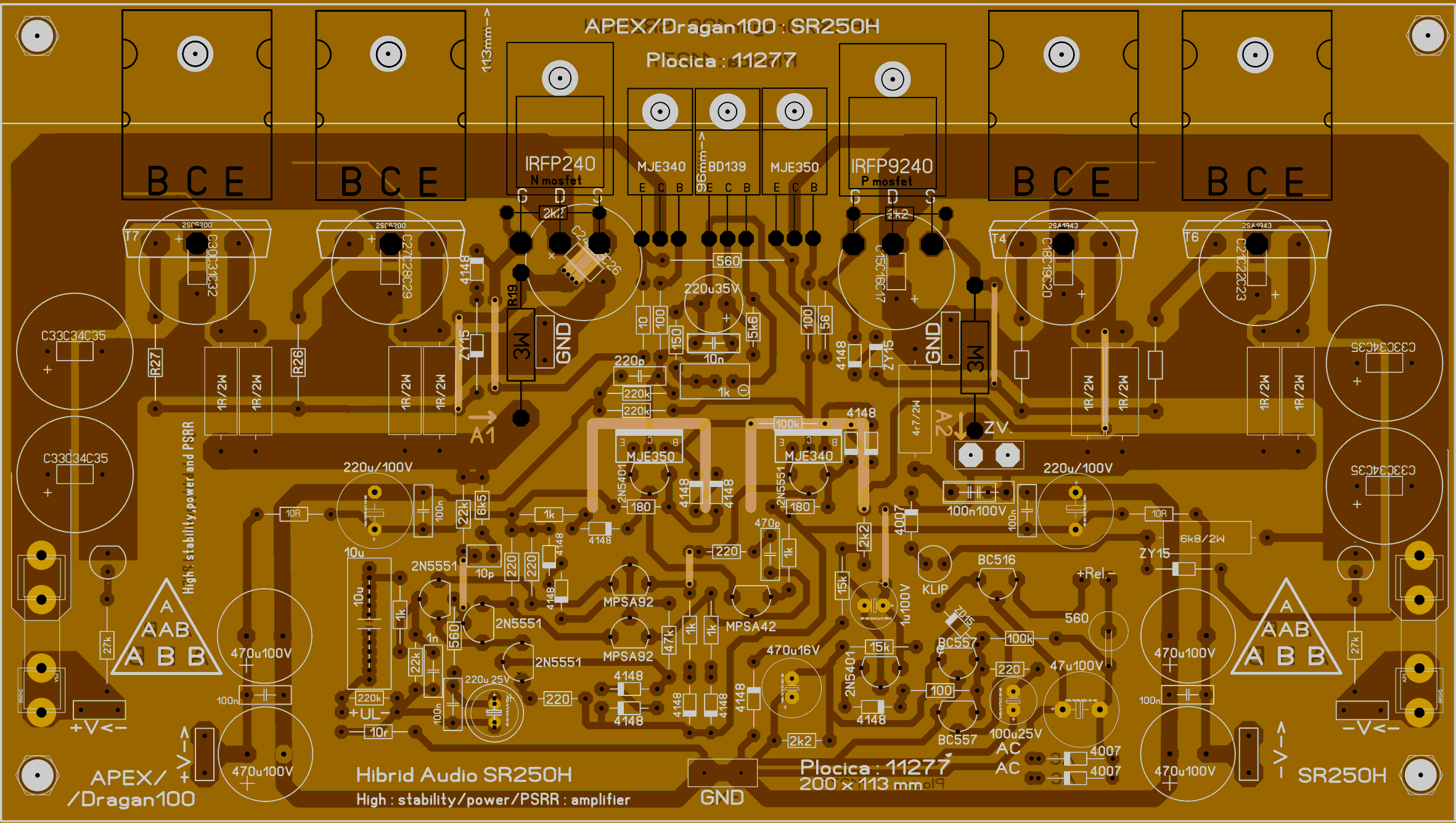

SR250H,in progress:
(there will be lateral SR250, and smaller versions irfp / 2sk-sj with one pair of bipolar transistors in output-4 versions in total)
SR250H,in progress:
not checked...
the point would be to play a bit in order to get first watt or two in a-class,make mosfet to play to about 30-35W / 8r and than to get all the help needed from output BJT pair. i believe that i will build smaler lateral version because it will give me enough power and i have output transistors. before i do any pcb´s i must check out if it is matching schematics,and to adjust resistors in bias circuite. for lateral mosfets there should be a little less Ugs and bias transistor probably will not be needed but practise will tell.

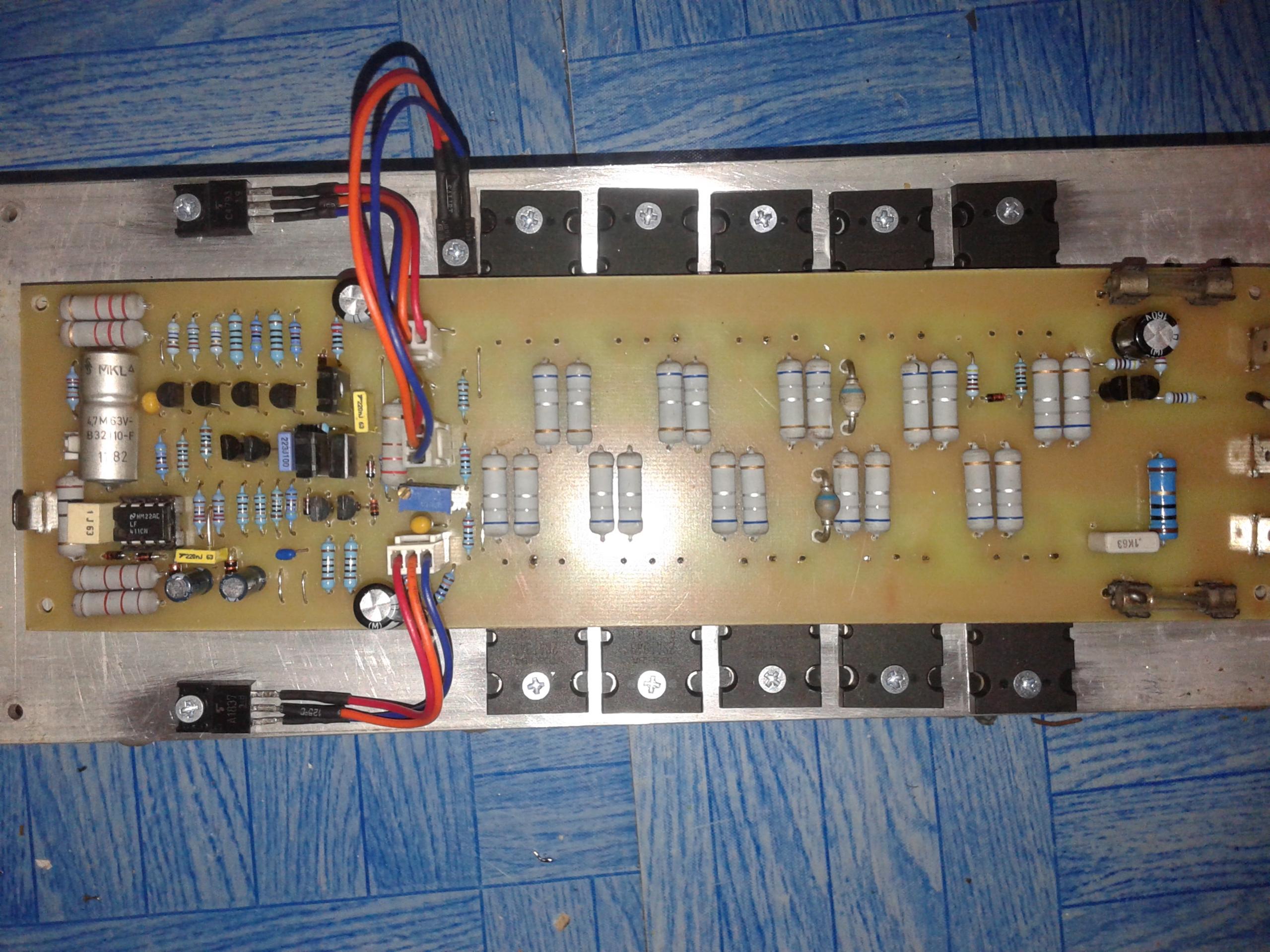

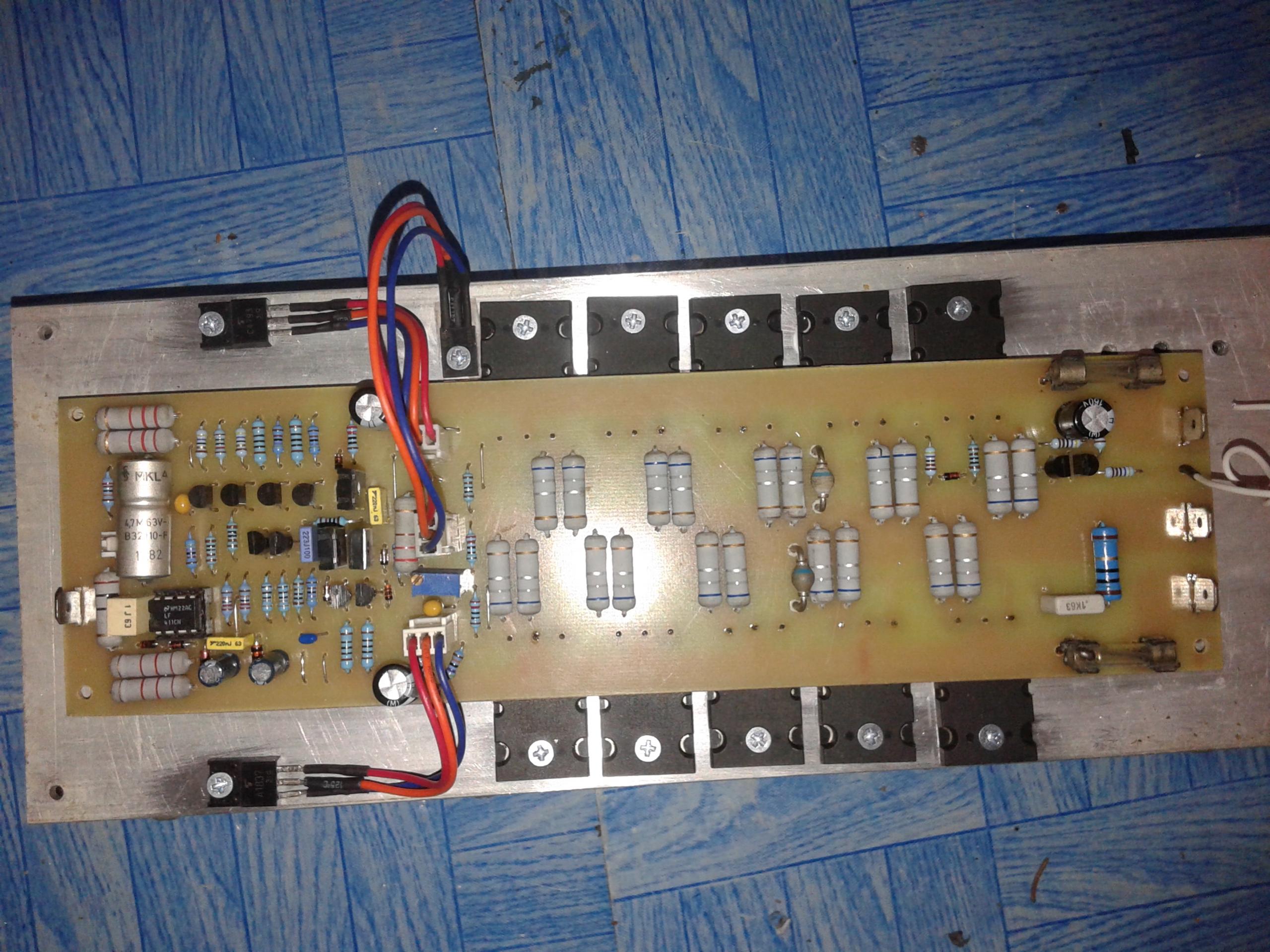

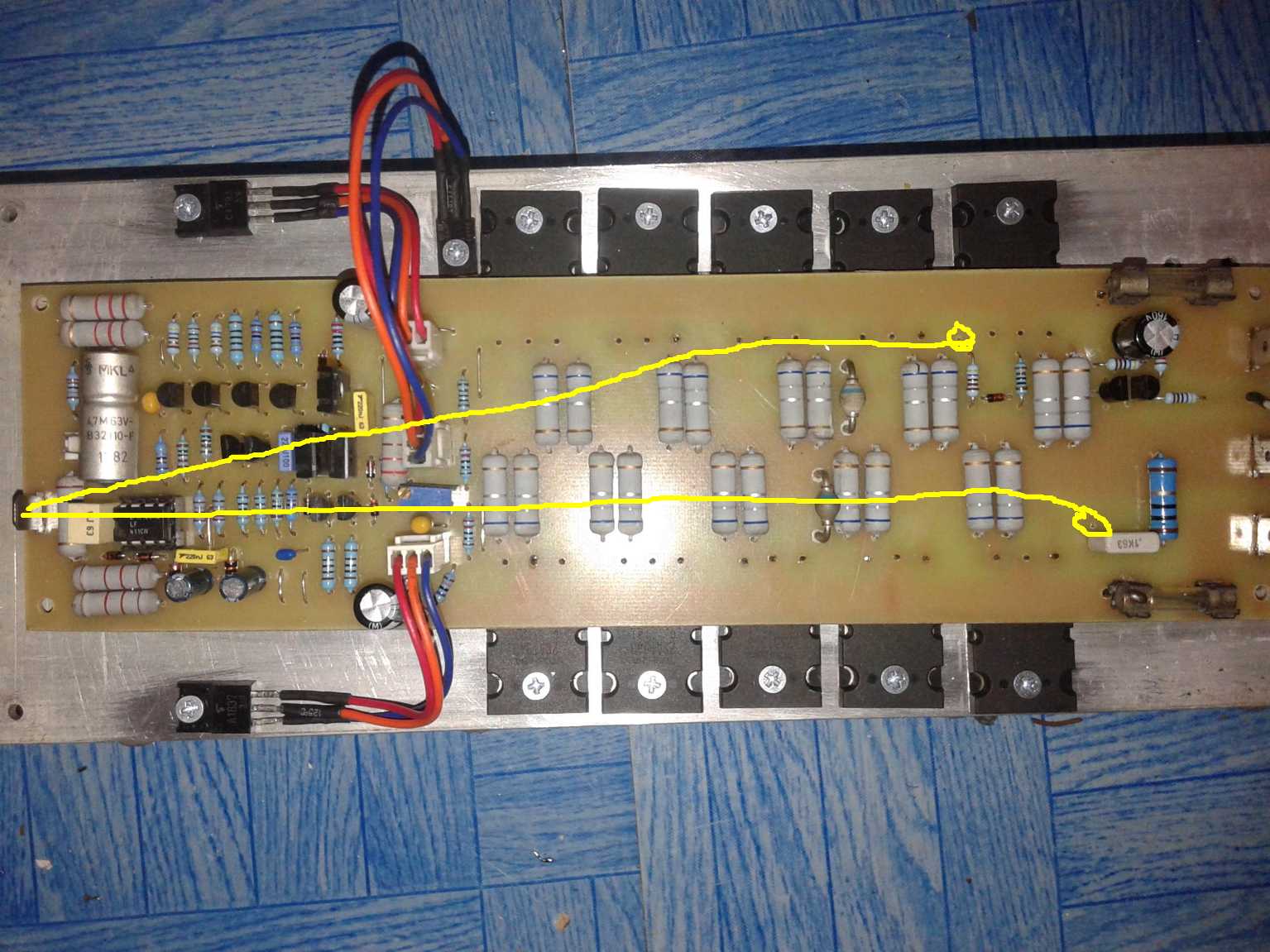

Are the cable wiring ok ?
Need advice and lighten...

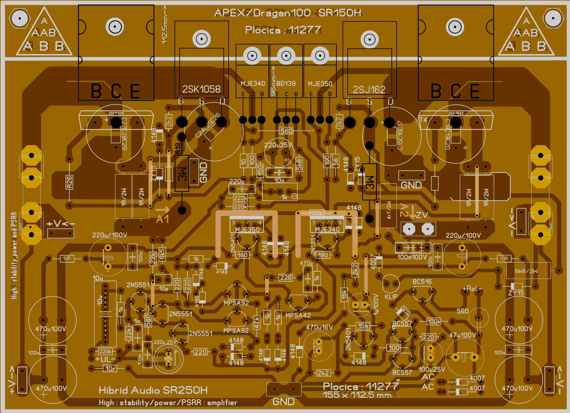

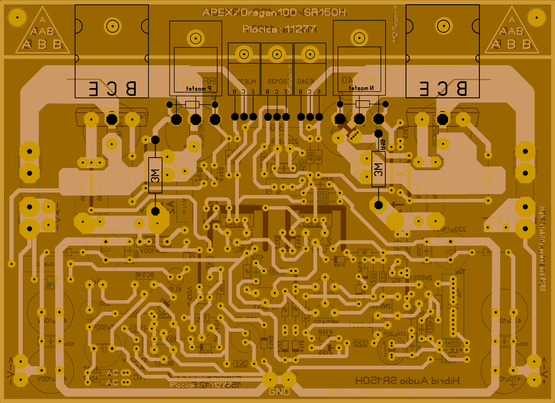

Just need wire to connect two point with gnd. Pcb layout was modified from Alexmm layout just to fit extra OP. Layout for protect and zobel was done keeping in mind double side copper board that I had back then.
backside
Cable jumper on the backside sir...
How mA for the bias i suppose ti give sir?

-the point would be to play a bit in order to get first watt or two in a-class,make mosfet to play to about 30-35W / 8r
-for lateral mosfets there should be a little less Ugs and bias transistor probably will not be needed but practise will tell.
Regard 44250, fast progress!!!
For V_be biasing circuit with laterals in output we`ll need only R16 - 150R and P1 - 500R multiturn (10 turns) trimmer pot.
Because for laterals output pair in hybrid version with their positive temp drift we will eliminate:
-T14 V_be bipolar
-R15 put 0R or short
with 10-11mA biasing current (VAS CCS) we`ll have
-min U_bias 1,5V (150R)
-max U_bias cca 7V (150R + 500R trim.pot)
and we needs cca ( 2x 1,1V (for Ugs treshold typ laterals) + 2x U_be (for U_be drivers) + 2x deltaU_R (for R13, R14)) = TOT typ 3,7 - 3,9V
-start biasing with P1 at 0R and gradually turning trimmer with DMM on mVDC range over R8 (or R7 - 0R39) and find 55mV - 60mVDC reading,
this is minimum bias current for output mosfets pair - 150mA.
Both bipolars output pairs are in STDBY mode, they need about 0,7-0,75V treshold voltage over R7-R8 for starts conducting.
With bias current cca 250mA we have:
-classA region with "mosfet solo" - cca 2Wrms/8R0
-classAB with "mosfet solo" - cca 16-18Wrms/8R0 with R7, R8 - 0R39, and with 0R33 we get almost 25-30Wrms/8R0
If you have large heatsink, tray biasing with more current, you will have more power in classA push-pull region and also minor THD.
Don`t exaggerate, the THD improves only slightly, on 3-4th decimals range 🙂
The drivers MJE340/350 are biased also in classA @15mA (R6 = 560R) or with cca 25mA (R6 = 470R)
and in my opinion is enough current "storage" for driving mosfets gate charge + R_gs 2K2 without leaving classA.
R6 must be at least 1/2W for 560R or 1W for 470R.
-classAB hybrid 150Wrms/8R0 and klipping occurre/appears at 175-180Wrms/8R0 with PS +/-55VDC and +/-70VDC for input+VAS section.
Dragan

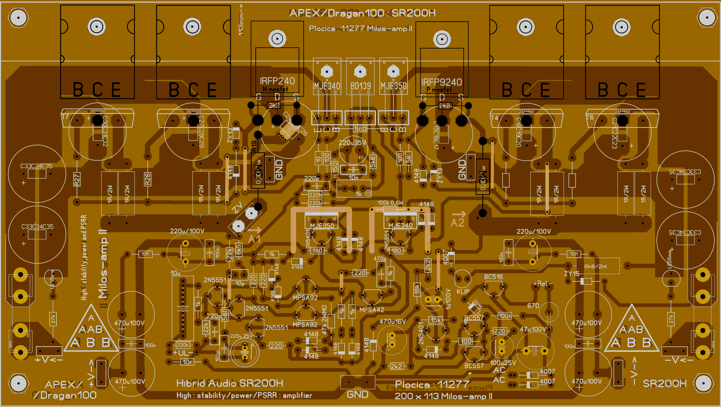

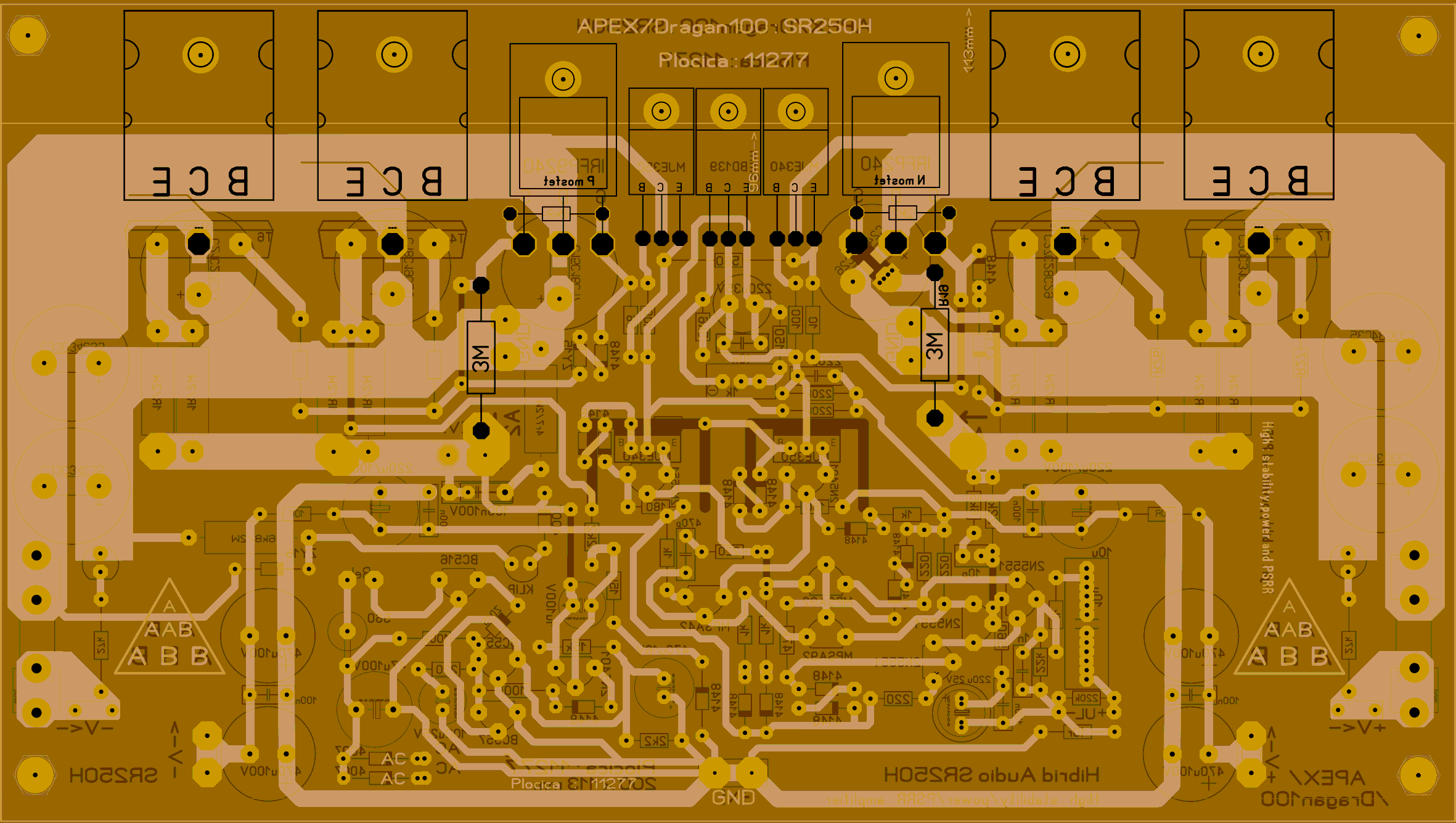

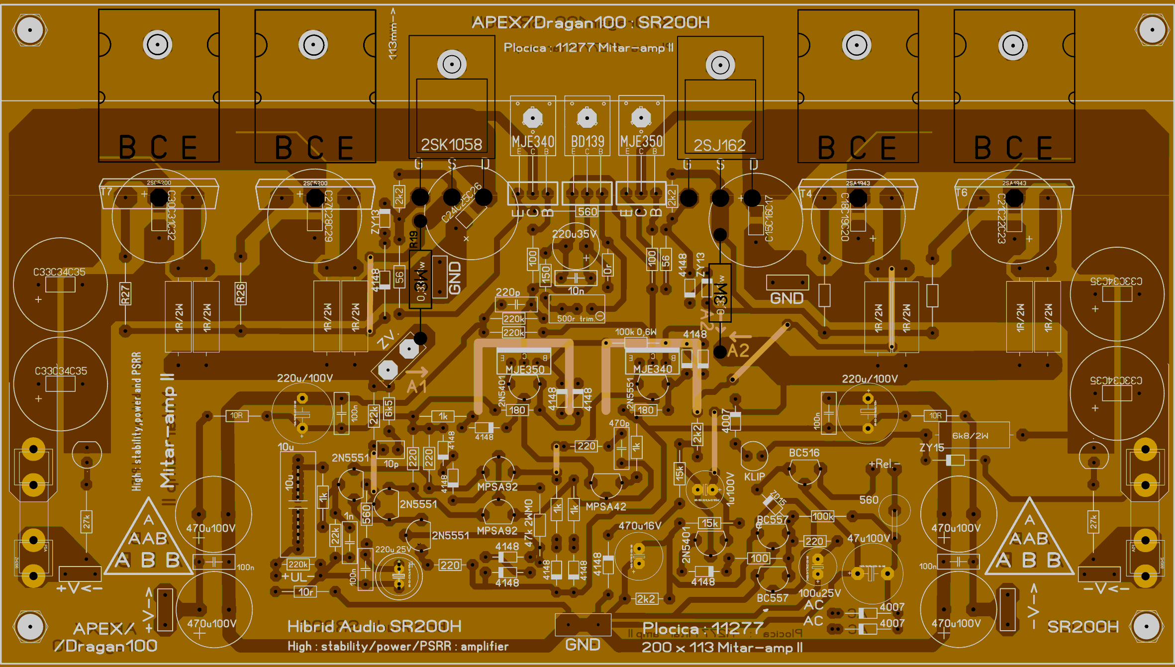

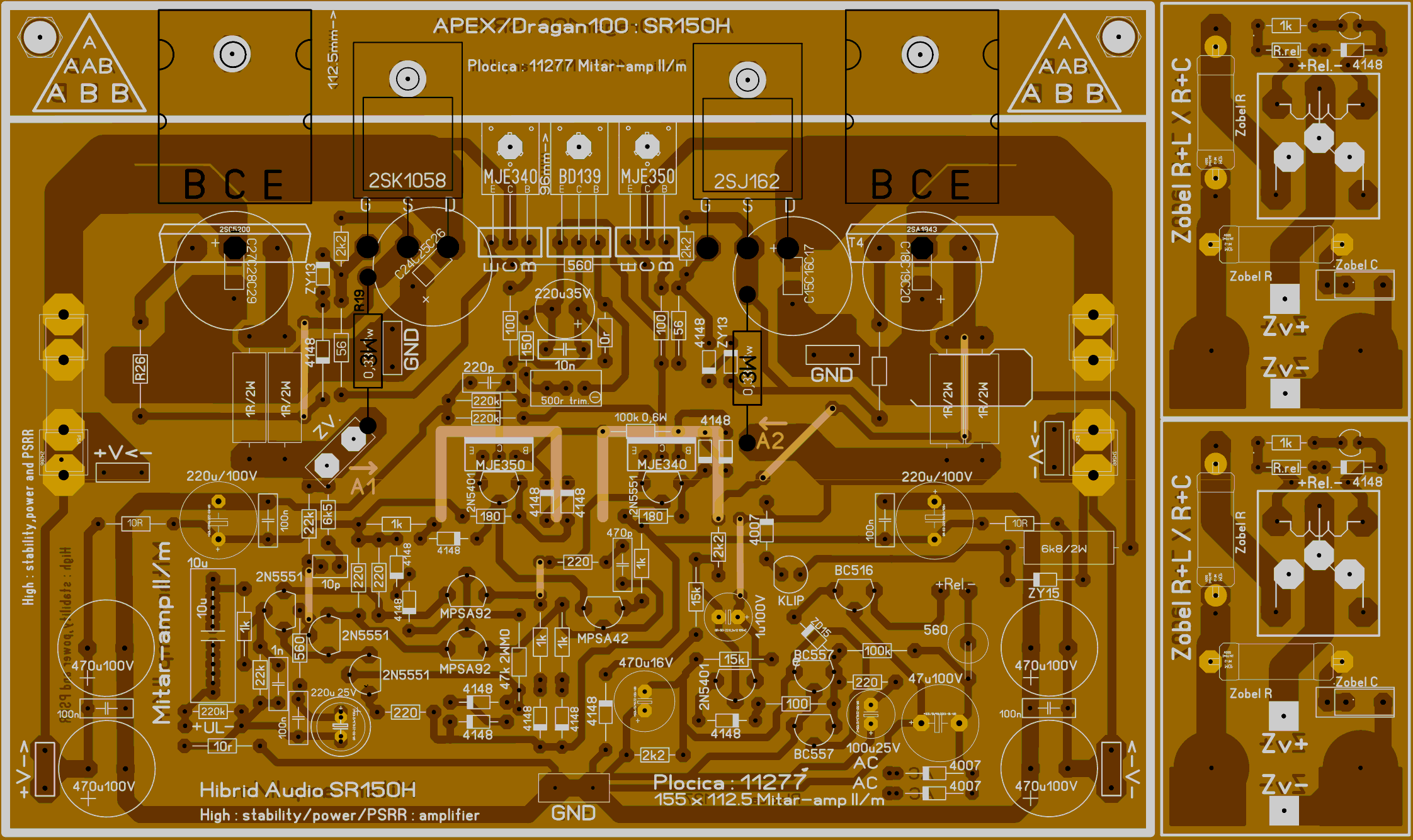

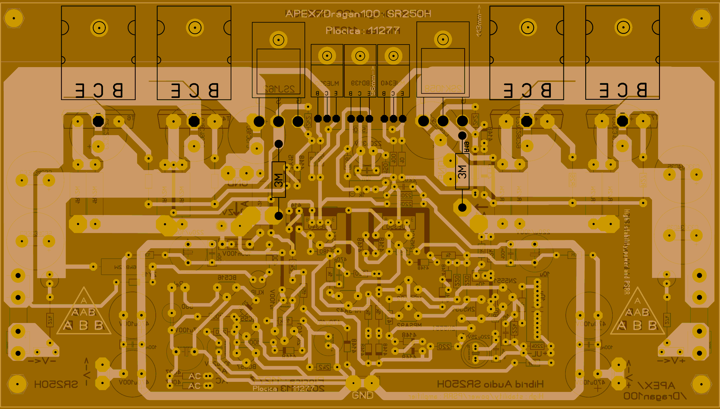

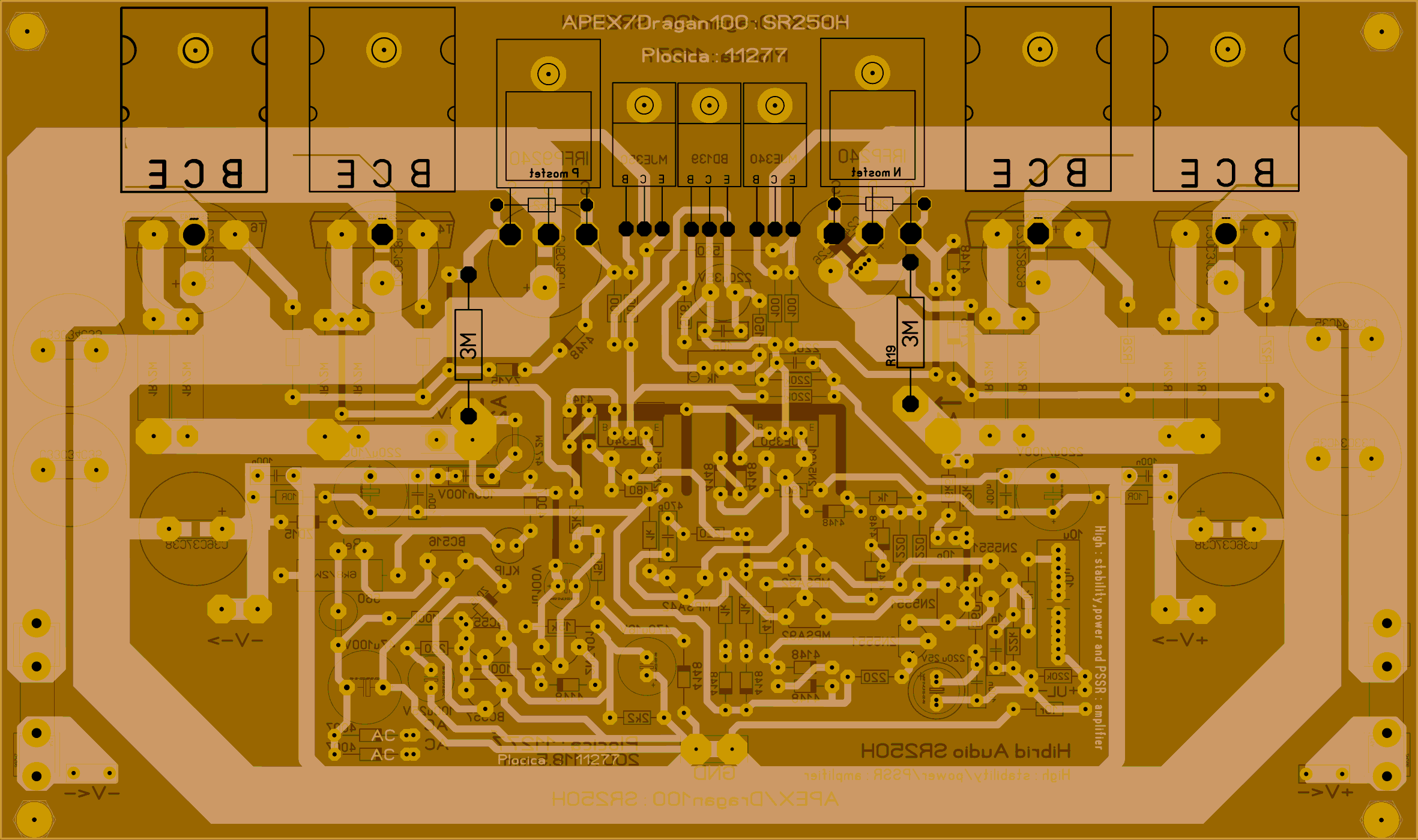

first one to be checked will be lateral version with one pair of BJT in output,this should be latest files. when i become sure i will post other files:
PCB??
thanks
regard

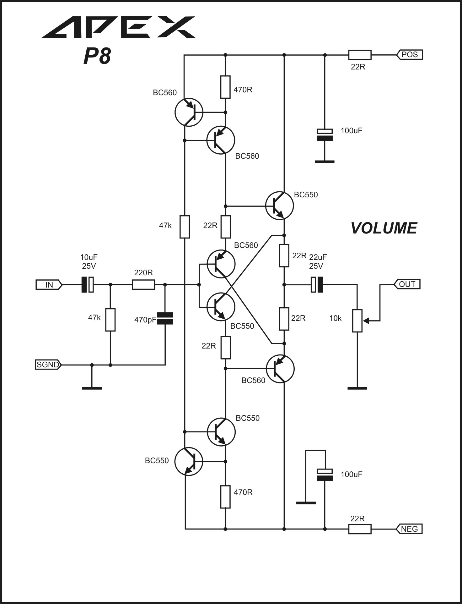

Does someone build this project??? where is post/threads, i want to try this.Preamp or headphone amp.
thanks
regard

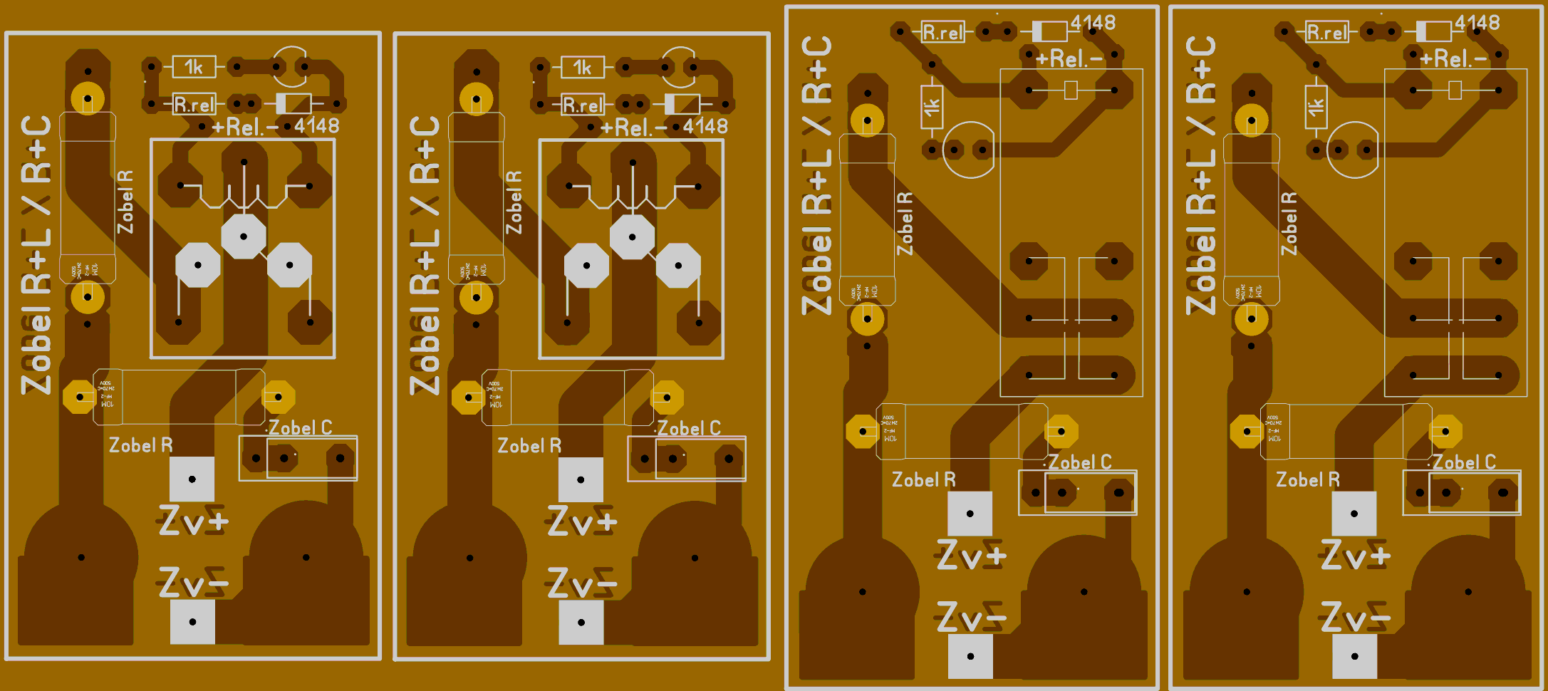

You're welcome, Mile.

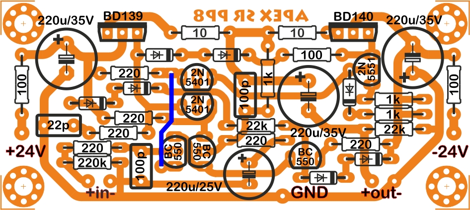

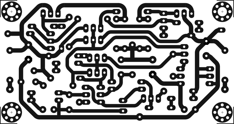

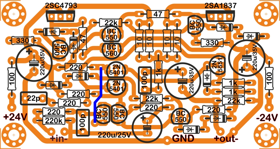

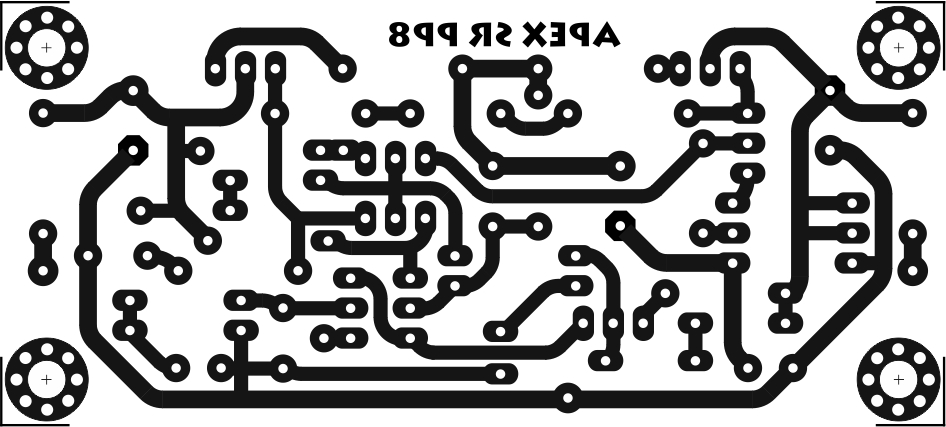

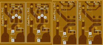

I'm not in position to build anything, so I spend my free time drawing pcbs.
Hi dobrivoje, beautiful work!You're welcome, Mile.

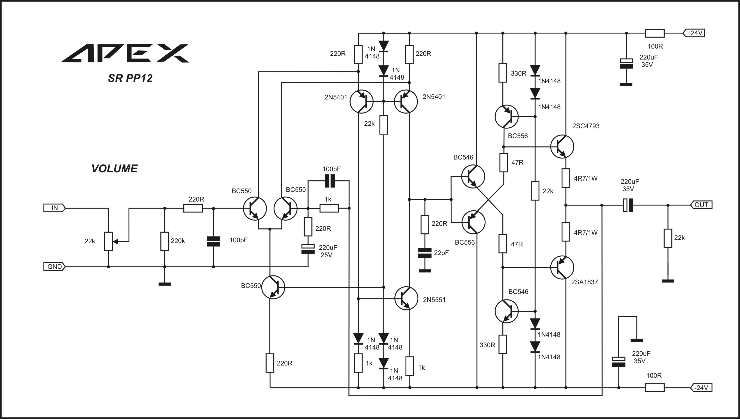

Can you draw a pcb for this Apex buffer? Many Apex amplifiers can be used with this.
