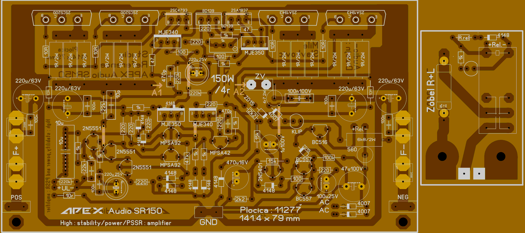

hi, i decide to make sr 150 confirm.please tell is everything ok in your pcb?tell more about sound quality and give me advice and any kind of trouble.i am asking because i will make sr150 on your pcb.thank you for sharing.GIF , pdf and sprint-file:

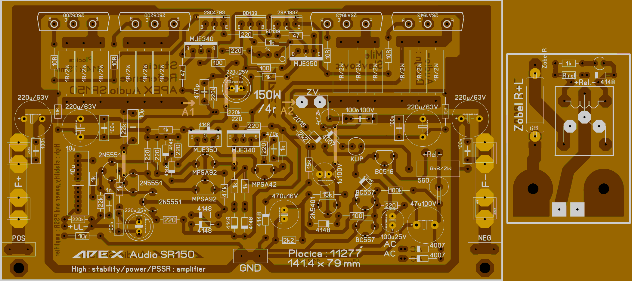

those are the latest files,and an amplifier on video works on them. all changes i have done to make it work (values from two resistors on amplifier stage,and one in protect stage) were assigned on schematics. PDF of top layout and copper side are latest,feel free to make your amp on them.
only thing that might be different in your case is 560r 2W in series with relay coil and value of that resistor actually depends on coil resistance. my relay coil resistance is 400 Ohm and with 560r 2W i have about 15V on relay and i will not change it. yes it is a bit more than 12V but relay is not getting to warm and i believe that i have a better contact in it.
it works really nice in all sound ranges,and even with 3,3uF elco instead 10uF block on input it goes really deep on bass - i am nicely surprised!

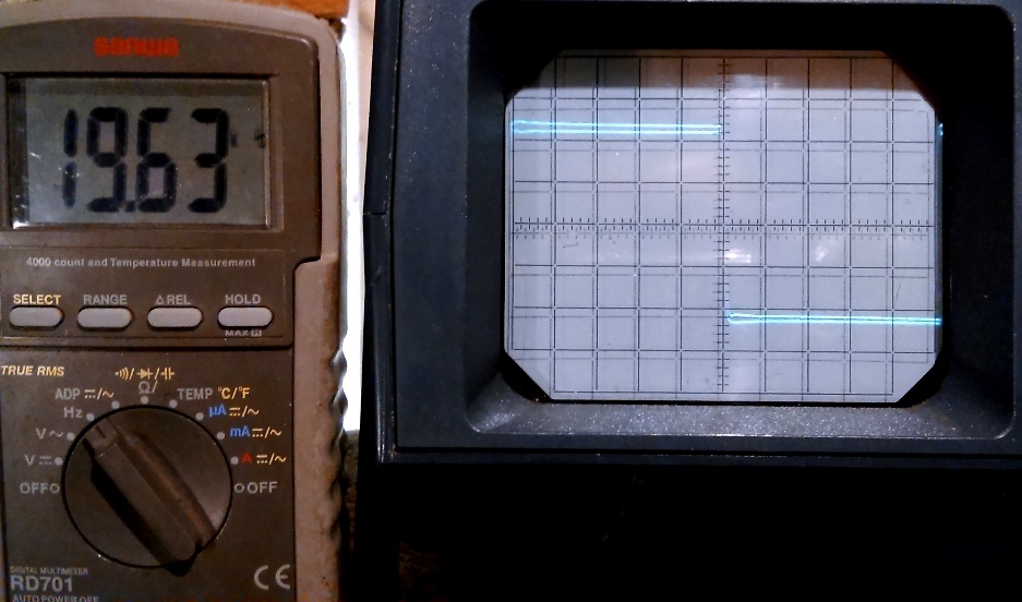

LME49830 Hybrid by 44250 square wave at input 19,5KHz,
output 8R//470nF
oscillogram in attachment: 5usec/div, 10V/div
It is almost optimal dumped, with avarage SR but stil in the range of 70-80V/usec,
the BW is in the range of -0,5dB@4,5Hz and -0,5dB@375KHz
phase is almost linear in audio spektrum with +2,5°@20Hz and -3,6°@20KHz
@AndrewT:
You can find that the simetry of waveform at the output is very good with doose diferent R_gate resistors and equal Rgs.
Also the input sq.wave is already slightly not perfect, so look at output, it just follows that signal... 🙂
Regards
Dragan100

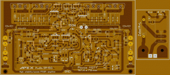

if you do an amplifier on my earlier files,you should pay attention on 2N5401 and his Hfe - it should be at least 250. is it enough you can check by measuring it´s Uce,it should be under 1V. if you don´t have it you can use another one,for example BC560C or BC516 but you must check pinout diference.
on files under this post there is PCB with BC516 placed instead 2N5401,and here is a part list for that version:
