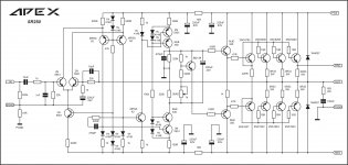

Studio Reference Amplifier
SR30

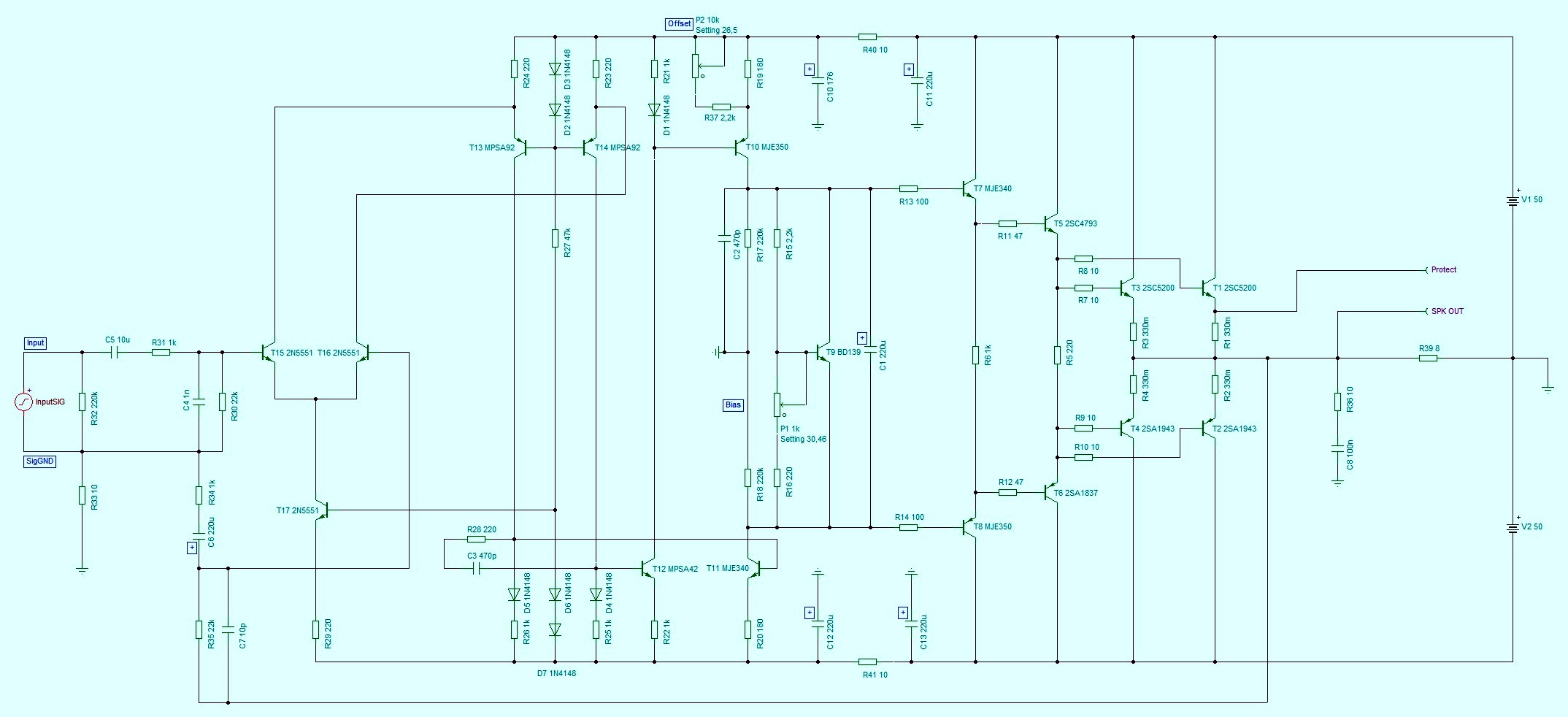

SR30 schematic

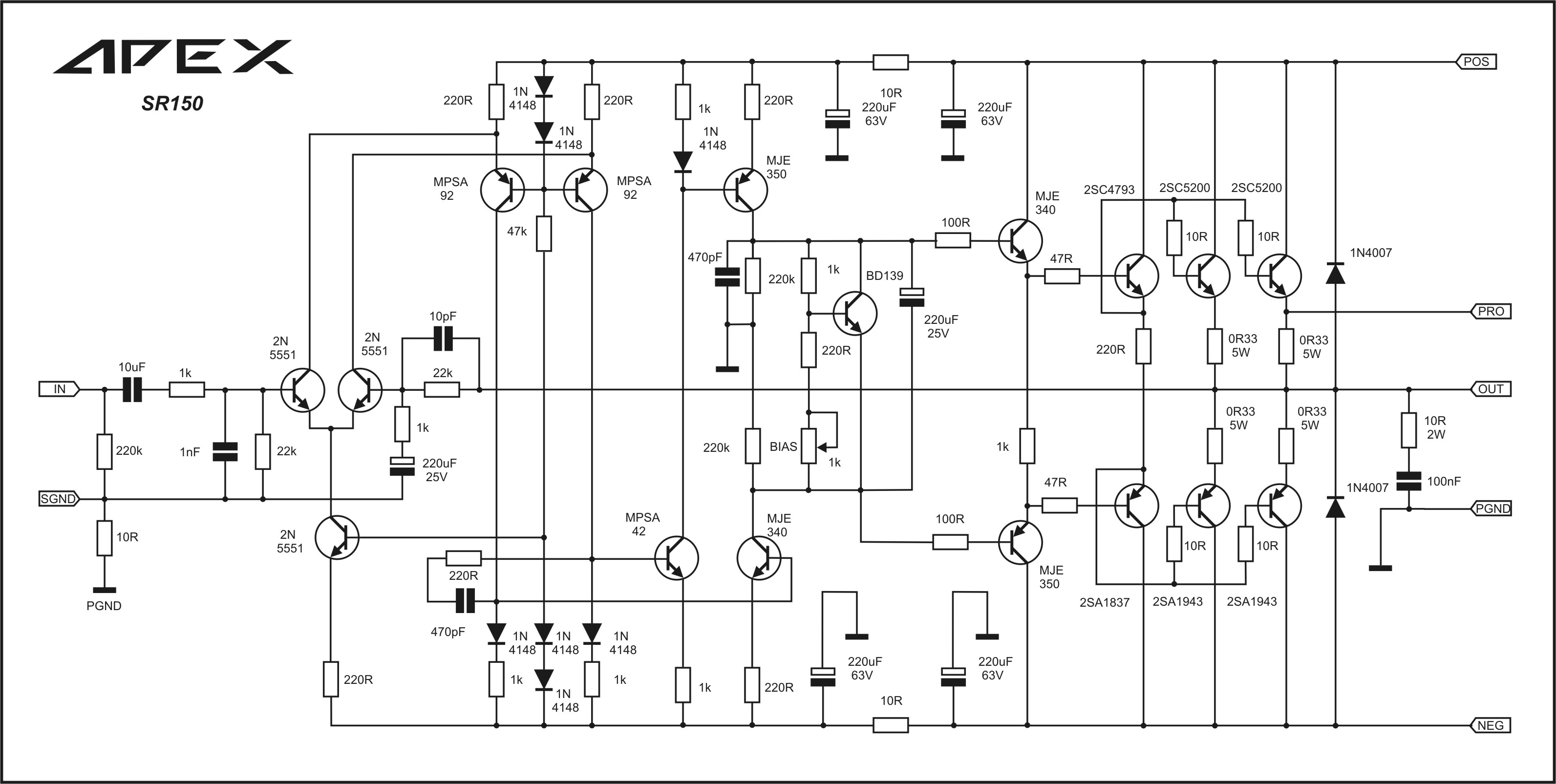

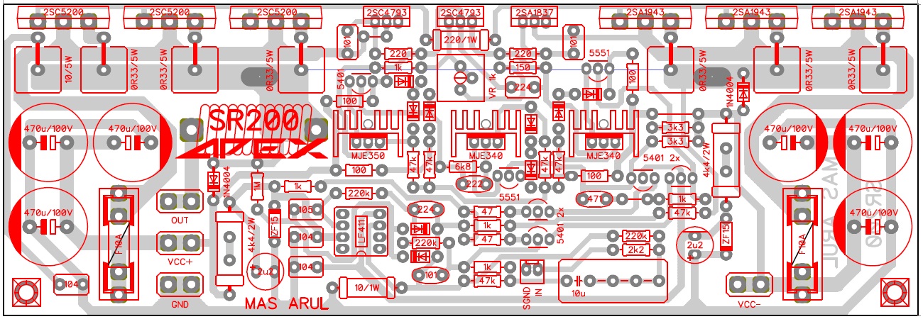

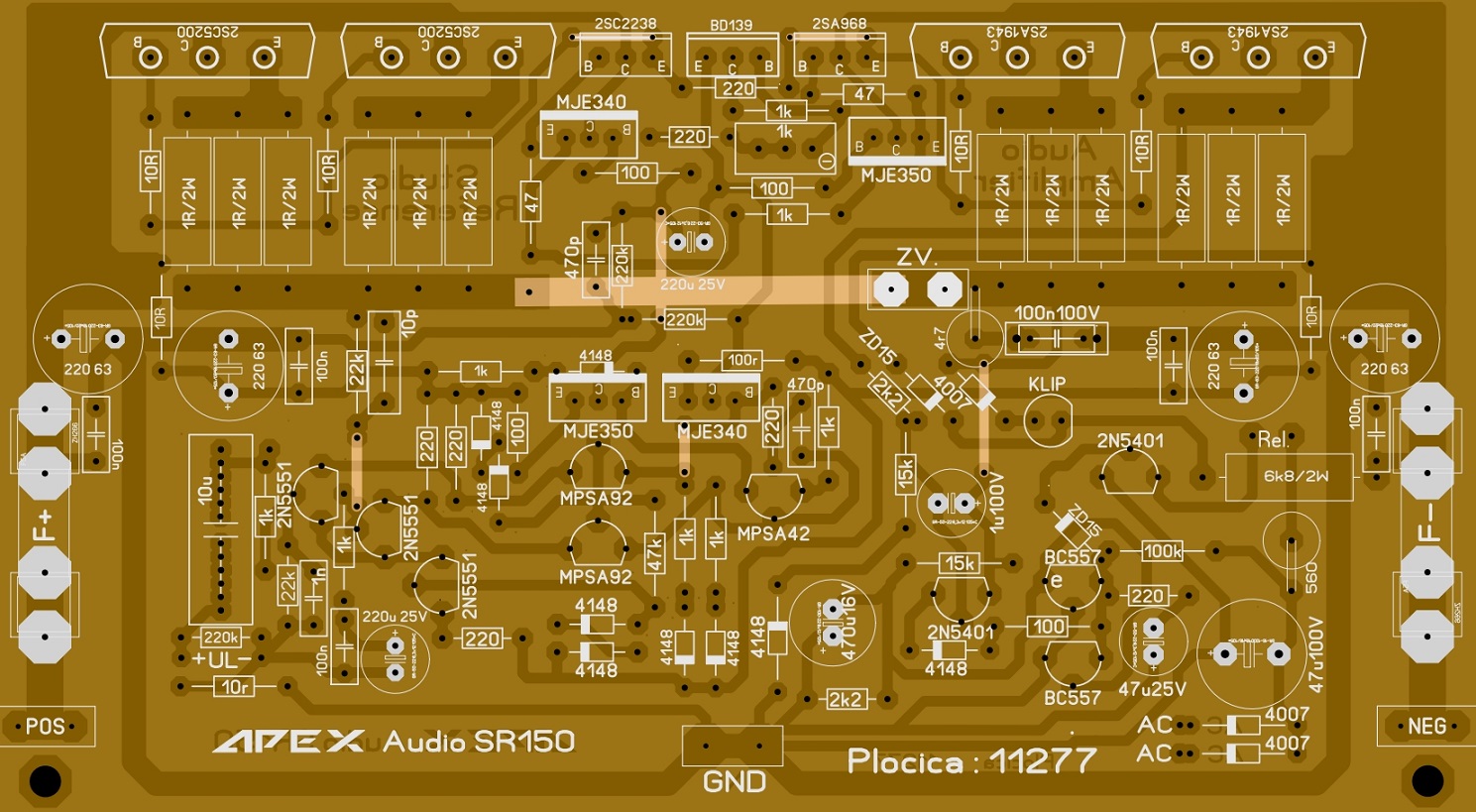

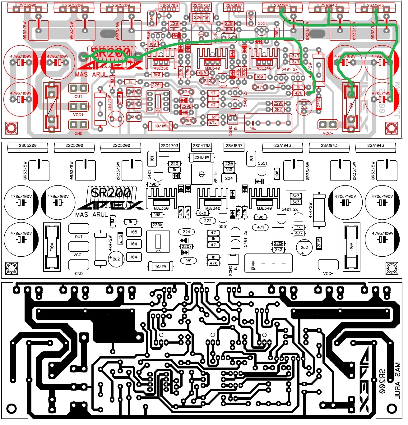

.....at first look missing resistor paraleled with output coil , RC from output to ground (10/3w + 100 nF/250V) and feedback trace must be connected to coil and so on :magnify: ..... heat sink to small ,better use SK104.
Regards,Alex

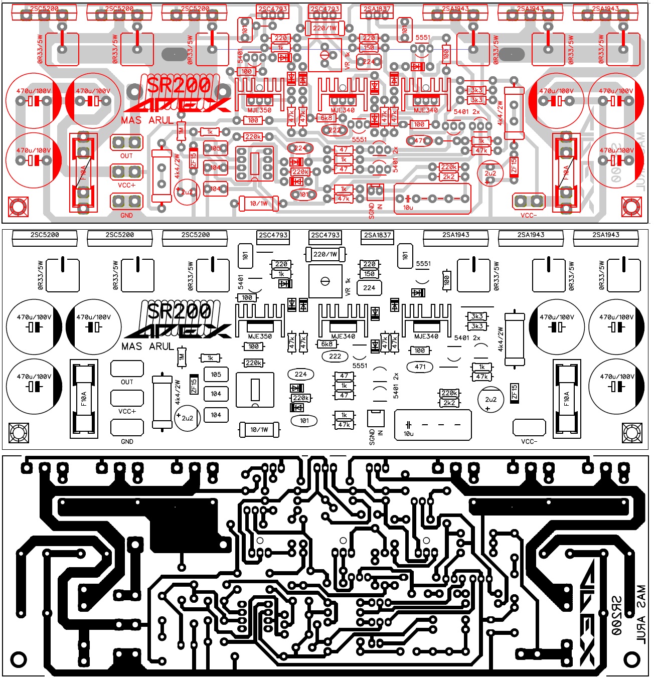

tanks sir.
corection again.
