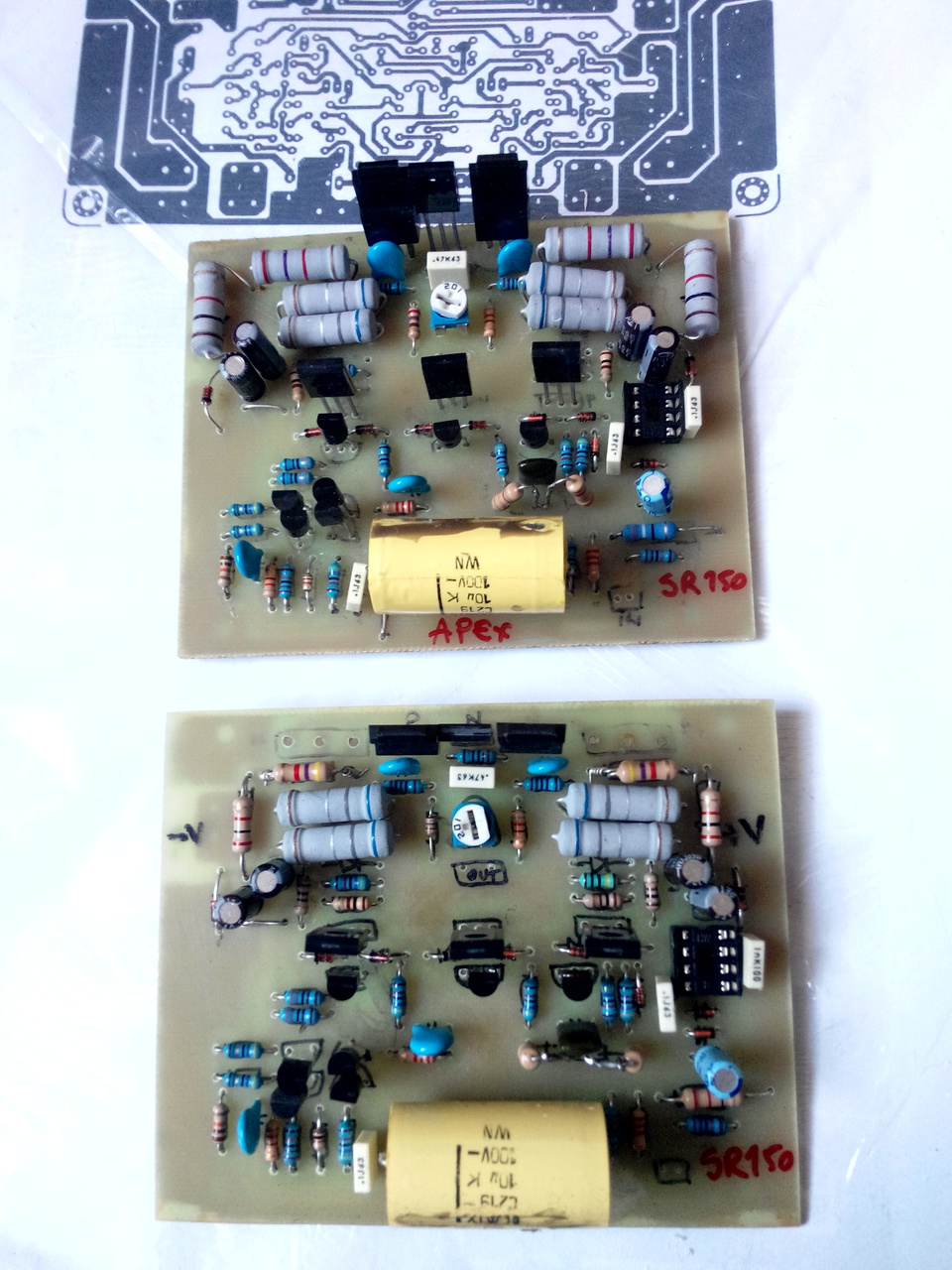

hi apex sir,i am trying to match hfe of all transistor of sr 150.sir what is proper bias current of sr 150 with good heat sink ? if i get some mv on output can i set this by this 1 k pot? thanks.
1 k pot is for bias (set 25-50mA per pair) if you want set dc offset you must add pot (schematic from post #1788)

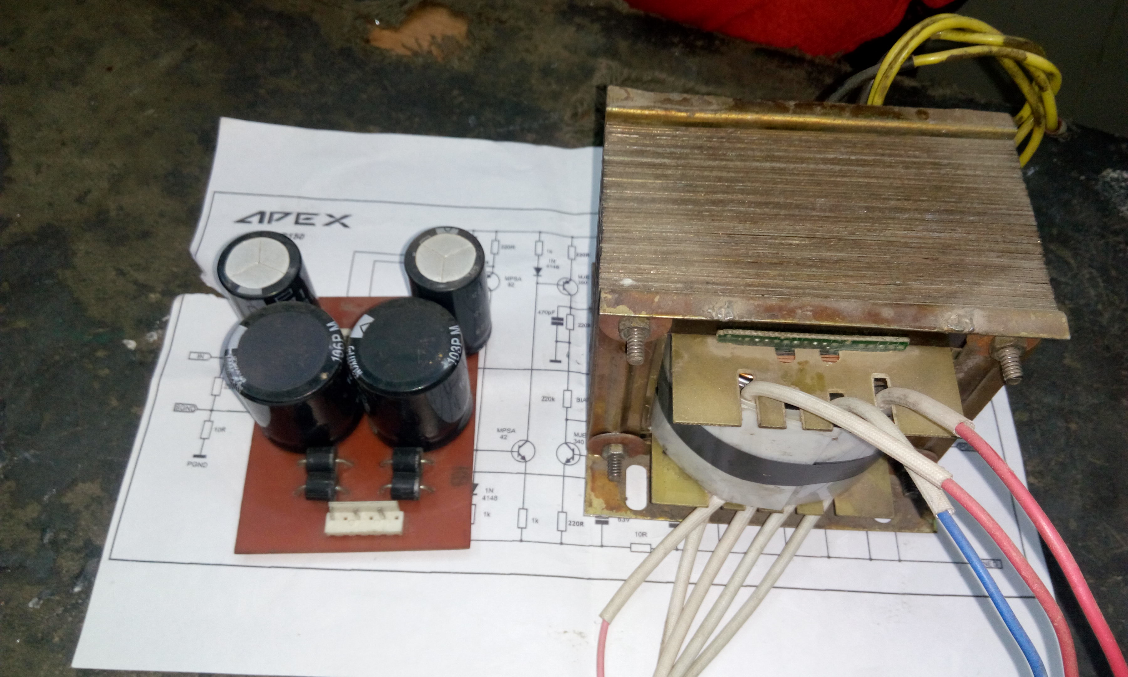

Can you help me with pcb for apex pro stereo? First one of the 3 picture you add . Or maybe let me know the address where can I find it. For 24V relay if it's posible 😱😕my SR150 works with 2x35Vac transformer,and that is a voltage that you connect to AC/AC on left/bottom side of pcb. AC/AC are connectors to supply protection circuite. you have a schematics of protection circuite in a post where i posted that pcb,instead 2N5401 better use BC516 (reversed pinout!!!),there is also an explanation how to chose resistor 560r,depending on your relay coil resistance.

i have output simetry of 5mV and 23mV on my SR150 left/right channel without any matching hfe. bias is 50mA per pair (100mA total for one channel).

BTW, I have done 2 modules of sr150, simple, but didn't tested yet.

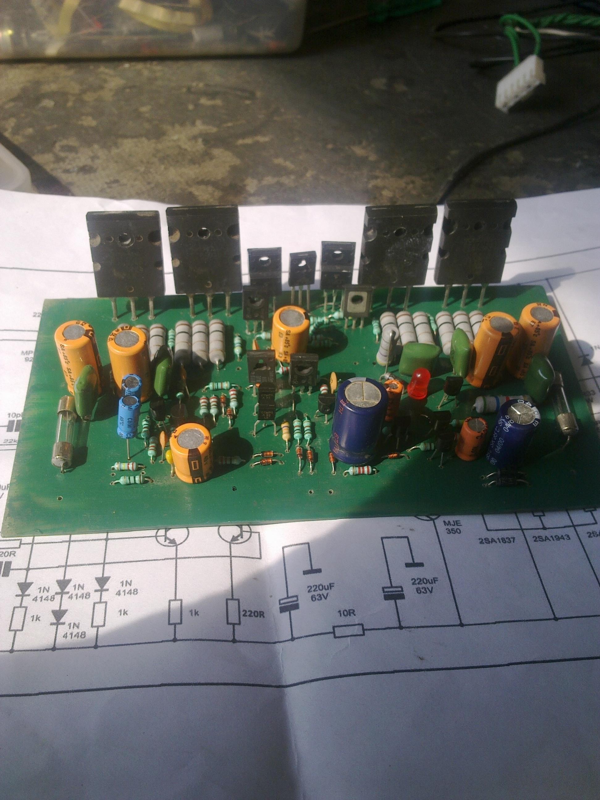

hi to all, almost complete. i have to attach heat sink only .which value good for zobel 4r7 or 10r? in pcb it is 4r7 2w.thanks
Nice work, 4R7/2W is ok
Regards
Bais is Set over emiter resistors..this can be 20mv or more..a different way is current setting, remove the Plus rail fuse and place your Meter across in current mode and Set to 100ma..no load or Signal next wait till amp is warmed then reset..
hi sir, i have some problem with my amp.my dc off set is -8mv and bias is minimum 140ma with 1k .is this ok? no doubt sound is great and good at even high frequency.thanks.😎
It is OK

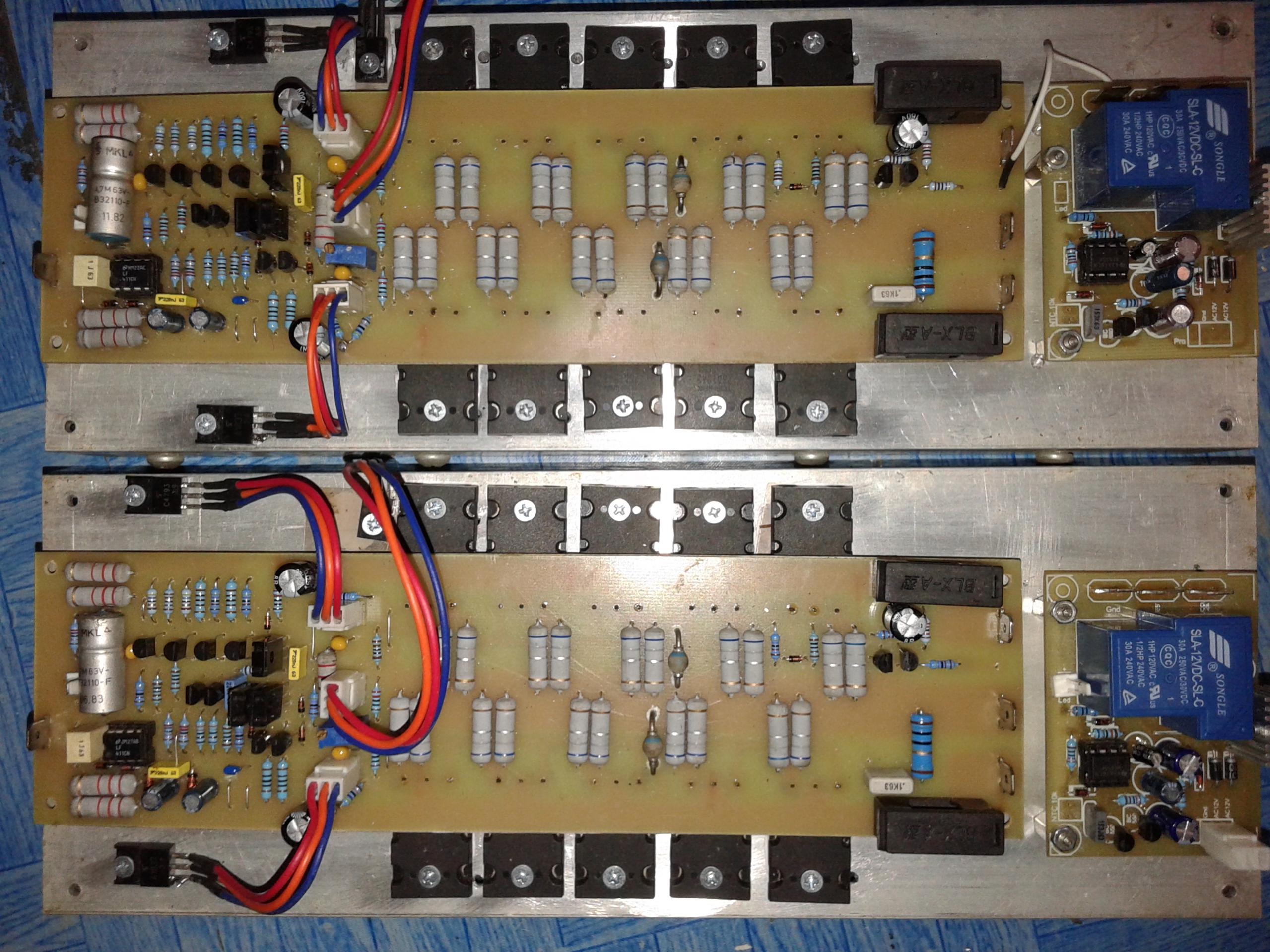

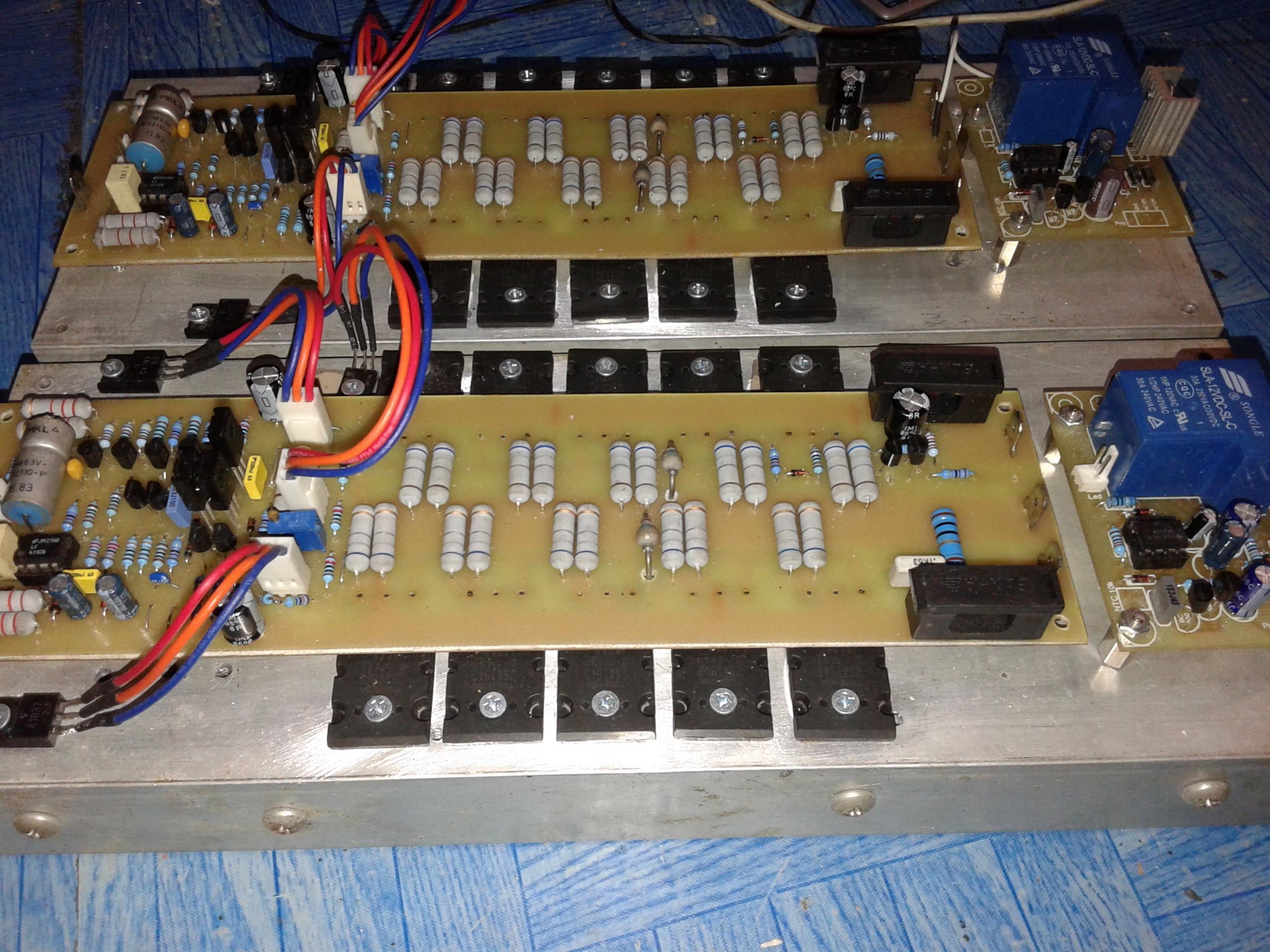

hi ,i check everything before start my sr 150 on 44250 pcb.sr 150 working good but there is some little mistakes on protection layout in first version with 2n 5401 not working good and you made another layout with change of some resistance and bc 546 but connection is wrong because it is cbe and it is npn but 5401 is pnp.i fix it and use bc 557 and it didn't give any headache to me.i like protection circuit it is very fast and i like mini relay i also got 15 vdc on relay then i add a 12v zinor diode on relay. thanks to apex audio and 44250 for giving us beautiful amp.
hi sir ,today i test my amp for 2 hour and find that one mje 340 and mje350 are hot other all transistor are normal.even mje are in series with 10 r and 220 r from +-55 v.they need heat sink but not small.other mje pair is cool.is it normal?i need your suggest.
MJE340/350 in VAS work in class A and need heatsink, it's normal
Regards
no need for zener diode on relay, it will work well with that voltage on it. thank you for pointing me to a mistake i did with labeling BC transistors, i will correct it on lay document.
