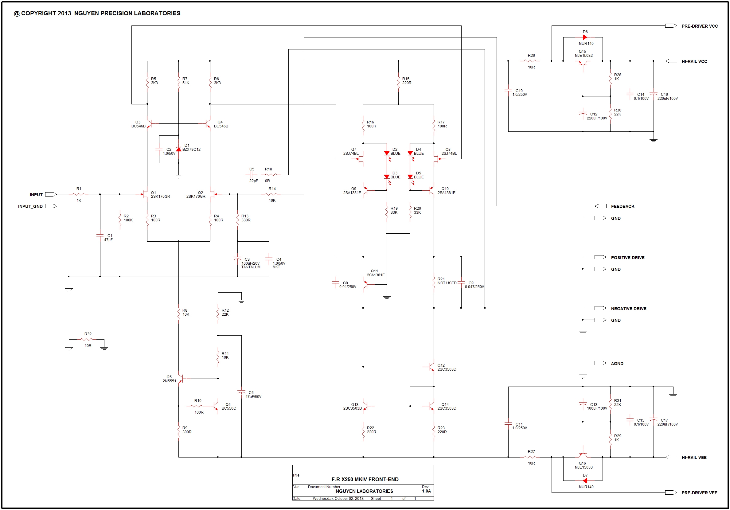

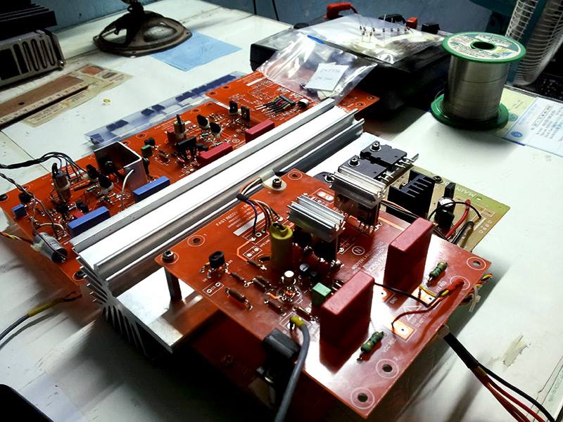

I'm attach my amp, X250MkIV with cascoded IPS & VAS by JFET.
The lasted schematic like this pic, but Vas's current mirror is compensation transistor type (sorry, i'm using a computer which can't get the picture).
The sound is very good, more than my Goldmund clone, very clear...
I can't use LTSpice to simulation this schema. I want know THD, SR. Any one can help me and suggest me for this amp to better?

Should start your own thread first.
LTSpice is strangely in my country, mainly are OrCAD & Multisim. I've used multisim and feel it is not good. I don't know, i'm trying to learn use LTSpice.
//However, the amp in real life is very good, one of my best in current.
SR100 & SR200 can use tantalum caps in input & feedback. This's can get better sound. I used Vishay 150D 10uF & 100uF/20V paralled with 1uF MKT caps.
