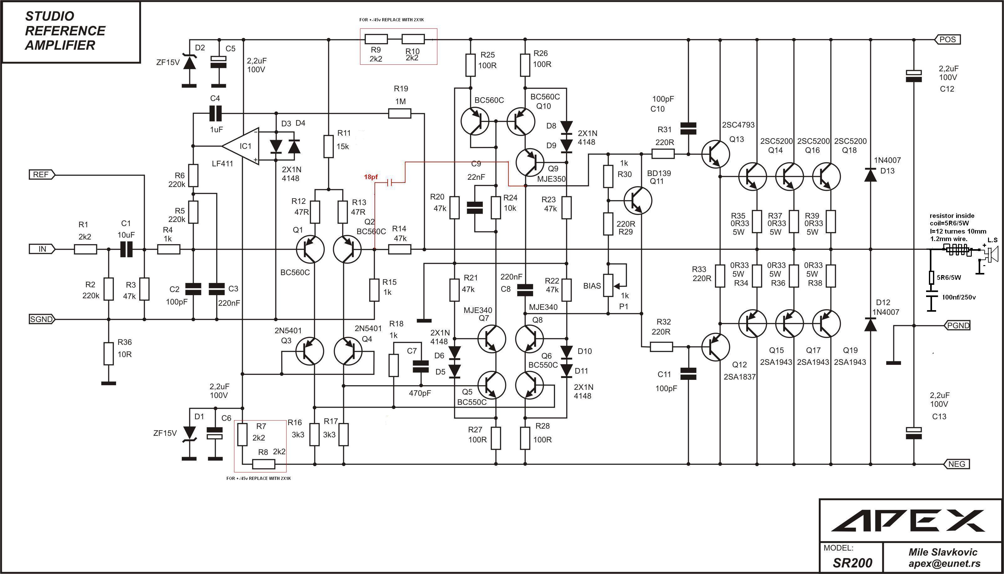

And this schematic will be ok.
In schematic, V reference of Vas's cascoded by ~ 1.2V (1N4148 x 2).
Q5 (Q6) have 0.6V Vce for 5mA Iq (per side)? It's ok?!
How to choose voltage cascode reference? I usually see about 4 ~ 5V in many schematic.
It can be lower since its not terminated to the negative rail but to the emitter of the transistor instead (Hawksford 'Enhanced' cascode), some argue that this is a 'better' way to cascode the VAS/TIS.

If you have technical evidence that the transistors works well with Vce=0.6V then go ahead.In schematic, V reference of Vas's cascoded by ~ 1.2V (1N4148 x 2).
Personally I would go for 2Vce to 10Vce as a guess at what might allow the transistor to perform well.
If Iq of Q5 (Q6) is very high, 0.6V Vce is ok. They're near the saturation.
Datasheet don't show Vce/Ic characteristics.
I agree with AndrewT, 2 ~ 10V Vce for work well. Personally i choose 5V by 2 LED in series.

http://www.essex.ac.uk/csee/research/audio_lab/malcolmspubdocs/J10%20Enhanced%20cascode.pdf
In figure 9. Hawksford seems to use a single Green LED for Bias Voltage.

The kind of current mirror used in Dado's GainWire has the lowest THD. It is important to have cascode AND base current recirculation like a Baxandall mirror. Not unlike what Edmund Stuart uses in his SuperTIS.
Amplifiers with separate PSU for VAS with about 10V higher rail voltage than output stage can use 4~5V cascode reference voltage but with common PSU clip level will be lower.
Using amp with 60Vpk(out) at full load, with IPS, VAS and OPS on same rail voltages.
With values of 5-10V for cascoding, if I'm correct that can mean amplifier can clip 30-65W lower than without cascode.
I personally won't think of doing this beyond 3V.

What's about current mirror? Cascoded current mirror will loss more a few volt at output. I'm used Wilson improved current mirror and i have seen this problem.

Hi Joeyt, no you can'tcan i use 63v with these capacitors, 470pf,220nf,100pf and 22nf?
470pF & 220nF will fine but 100pF & 22nF at least 160v. I use 100pF/500v & 22nF/250v

could you explain why?........but 100pF & 22nF at least 160v.........
because I measure voltage across it...could you explain why?
if the rail is +/-75VDC (max as Apex suggestion) then on this cap will be almost 150VDC
also the parallel 10k resistor will be hot, use at least 2w.
