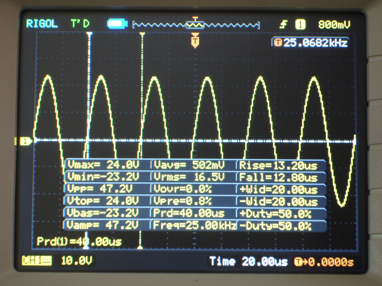

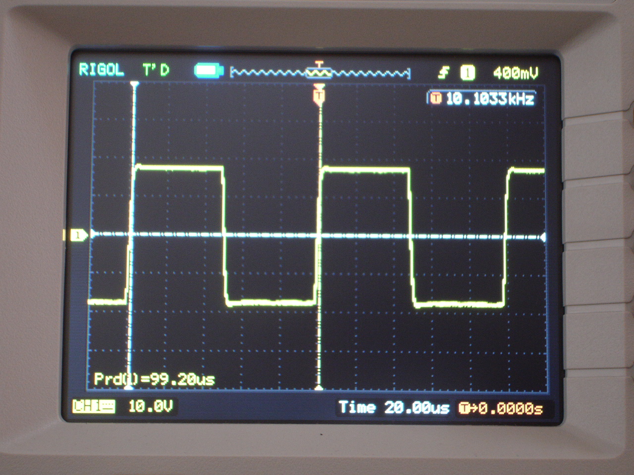

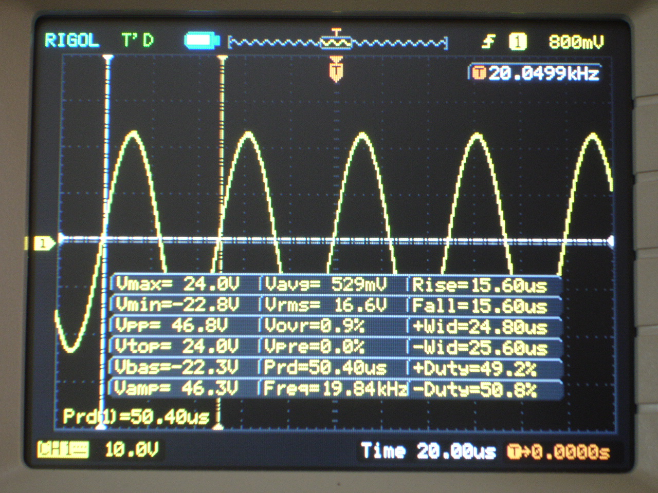

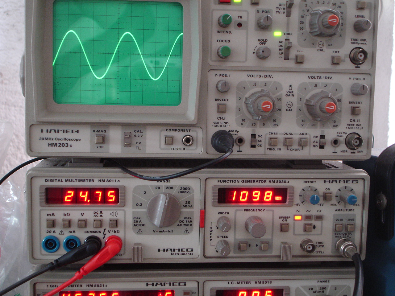

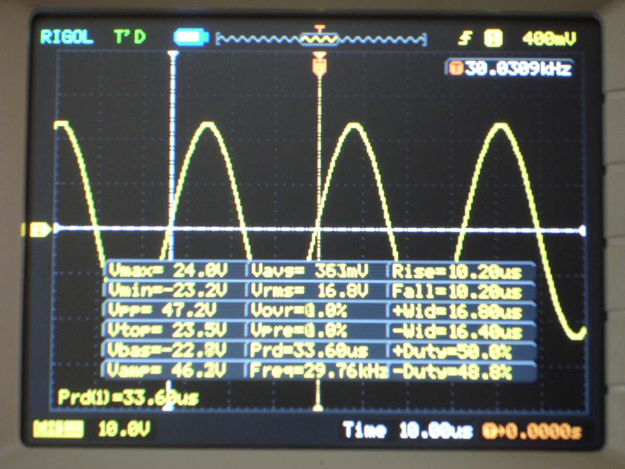

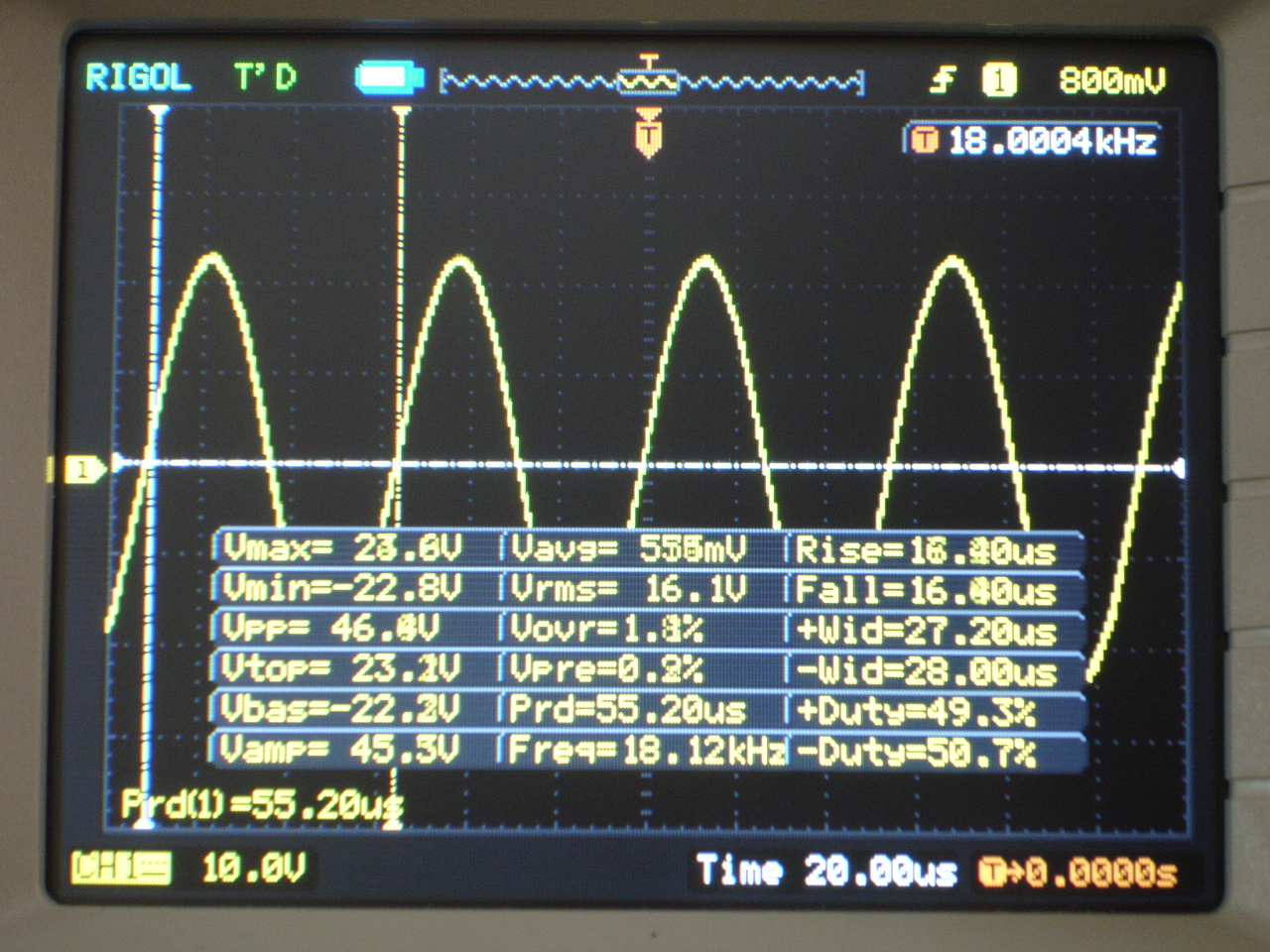

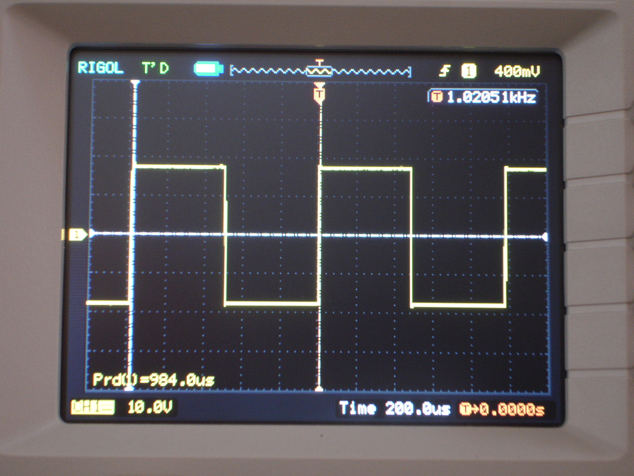

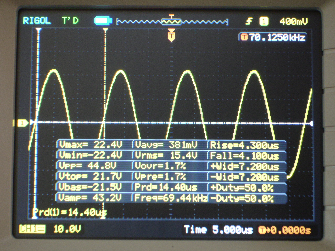

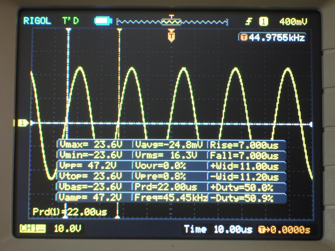

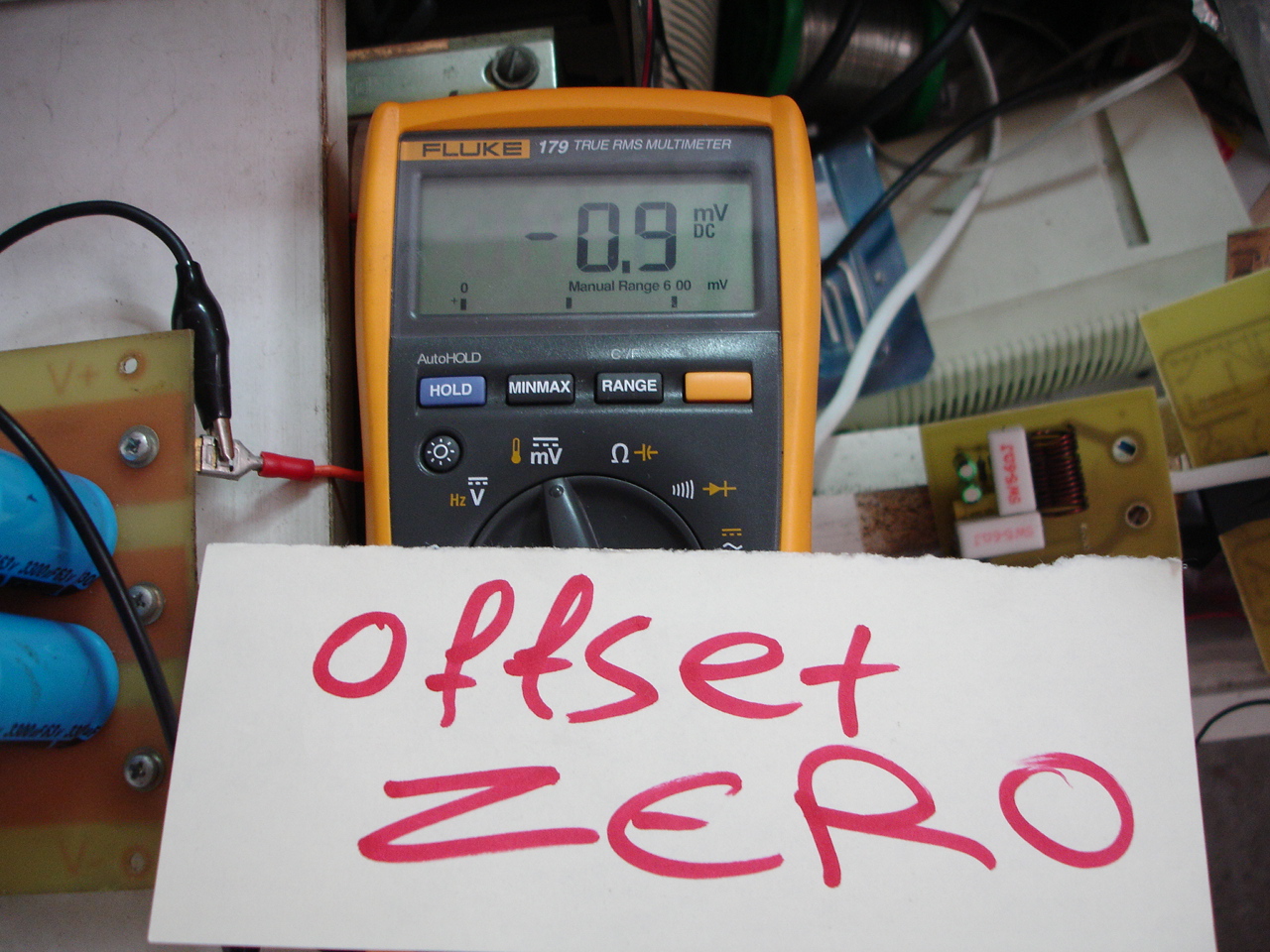

All tests as follows
Usys.+/-45v
Cpsu.51.000uf/rail.
out.transistors 2x2sc3264
2x2sa1295
idle current.45ma(25mv on 0.33R)
Vinp. 570mvrms
Vout. 24.6VRMS
Rload 8R
Finaly 3 other photos
1) 1KHz behind zobel
2) 1KHz after zobel
3) 10KHz behind zobel
4) 10KHz after zobel.
5) zero offset.
6)570mv inp ,24v out just pehind cliping

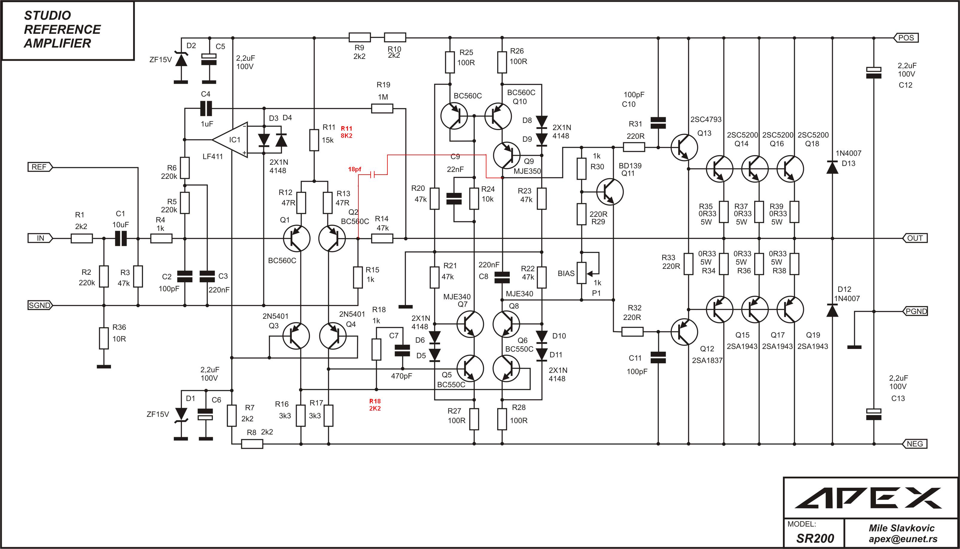

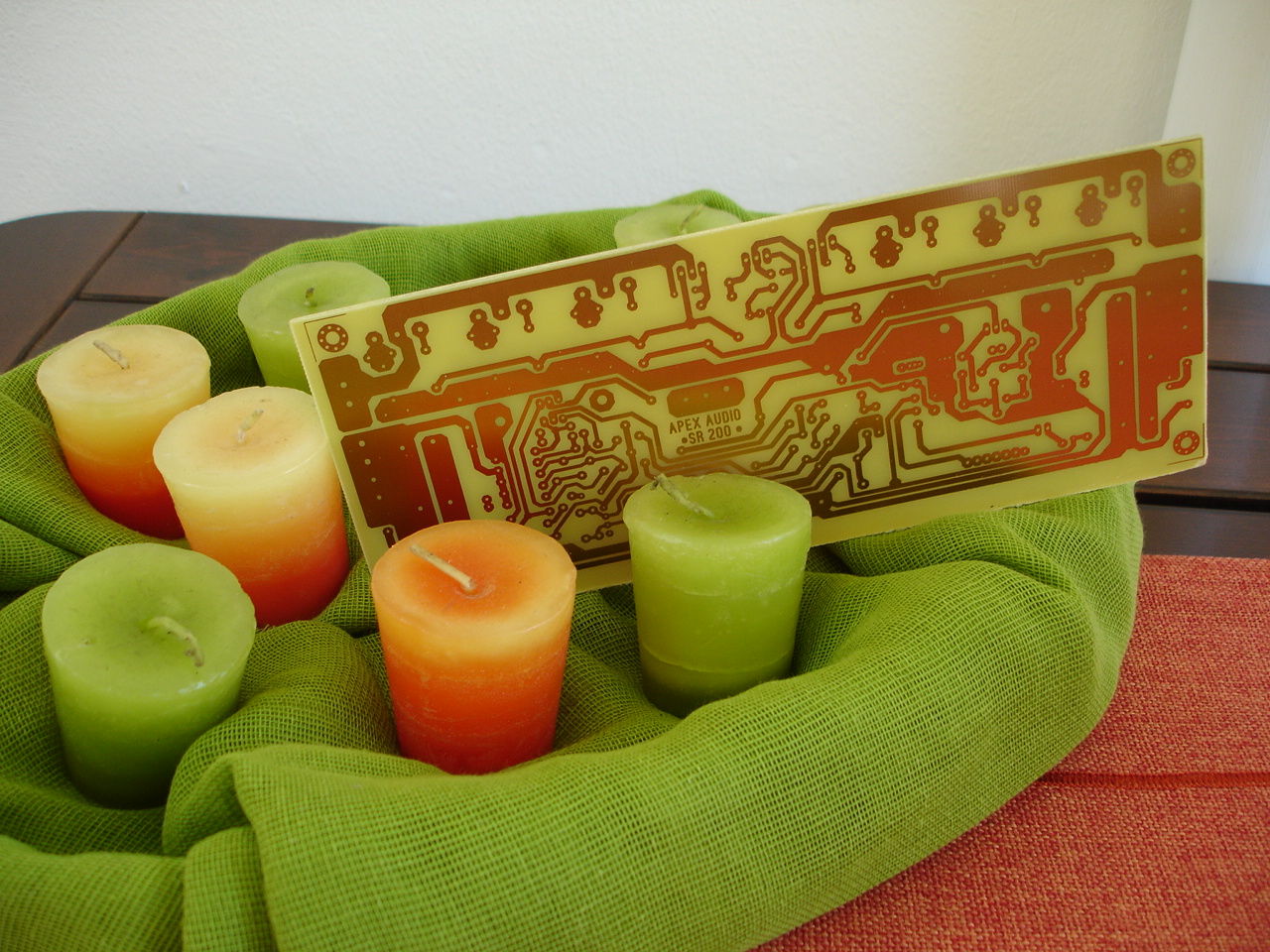

Thanks to 'alex mm' for pcb design and what is your final circuit?
Apex sr 200 studio referance.
Thank you especially Mr.Alex mm.🙂
Without your's printed circuit board construction would be impossible.🙂
Mr Apex just missed my own question.
This time circuit is with R11=8K2
R18=2K2
added 18pf between collector Q9 base Q2
Theese all modifications.
Is it necessary to keep them all?
Regards.

It's ok and you must use heatsinks for MJE340/350.
Regards
Thim,
can you post your final schematic? Add notes on what values you changed to reach that success.
And finally what values did not work for your build.

Dear Adrew this is shematic last modified by Apex. Red values are the modifications.Thim,
Keep in mind that original schematic is functional also with a little problem an overshot
probably.

A romantic version of SR200😉
Good luck!
sr200 studio refer.
Thanks wiljj78A romantic version of SR200😉
Good luck!
sr200 studio refer.
Just as befits a reference amplifier.
Thanks Mr.
Very artistic picture of SR200 🙂
Thanks Mr.

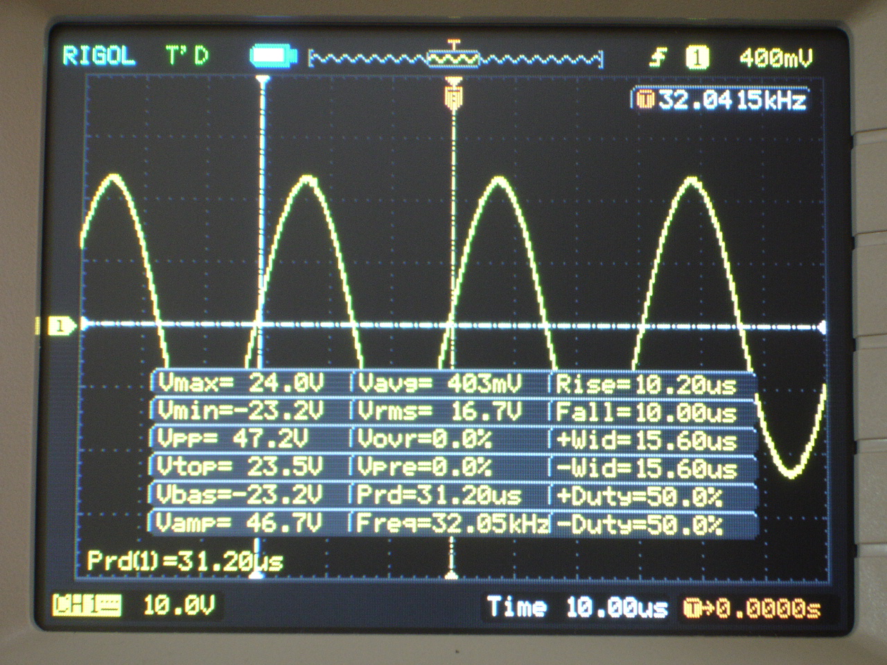

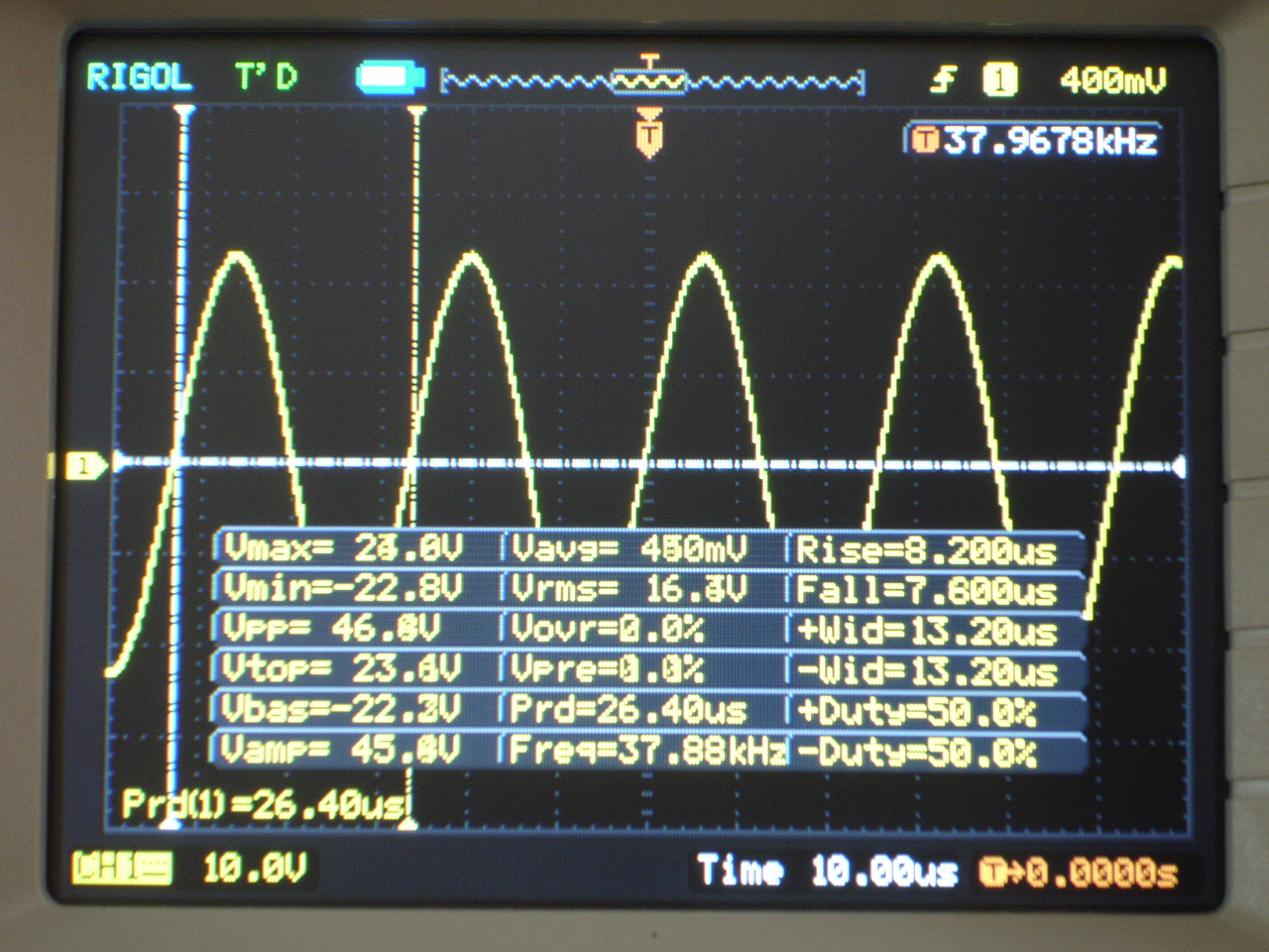

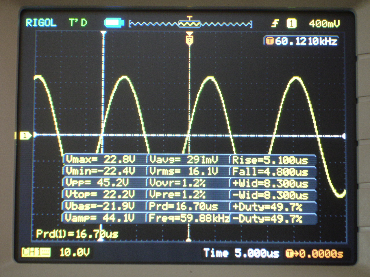

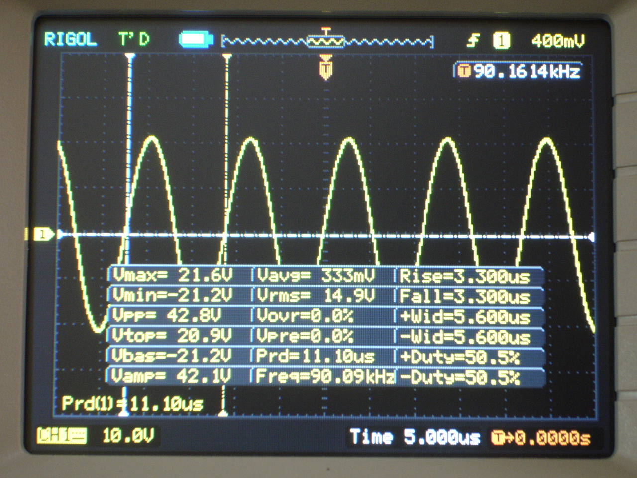

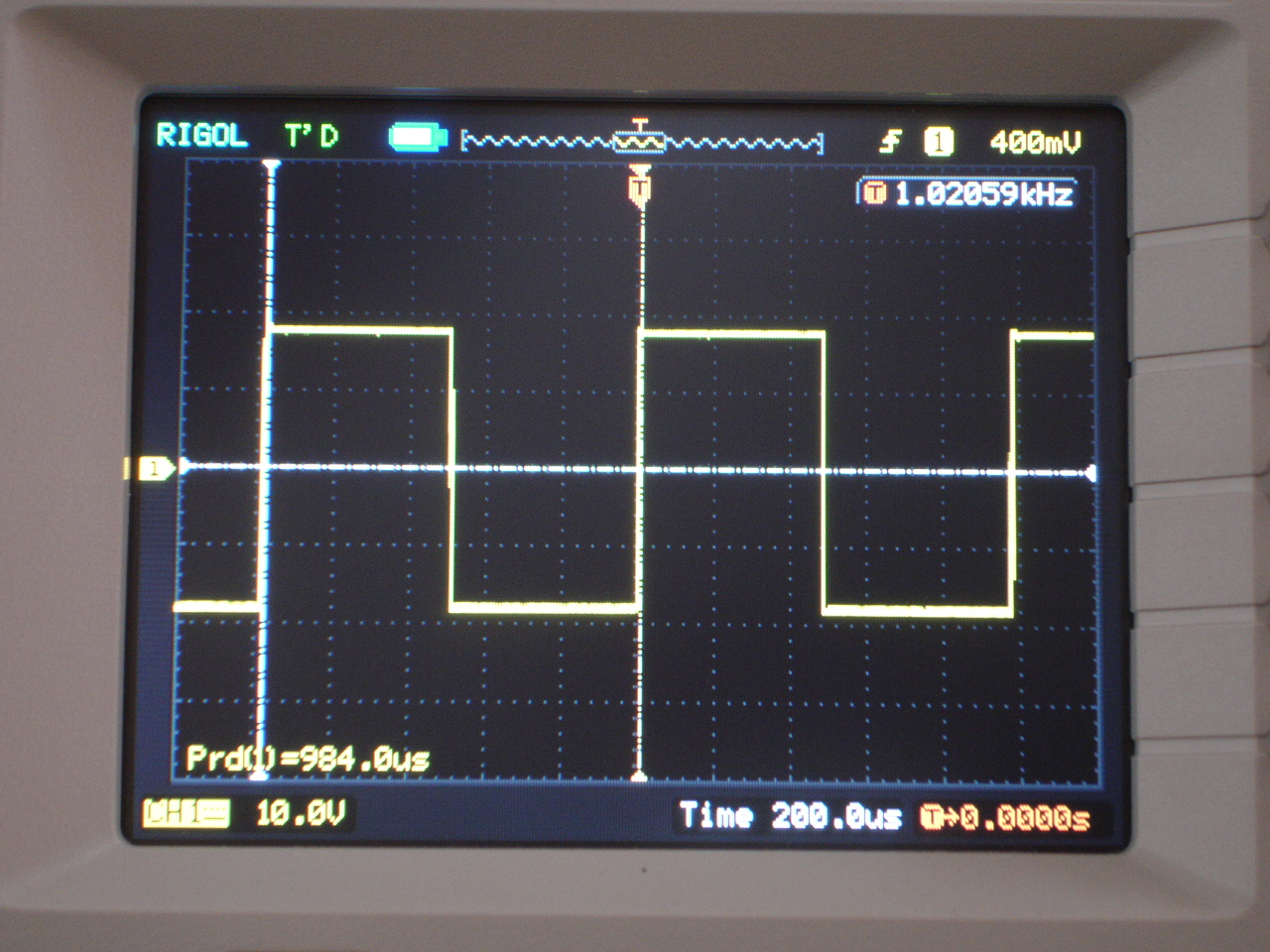

Hi Mr Apex.
I have made a zobel just with i had this time and test again.
first picture is for +/-35v rail 50mv on 0.33r idle current .
out.14vRMS/8R at 11Khz.Please take a look.
Second picture is under same conditions
+/-35v
1 pair 2sc5200/1943
50mv on 0.33
450mv inp./1khz just before start symetrical cliping
19vRMS out/8r
and the draft zobel

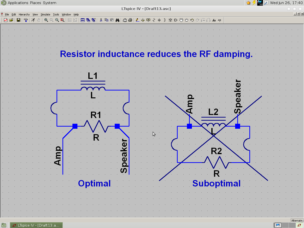

For an output zobel, you take the output/speaker leads from directly across the resistor, not the inductor. This is because the resistor needs to have as little series inductance as possible to increase damping at RF. Stray inductance of the inductor leads, as you may have guessed, does not matter. I would use carbon comp for this resistor if possible.
any chance to see a drawing of this
zobel..inductor...I dont understand what you are saying
(zobel cap/resistor is in parallel with output/speaker, and inductor/resistor would be in series)
sr200 studio refer.
Well i did not understand . In your diagrame Zobel is in parallel to the loudspeaker?
As you say non inductive resistors is the must for that circuits but if you haven't ?
