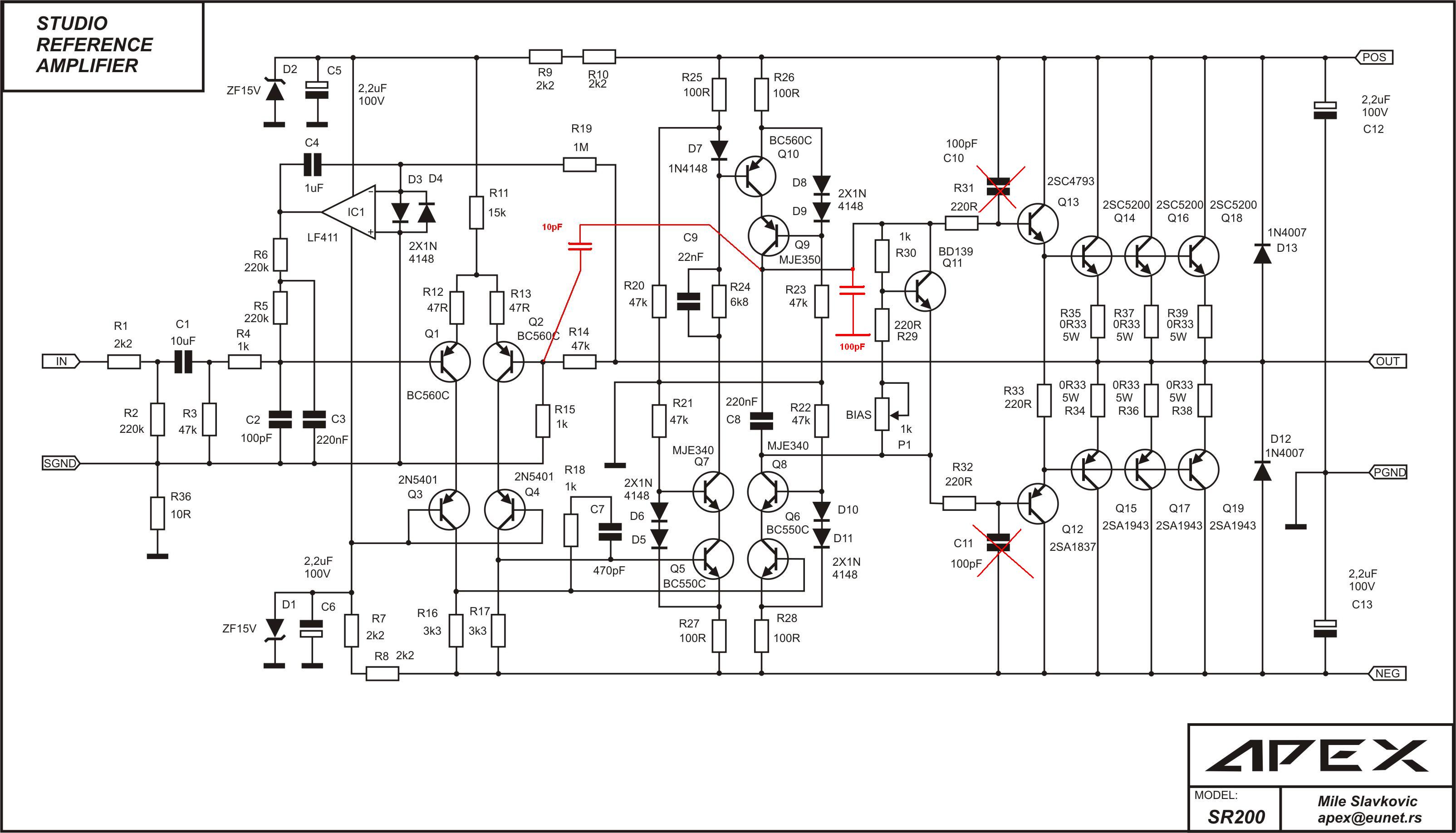

hi friend i see this about 100pf decapling at the input.

My SR200 is working perfectly after inclusion of the missing caps. My issue before is like what you are experiencing now if I remembered correctly I have smoking zobel and blown OP's.
I don't have a scope so I cannot check for any oscillations present in my amp now but it's a working amp and I don't have any problem with it, no smoking no burned components and it's singing pleasantly into my ears 🙂. Surely you will find what is troubling you.
Actually I printed the schematics and the PCB layout you choose, I'm checking it right now but I cannot find any errors...check for resistors wrong value, PCB tracks short circuit (I reckon the signal track width which might picking up signal from the power line).

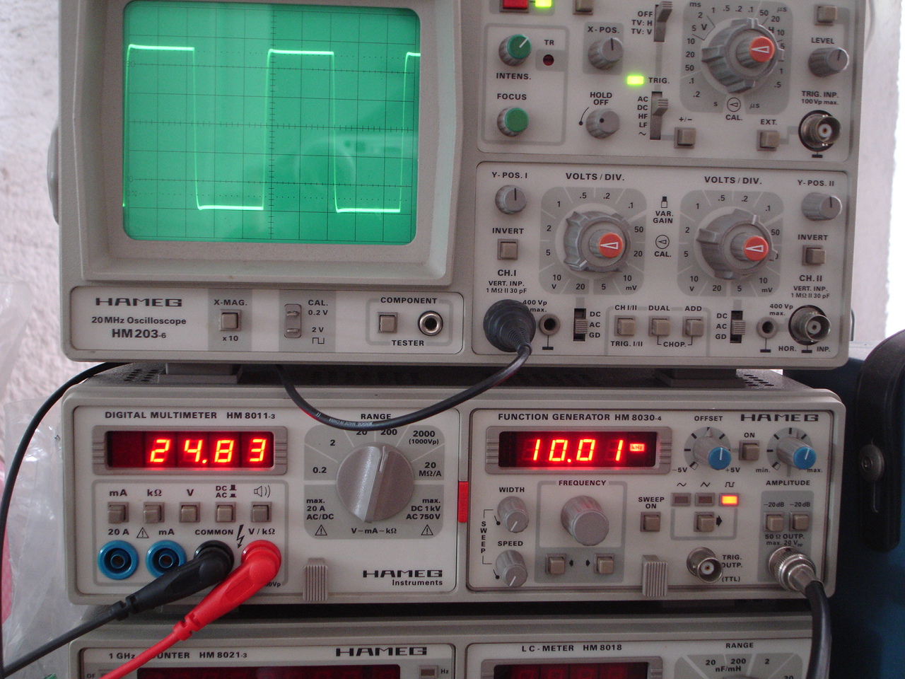

Post a pic of both the input signal and the output signal.
If you feed in an input signal that is slightly too fast, or with slight overshoot, you usually find that an amplifier will output an exaggerated overshoot.
Your massive overshoot could be due to bad input signal.

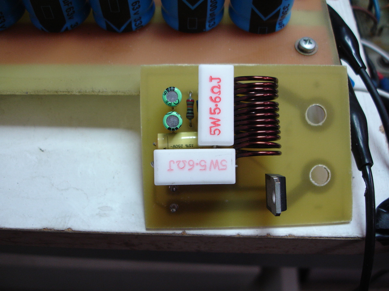

I forgot to mention that I removed the RC network from the Main PCB, I solder it in speaker terminal.
Me alsoI forgot to mention that I removed the RC network from the Main PCB, I solder it in speaker terminal.

The problem occurs only under control conditions and only, as many times highlight , at square wave signal.

sr200 studio refer.
There's something not like to me in this case.
This is one reason that I tried with another generator and other oscilloscope.
Today I decided to change the supply of the organs leaving the generator on the isolation transformer while oscilloscope directly from the network.
This mode will not share a common ground.
you have note that with the same procedure I have checked too many amplifiers without ever Troubleshooting
Hi dear Adrew.Post a pic of both the input signal and the output signal.

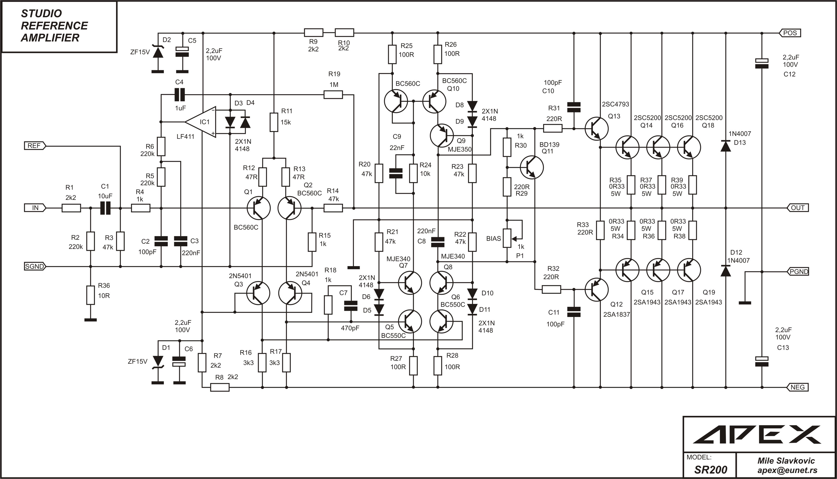

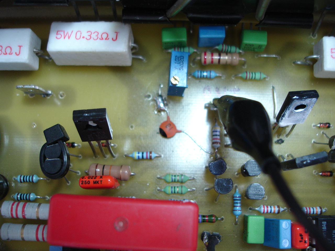

You added 10pF compensation and peaks are still there. Something behind is slow. Try remove c10/11 and increase added capacitor value (22p, 47p...). But be careful in view of oscillations.
C10/11 can be removed and add 100pF like on this circuit, R31/32 value can be decreased.
Hi Mr ApexC10/11 can be removed and add 100pF like on this circuit
I try as soon as i can.
Thanks i hope to your help🙂
keep in mind, however, that i do not built this circuit but this.C10/11 can be removed and add 100pF like on this circuit, R31/32 value can be decreased.

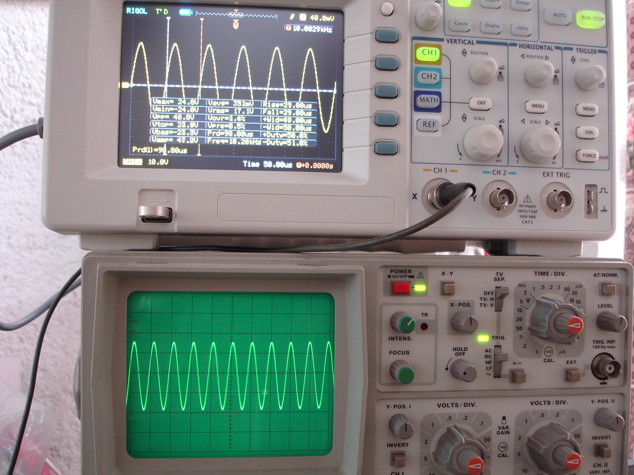

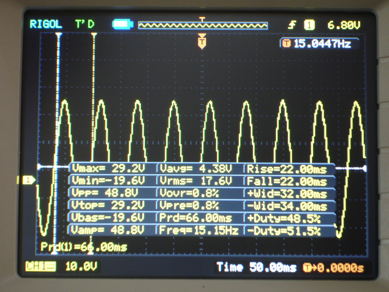

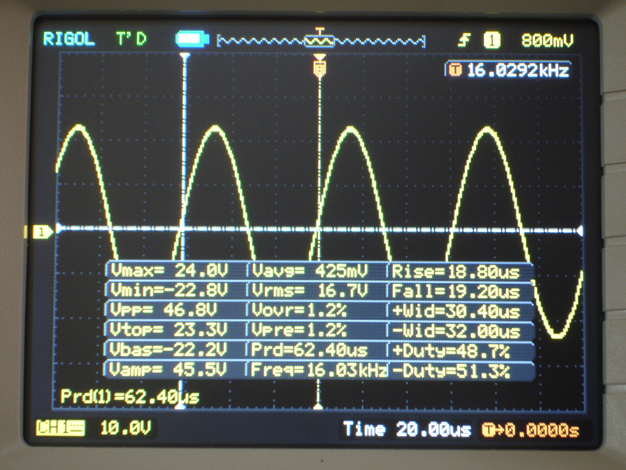

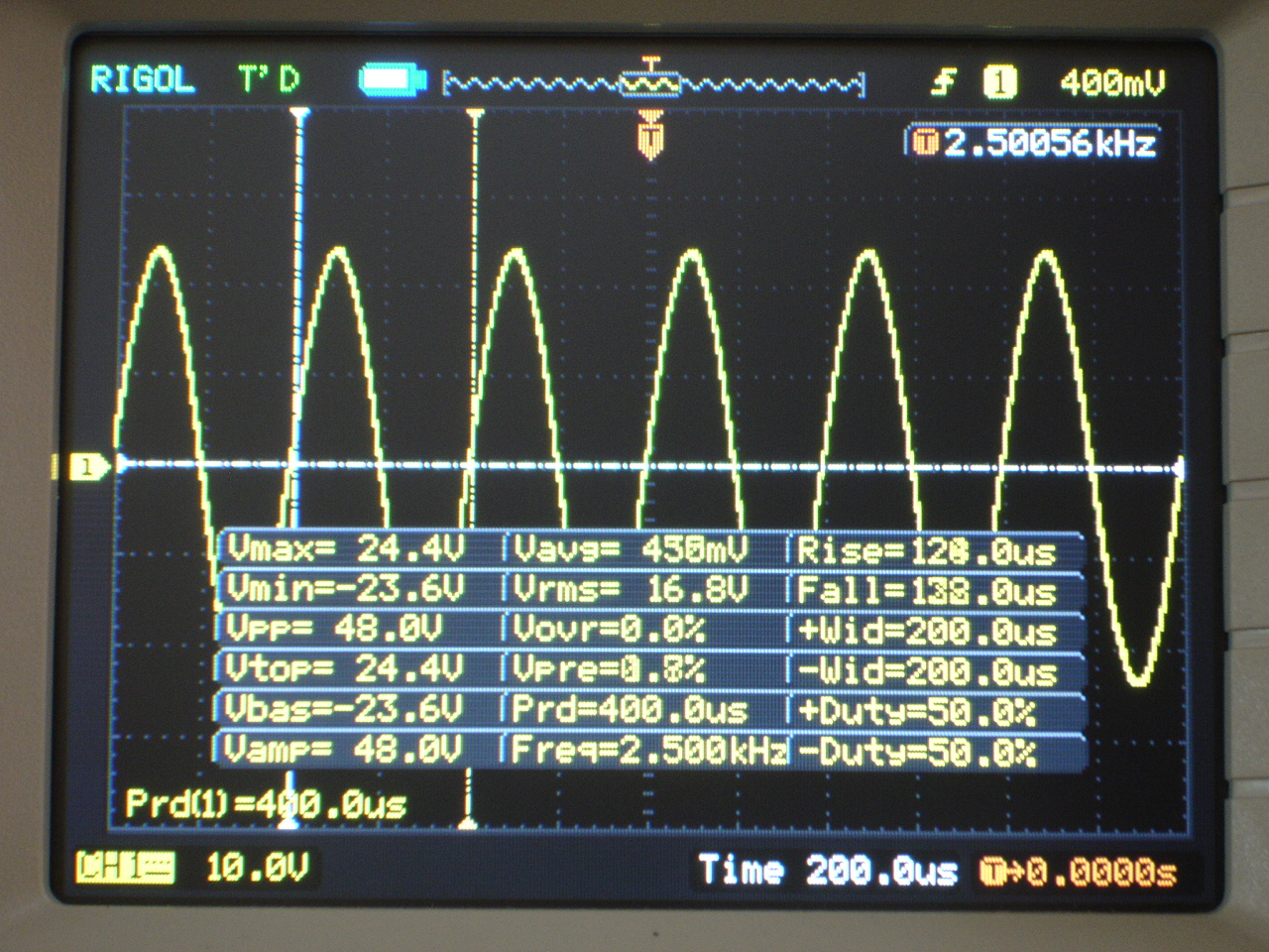

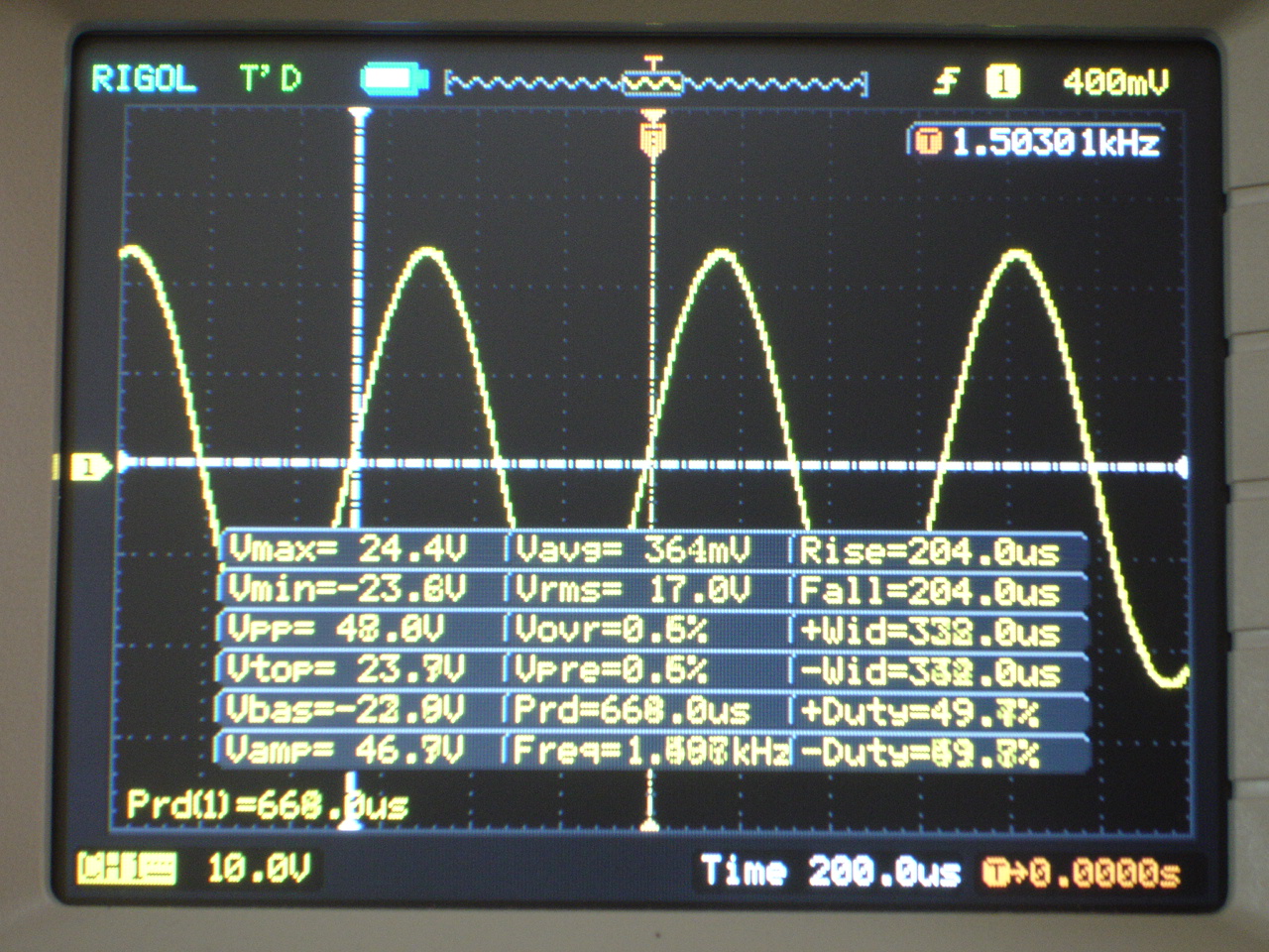

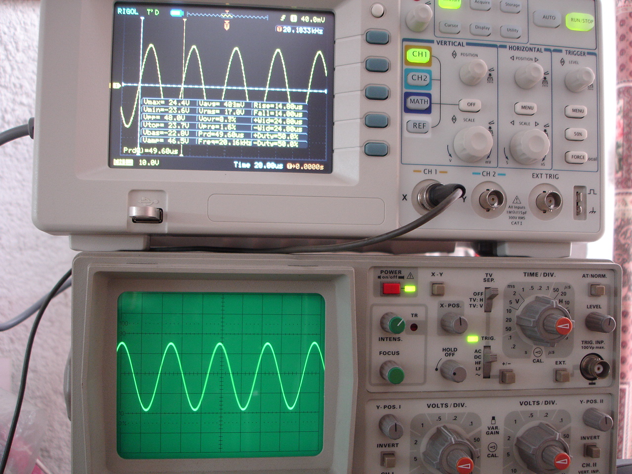

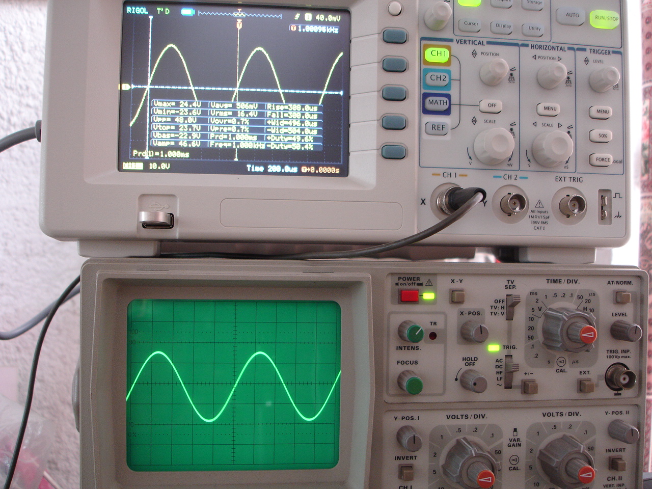

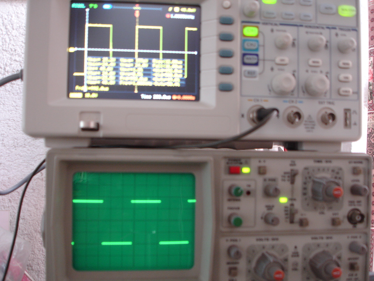

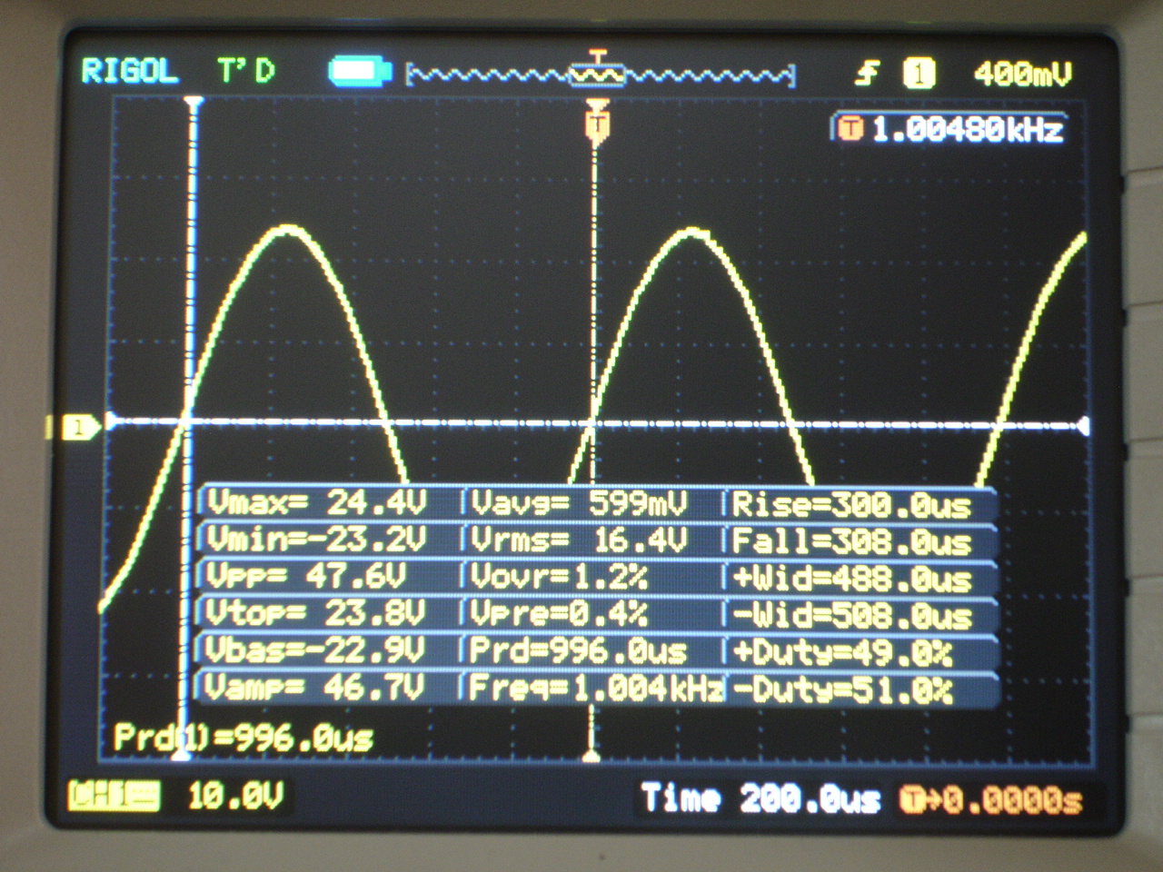

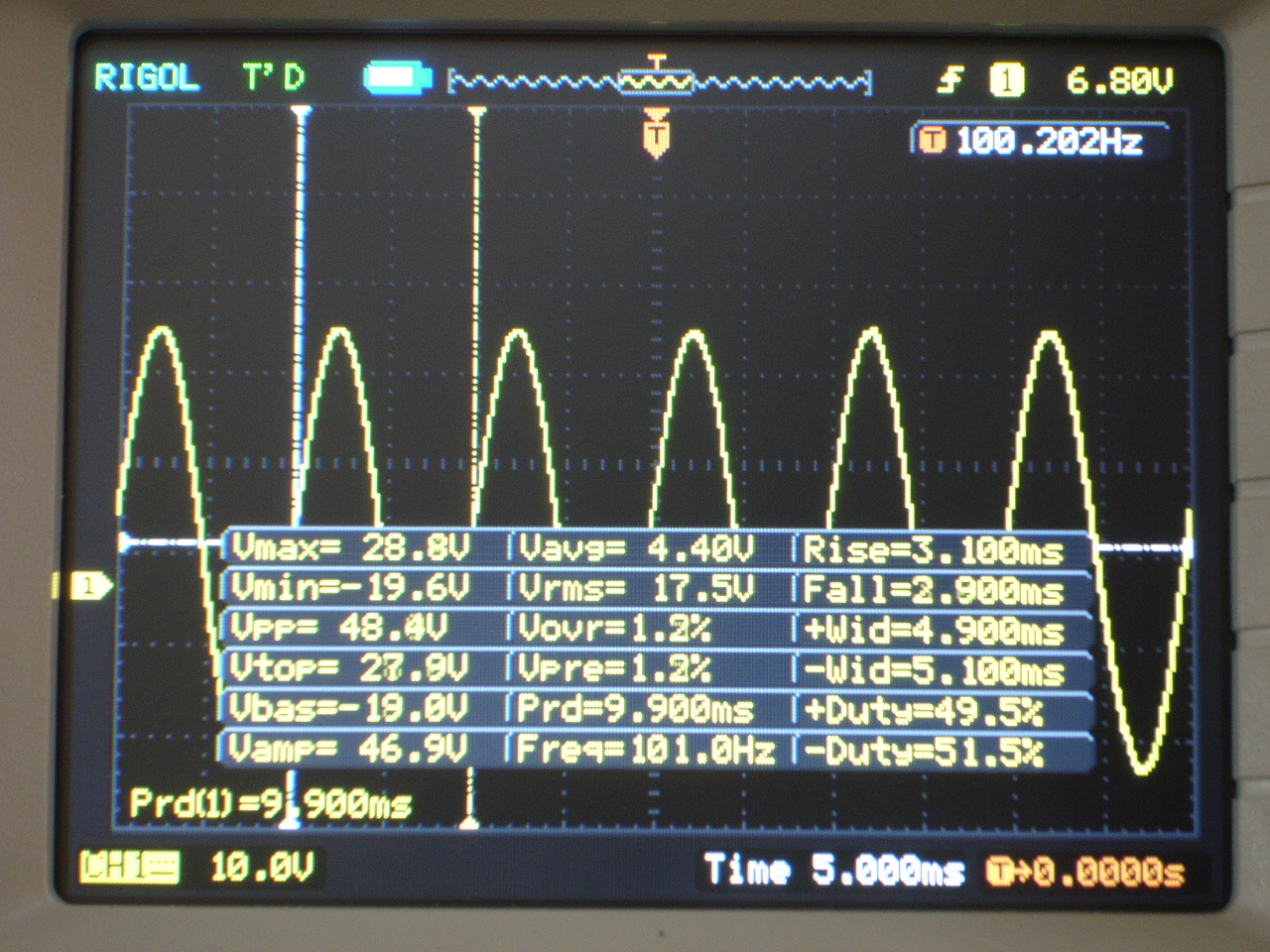

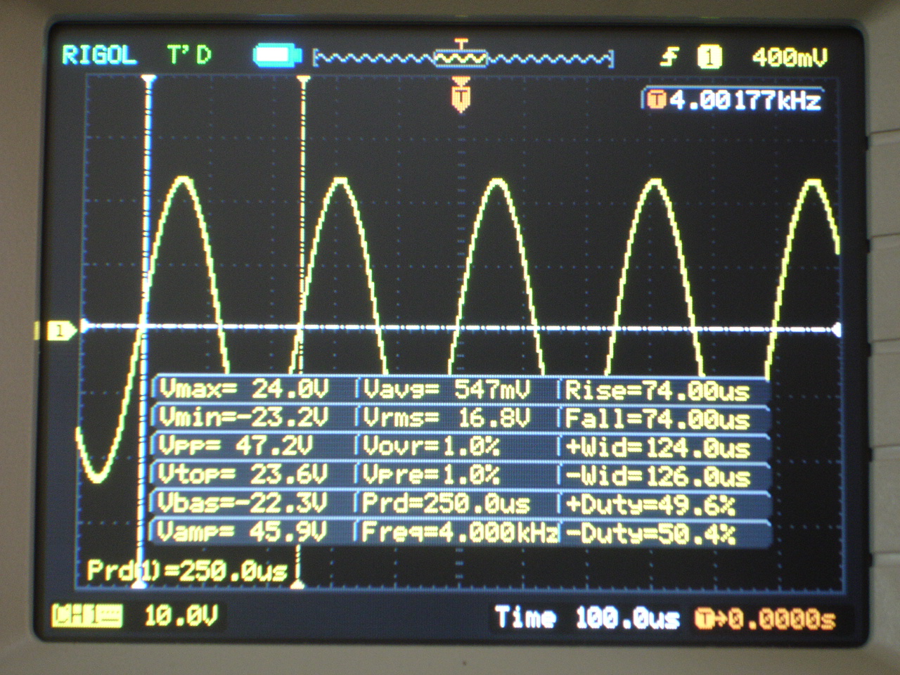

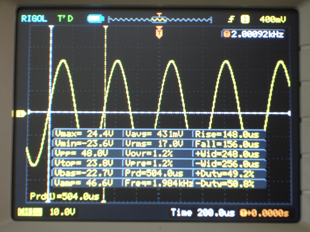

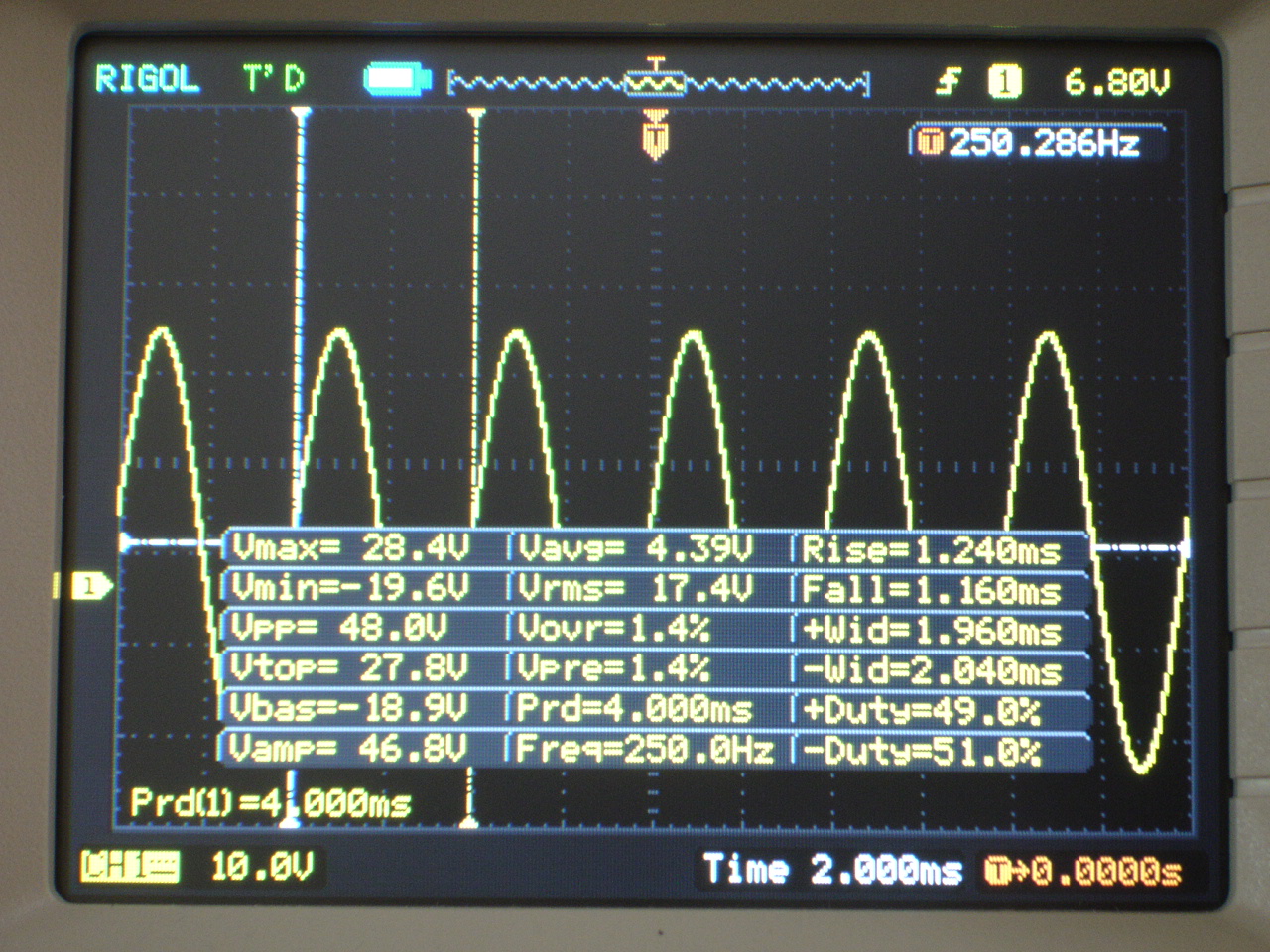

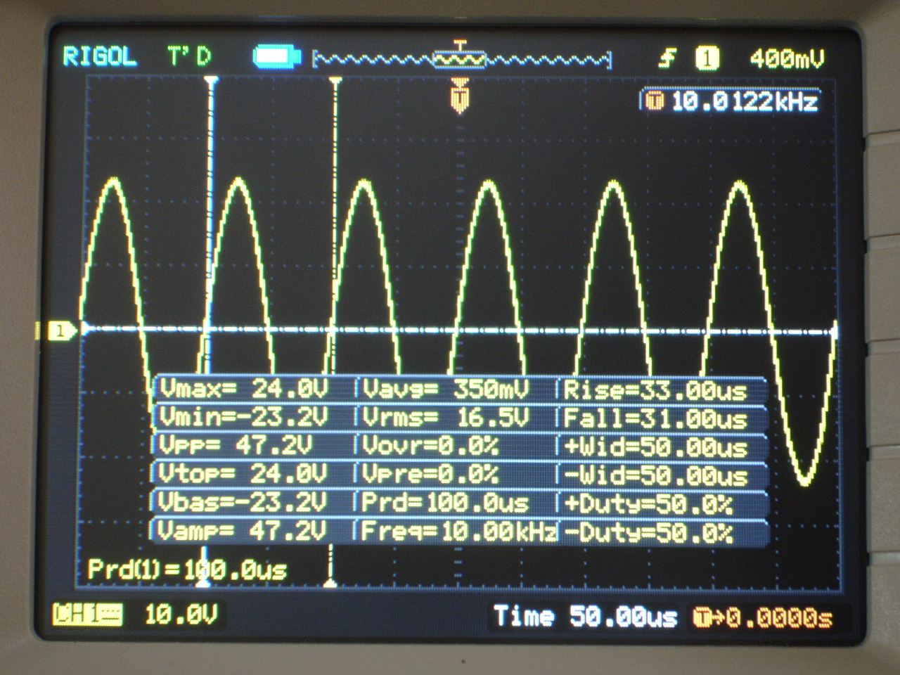

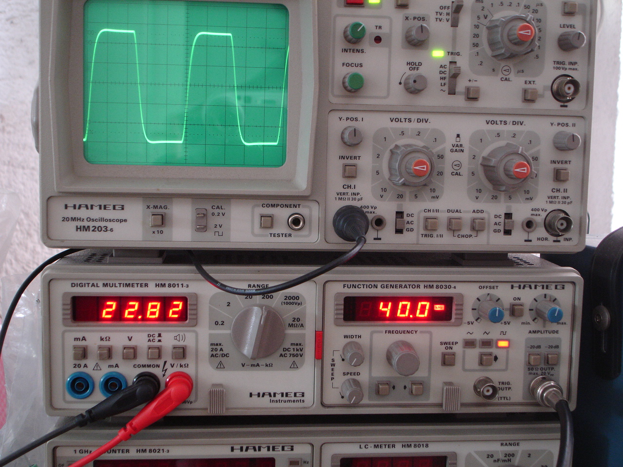

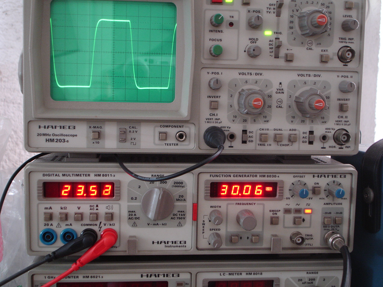

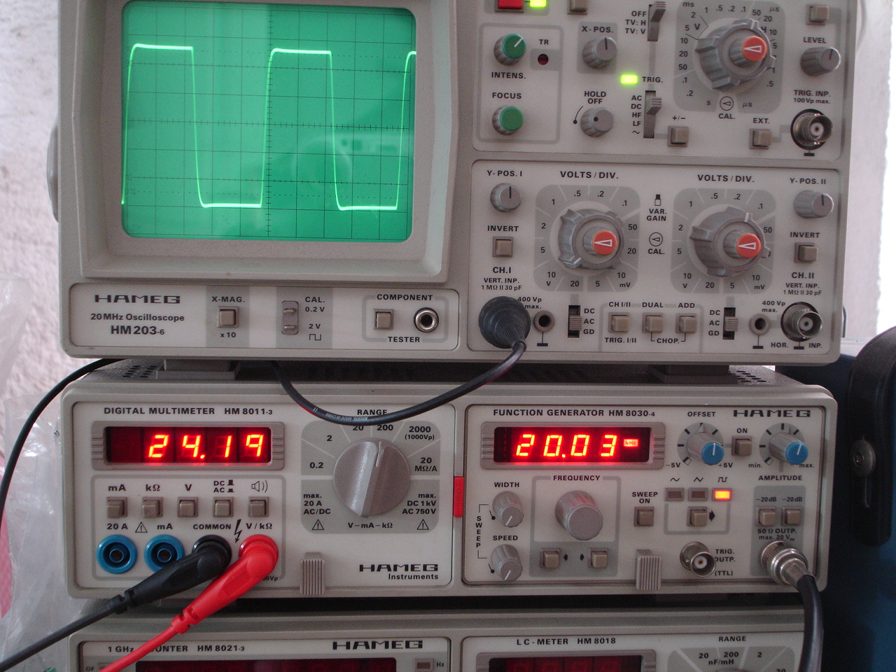

Good news friends!🙂🙂🙂
As previously stated, today made the above instrumentation wiring.
The overshoot decreased to half immediately!
Then added a 4p7 parallel to 10pf ..beter results
The final choice is18pf.
Take a look.
1)1KHz
2)10KHz
3)20KHz
4)30KHz
5)40KHz
Take a look.
1)1KHz
2)10KHz
3)20KHz
4)30KHz
5)40KHz

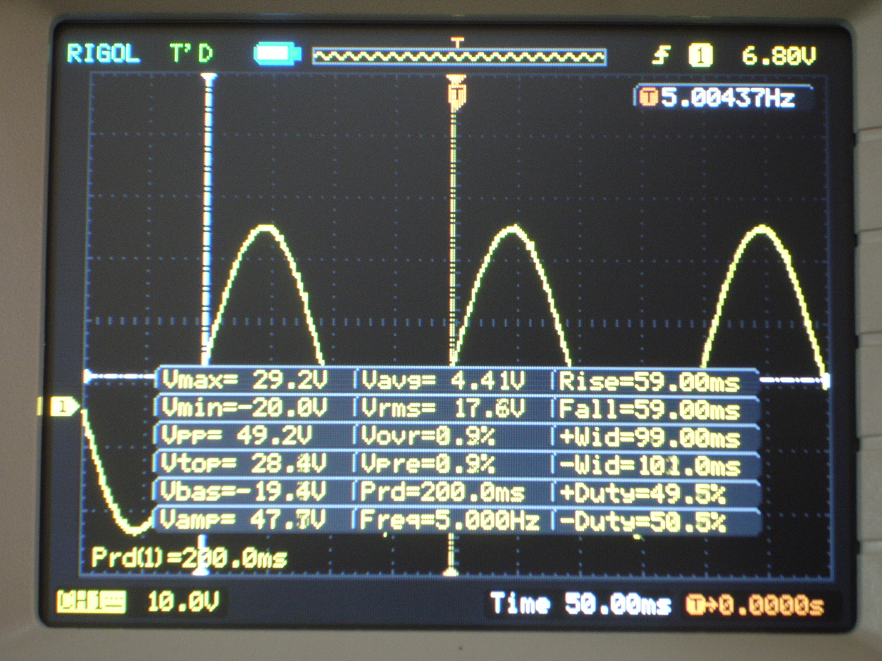

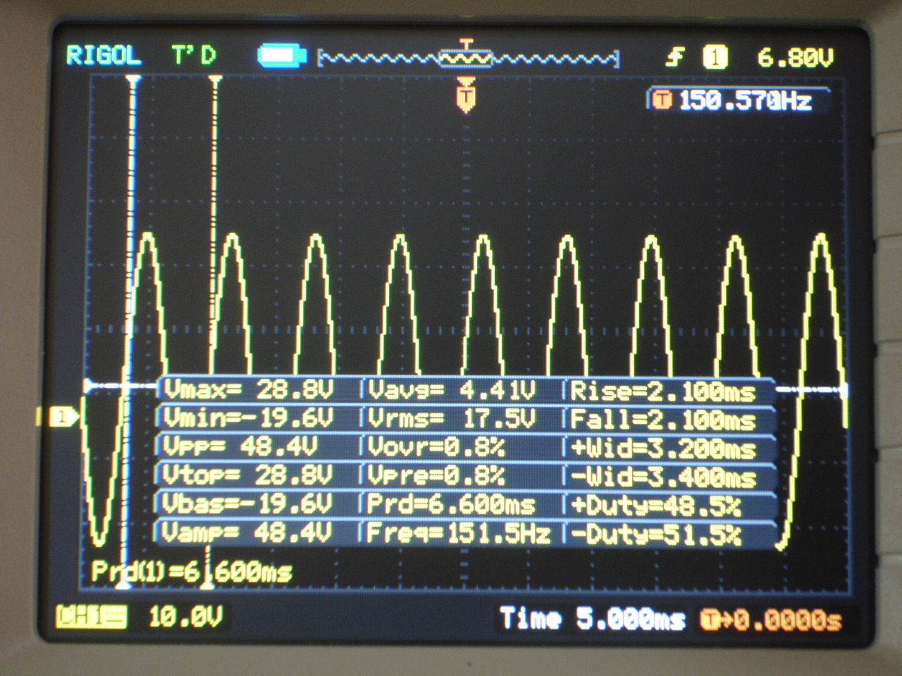

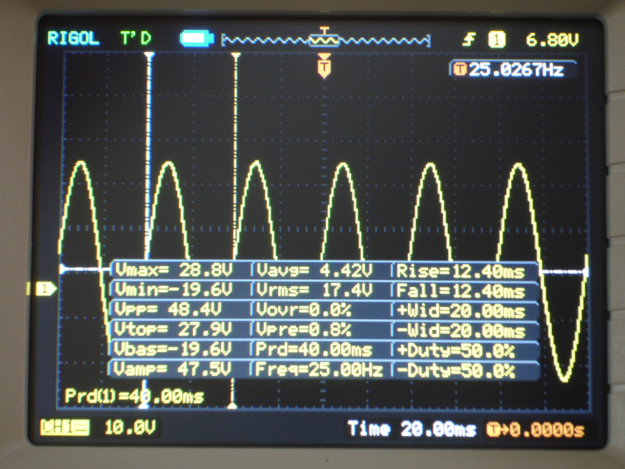

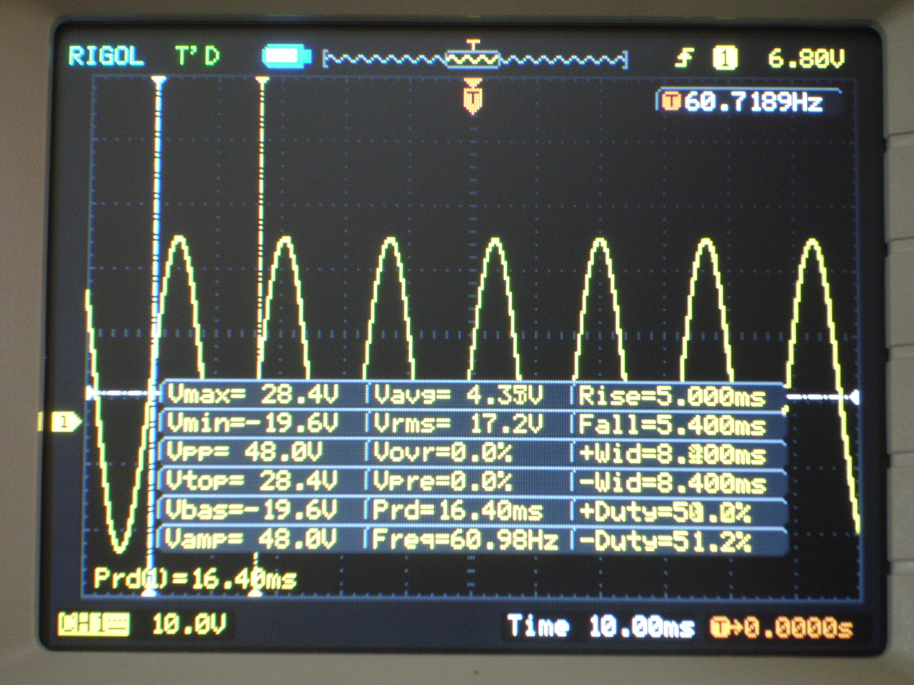

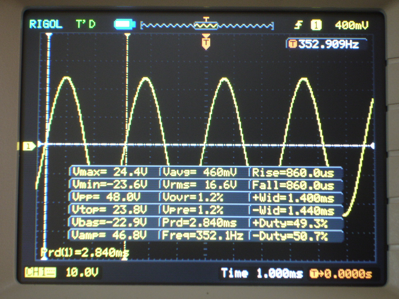

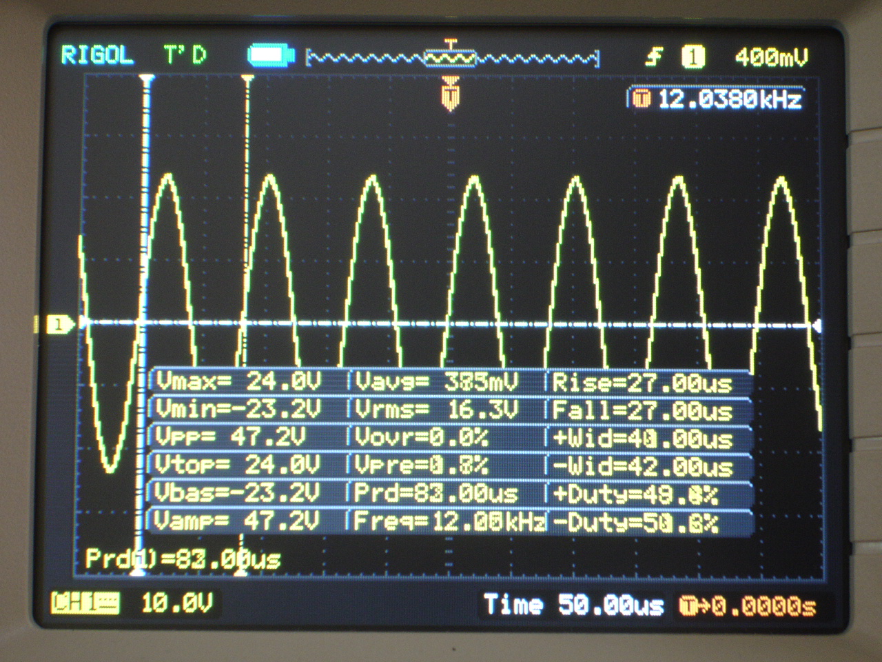

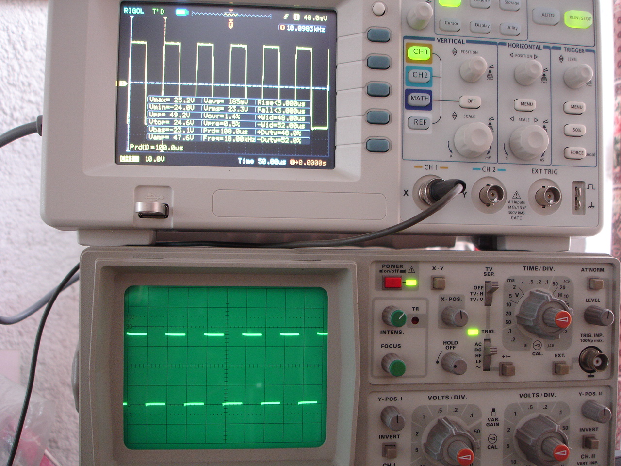

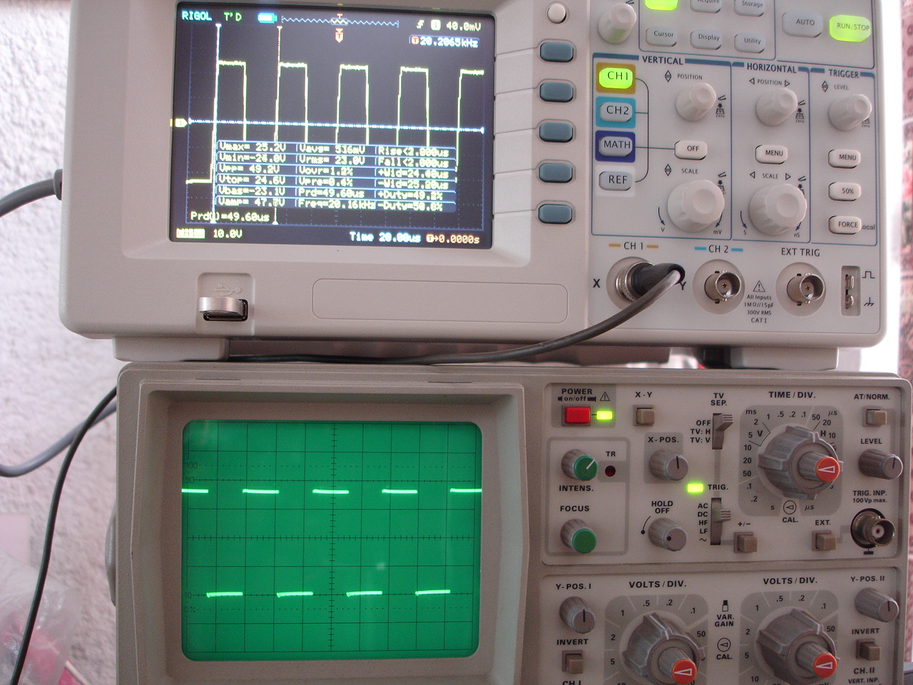

sr200 studio refer.
in continuity with previous some other pictures.
The down oscilloscope show the input signal
The up oscilloscope show the output of amplifier
