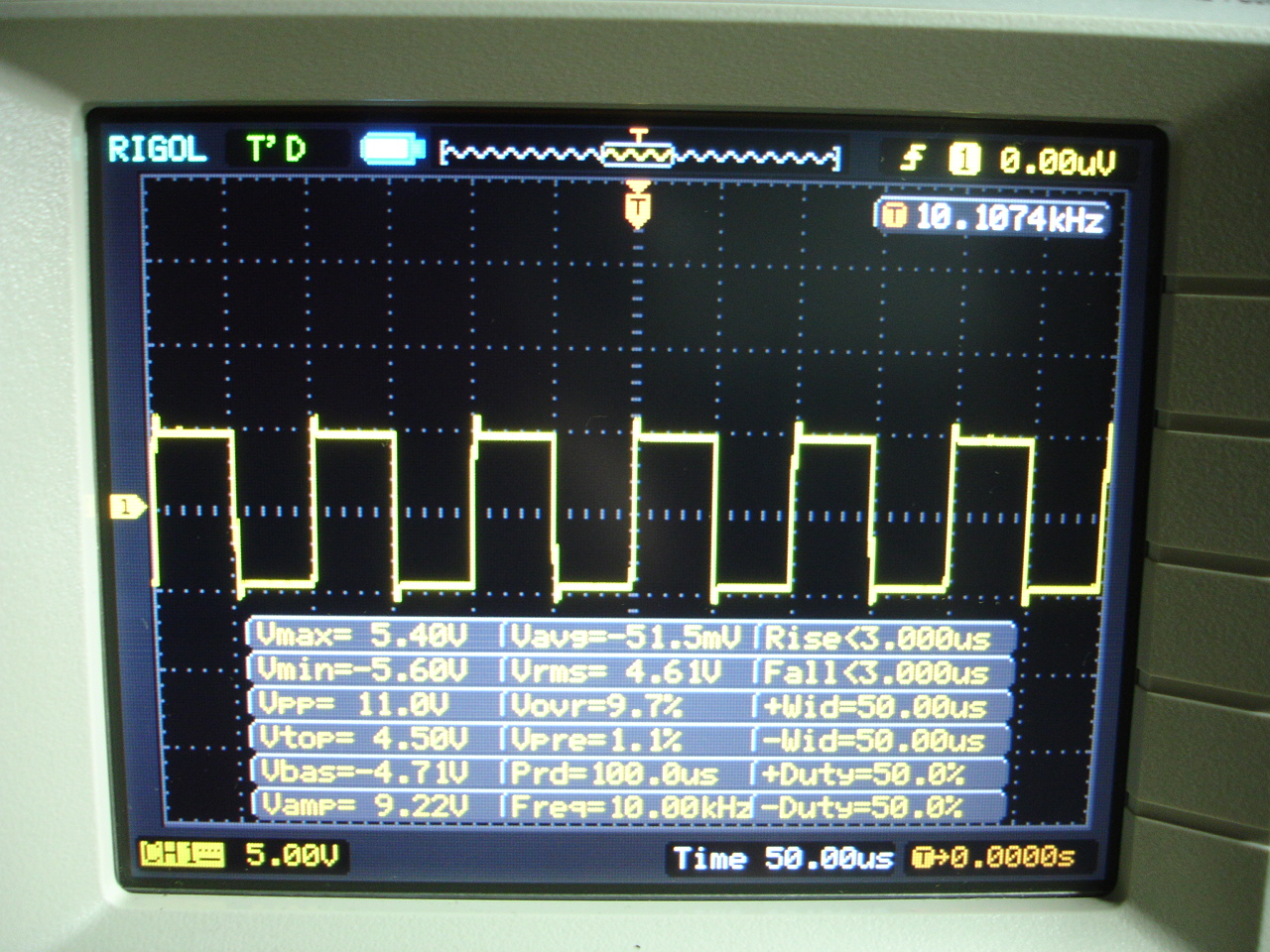

Νow do not know where to start ....
so many tests so many results.....i'm confused.
But lets go from the end.

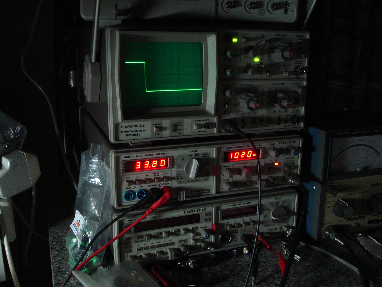

This 4 photos showes..
1) 1khz
2) 1khz full volume
3)10khz
4)10khz full volume.
Please take a look.
1) 1khz
2) 1khz full volume
3)10khz
Please take a look.

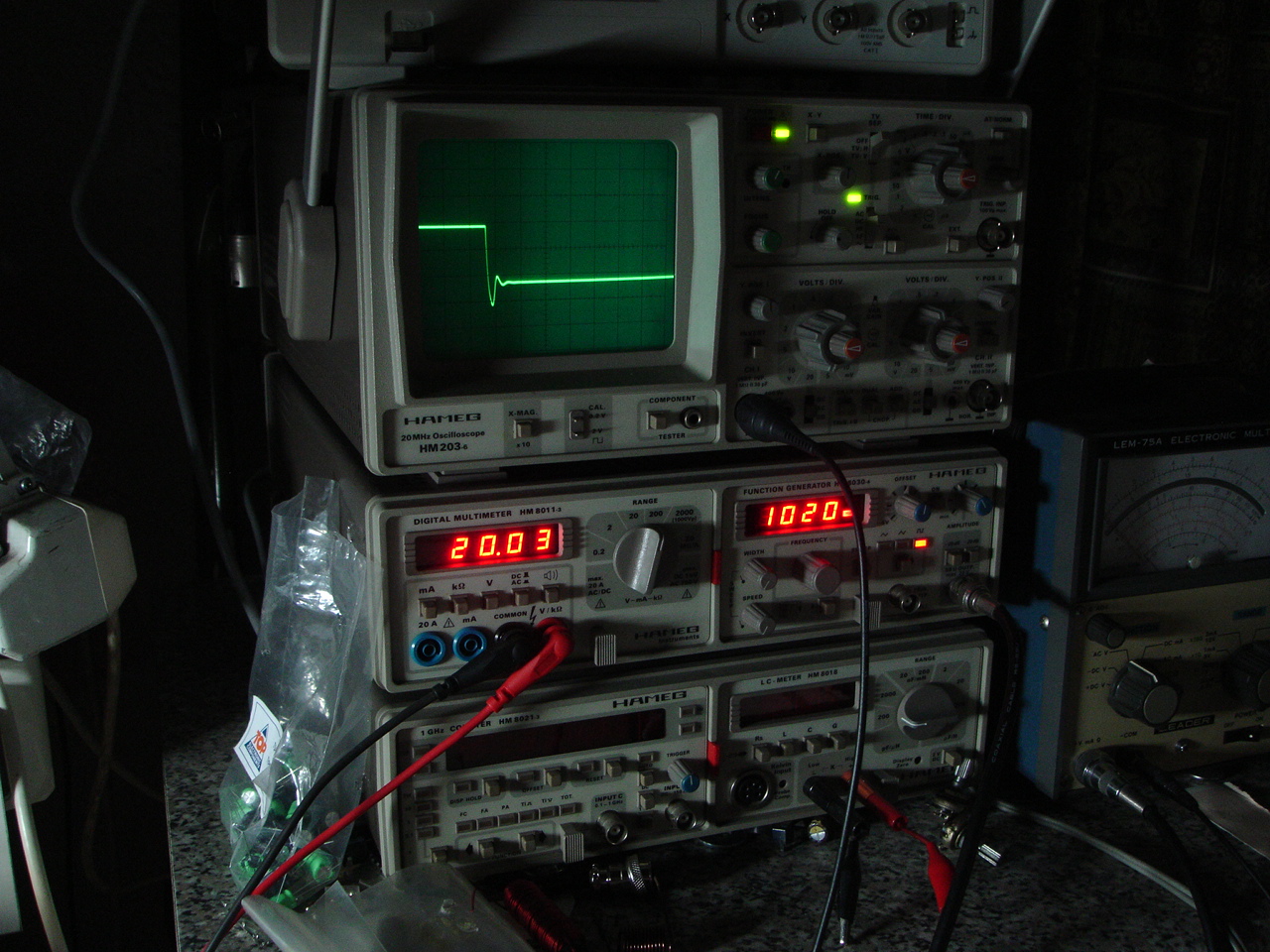

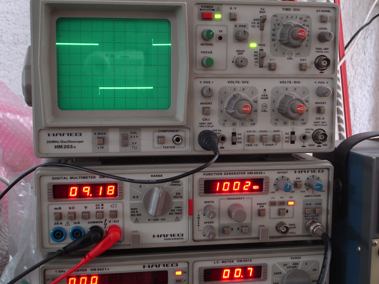

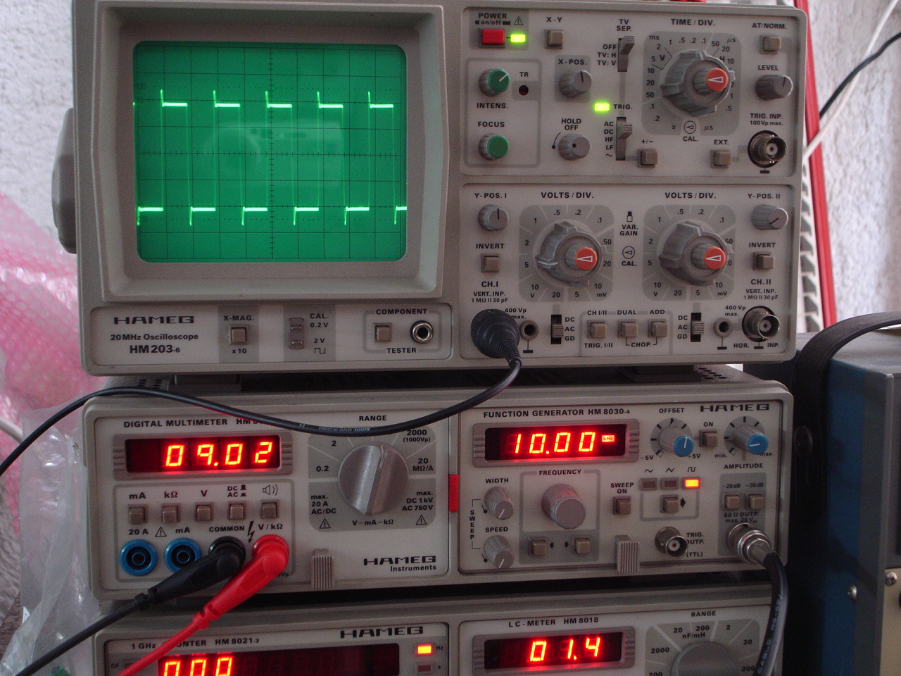

I have made a zobel just with i had this time and test again.
first picture is for +/-35v rail 50mv on 0.33r idle current .
out.14vRMS/8R at 11Khz.Please take a look.
Second picture is under same conditions
+/-35v
1 pair 2sc5200/1943
50mv on 0.33
450mv inp./1khz just before start symetrical cliping
19vRMS out/8r
and the draft zobel
that zoble is a bit to large,,,try 15 turns of 18swg enamel copper wire plus 100nf cap for circuit..

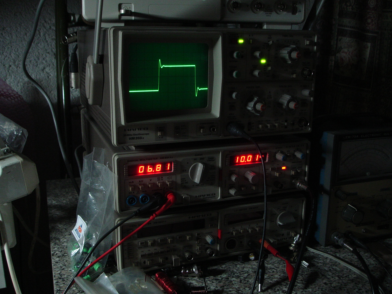

1) 1khz
2) 1khz full volume
3)10khz
Please take a look.

Last photos are with Apex zobel.....

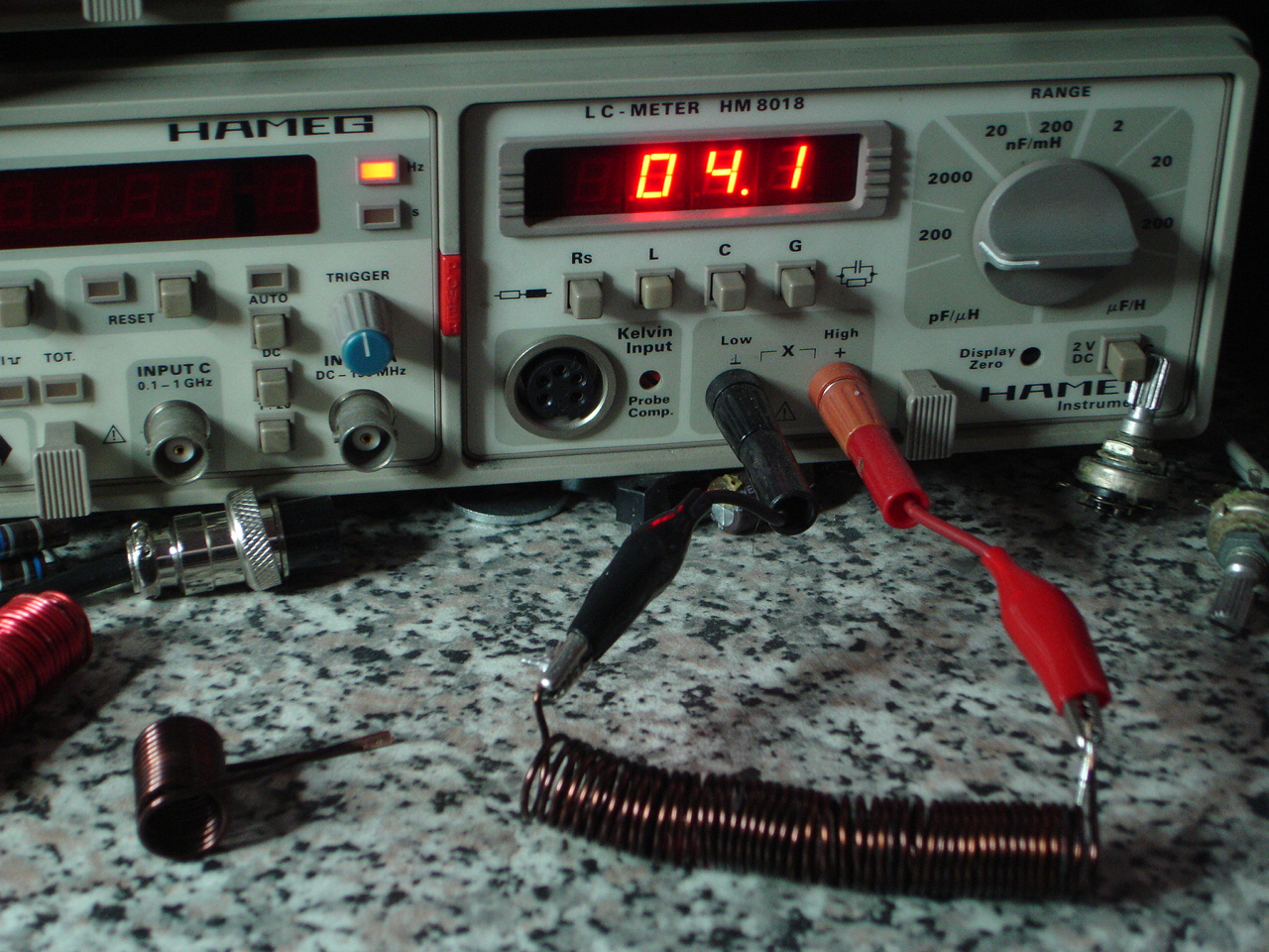

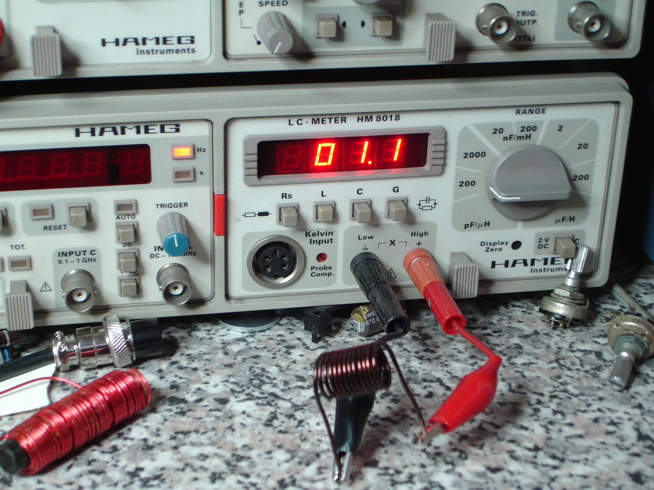

i can't understand why this coil is mentioned as 4uh
I made a coil as mentioned by apex 12 turnes 1.2mm enamel copper wire but this is only 1.1uh(see photo)
The large coil is 4uh.I made this before i see Apex guides ,focusing on it's value
Hi sir ...zobel is another story.that zoble is a bit to large,,,try 15 turns of 18swg enamel copper wire plus 100nf cap for circuit..
1) 1khz
2) 1khz full volume
3)10khz
Please take a look.

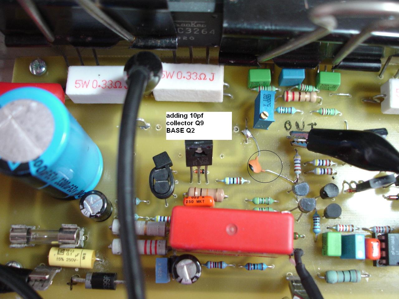

Is this results with R11 8k2 and 10pF add to the circuit?

Hi Mr these results is with R11 CHANGED TO 8K2Is this results with R11 8k2 and 10pF add to the circuit?
I can make the other modification(10pf) tomorow morning🙂

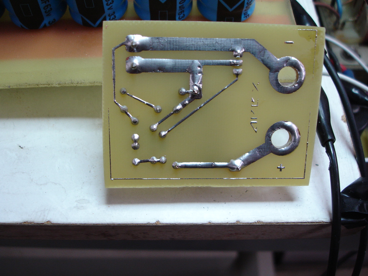

some other photos from today tests.

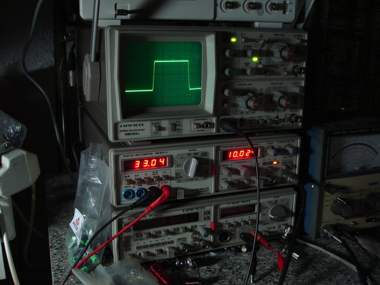

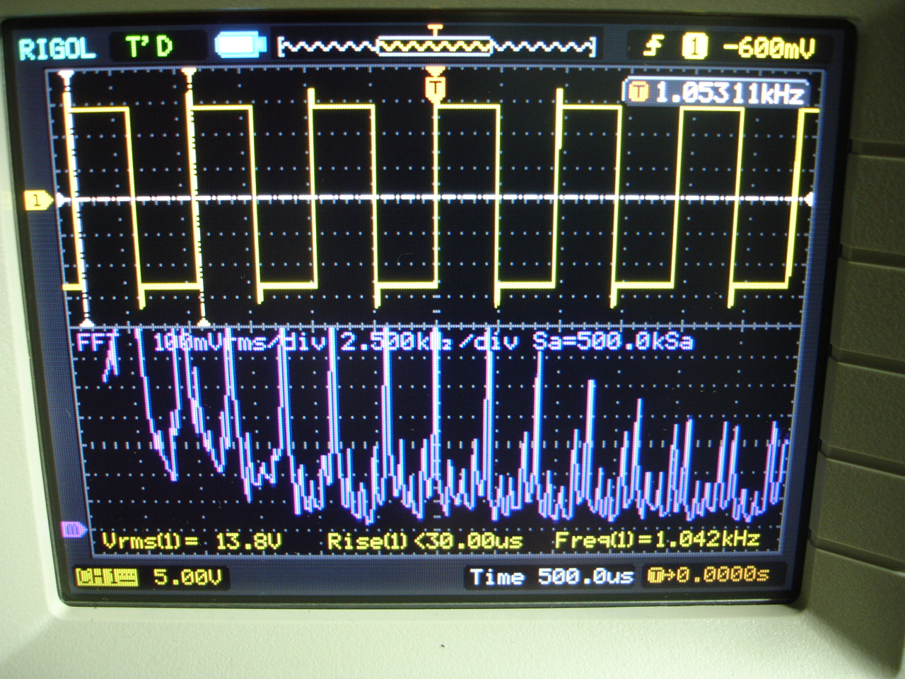

Here are these resultsIs this results with R11 8k2 and 10pF add to the circuit?

And what without c10/c11?

You added 10pF compensation and peaks are still there. Something behind is slow. Try remove c10/11 and increase added capacitor value (22p, 47p...). But be careful in view of oscillations.
