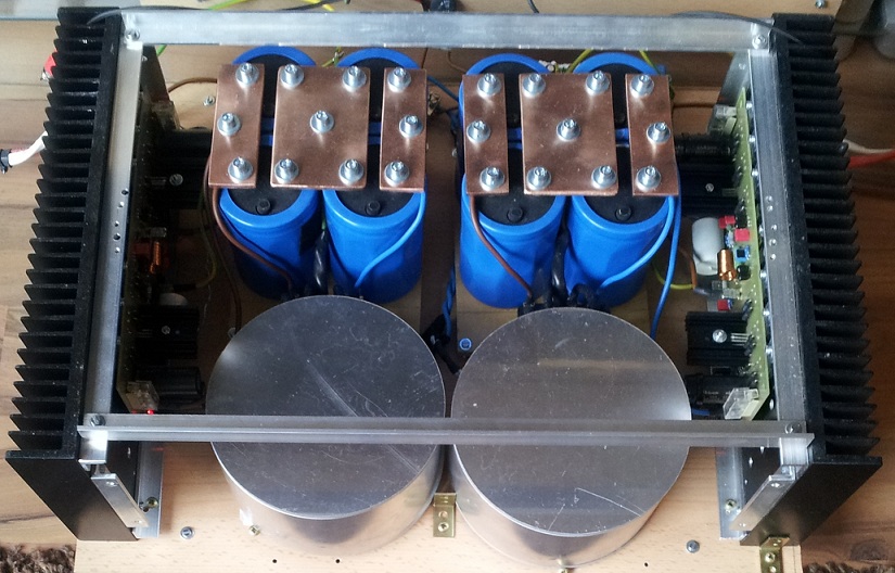

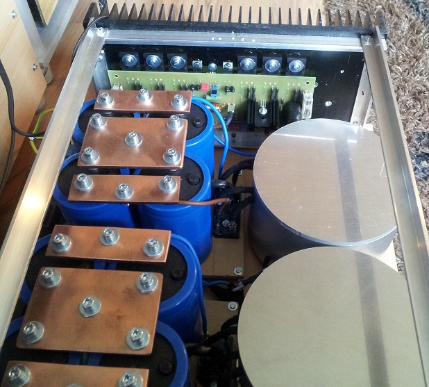

Hi to all! I decide to built this amp,but I have only 4+4 pieces of 2sc5200/1943.Is that a problem or not? And a voltage rail +- 60V is enough or too much for 150watt?

I'm using SR200 (AlexMM Rev3.1 PCB) with 3Pairs Output (per channel) with no problems at aprox 63Vdc-0-63Vdc.
Or do you mean 2Pairs per Amp (channel) for stereo at 60V ?

I have a total 4 pcs of 2500 and 4pcs of 1949 instead of 6+6 of SR200...so for a stereo amp I have 2 pcs from each one transistor per chanel...+- 63Volts is ok?

It's OK with 8R speakers.
