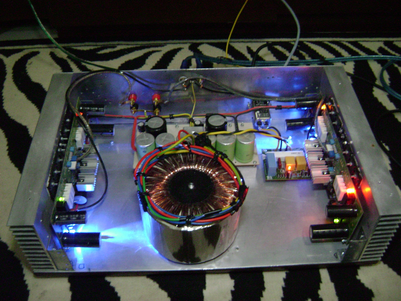

This is my SR200 with Soft Start, but i plan to move this soft start. It is located too close to Solen input capacitor, it affects some noises into right channel amplifier block.

I have completed the SR 200 project, the result is quite satisfactory in terms of sound quality, but there is a little problem on the final transistor excessive heat, bias from base to base in the set at 1.9 volts. does anyone have a solution to this problem?
thanks

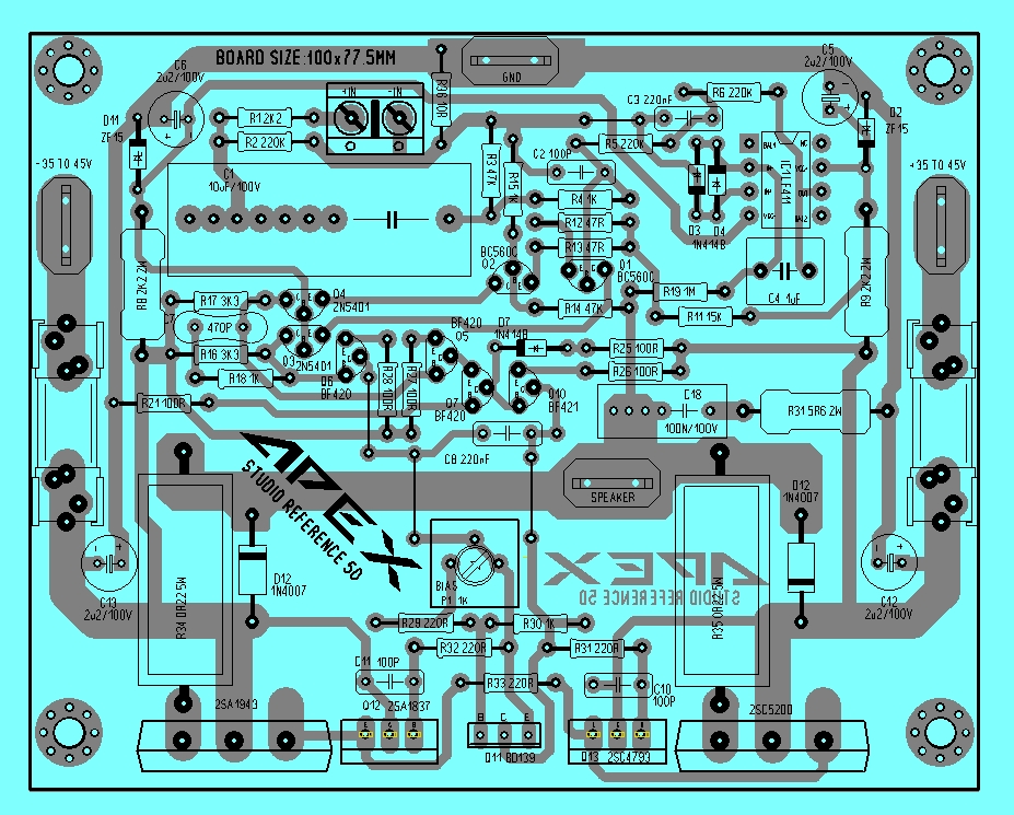

I just made ​​SR50 and the sound is great, but the BF's transistor are quite hot when turned on for 5 minutes, is this normal or is there something wrong with the circuit that I created, help me please newbie here
Nice work, BF's must be hot, what is your rail voltage and what pcb design you use?
Regards
Regards
Thank you sir apex, i use 35Vdc rail voltage with 10A fake transformer 😀 the final transistor used A1943 - C5200 Grade II (only these sell in local store nearest my home) but the temperature not to hot and one more question if i use TL071 what do i have to change to the board? so hard find LF411 in here only got 5pcs last week, i used pcb design in attachment, thanks for sharing a good knowledge n schematic, this is my first build next i will build B500
Regard
You can use TL071 instead LF411 without any changes.
