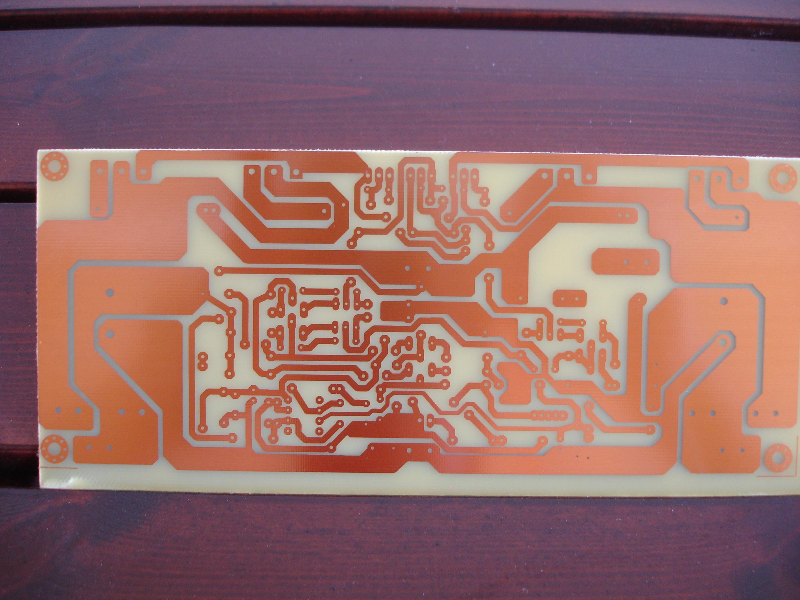

oh sorry i see more circuits and i worked on many amplifiers this days and i am confused.i have make nmos200.QUASI'S NMOS200 - YouTube and elektor. "Giesberts HEXFET AMP" hexfet amplifier - YouTube yesterday so......
This morning i make PCB for yours sr 200 studio ref. version with 2sa1216.....2sc2922.🙂

This morning i make PCB for yours sr 200 studio ref. version with 2sa1216.....2sc2922.🙂View attachment 353876
Nice PCB

Thanks Mr .
I look forward to hearing these amplifier.
The problem is that i have only+/-55v at this time ,can i use this low voltage just for testing?

Yes +/-55V will be good and it is not 'only' 🙂
