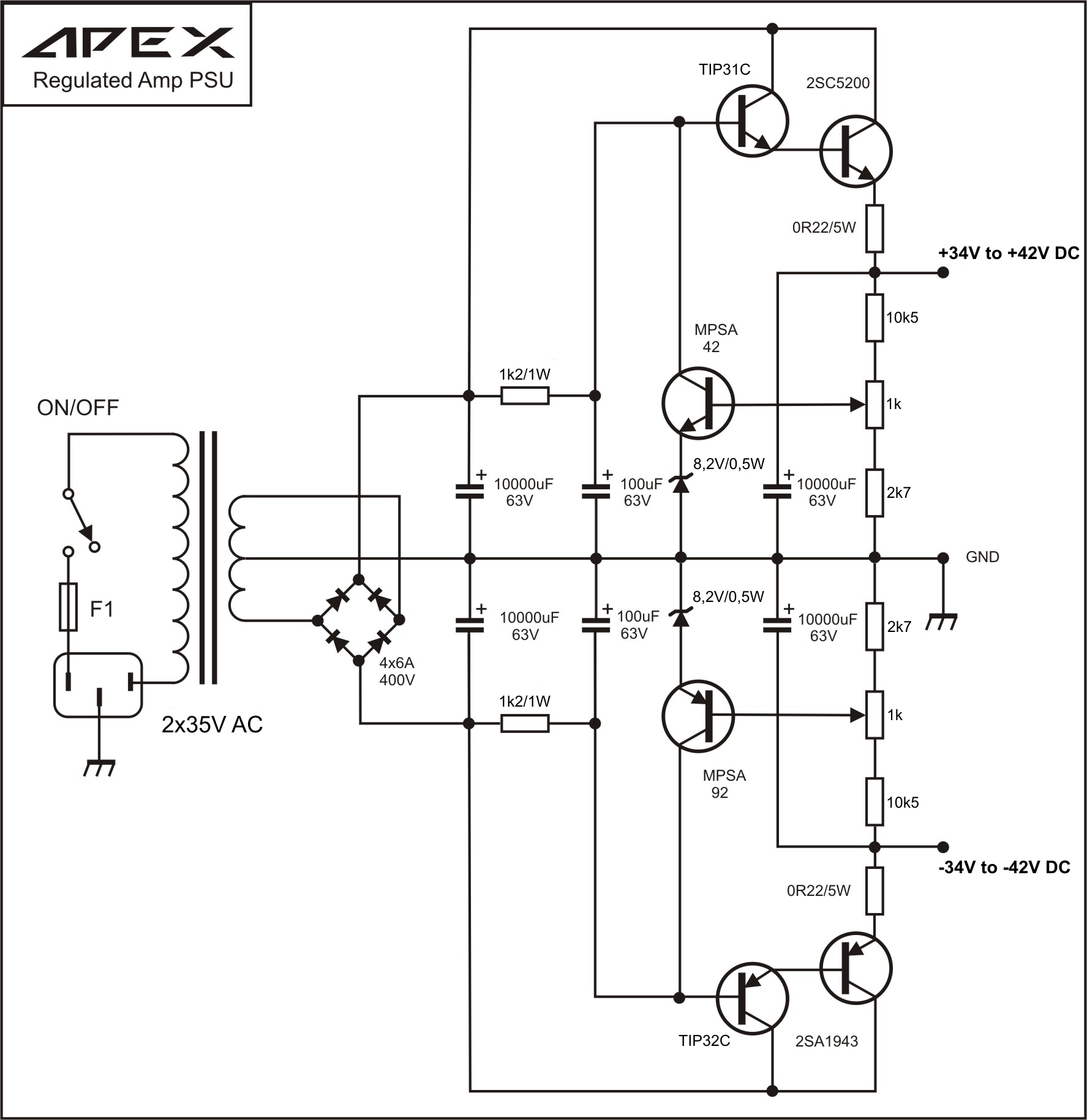

Dear Apex,
i build your PSU for my amp. Therefor i changed the values of a few parts (see picture) for DC output voltage from 34V to 42V. The PSU regulate the voltage really well, but after a few minutes the transistors MSPA42 and MPSA92 will be hot. Where is the mistake?
Regards

Dear Apex,
Regards
What is the input voltage? Replace 1k2/1W with 2k2/1W or 3k3/1W.
Regards
The input voltage is 50VDC. I changed the resistor from 1k2/1W to 3k3/1W and both transistors MSPA42/92 keeps cool. First of all i thought, if i change the value to 3k3, the current through the zener diode is too low.
Now, the PSU works fine and i can do the next step to integrate the PSU in the schematic of my amp.
Thanks a lot!

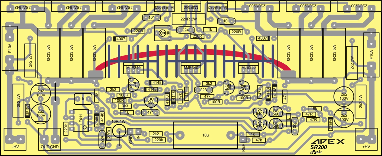

..... Revised PCB this time , much better I hope ....🙂
Alex.
Hi Mr Apex Sir,
i try this pcb layout #145 but i have problem i got -48vdc at the output using 35 0 35 VAC trafo. I replace bc550 and bc560 to mpsa92/42 and mount in reverse position. sorry i dont have picture of my work. hope you can give me hint/clue on what could be the problem of my work if there is presence of high DC volts on output. thanks in advance.
regards,
nix
just a lucky guess...
Have you placed all the jumpers? There is one in a lower left corner under the 2k2 2W resistors,easy to be forgotten and overlooked.
Hi Mr Apex Sir,
regards,
nix
You must post pictures, there must be some mistake with this high DC on output.
Regards
