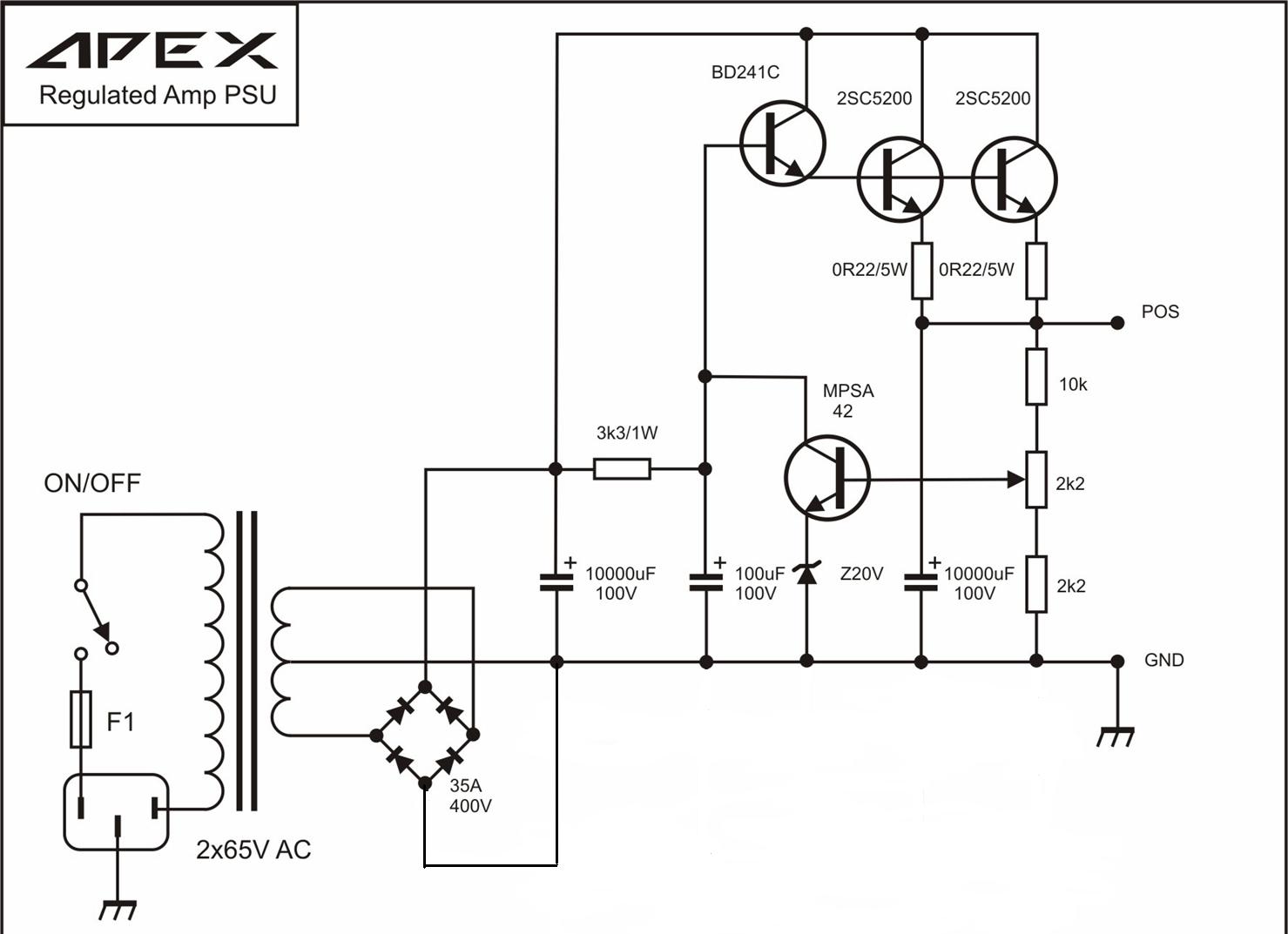

Hi Sir Mile, apologize in advance this might be a silly question and beyond the discussion, can I use this schematic for power supply with an output capacity of 48 Volt 10 Ampere? whether there are components that should be changed or added? please help me. I needed.

Use single 50vac instead 2x65vac, and 15V zener instead 20v.

Thanks Sir.
