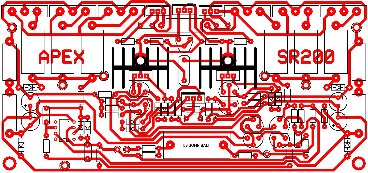

Thermal Coupled
Hi...🙂
This my PCB design of SR200,
Are all these small TR need to thermally coupled?
I arranged them like that so it easy if it is need to thermally coupled
It is still need to be check again & if it its a bad design I will redesign again...😀
