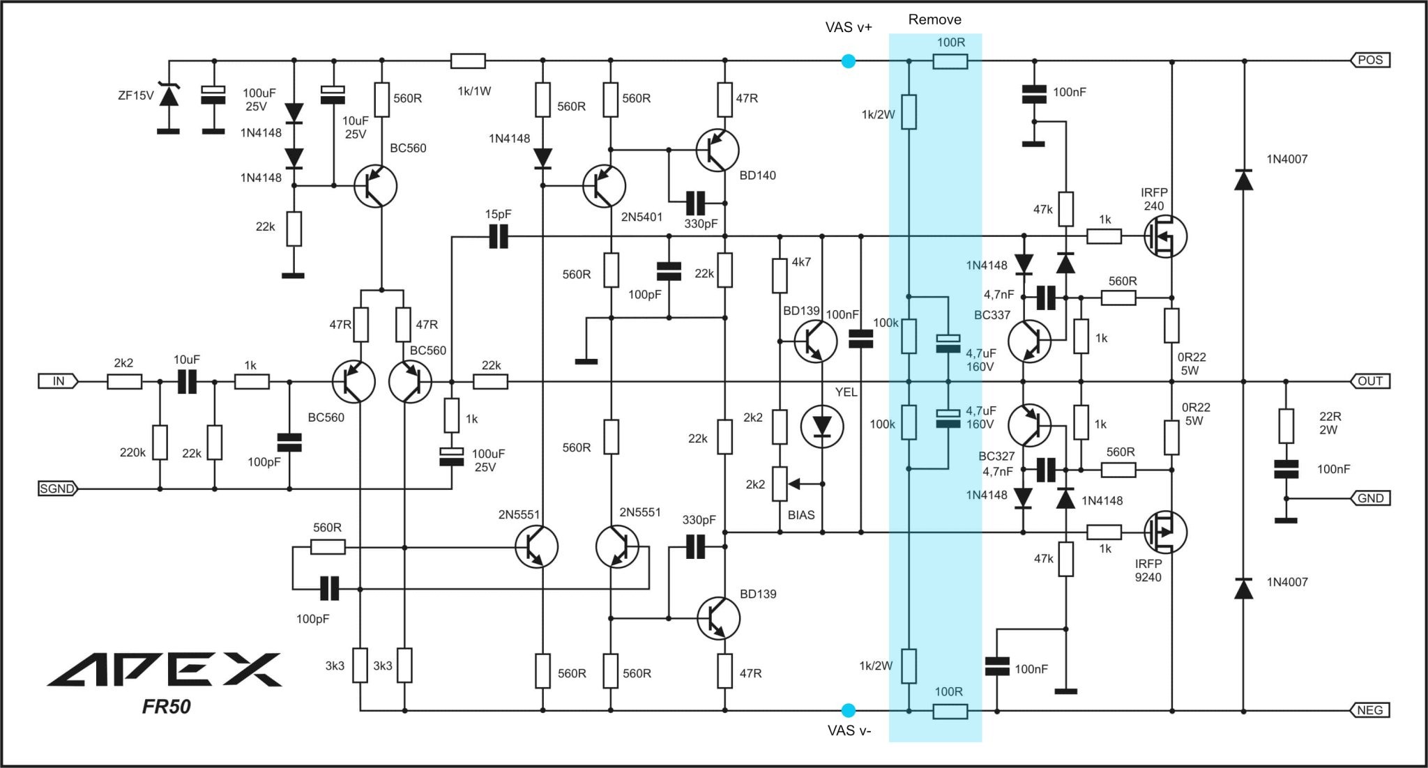

Hello. There was a bootstrap analysis when the FR100 was introduced. MR Mile added this circuit to increase the voltage by a couple of volts on VAS as I understand. I would ask if there would be any advantages to remove the bootstrap and using a stabilized power supply instead. I'm not an electronics expert just an enthusiast.... can I do this modification on the FR50?

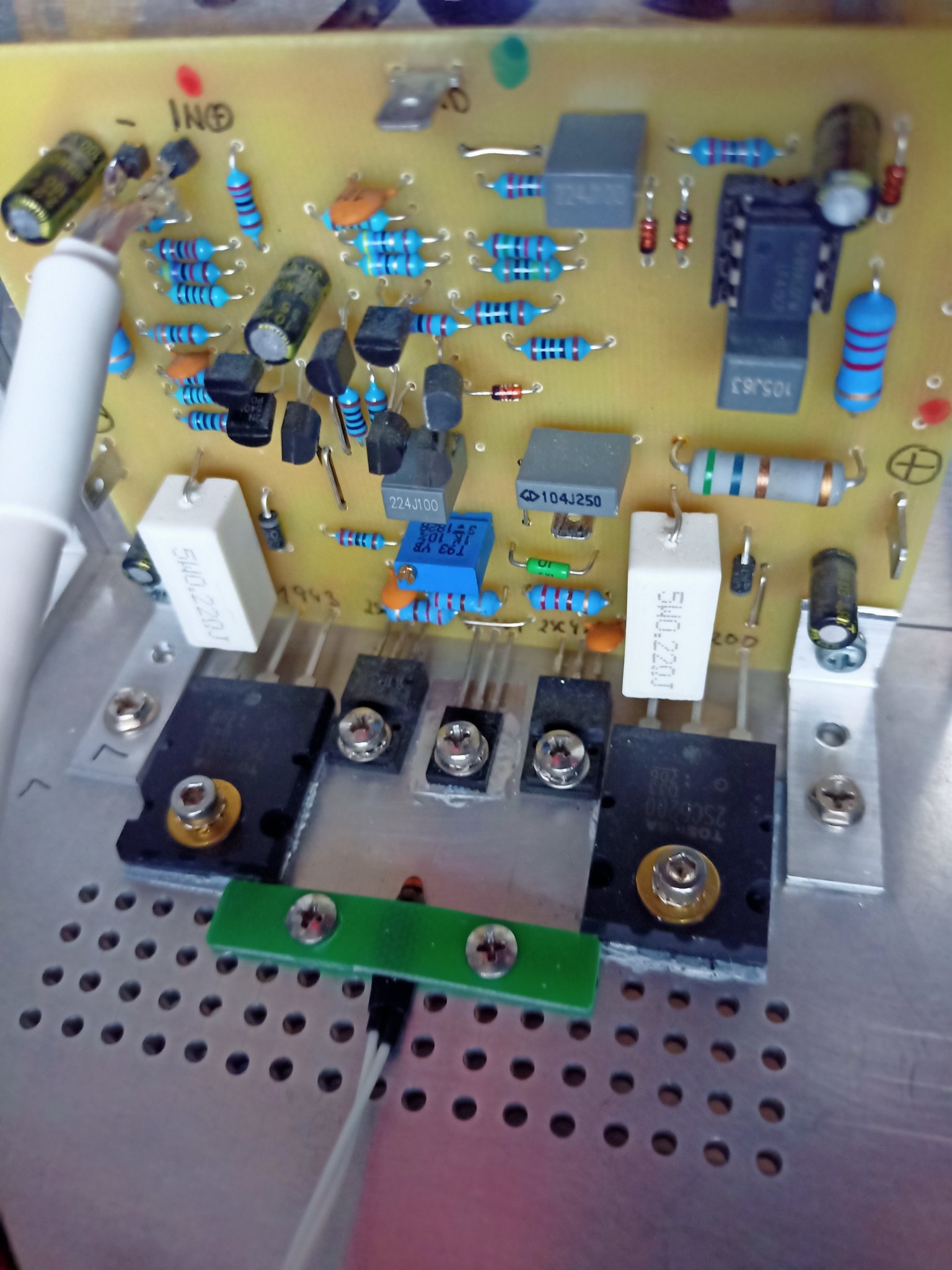

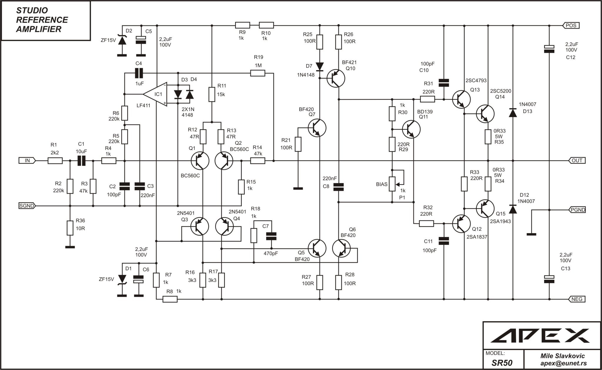

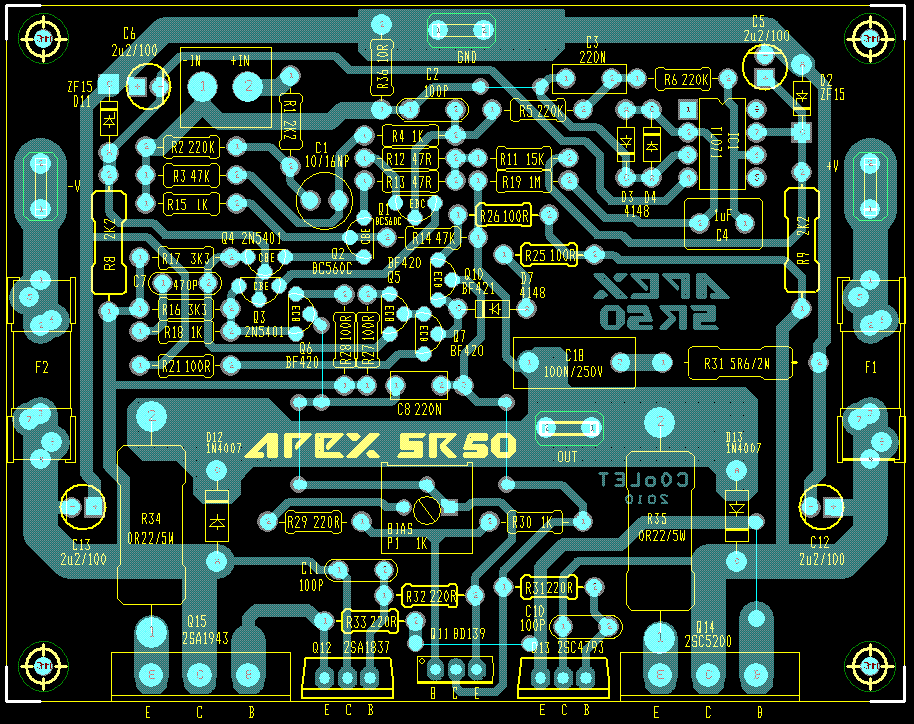

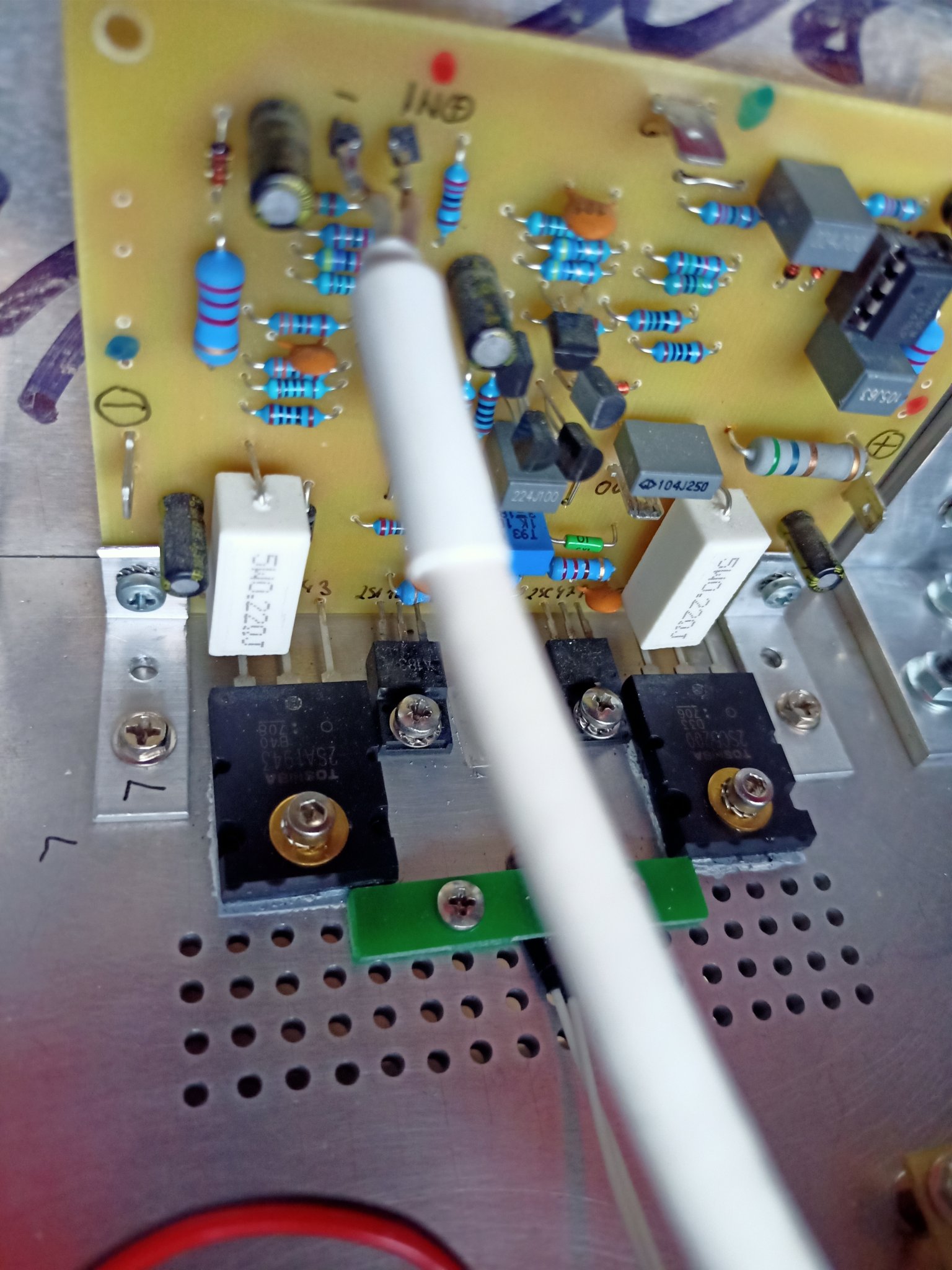

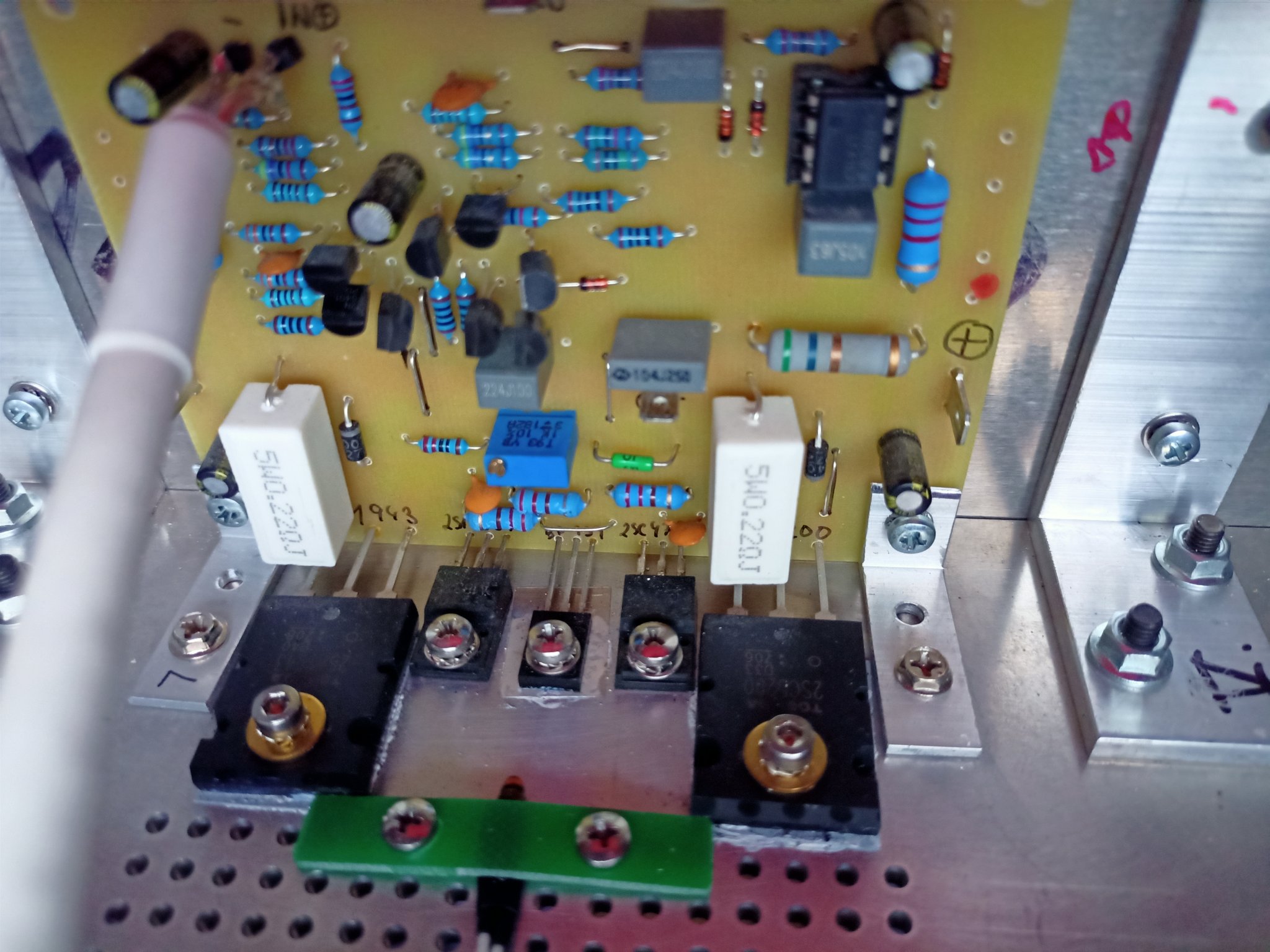

I greet you all. Please help and advice. I can't adjust the bias on the Apex SR50 amp. I changed resistor R30 from 1K to 1K5 and I still don't have about 2V voltage on BD139. Please advise me what to focus on and where the problem could possibly be. Thank you very much and have a happy and merry Christmas. I use layout Coolet.
Thank you for your willingness.
Vbe_multi (Q11, P1, R29 and R30) is most likely no working "properly".
You made change for R30 from 1K to 1K5 with no visibile BIAS changes
i.e. differences in Vbe_multi min-max adjusting voltages (voltage measured on C8 adjusting P1)
For DualEmitterFollower DEF OPS you need aprox. >4xVbe = >2,5V on C8
When you adjust P1 to the one off the two extrems (0R and 1K), for P1->0R, what is your voltage measurement on C8?
C8 voltage = Vbe_multi (V) = Vbe * (1 + R30/(R29+P1)) ; Vbe= aprox 0,65V
Check R29 value!
Maybe is not 220R but higher in value, so Vbe_multi voltage cant reach necessary max level (more then 2,5V on C8)
Measure voltage differences on VAS R28 100R and on VAS current mirror R26 R100 (you must read on DMM aprox. 0,85V...1V on 100R => 8,5...10mA)

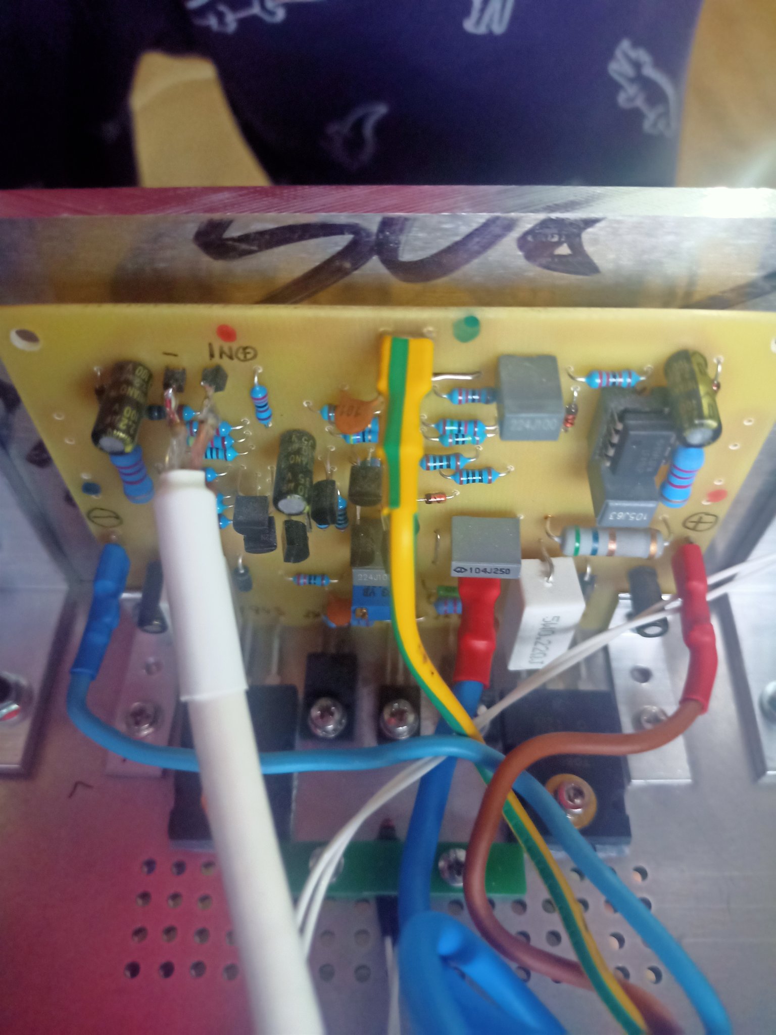

Hello Dragan and everyone. Thank you very much for your support. I measured -16 VDC on capacitor C8.
The Christmas holidays are about to start, so I'll check it out later. When I get to it, I'll write what I measured. I wish you a merry Christmas.
