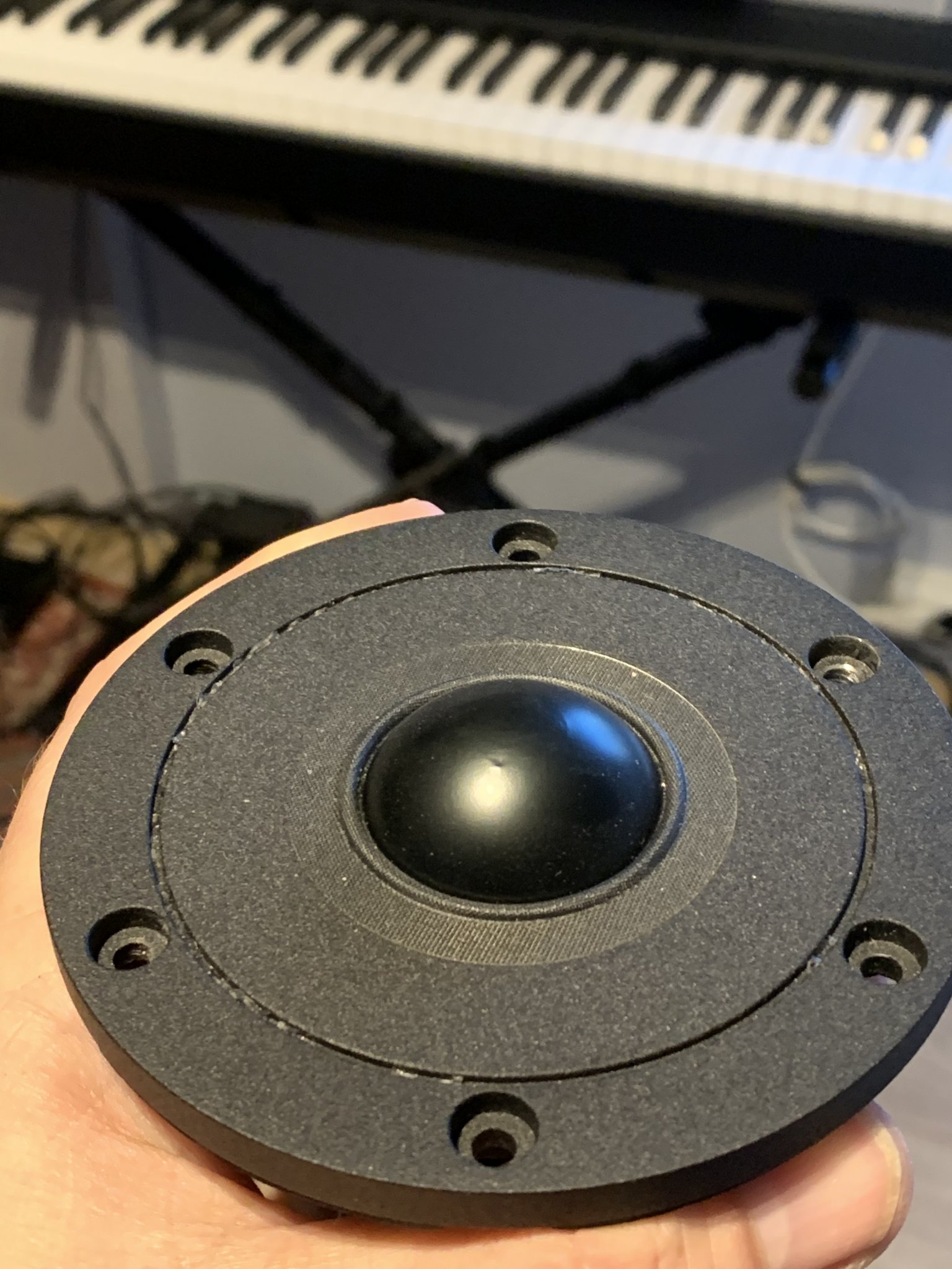

Well the shapes in the dome, matching the grille, clearly showed it must have been overexcursion. Low freq signal is only reasonable explanation.

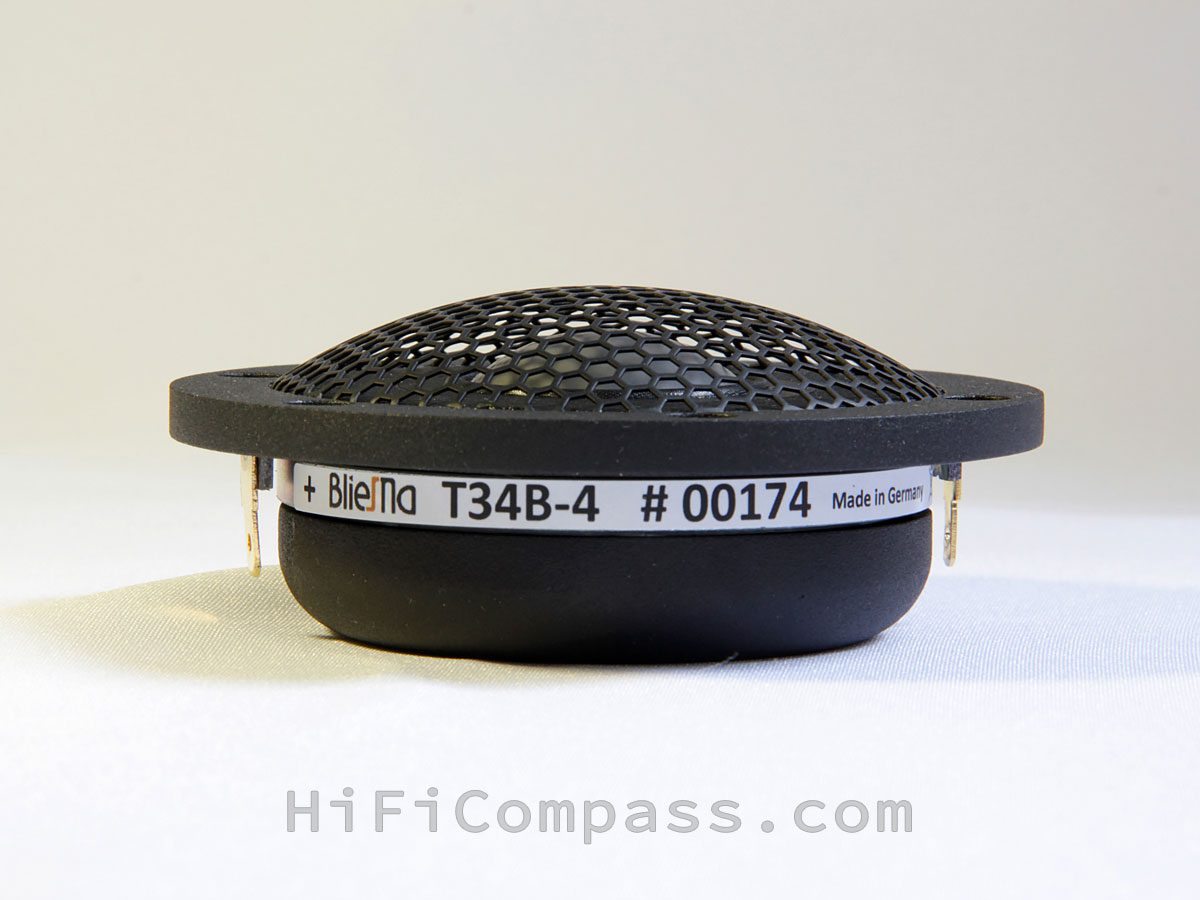

As for the T34B the dome profile is much shallower and much more difficult for it to happen, luckily as it would have shattered if the same happened.
Looking at the T34A because of the dome shape the clearance in front under the grille, is severly reduced in comaprsion too.

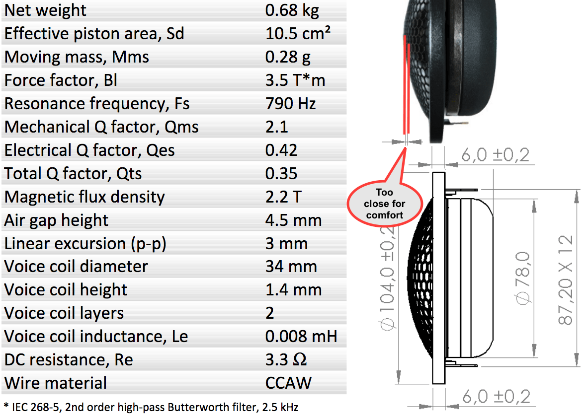

Sounds plausible for the damage done to the T34A-4 variable thickness aluminium-magnesium alloy dome.We think that any kind of low frequency signal passed like DC pop?
From the mechanical drawing, it appears the clearance between the dome and grill may be less than the 3mm peak to peak "linear excursion" potential.
The air gap height is 4.5mm, the underhung coil 1.4mm, so if the suspension does not stop movement, almost 3mm forward movement would be possible without the voice coil completely leaving the gap. From the mechanical drawing, the distance between the screen cover and dome is much less than that.
Standard aluminum domes can withstand quite a few beatings before developing cracks, considering there does not seem to be any wear marks, appears the aluminium-magnesium alloy is not so robust.
Since the tweeter's diaphragm is already cracked, would be an interesting experiment to see how much DC voltage is required to for the diaphragm to make contact with the screen. Short "pops" would be required to keep the voice coil from burning up, but my guess is less than 18 volts would be required to make a hit.

@weltersys is correct these 2 pics from hificompass clearly shows the difference in the tweeters so does the mfg spec sheets profile pictures, as quoted in the post above. Hence why this might happen to the A more easily, but with less catastrophic results.
Obviously also why the dispersion character is so different, and what makes them sound different too with room interaction etc.

I fully agree about the clearance and voltage required for the dome hitting the grille. That isn't a good design and should be revised. I would cut the OP a price break on the repair if I was Bliesma. Building a dome with that much excursion capability should factor in some leeway with anything interfering with peak excursion. Otherwise i love Bliesma drivers and think they're some of the best dome transducers available at any cost. I actually prefer the T34A over the T34B in some regards.Sounds plausible for the damage done to the T34A-4 variable thickness aluminium-magnesium alloy dome.

Having the dome hit the grille is a bad things for sure. The voice coil can still be damaged easily when it is forced outside of normal travel with a low frequency signal.

If it wasnt for the grill i am convinced that this couldtnt happen. If the LF signal dont damage the voice coil it the dome and the suspension can handle much more than we think. I have testet JBL 2451 with original titan membrane directly with heavy bass music with open back chamber (for fun). It was still working. And also mixed the tweeter and bass wire on a two way with Seas DXT alu dome for 20 seconds on moderate volume and It was measuring exactly like before the insidence.

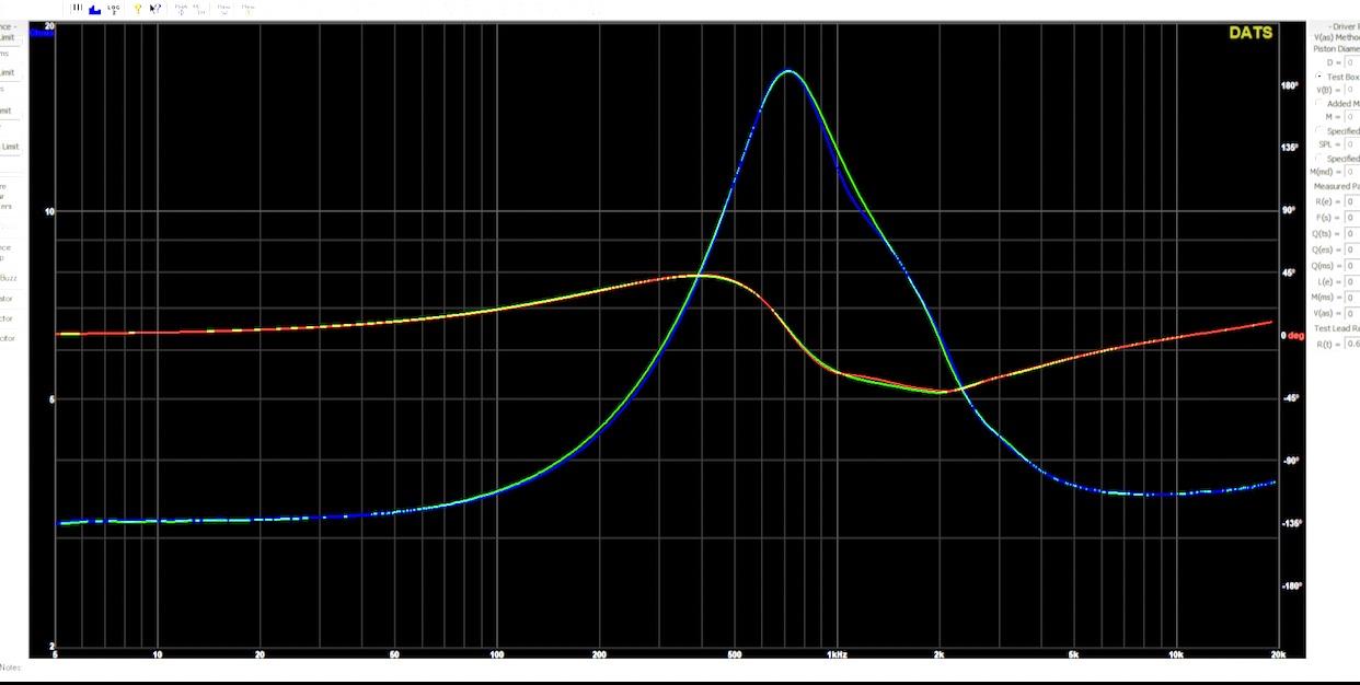

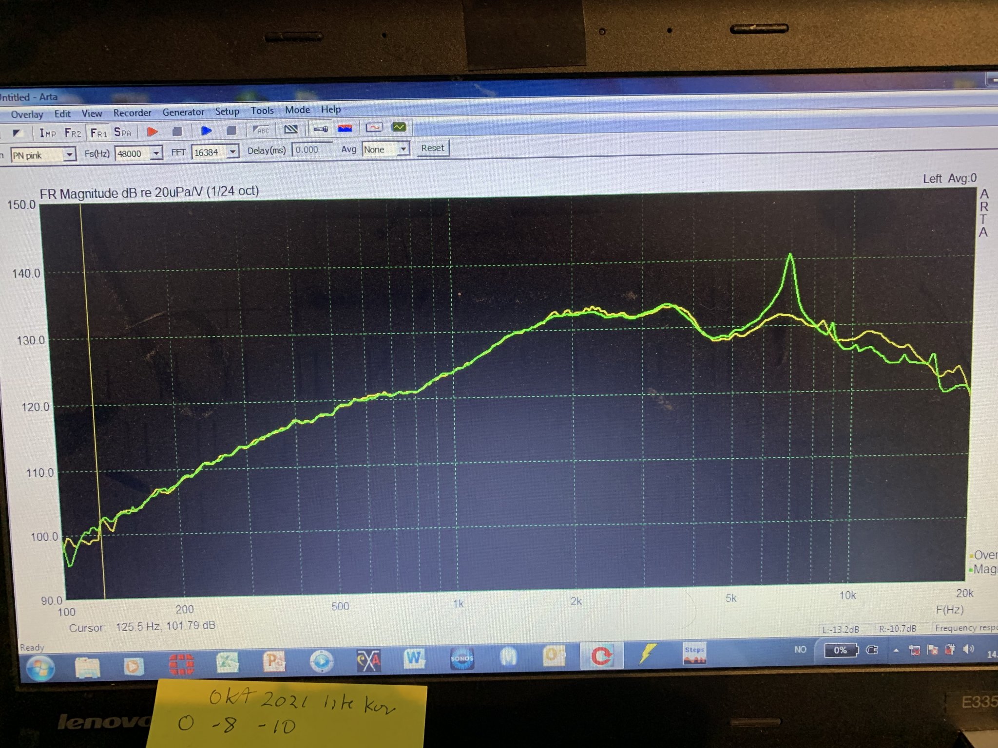

When i pulled out the damage in one of the tweeters with a little stick glue on the finger the impedance peak disapeard in both Dats and in ARTAs frequency response despite the small hairline crack of 2 mm.

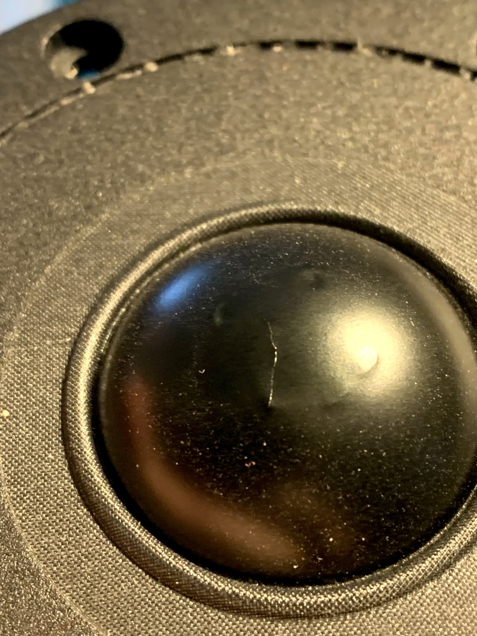

When i pulled out the sharp dent in one of the tweeters it got this small thin hairline crack.

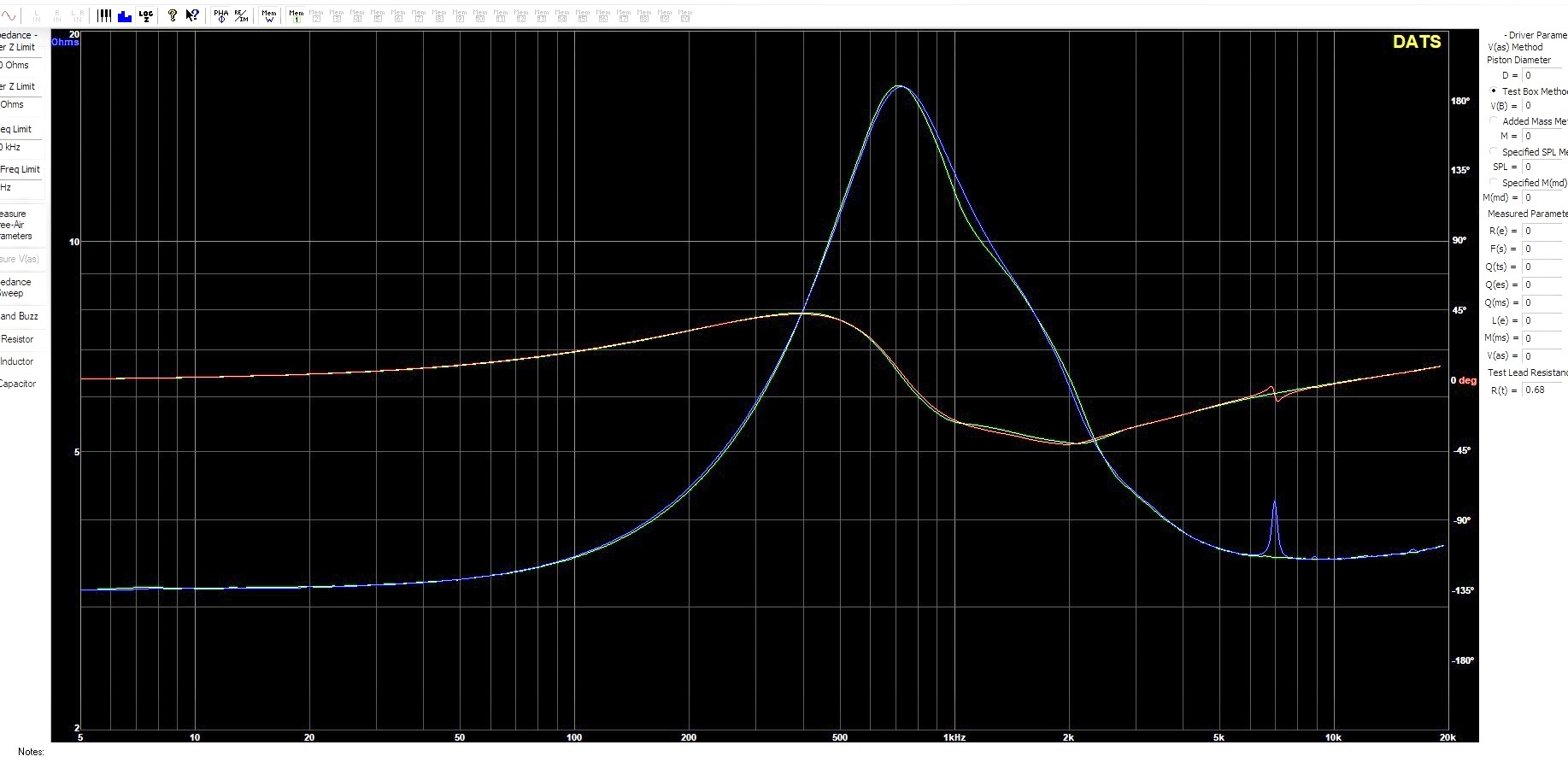

But then the impedance measurement got fine and the peak at 6500 Hz disapeared.
Strange.
This it the two tweeters, the one with the peak have still the dent.
Since it so expensive to fix it (freight and VAT to Norway comes in adittion) i will try to fix the other and se if it can be used. Maybee a distortion measurement is required also? Or that it can be used as a supertweeter over 10K?
Strange.
The hairline crack may be sonically harmless, or it may even have a damping effect. ScanSpeak deliberately slices their cone diaphragms to introduce a damping of the primary cone resonance, and a slice in a paper cone is very similar to a crack in a metal dome.
If the tweeter measures OK, then I would say it is OK. If the impedance curve, FR curve, and harmonic distortions are the same as original, no worries.
It is possible that the crack will grow as a fatigue crack. It will depend on the stress level in the material right at the crack tip when the tweeter is being driven. If it is low, the crack will not grow. There is no way to know this without a ridiculous level of analysis. So I would say just keep an eye on it. Take a good photo of it now, and compare the crack size in the future.
