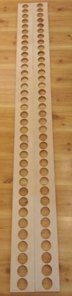

I don't actually need that much, want is another matter😀. hehe anyways kazap got me thinking. Going to pick up some 1/2" mdf to do some testing. Combined with reduced cutout size and 1mm reduction in CTC spacing I'm going to test if I can squeeze 36 drivers upright on my space. That seems like it might be the best compromise for the array I wish to build.

Final layout and sectioning
All fears gone! Made a test baffle 94.5" high and 5.5" wide. Looks like it will go in without scraping the ceiling therefore:
Per side:
- 36 drivers
- 6 drivers per sealed section.
- 6 sections.
- 65mm Centre to Centre spacing.
- 1/2 inch front panel and 3/4 inch everywhere else. Euro Birch used.
- 1/2 inch internal section bracing and routed out near the openings.
- Rough outside dimensions, 5.5" wide by 12.5" in depth and 94" height with out base.
- Pressure fit top and bottom with foam/wood base OR mount to ceiling.
Per section:
- 2 drivers in parallel + 3 pairs in series = 6ohms nominal for each section.
- speaker terminals to the rear for each section.
- No rear access panels. I will use a tool to tighten rear speaker terminals to enclosure after finishing is complete.
Total line nominal impedance = 9 ohms or 4 ohms depending on wiring. If shading required then each section will be connected to its own amplifier. Section delays and level reduction done digitally or at the line level.
Time to start the enclosure! This will take some time as I'm slow and don't have a lot of extra time to work on it. Will be using quick connects (without the plastic ends) to connect wire to the speaker terminals. Thinking grey enclosure to match the silver/grey of the SB65 cones........maybe black.......

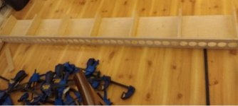

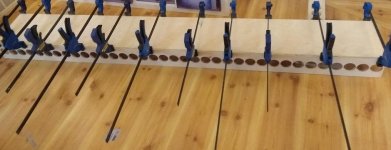

What do you think of the idea of building the enclosure from just one sheet of 1/4inch pre-sanded ply using Kerf bending and compound curves for rigidity and low resonance?
Hmmm... not so sure I agree you should wire 2p/3s per box. You now have a mathematically perfect 6s/6p option and I would wire each box all series and connect all 6 with a solid 10ga copper bus that runs through the holes on a 5way binding post all in parallel.
Good idea and one I'd like to explore at a later date but way beyond my mechanical skill level. The garage is not big enough to rip the 4x8 sheets of BB properly nevermind kerf cuts. There are some really great woodworkers on this site but definitely not me.
I almost want to contract out the enclosure out but I've collected too much of the material already. If I really mess this up I might have to do that in the end. This will be my first and last enclosure of this size hehe (I hope). Most of my builds are prototypes as I don't enjoy woodworking that much 🙂.
