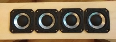

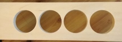

Attached is a comparison of size vs TG9FG. Also cutouts are 66mm CTC spacing and 2-3/8" cutout. There is a tiny bit of wiggle room at 2-3/8" cutout. Just enough to slightly move the drivers around. It is a tight fit and no room for cumulative spacing error.
These are small drivers and 3/4 front baffle thickness is pretty big so will probably go with 1/2 inch front baffle thickness and 3/4 everywhere else. Will have to route out a bit of the rear opening to ensure the quick connects fit and not rub on the sides under vibration.

Perhaps also consider a smaller diameter through hole but add reliefs for the basket webs (these extend enough to dictate a 2 3/8" diameter cutout) and the side connector tabs (these need 2 1/4" cutout to clear). If surface mounted on 3/4" thick material, the baskets would be blocked for their entire depth so the small speaker doesn't have much room to breathe.
If you are using CNC to cut the holes, then you can include reliefs, chamfers, and edge routing to mitigate some of these conflicts yet maximize the mounting landing pad. I'm on the side of reducing the through hole diameter to assure a good mount while adding reliefs where needed.
Of course if not CNC'ing the baffle you can use creative hand routing or a Dremel tool or manual filing to carve out clearance where needed.

Great ideas Jim Griffin. I will try the smaller cutouts tomorrow and clearing some material for the tabs. I will be using a router so maybe a template for clearing the wire tabs will have to be made. I will also move to 1/2 inch front baffle. The 3/4 when surface mounting seems like it is too thick.
Quick question, when mounting your drivers did you screw directly into the front baffle with wood screws or did you use bolts and nuts? Thank you for all the great information!!!
I used #6 size wood screws and mounted my SB65s directly to the 0.5 inch thick MDF baffle. No mounting with bolts/nuts for me.
The mounting holes are on 2 inch spacing around each SB65 driver.
I used 2 5/8" (66.675 mm) center to center mounting for my Modified CBT24 arrays.
