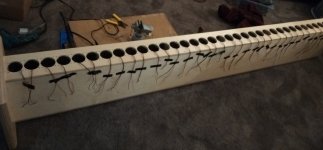

Thanks for the comments and discussion. The SB65 is a very delicate driver and if you don't watch the pressure on it, it may break. I didn't allow for wire strain relief in the enclosure as I chose to not make access panels in the back. If I do this build again (surround channels ?) I would make access panels for easier wiring as this is taking forever!!!
When I tried the different gauges and solid core hanging off the end of the SB65 terminals the thicker sheath and thicker gauge wiring seemed to put a lot of weight on the terminals. Since I've been known to attached thicker wires to pcb boards for testing and occasionally rip off pads due to wire weight I'm hypersensitive this so I've erred on the side of caution in hopes to not open the case again. Tracking down the problem unit will prove difficult.
What I've learned from this project is there are a number of additional considerations with the LA design that do not apply to your conventional speakers. With the added number of drivers playing the same frequency range and design goals there could be a few gotchas not easily anticipated. I'm hoping my wire choice is not one of em..
To shed some light on the system I've ordered 1200AS2 ICE power board for the LAs. Page 23 contains the amp damping factor vs frequency chart.
The foam came in and speaker 2 should be ready for driver installation by the end of the weekend! Will have speaker 1 wired up in 2 days!!!
P.S. Wiring takes a while and mounting screws have to put in by hand to watch the pressure on the frames.

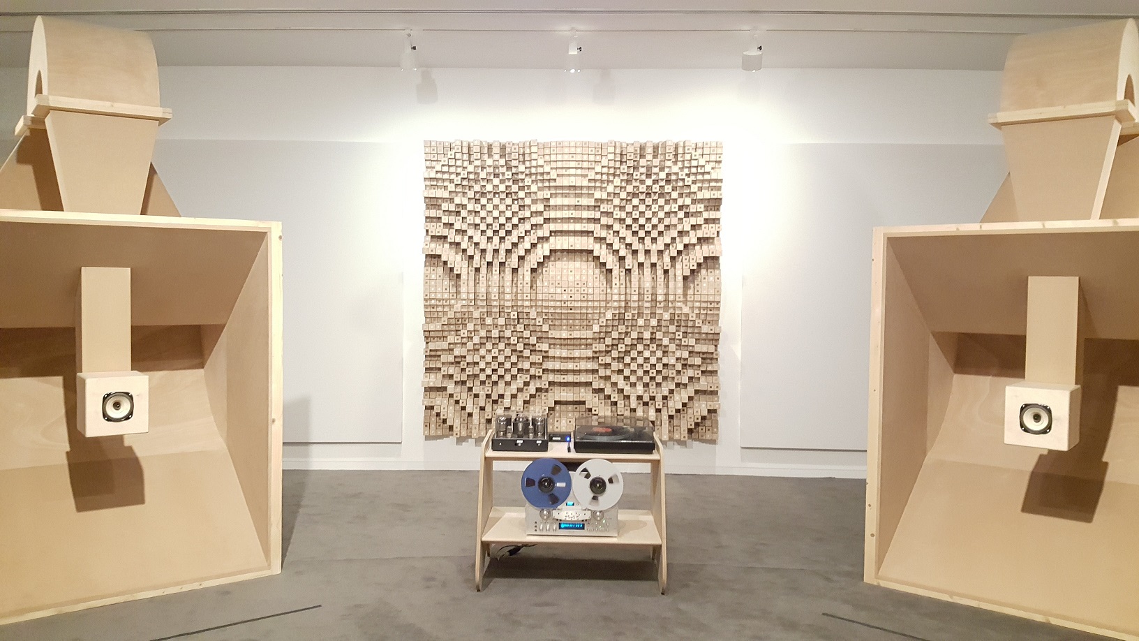

Was able to see this "art installation" at the Vancouver art gallery. Was in a large room and a bunch of diffusers with Tape and Reel, Vinyl and Tubes! Vinyl only allowed.

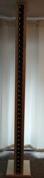

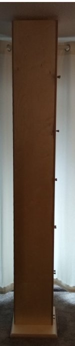

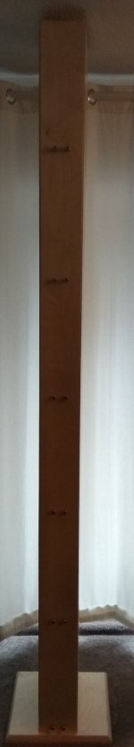

After an epic push, these things are labor intensive! The single sweep is the bass-horns that were in this room before the LAs. The dual sweep is L and R RAW frequency dependent window sweep. Phase between the 2 are pretty close. FIR phase correction was done on the bass-horn. Non-needed on the LAs for the phase to remain pretty flat. All sweeps done in the listening position. Fun is just starting.
With eq these get down to 30hz in room, I have a mode right at 30hz so this helps out a lot. Fullrange these sound a bit light. Blended subs at 60hz brings back the weight I'm used to; however, the subs smooth out a 60hz hole in frequency response the is deep and wide with only the LAs playing. Major room problem with all the speakers located in this area when only 2 are playing. Not sure how much the weight thing is due to the hole in FR at 60hz.
Quick comparison to the bass-horn speakers that were in here before. Lost a bit of sensitivity. Have to turn the volume up a bit more on the LA. They sound pretty close to the same. Both sound good. The LA are better at different locations in the room, not as much problem with off axis. The LA sound better at back of the room in the kitchen so that is nice. Bass-horn seem to image better in the sweet spot but the spot is smaller as compared with the LA.
These 2 speakers sound more alike than different. The controlled directivity vs wide dispersion sound different and the presentation between the 2 is a different but overall they both play very nice. The LA are easier in that eq is needed but no XOVER. LA need more power.
Only have like 30min listening on the LA so will spend some time tweaking and evaluating. The LA are very labour intensive.....like building 12 pairs instead of 1. Lots of material needed. The raw price difference of the 2 speakers is negligible.
Its neat hearing a 2.5" play 30hz lol
