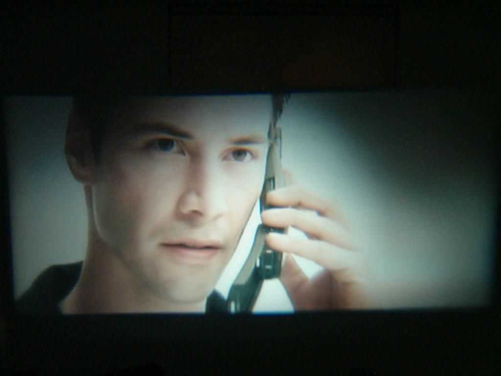

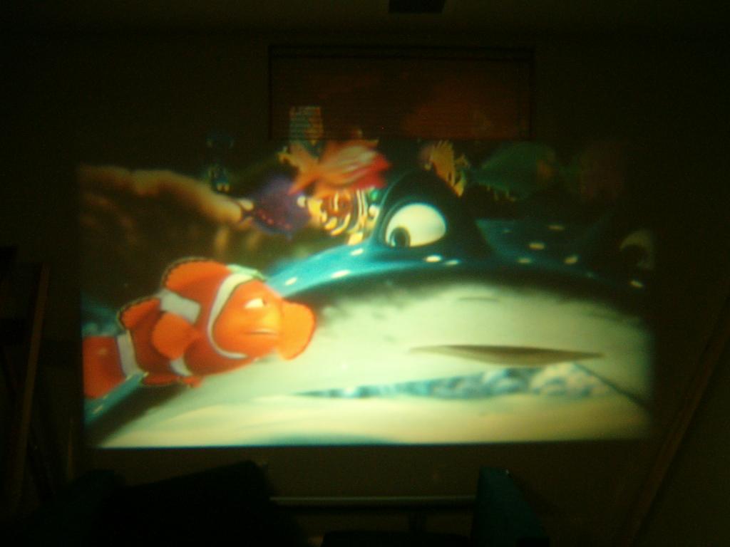

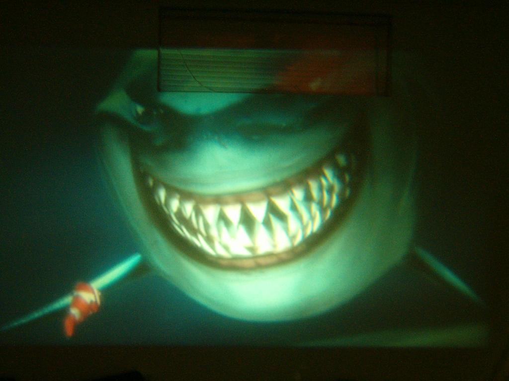

Here are my results after a few days with a Myron and Davis 7" LCD(1440x234res) This is 100" diagnal screen with a 175 watt halide. I used 2 page mags and a Kwik Kopy projector lens. The edges are a little dark but i think that's from the tube the lens sits in.(5" long) I'll post some pics of the inside after i'm all done building.🙂 Let me know what you guys think.
