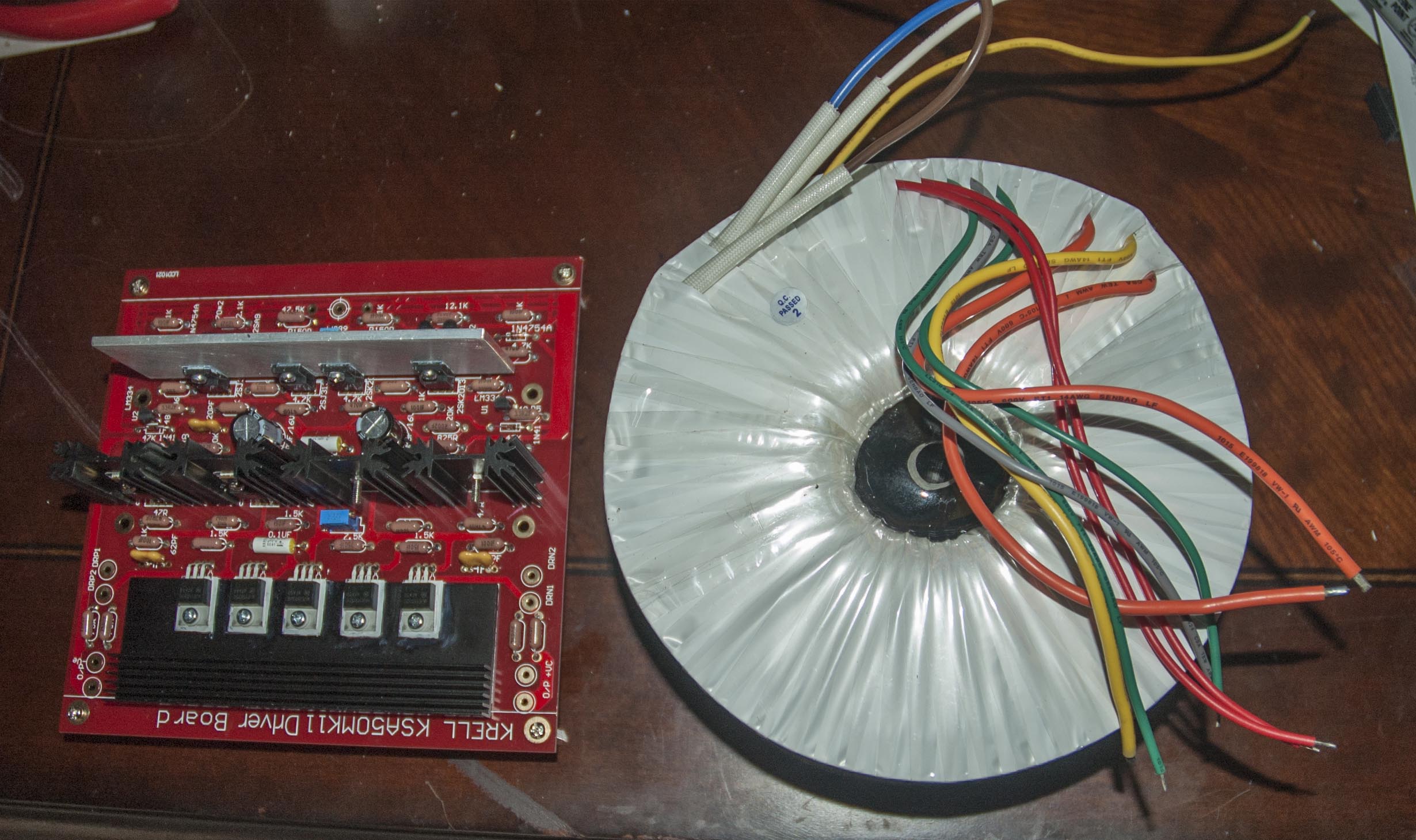

I made some progress aswell,. Will post some pictures of the KSA soon. Battery is low, so I have to charge them.
Dean, I bought some Dale resistors and replaced some of the original ones Haha, I HAD to try 😀. To be fair, I can’t hear any difference between a board with Dale resistors and a board which still had the resistors on them which I soldred earlier. From the other hand, I have to say, the quality of the Dale’s is much, much higher. They are more rigid, leads are thicker and far much lower tolerances than the ones I soldred earlier when comparing values. I am happy with them.
I have also mounted the board to the cooling tunnels, wired the fuse box and wired the boards to the trannies. I used this config first:
Although I thought it looked very nice, I realised this was actually not preferable. Leads to the trannies were far more longer than when I would rotate the boards 90 degrees. So had to make a new plate and drill new holes, so I could rotate the boards 90 degrees… but I was bored anyway 😉
When testing the amplifier, it is even better! Previously when I cutted the power towards the amplifier there erupted a sort of oscillation, almost like a little canary flute, but there was not a canary here! Now the amp shuts down like it should, it keeps on playing for another 10 secs, sounds fades away and than gets distorted because the caps are at that moment almost discharged. Unbelievable how much current these caps can deliver.
But I have some questions which I REALLY hope someone can help me, yes some of you already predicted it, it gets HOT, yes like in the song from Arrow - HOT! HOT! HOT! For the fans: http://www.youtube.com/watch?v=OkGgdIBX1to
I attached a thermostat to the heatsinks with some thermal grease. When applying 500mV the thermostats (rated 75 degrees) kick after 30 mins in and would, if I had connected them, shut the amplifier down. The hottest part of the heatsink (at the end of the tunnel) gets about 40 / 45 degrees above ambient temperature when fan speed @50 % and bias @ 400 mV. The least hot part of the heatsink gets about 30 / 35 above ambient temperature.
But friends, what is safe? I’ve red the original KSA-100 uses 100 degrees thermostats. This would mean TO3 devices can reach 100 degrees before it cuts the power. Also heatsinks on the original KSA-100 are smaller than mine. From the other hand they are separated from each other which is better.
I use anodized heatsinks, the TO3 devices are directly attached (with a very thin layer of thermal grease) to the heatsink, so better thermal attachment than this is not possible.
How can I calculate how high the temperature may become? I know Tj can be max 200 degrees Celsius. I also know thermal resistance, junction to case is max 0,70 C/W. Rail voltage is + / - 51 VDC
I found this formula in the other KSA-threat: Tc = Tj - Tjc * P
Tc = 200, but let’s be on the safe side, 150 it is. Temperature in my case at, let’s say 75 degrees:
75 = 150 - 0,7 * X, so the power it can handle 107 W per device max? I don't really understand how to calculate it.

Hi guys,
I've done some further measures and digested some reading food 😀 I've experienced that airflow is actually decreased with the push pull system. It seems that the outtake fan is blocking air that is blown towards this fan. I got more airflow when using one fan. Unfortunatelly haven't got a nice temperature meter, otherwise I could measure temperature more accurately and see if there is a difference in temperature.
Temperature difference between the outher sections is about 10 / 15 degrees. I used the so called 'finger method'. When you can put you finger on the heatsink for more than 30 seconds, temperature is about 60 degrees (or less). I can do this at the intake, but not at the outtake (which is about 75 degrees).
Now it is really hot here in Holland, especially at my room, it is a great time to test for extreme circumstances. Actually I don't experience sonic difference between 400 or 625 mV bias, so that is a good thing. Would also be logical, because bias has to be slightly more than than the power the amplifier has to deliver at that moment. Since I don't listen at very high volumes, using too much bias would actually be wasting energy.
But aside from that, this stuff strongly appeals to me, so I realy want to know how it works 🙂 I've done some calculations, hear me out :
1. Total dissipation: since it is class A, the more power your speakers absorb, the less heat, because power is now not dissipated, but used as sonic power. So total dissipation is (I think) (railvoltage (VDC) * bias (ampère)) - ((output voltage (AC) * sqrt(2))^2 / load (ohms)). I assume there is no load from here, all power is transfered into heat, so 51 * 0,4 = 20.4 W per device.
2. So total dissipation per channel = 8 * 20.4 = 166,4 W
3. dT = Theatsink - Tambient = 75 - 30 = 45 degrees Celcius.
4. C/W - value of the heatsinks is thus: 45 / 166,4 = 0,27
5. Tr from MJ15003/4 = 0,7 C/W, C/W heatsink = 0,27, so total = 0,97 --> so 0,97 * 0,4 * 51 = 19,8 C. Temperatur inside is thus 75 + 19,8 = 94.8 degrees. Yes, that is hot, but far under 200 degrees for Tj.
If the above is correct is isn't that hard to calculate max bias:
Lets say Tjmax is allowed to be 150 degrees to be safe.
bias (mV) * 51 * .97 + .7 * bias (mv) * 51 = 150 degrees C.
bias (mV) * 49.47 + 35.7 * bias (mv) = 150
bias (mV) * 85.17 = 150
bias (mV) = 150/85.17 so bias can maximally be 1,76 V.
Big chance I did something wrong 😀 Hope someone can guide me on the right track.
