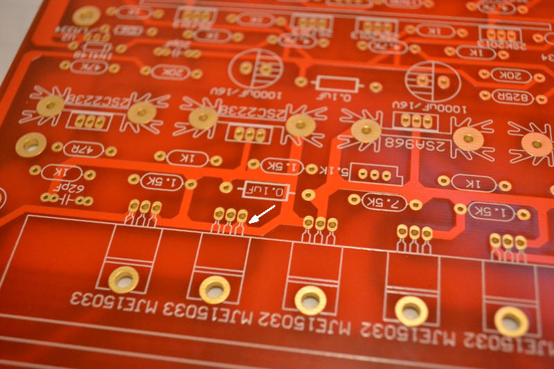

Like you all can see in the previous pictures the setup right now is far from ideal, but luckily it worked to test the lot 🙂. Due to the bad wiring I was very suprised that there was no audible hum. Especially grounding is far from ideal right now. When I connect the oscilloscope to the speaker outlets, little hum arises because of a groundloop that is formed (the oscilloscope is grounded aswell). That is also why I have to measure very carefully and one channel at a time because both channels are not galvanic separated in the oscilloscope. Momentarily the only grounding point is at the chinch connectors from the pre amplifier. So at the end of the signalcables. I use an Accuphase E204 which I restored last year (yes I am very spoiled with that amplifier haha) as pre amplifier. The signalcables are very thin á la liquorice lace, long (almost 5 meters, so you can imagine how thin the shielding and thus grounding cables are) and cheap but it seems that this cable was usable for testing. It is almost unbelievable that there is still room for improvement while it sounds so good allready. There is a reasonable chance the amplifier will be even better because in the final setup the cables will be far more shorter and thicker.
@David (Spurtle); you're welcome! 😀 I did not mentioned the missing track till I tested it. When I relooked to some of the pictures which I made at the start of the build I saw the track was really missing.
Dean (Neychi) has a blue version of Jim's boards. Dean showed me that his version has the track. There is a good chance that, when you have blue ones, this track is on your boards aswell.
When using both channels the heatsink gets hot, while when using one channel the heatsink does not seem to care. I would estimate about 60 degrees @ 400 mV bias when using both channels. From the other hand room temperature (@loft) is exceptionally high right now. Very nice wheater in Holland. The trannies at the intake of the tunnel are pretty cool (50 degrees or so), but at the outtake the trannies are hotter (would estimate 60 / 65 degrees) which AV werk mentioned earlier in this threat. So I think that it will exceed the 75 degrees when mounted in the cabinet, fans on less speed and higer bias. When that is the case, I think that I will change the thermostats to 85 degrees devices. But I have to measure temperature when mounted in the cabinet. Maybe I can borrow a nice temperature meter from University (they have very nice Fluke equipent over there

I got a hold of Jim's Audio and his reply is "Dear sir,Thanks for the replies guys!!!It is so nice to see it work.

Thank you very much for letting us know of the error. I am myself surprised that there is no connection there. On inspection it seems a gerber error that waw not there in the previous version. If you look on the top side, the disconnected MJE15003 left-most pin should be connected to the track running below it, but the link is missed. I will check with the PCB vendor why this had happened. And I will absolutely revert to the correct one in the next spin of production. Thank you again for the information. I appreciate the diyaudio forum have made this a more perfect board.

Good job David!!! I also got a reply from Jim:
Thank you very much for building the boards with patience and shared your experience with other people. I have checked the board, and it seems to be an error that happened during PCB fabrication, since in the first log of boards ( I built two logs, and the first log was done in 2007 - 2008) there is a link from the track ( right below the transistor MJE15033) to the base lead of this transistor. I need to check with our PCB vendor why this happened. But I thank you for letting me know this otherwise I thought the board is as good as it has to be.
Nice that this mystery is solved 🙂!
By the way David, there is another thing you have to take into account. Around the holes which are meant to attach the MJE15033/32's to, there is a conductive ring:
When you attach a non isolated / non anodised heatsink, which means your heatsink electrically is conductive, chances arise that your heatsink will make short circuit due to a connection with these holes. This holes are connected to the the collectors of all MJE15032/33 devices. Short circuit between the collectors is something you definetely don't want, because your power lines will make short circuit also (V+ and V- are attached to the collectors). So you have to isolate the heatsink from this rings aswell, or use an isolated heatsink. I took no risk, so I chose to remove the conductive layer on the surface around the holes in the front by drilling very carefully the little conductive surface away. Worked like a charm 🙂.

I was realy nervous when powering it up. I've hooked the dummyload together with a Zobel network to the outputs. This was it, was al the effort I've made going to pay off, or did I make a nice piece of expensive firework. With a fire extinguisher in my left hand and with my right hand across the dial of the variac, I slowly powered it on. Hmm, no fireworks... that seems good. And It kept good!!!
But there is a but friends, I got no bias to one halve of the MJE15004's. I discovered a little mistake on Jims boards, there is missing a little track from the emitter of the middle MJE15032 to the MJE15033 compaired to the original. So I had no bias on connection DRIVE P1. But that was fixed easily with a little wire:
After fixing this, there was also current from DRIVE P1. Everything seemed to go OK so I pressed the proverbial gas pedal a bit more ;-). Freakin unbelievable how much power it has. I've measured 40 VAC max output across 8 Ohm load!!! I was able dial the DC offset to 0 mV very easy. Bias spread is about 10 mV across the different TO-3 devices. Not bad, I since I have not matched the devices 🙂.
After some testing (it was 2:00 p.m. already) it was time for some music! It's is unbelievable how it sounds, I try to be as objective as possible, but it is so dynamic, so much power. No hiss, no hum, nothing!!! I've set bias to 450 mV right now. Fans are running full speed right now (fan control is not finished yet). For Dutch standards today is pretty tropical, it is about 26 degrees outside and here in house it is almost 33 degrees. But despite of that, the tunnel cooler gets mildly warm.
