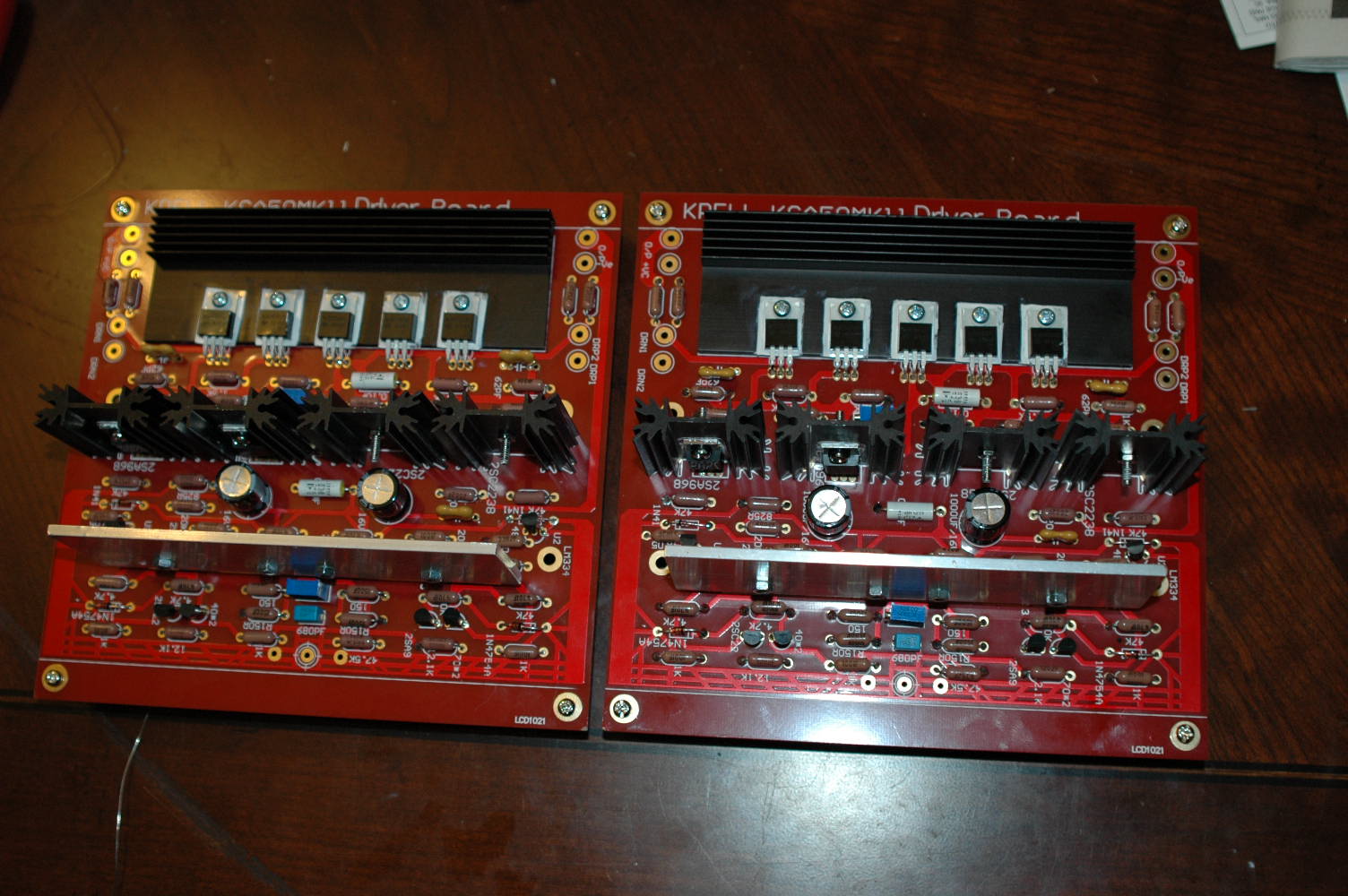

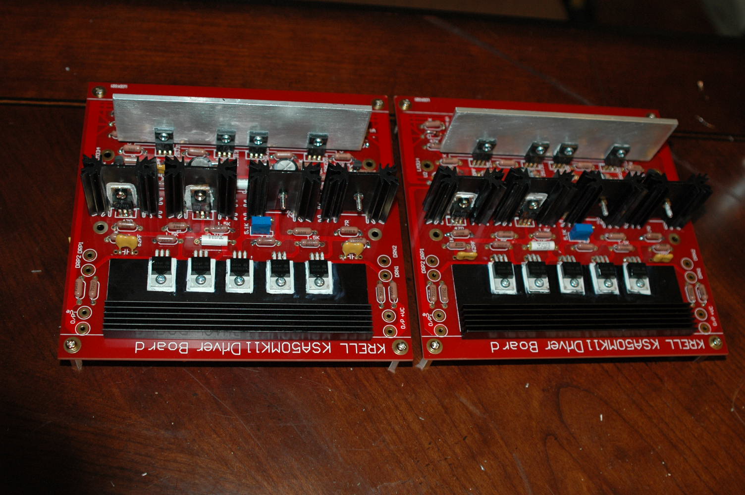

It may seem that there is a lot of white grease on the transistors, but believe me you that I did not use the stuff sparingly. Very thin coat of the stuff. I ordered that can type caps yesterday and will order the 40volt 1000kva transformers tomorrow. I had a time soldering the 2SJs and 2SKs. The trans' leads wanted to cross solder together easily. Had to desolder two legs twice and will have to buy stronger reading glasses check for cleanliness. Again, I would not have gotten this far without you guys. Should I remove the excess resin? David

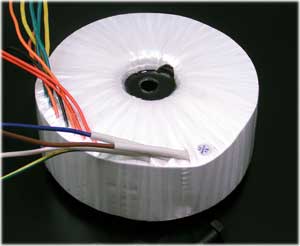

Transformers
Here are the transformers (DIYCable.com : Intro » Home » Exodus/Hypex Amps » Amp Parts »), I am looking. They are only $65.00 USA each and come with extra low power secondaries. But here are Antek's (https://www.antekinc.com/pdf/AN-10440.pdf) transfos. They are $100.00 USA. The diycable.com transfos are for their subwoofer amplifier and have 1amp lowpower secondaries (13-0-13 @ 1A and 0-16 @ 1A)while antek's are 0-12 @ 2A and 0-18 @ 2A. I would be saving $70.00 for the pair with diycable's, but the Antek's secondaries can push 2Amps. What do you think? I just wanted your opinion about which do you think would be the better transformer for the Krell, the soft-start and speaker protection and will need the 2 Amps?
