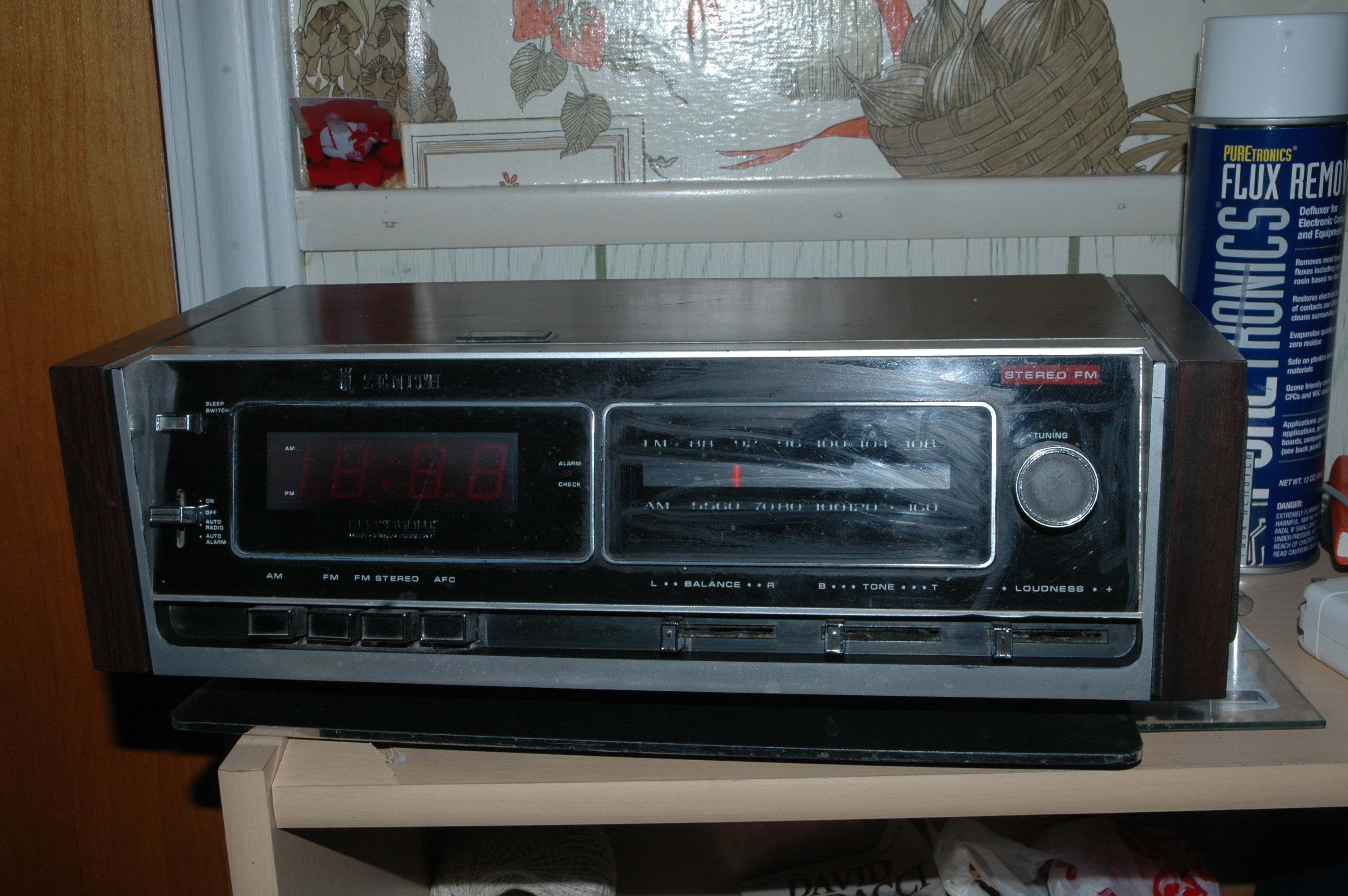

Nice radio David! 😀

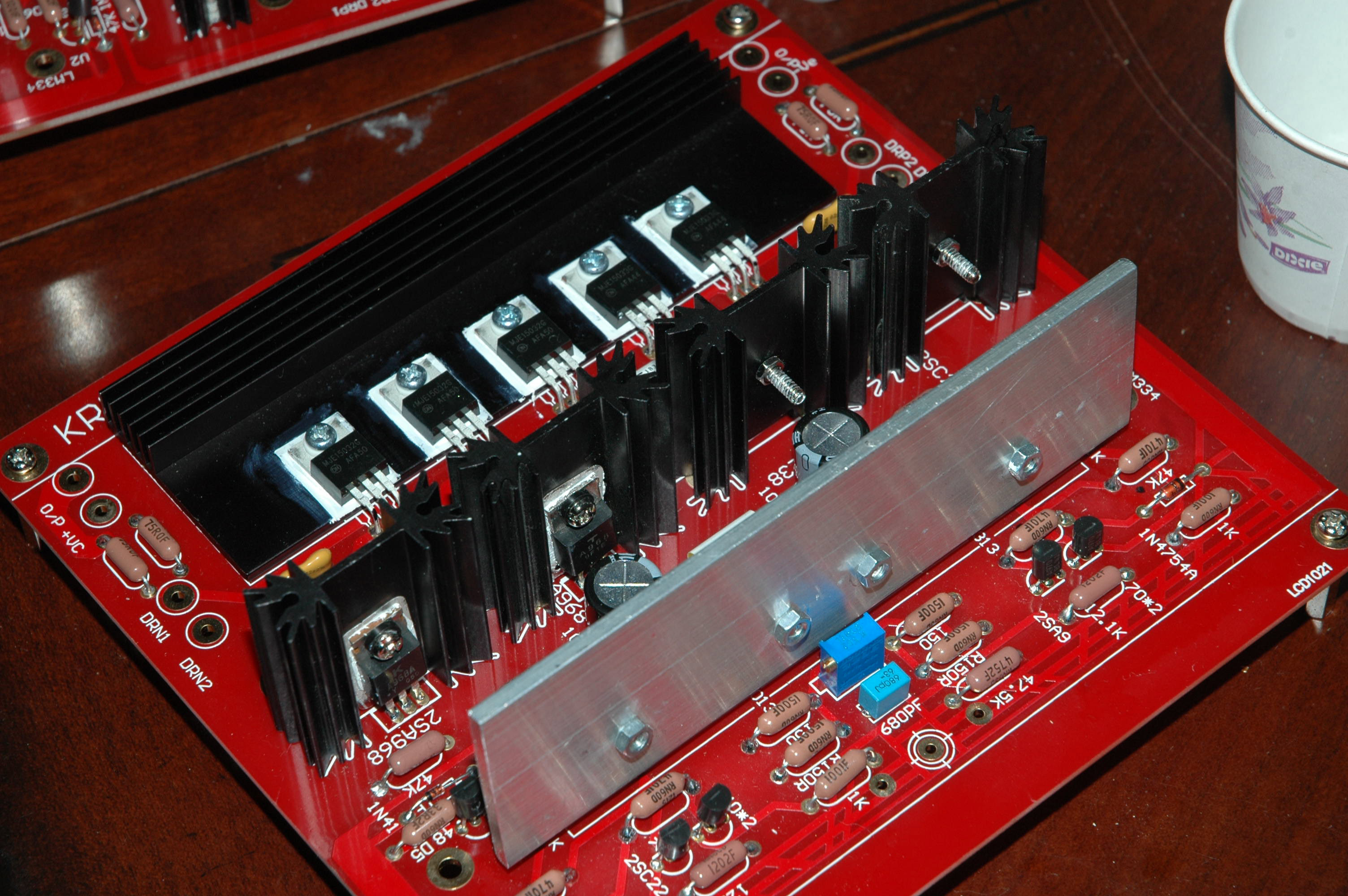

I am afraid I have some bad news, but when I see the 2SA968's on your board I think they are not original Toshiba. Especially the right one seems to be fake because the Toshiba logo is printed on it. Original ones look different. Original ones with the T Toshiba logo should look like these: http://michaelq.home.xs4all.nl/Projects/2sa2sc%20(2).JPG
Yes David, I'm afraid Michael has right. The left one could be original KEC, but the right one is probably a fake. It will be a shame to spoil such a beautiful amp with a nasty components. It could work, but how...that is the question.
Btw Michael, genuine 2sa968/2sc2238 came with two Toshiba logos, old T and...
Hmm, I hope David did not buy the MJ15003/4's from Ebay also. Buying trannies from Ebay is very risky. Best is to buy from official partners. Like Digikey which is a official partner from ONsemi.

David, don't mess up with transistors of suspicious origin if you can't get the real mccoy. Get 2sa1011/2sc2344 like I told you. Mouser is no guarantee that these are the original transistors. A few years ago I ordered via RS Components Toshiba's 2sa968/2sc2238 and got Magnatec. They work fine but these were actually 2sa1011/2sc2344 transistors with polished front and re-printed logo and product labels. I've made a comparison. I even went well, but their price was pretty high and I could get a two original transistors for price of one. Just be careful.

I could not agree with Dean more 🙂 I have very bad experiences with cloned / fake transistors. Repaired a Denon PMA-920 once. Replaced the original Sanken outputs for ISC's. 5 seconds full power at the dummy and BOOM. Sliced the trannies open, and.... well see for yourself, compaire the dies (left ISC, right good ol' Sanken):
That little joke made the repair even more costly, could replace the drivers again, and now the biastransistor and emitterresistors were broken also.
2SA1837/2SC4793 are not direct substitution, 2sa1011/2sc2344 are.
