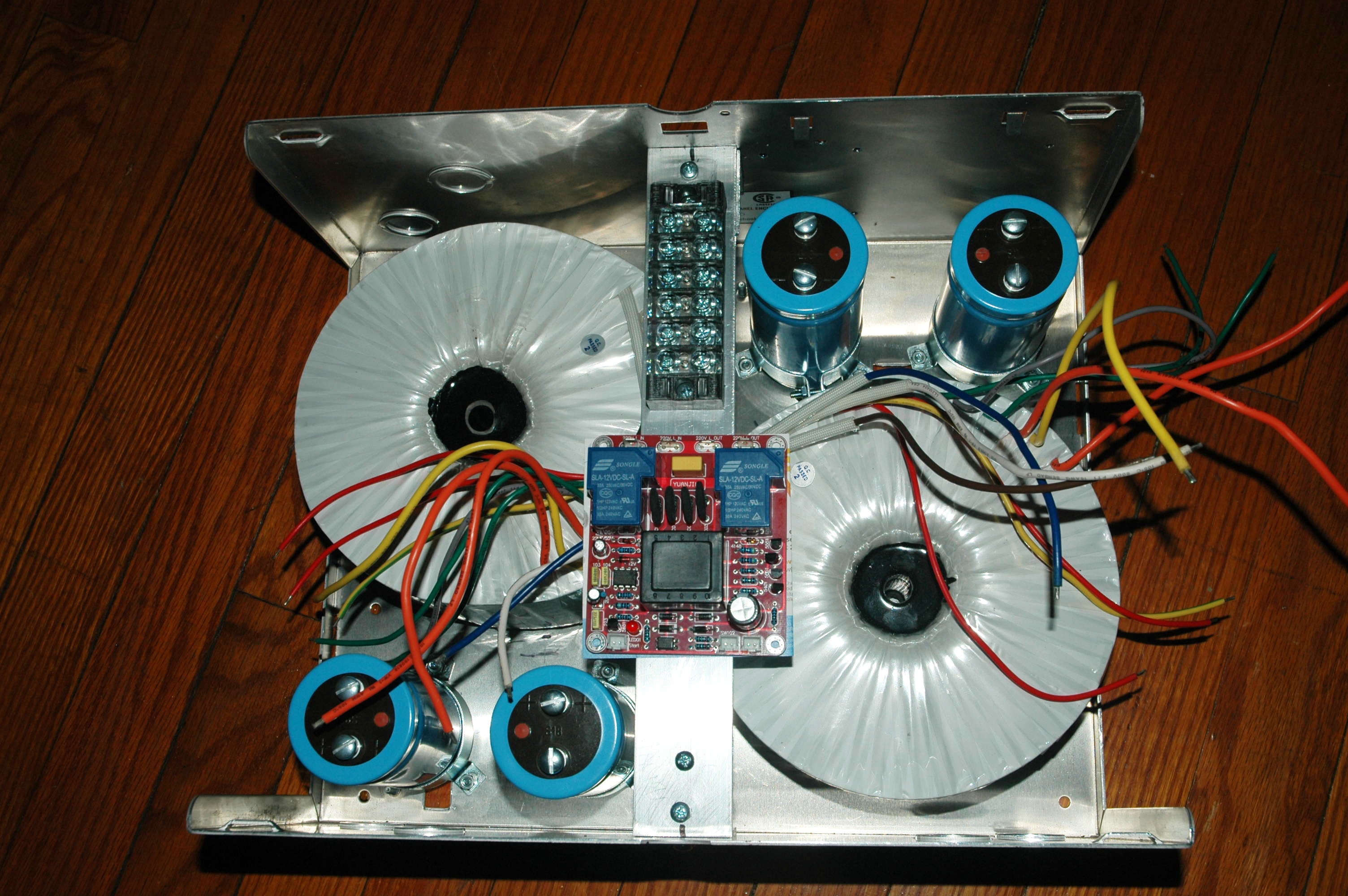

Wow, when you see it in this perspective those transformers are really huge! I like them. Will that become the PSU-box for the KSA David?

I paid $65.00 US for each. They weigh close to 22 pounds US. The websiteWow, those transformers are HUGE!!!😱. How much do they weight? what are the spec for them?
DIYCable.com : Intro » Home » Exodus/Hypex Amps » Amp Parts »
for the specs. They are used in their bass amplifiers.
PSU-Box
I hope so. It's not too much? My growing muscles are over. I want to use my brains for now for a change and let electronics do the work. It was really cute how the soft-start had a tiny jumper from PP to 220v and I had to resolder the little jumper to convert the soft-start to 110volts. The PSU-Box is very tight with those transformers, so I created a bridge across the inner-box so I can attached the terminals, soft-start and maybe the bridges. Tomorrow, I will go to the scrap metal yard to find some copper plates to run across the neg poles of the can-capacitors. Sleep well and have a good day, DavidWow, when you see it in this perspective those transformers are really huge! I like them. Will that become the PSU-box for the KSA David?

Nice toroidal transformers you have there
Where did you get those beauties?
Will you use NTC for inrush current delay?

Andrej, as I can see spurlte has soft start with NTC resistors. In the center of the first picture😉

NTCs
Andrej, look back a few pages and you will see the url for diycable.com and we are using a soft-start with NTCs, relay and temperature protection.Hi Spurlte 😉

I,m surprized your putting 2 toroids in one box. Why not build seperate monoblocks with short supply connections to the boards?

I could do that but I wanted the TO3s in it own environment with its own cooling system. The PSU will be right next store and the supply connections will be short. I may even put a sheet of electro-magnetic shield of MU-metals between the two chassis and have them tightly sit together with very short connections, but you do have a point thank you. I was just thinking of the dust and the interference from the transformers and cooling fans and the added heat. Once I built this beast, it will stay in one place in my finished basement. The KSA-100 will generate enough heat during the winter as I build another project. Hopefully a speaker system to tame this beast. Any suggestions?I,m surprized your putting 2 toroids in one box. Why not build seperate monoblocks with short supply connections to the boards?

If you could possibly fit the two transformers on top of each other and wire the mains anti-phase to one (or turn one up-side-down) then any stray magnetic field would cancel and muMetal may not be necessary at all.
Every mono I built I put the toroid up against the front panel with the caps and bridges behind that with the board at the back or middle vertically.
All in an goal to minimize wiring to its shortest length possible. You also by default, get maximum electrical isolation for each channel.
This also allows short speaker cables with your amps close to your speakers
Never had any hum or negative interaction from the PS ever
Thats my way, but its your build and at the end of the day, its your creation!
