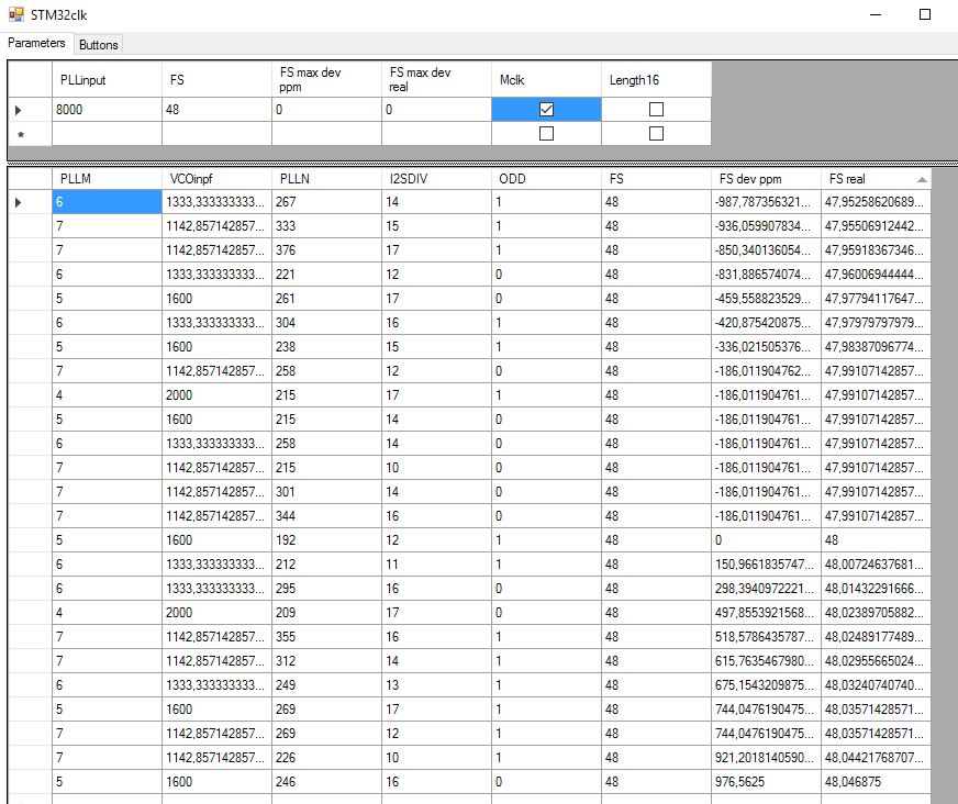

from 26.6.3 Clock generatorWhen the master clock is generated (MCKOE in the SPIx_I2SPR register is set):
fS = I2SxCLK / [(16*2)*((2*I2SDIV)+ODD)*8)] when the channel frame is 16-bit wide
fS = I2SxCLK / [(32*2)*((2*I2SDIV)+ODD)*4)] when the channel frame is 32-bit wide
When the master clock is disabled (MCKOE bit cleared):
fS = I2SxCLK / [(16*2)*((2*I2SDIV)+ODD))] when the channel frame is 16-bit wide
fS = I2SxCLK / [(32*2)*((2*I2SDIV)+ODD))] when the channel frame is 32-bit wide
1< I2SDIV < 255
And I2SxCLK is
VCO output frequency = VCO input frequency × PLLN with 192 ≤ PLLN ≤ 432
VCO input frequency = PLL input clock frequency / PLLM with 2 ≤ PLLM ≤ 63
So quite a few possible Fs
The relevant frequencies must be precalculated with the closest other frequencies also calculated. (can be total different sets of PLLM, PLLN, PLLR, I2SDIV and ODD)

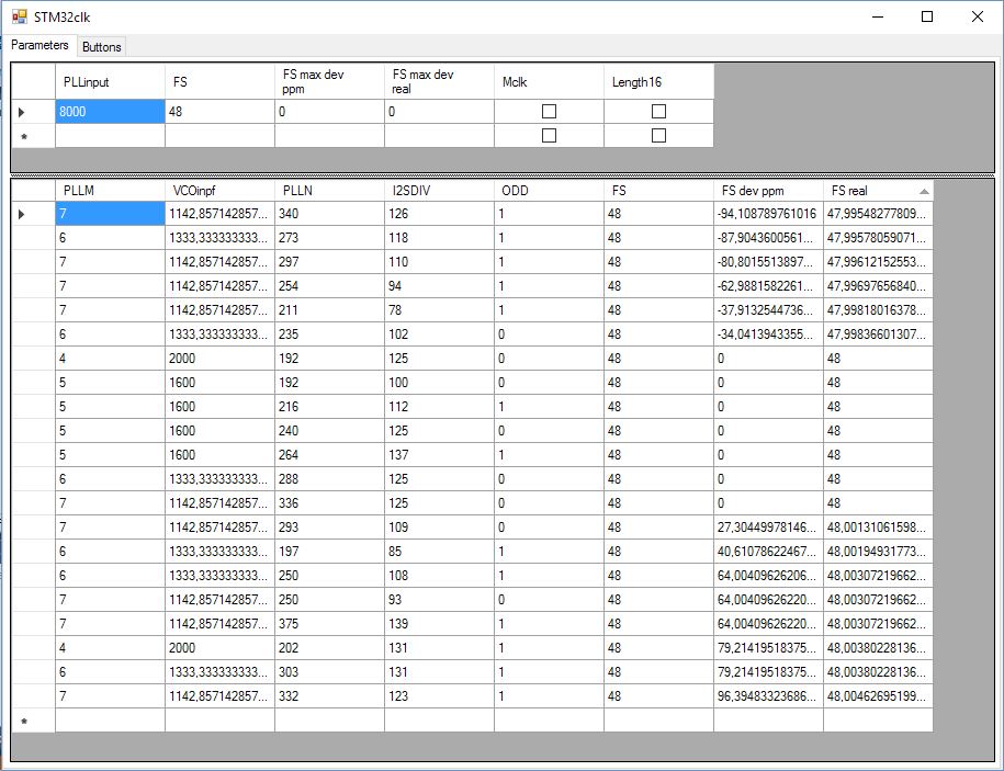

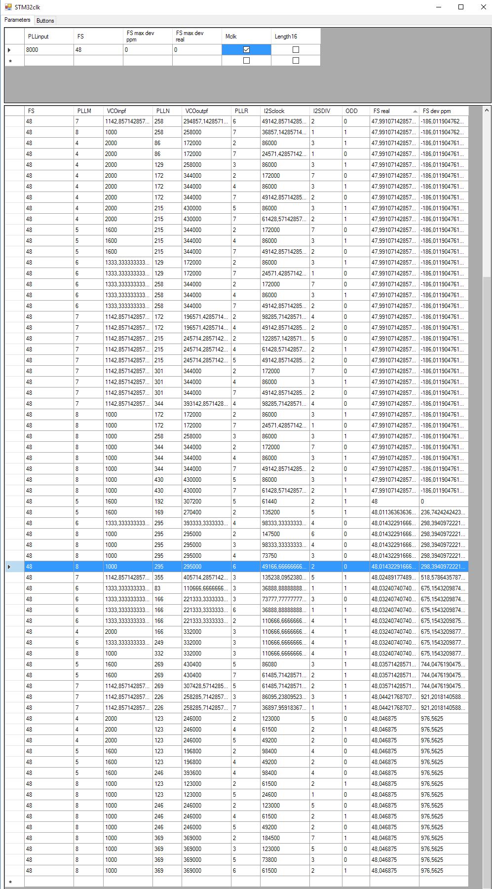

Regarding SPDIF sync:
The picture shows thet there are quite som divisions that can give a almost exact mach of frequencies. In addition samples can be replicated on zero crossing when needed.
"Almost exact match" is not enough, and estimating it once isn't enough. Take a real SPDIF receiver and a frequency counter and give STM32Cubemx a shot. I'm not the man from La Mancha, but if you get the job done using those bare integer dividers and multiplier let us know.
Even if I think it is possible to go to the moon, it don't mean I can do it myself🙂
But I have thought about of making a program to calculate possible frequencies around the normal samplefequencies. I tried so google such a calculator, but could not find one.
Thought about your case of 50ppm drift. That should be 5 samples a second for 100k SF.
So the SF delta must be possible to adjust 50ppm or a puffer that handles 5 new samples each second must be set up.
This can't go on forever so my startegy depends on that samplerate can be changed without droppout artifacts.

The picture shows different possible FS values inside 100ppm of 48k.
That is max 20 samples/sek drift. So drift can be much lover than that.
About 30 ppm resolution or 6 samples/sec

The resolution of output SR can be calculated. That will deside the length of needed buffer
So the stretegy can be to:
Measure input samplerate with with5 or TLO and THI or spdifrx_frame_sync and timers.
Set PLLR to closest samplerate.
Every 0.1 second: Measure input samplerate with spdifrx_frame_sync and timers.
If buffer to small or input/output difference can be smaller find new output samplerate and set PLLI2S.
When PLLI2S has settled switch output clocksource.
At next adjustment, set and switch to PLLR and so on.
To me it looks like a swing of about 100ppm is doable. That is 10 samples at 100k samplefrequency. And 0.1 ms delay.
Maybe around 1 ms buffer is safer...
