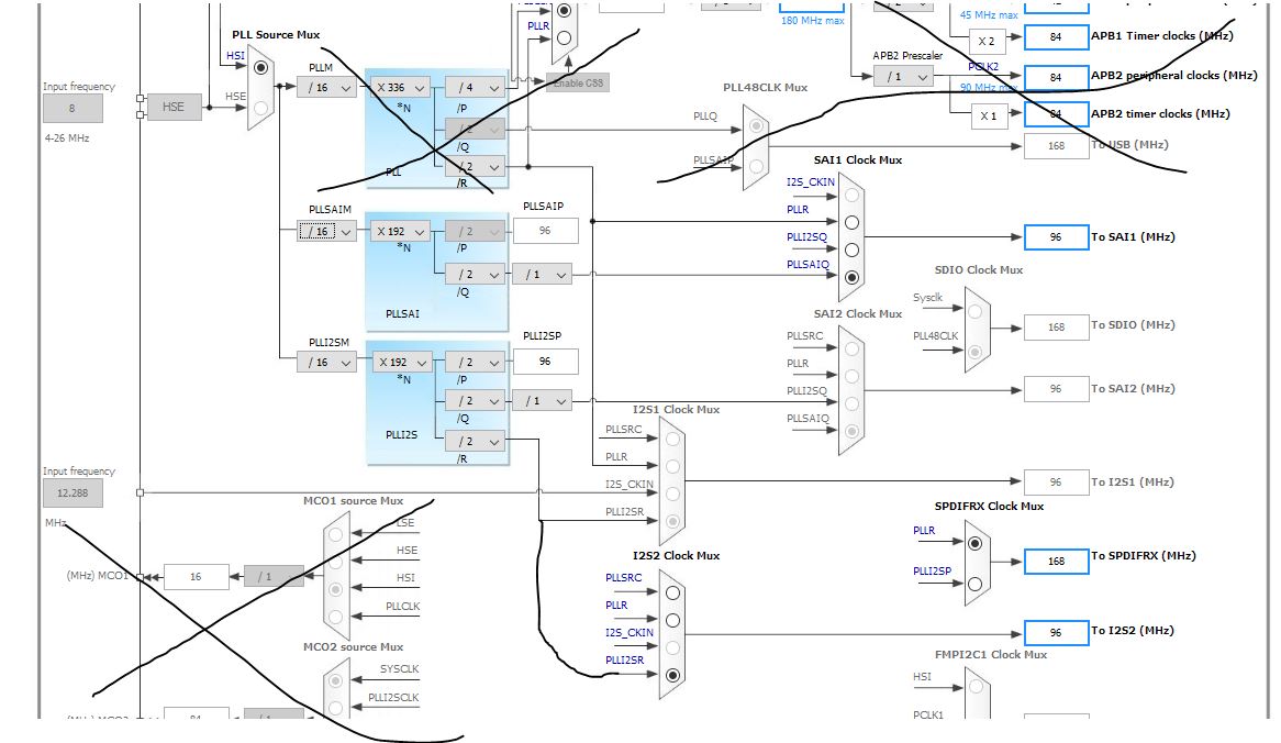

Regarding SPDIF sync:
Input frequency of SPDIF in can be measured by the spdifrx_frame_sync and timers. Then the clock can be set for the same output frequency.
Measuring for 0.1 second gives quite accurate value.
Then the output masterclock frequency can be set and output turned on.
The audiostream don't have to be delayed, just muted for the first 0.1 second.
The picture shows thet there are quite som divisions that can give a almost exact mach of frequencies. In addition samples can be replicated on zero crossing when needed.
