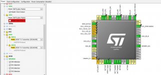

I am afraid the 4xspdif is 4 SPDIF lines where 1 line can be chosen (MUX).
So only 1 SPDIF input at the time unfortunately.
But it eases the making of an input selector....
(The SAIs can be configured as SPDIF transmitters (only 1 pin used) but not receivers and of cource as PCM/TDM, but I think that will be on expence of a I2S as it is only 64 pins)
Regarding STM32F446 I cannot find how to use the S/PDIF for processing (S/PDIF input to SAI output). There is no recovered S/PDIF MCLK output neither the SAI PLL's cannot be synced to S/PDIF. Only if you run SAI's as master and your external S/PDIF source can be synced as slave to your clock (word clock or super clock = mclk) then it can be possible.
"The SPDIFRX offers the possibility to use either DMA spdifrx_dma_req/clr_d) or interrupts for transferring the audio samples into the memory. The recommended option is DMA, refer to Section 27.3.10: DMA Interface for additional information.
The SPDIFRX offers several way on handling the received data. The user can either have a separate flow for control information and audio samples, or get them all together."
The datarate can be read from the control information. And SAI or I2S master clock can be set accordingly
So with some buffering it could be done. But there are always some risk of drift between input and output. Maybe DMA interrupts can be used to calculate drift and then compensate?
Appearently ST has thought of sync:
"The SPDIFRX also offers a signal named spdifrx_frame_sync, which toggles every time
that a sub-frame’s preamble is detected. So the duty cycle will be 50%, and the frequency
equal to the frame rate.
This signal can be connected to timer events, in order to compute frequency drift."
