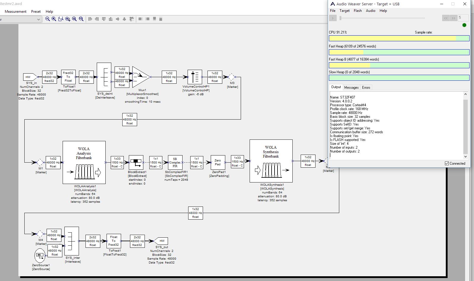

Had a little test myself.
The basic setup is fixed 48k SF USB out from PC. So a cheap USB soundcard.
The sound is OK. No annoying artifacts.
I was looking for cheap FIR for bass room correction. So high frequency resolution was required. And preferably low latency.
I have problem with getting the buffer up and down to work.
The workaround was subband coding, extracting lowest band and padding the rest.
Then I got the lowest subband (1500k SF) channel only FIR size up to 2048. So 0.75 Hz frequency resolution. Not bad for a 15$ card.
The problem is how to get to use the I2S inn and the free version of Audio weaver....
For experimeting it is excelent.
Enclose a the files + a basic FIR (short latency) also
  • M4FIRtestmr2.zip
    M4FIRtestmr2.zip

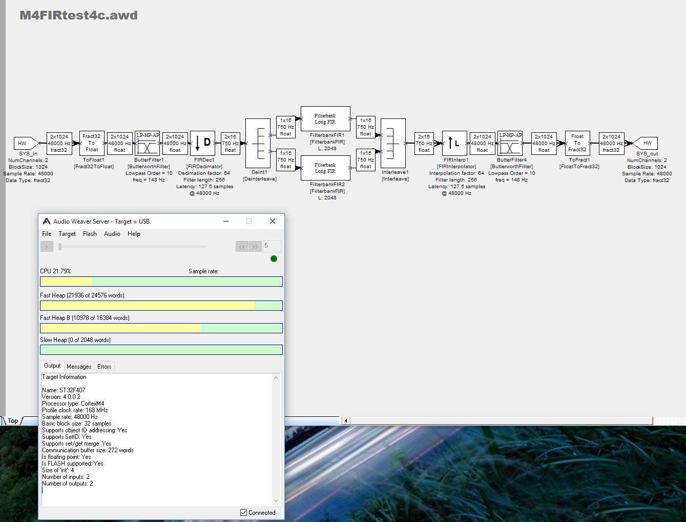

And yet another kind of setback.
How to get audio to play on an ST Cortex-M4 Discovery Board? | DSP Concepts
Only USB in works for Audio weaver. So no standalone operation.
Still possible to prototype and test. But the coding must be done yourself in KEIL or similar to have full control of inputs and outputs. (Think DSP Consepts was involved in KEIL DSP C algorithms).
Another board that is supported but nor so well documented with Audio weaver is the 49$ 32F746GDISCOVERY Discovery kit with STM32F746NG MCU - STMicroelectronics
SPDIF in.
Guess the coding has to be done manually at that board also.
The block size can be changed on input and output HW to 1024.
Then it is possible to decimate with fir 64 times to 750Hz SR.
The filterbank FIRs can then be 2 x 2048.
So 2 cannels with filter LP filter at 148Hz 60dB/oct. Then FIR filters with frequency resolution of 750Hz/2048 = about 0.370Hz.
Now it should be possible to hit the room resonances below 148Hz quite precise.
A full xover and roomcorrection system run on a cheap mini PC and prosessing on that PC (ASIO out to normal soundcard of decent quality) can achive wild filtering performance, but I think it must be a dedicated PC so the price is 10x and up....
  • M4FIRtest4c.zip
    M4FIRtest4c.zip

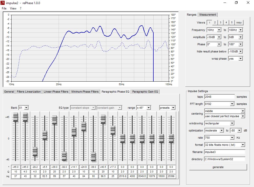

This is like a blog...

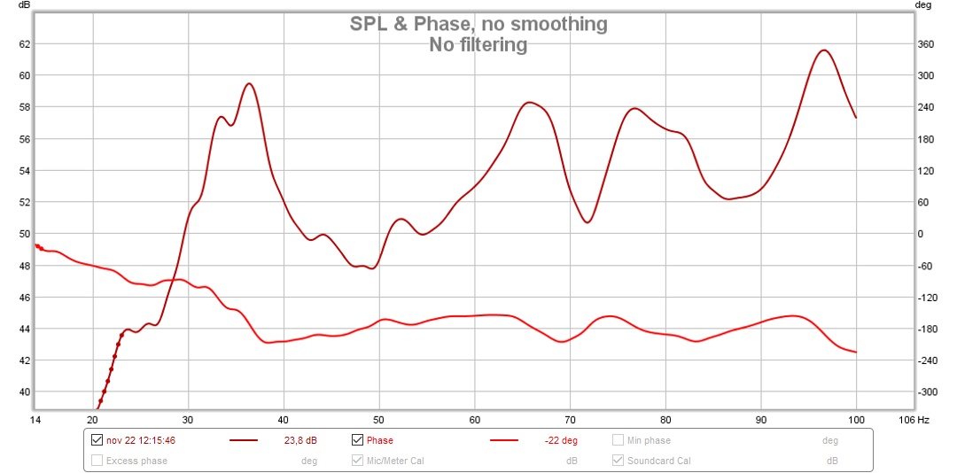

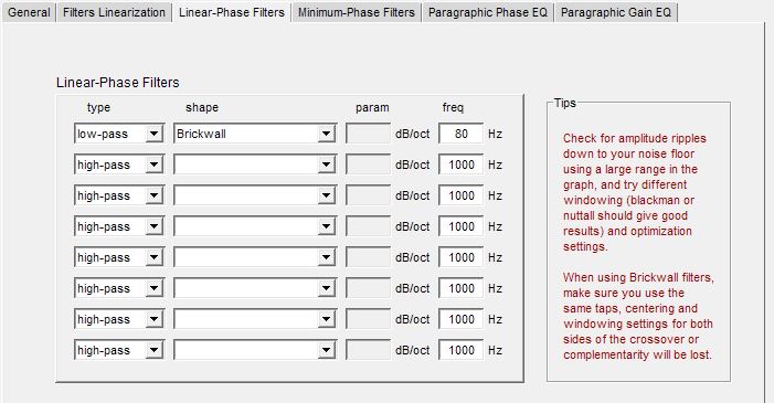

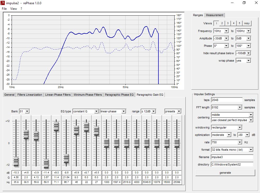

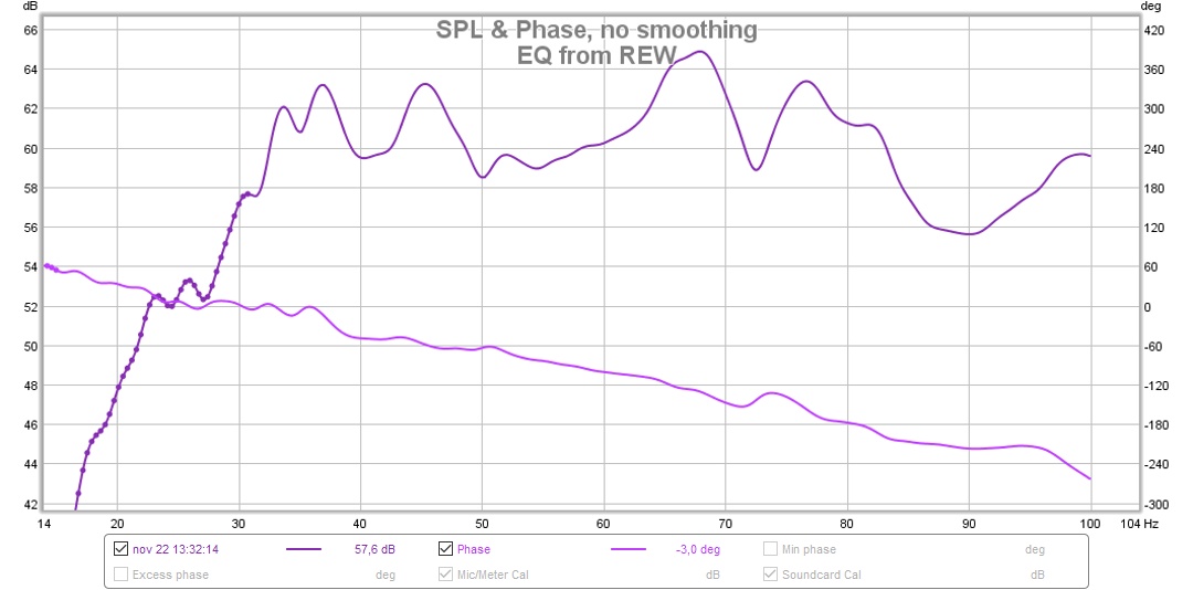

The last audioweaver configuration supports 1024 tap FIR filter at 750Hz.
First try was only to sheck if the mcu could prosess the filter. So filter was 1,0,0,0,0,0,...,0

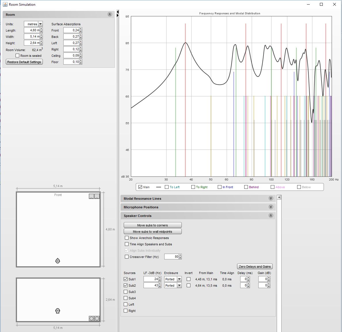

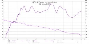

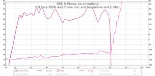

I used REW and RePhase to check if a real world bass eq for phase and EQ was possible. (Seeing is believing).
I got lot of time lag. And the microphone was always in same position.
Note that the divs are at 2 dB! I havent seen more linear bass.

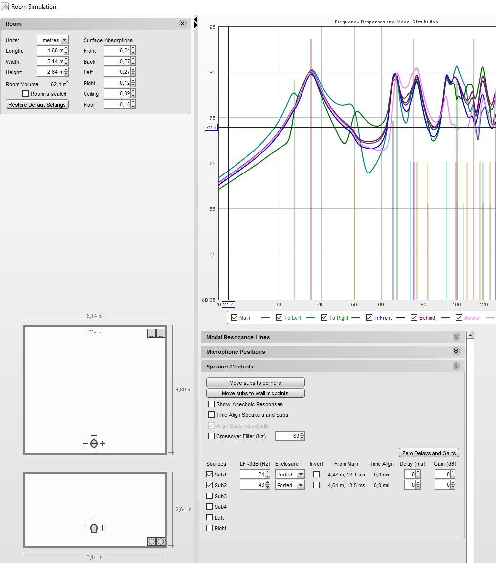

But the simulations show that the ear does not have to move much to have different results...

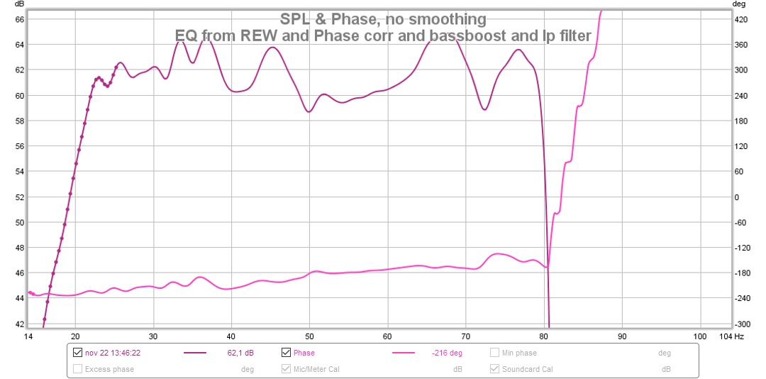

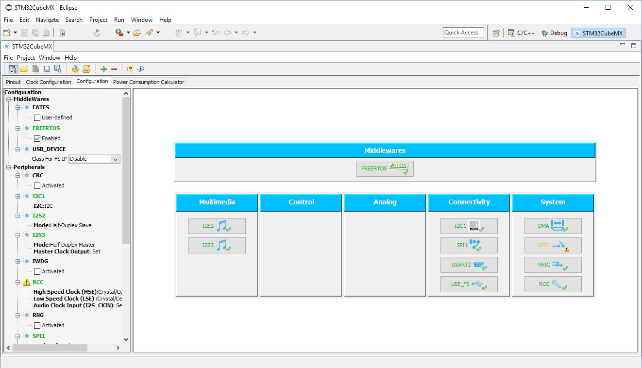

I did have a look at the STM32Cube and the STM32Cube MX software is great for visualizing the hardware posibilities.
A brief nonworking sketch for 96KHz I2S inn and 8kHz I2S to DAC out is enclosed as zipped .ioc file.
(Found no way to make high SF out based on input I2S clock, there might be one that i overlooked. Using internal clock is always possible)
Regards Torgeir

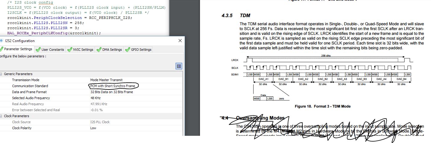

Had a look at multichannel interface.
I'm on thin ice here....
Looking at
http://www.cirrus.com/en/pubs/proDatasheet/CS4385A_F2.pdf
and STM32CubeMX.
I wonder if the TDM (cirrus) and PCM, short frame (STM32F4) is the same.
If that is the case, 8 in/out analog is possible.
Anyone?

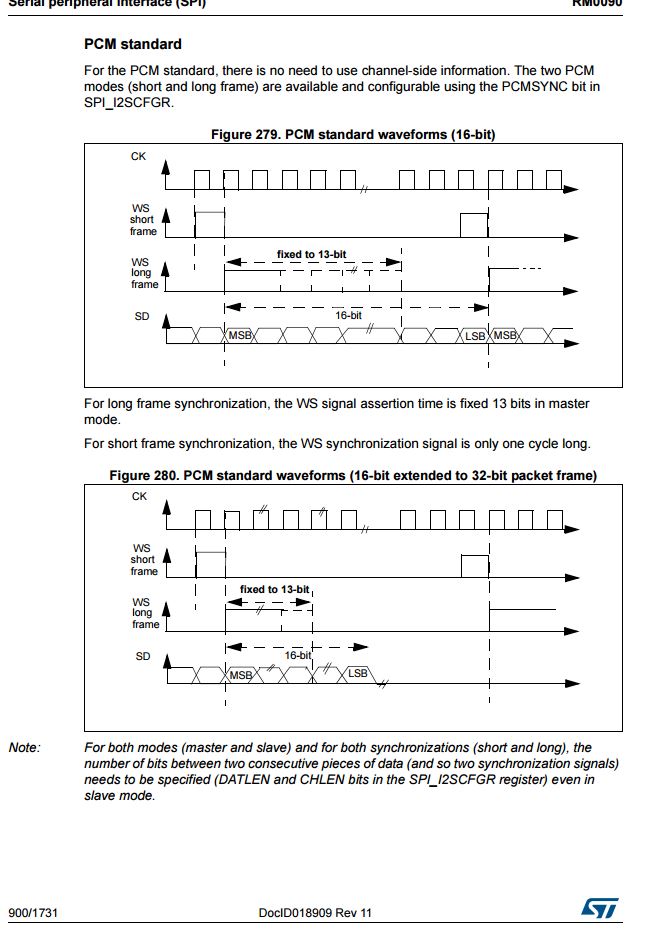

From 2.2.25 Inter-integrated sound (I2S) in
http://www.st.com/st-web-ui/static/active/en/resource/technical/document/datasheet/DM00037051.pdf
" When either or both of
the I2S interfaces is/are configured in master mode, the master clock can be output to the
external DAC/CODEC at 256 times the sampling frequency. "
The STM32F40nnn SAI should support to I16S. See section 29.7 of the reference manual, specifically SAI_xSLOTR; what ST calls the FS signal is more often referred to as LRCK or WCK. IMO the most interesting multichannel configuration is I8S---what Cirrus refers to as OLM---at 32 bits/sample. Mind the packing and unpacking for multirate filter banks, though.
Maybe 32 bit PCM is possible? Else half the bits is wasted and 16-bit extended to 32-bit packet frame has to be used to interface with TDM (cirrus)
ST has not documented 32-bit extended to 32-bit packet frame with figure. But it is possible to set in CubeMX.
28.4.3 Supported audio protocols:
"However there is only one 16-bit register for the
transmission and the reception."
"Four data and packet frames are available. Data may be sent with a format of:
• 16-bit data packed in 16-bit frame
• 16-bit data packed in 32-bit frame
• 24-bit data packed in 32-bit frame
• 32-bit data packed in 32-bit frame"
When using 16-bit data extended on 32-bit packet, the first 16 bits (MSB) are the significant
bits, the 16-bit LSB is forced to 0 without any need for software action or DMA request (only
one read/write operation).
The 24-bit and 32-bit data frames need two CPU read or write operations to/from the
SPI_DR or two DMA operations if the DMA is preferred for the application. For 24-bit data
frame specifically, the 8 nonsignificant bits are extended to 32 bits with 0-bits (by hardware).
For all data formats and communication standards, the most significant bit is always sent
first (MSB first).
