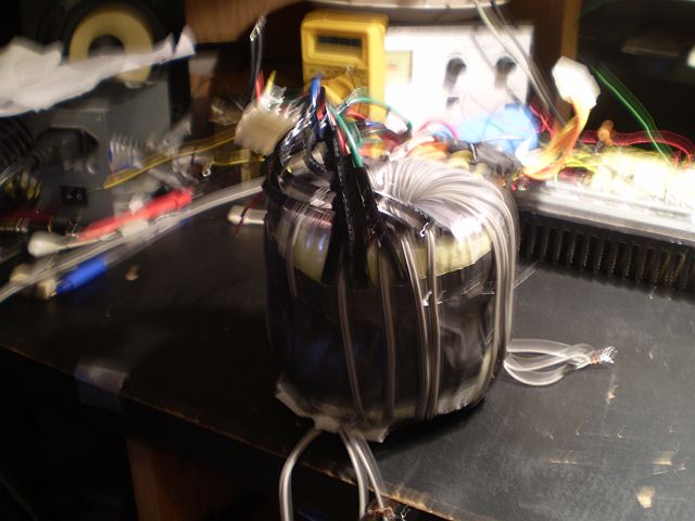

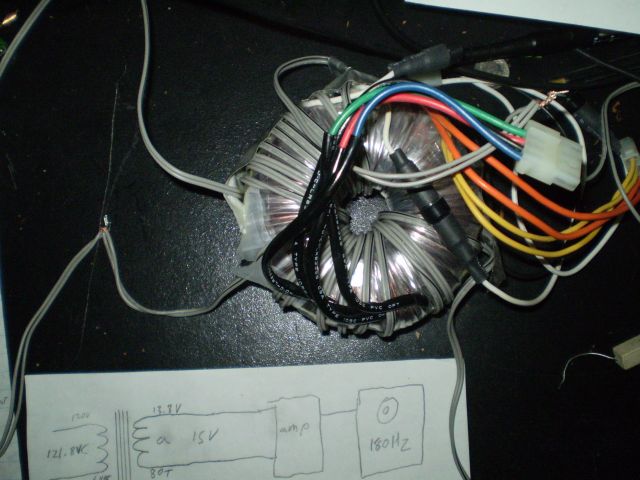

I understand your concern as I have not yet had the time to write the last part of my article.
Today was the first day I had the chance to do some testing and will be doing alot more in the next few days .
I did, however ,try using 5 turns as a primary bringing my ratio up to 1:256 giving me much more efficiancy.
As long as my crosover was high enough, it did not saturate the transformer, however, it also refelcted a 3 ohm load at 20khz with my little panel of 40pf.
This would not be a problem with a larger panel as increased surface area would compensate for this.
My amp didn't like that at full power and would shut down on high peaks.But it worked fine at a nomal listening level with no audiable distortions. my next goal is to build an amp that can supply enough current for such a load.
Most of the research i have done on power toroidal transformers has found that manufactures use crgo steel in most all of them produced today.
Yes,i have found that 20 turns is probaly an optimum choice as far as a crossover of 300hz to 500hz is concerned for my particular core.
But the efficiancy suffers greatly and this would not be an issue if i had 1280 turn 240v windings instead of 120v 640 turn windings. But the idea is to use a stock transformer.
I could easly just rewind the whole thing ,but I dont want to go through all that trouble at moment.
Maybe at a later date I might.
I will see after I build a bigger amp. I'll keep you posted on what I find.
Just a thought I did find a 360v-0-360v toriodal transformer that might be better suited for this idea, but funds are lacking at the moment. jer

I finished my bais supply and tried stacking transformers.
Works great!
I can get fullrange at a low level and down to 200hz with 18 turns (1:77 ratio) and 400hz with 9 turns (1:154 ratio)at full power.heck I have ten of these things tomorrow I'll stack 1 or 2 more.I'm hoping 3 will get me full range at full power (100watts) but 4 will defintely do it.
Also just as I suspected the ratios of the two identical transformers were not the same.
As much as 10% difference was found between the two of them.
Luckiley all of the windings are seperated from each other and could be wired with a balanced eqeal output per stator.
