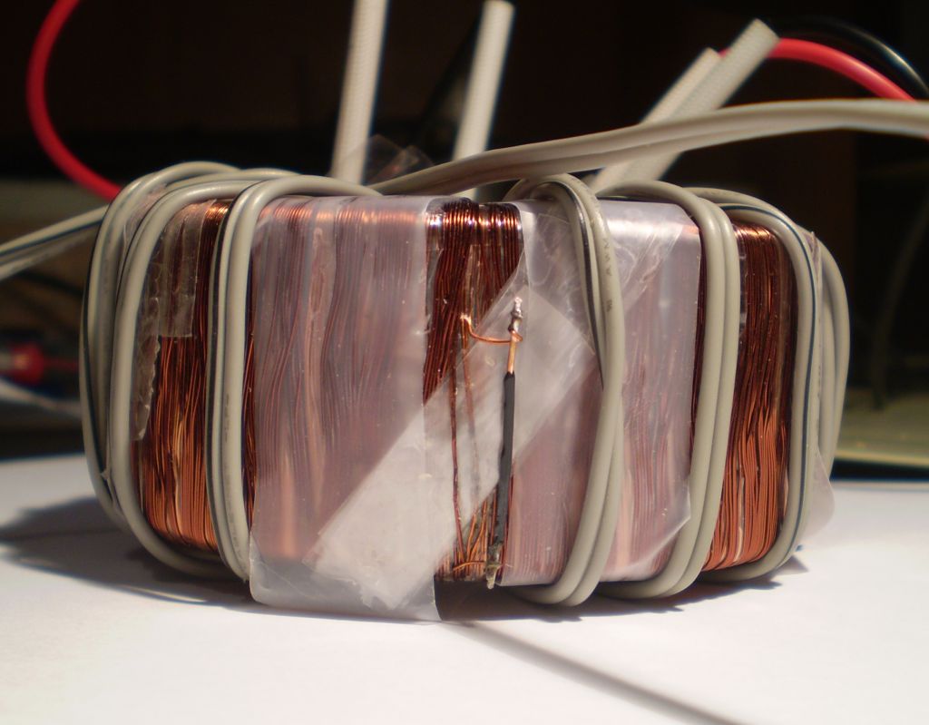

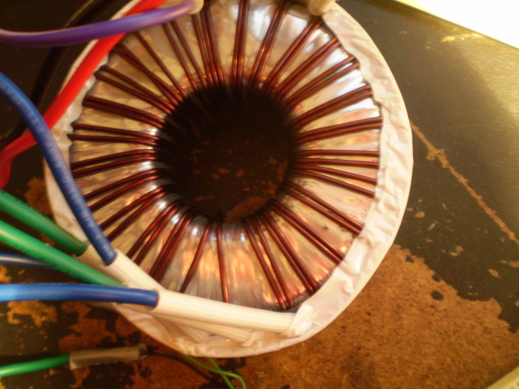

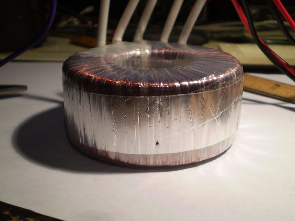

The electrostatic shield can give you some strange results depending on the connection configuration of the winding's as I have found out while testing the Antek AS-1206 using the resonate mode technique for leakage inductance and stray capacitance.
Overall it does add to the total capacitance of the transformer, regardless of what it does to the resonate frequency.

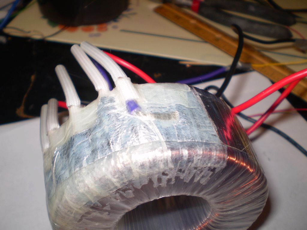

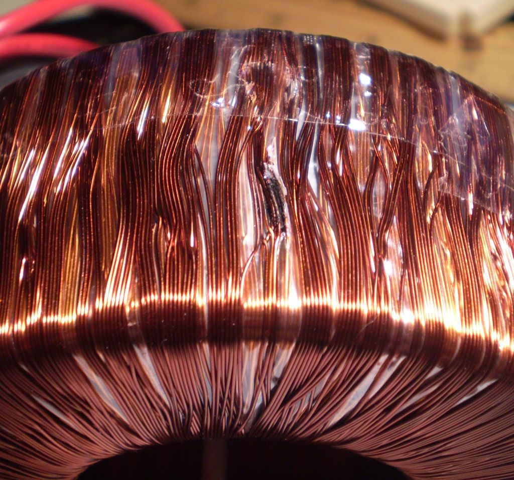

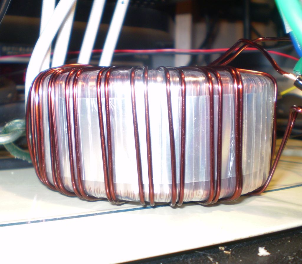

In my situation I ended up shorting one of the 120V winding's during a core saturation stress test and the poor quality/amount of insulating material cause a breakdown failure to the electrostatic shield and burned the winding.
Luckily I was able to strip it down to the burned spot and repair the 7 or 8 damaged winding's and make the core work again.
This is the main reason I have not presented any data in this particular core yet.

You can estimate very closely your capacitance by knowing the total surface area of the winding and the insulation thickness to the core or adjacent winding of concern.
The Antek AS-1206 core that I am working with shows to have about 450pf or so of capacitance when the 120V winding are in parallel and is typically double this when they are in series.
I don't have any exact measurement as I will have to go through my old data to sort them out.
My old data was before I stripped them down.
Right now the capacitance between the two 120V winding is reading 1100pf on my meter this is with each winding having about 520 turns each.
Before I stripped off the electrostatic shielding and 6V winding's this capacitance measured to be about 1300pf between the two 120V winding's.

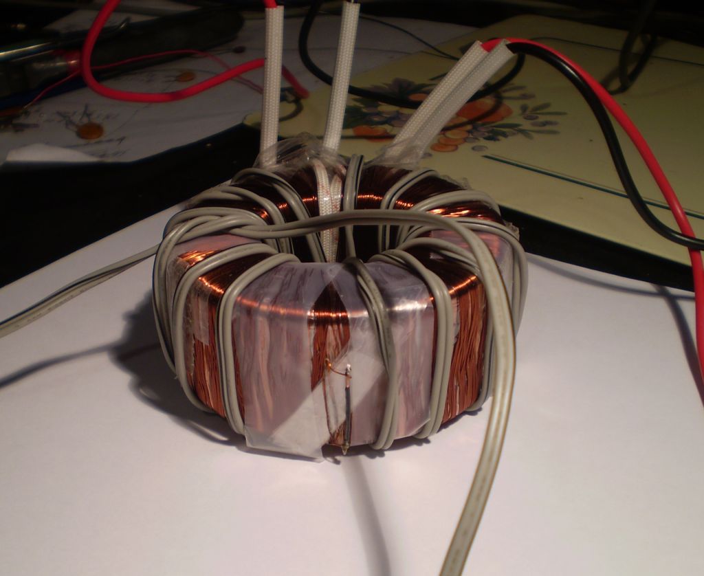

The electrostatic shield was nothing but a 1 inch wide aluminium foil tape around the outside circumference on top of the 120v windings and then the 6V windings were wound on top of that.
It had its own separate connecting wire.
Connecting this wire seemed to add another 150pf to 200pf to the total capacitance of the transformer and this was relavent as it showed up in the impedance tests at 20Khz.
As I had mentioned I did burn this transformer and so it throws off my train of thought for testing and it is now not exactly the same as when I started.
Right now I have duplicated the 26 turn 6V winding with some speaker wire and it show to be about 100pf to the 120v winding's.
This is actually a bit less than what I first measured with the original winding's with the shields in place.
I think closer to half of what it was originally was.
100pf seems high to me for only 26turns but then again it is pvc jacketed speaker wire and is still in zipp form and not separated.
At least it is on the primary side of things.
It is basically 13 bifilar turns in series right now.

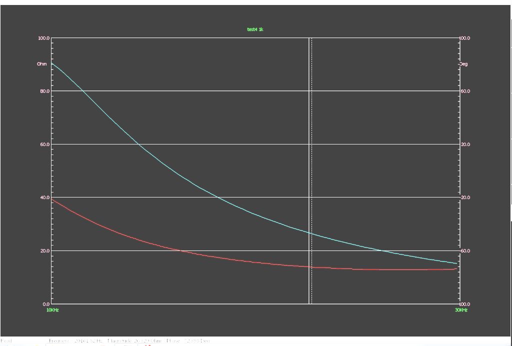

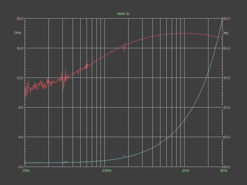

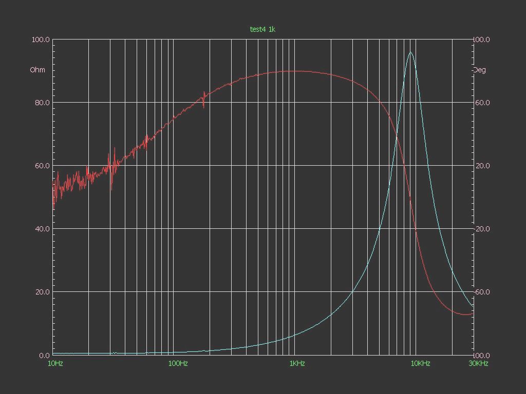

For the record here are the impedance plots for the Antek AS-1206 as it sits right now from the 26 turn winding (6V) and the 120V winding's open and not connected to anything.
The lowest frequency core saturation points are about 300hz to 330hz maximum with a 40Vrms signal applied to the 6V windings.
Some of the graphs for those can be found here but with the windings connected for 12V and some in 6V configurations at different levels -6db apart starting at 20Vrms and 40Vrms,
A TEST JIG FOR FINDING ESL STEP-UP TRANSFORMER PARAMETERS
jer :)

Shield has nothing to do with the "leakage" inductance which is due to coupling between the windings. Shield are to reduce stray (electro)magnetic field emanated by inductor/x_former/etc.
A shields affect on leakage inductance would be indirect.
Its presence does not directly affect leakage inductance but it may affect the distance between the primary and secondary which will change the leakage inductance.
