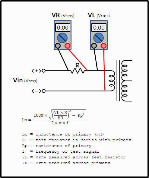

Concerning measurement of primary inductance:
My guess is that your meter is trying to determine inductance at too high a frequency and is getting confused by other parasitics like winding capacitance. You need to have a meter you can set the measurement frequency to something low(< 200 Hz) where the primary inductance dominates the impedance.
Attached below is a simple test setup to calculate primary inductance based on voltage measurement across a series resistor(VR) and across the primary(VL). I'd recommend input voltage of 1Vrms @ 60Hz using series resistor R = 10 ohm.
