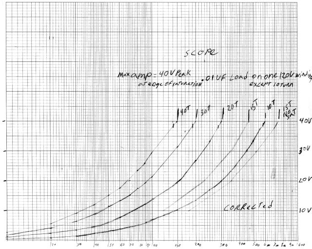

the larger the core ,the lower the saturation frequency for a given voltage 👍 for amount of turns (x)
this is the chart of the 200va transformer I used.
I am currently using two cores, each with 10 turn primarys in parallel and with the four 120v windings (2per core) in series this gives me a 1:240 ratio total.
With a 10 turn primary saturation starts at 600hz with a 100 watt signal (40v peak,80v peak to peak or 28Vrms into 8ohms)
If I were to use a 20 turn primary instead then my saturation frequency wil be 300hz or f/2 for the same voltage,but this also drops my ratio to 1:120 total for the two cores.
Also by droping the voltage by half (v/2) drops the saturation frequency by half(Fsat/2).
I have found that a 15 turn winding is a good compromise but I am using 10 right now and have even used a 5 turn winding to get even more efficiancy (1:480 ratio) on my small panel.

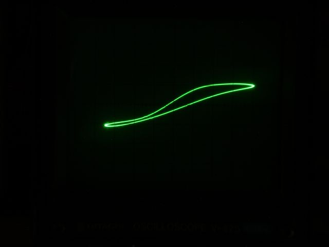

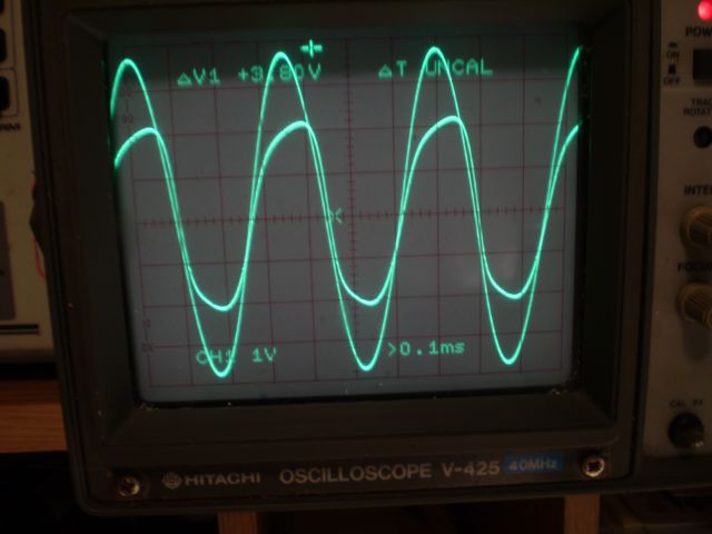

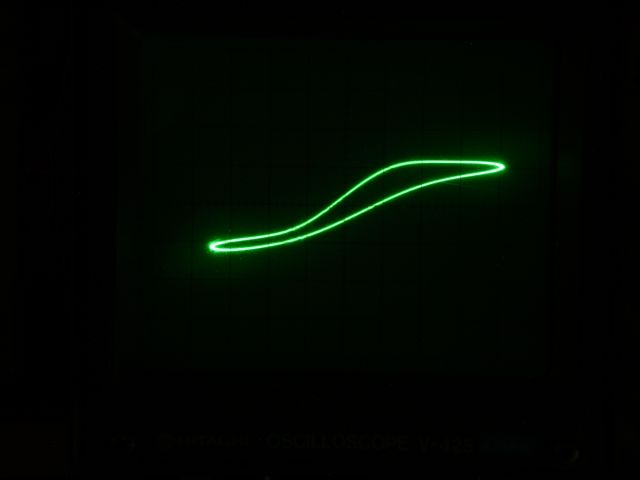

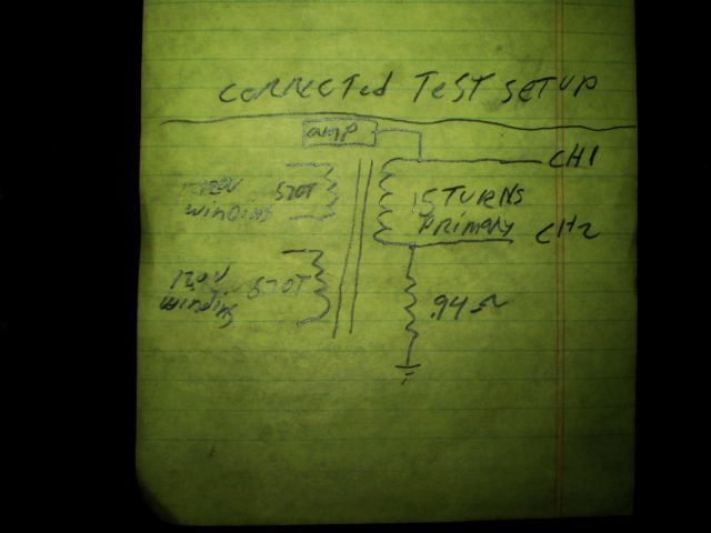

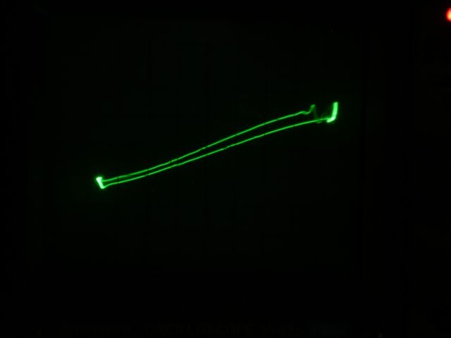

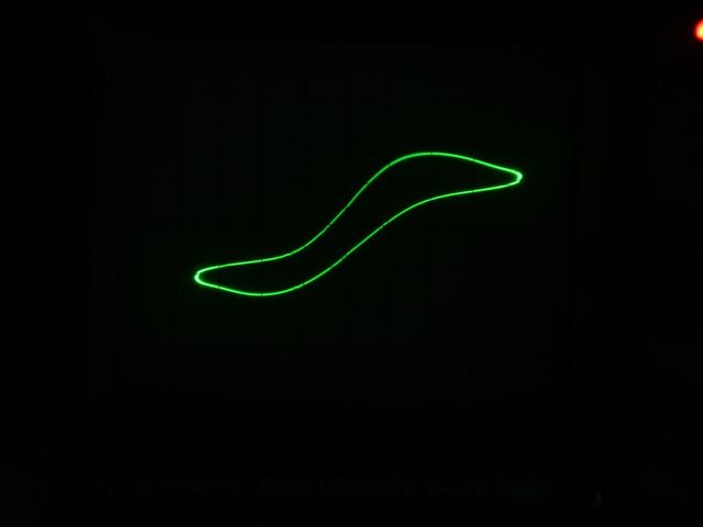

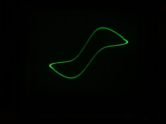

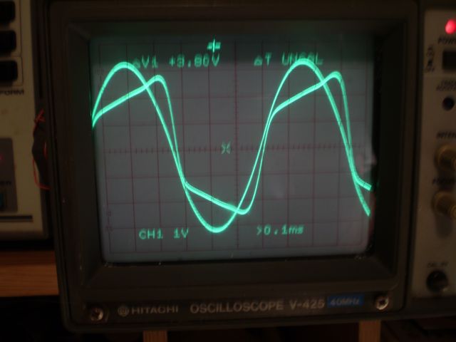

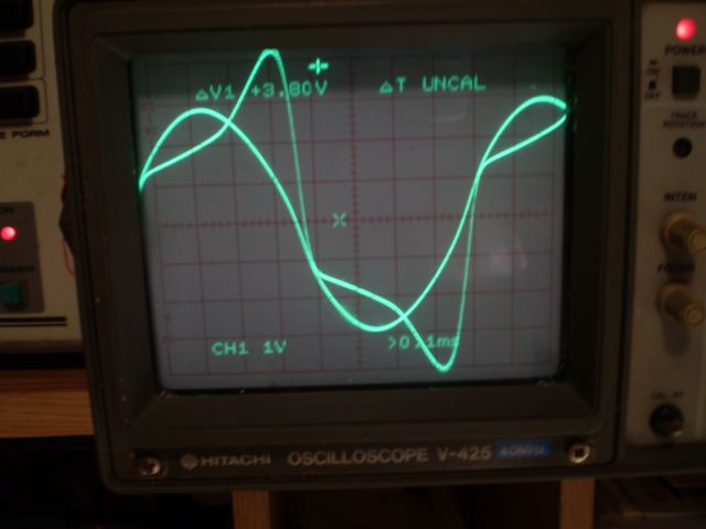

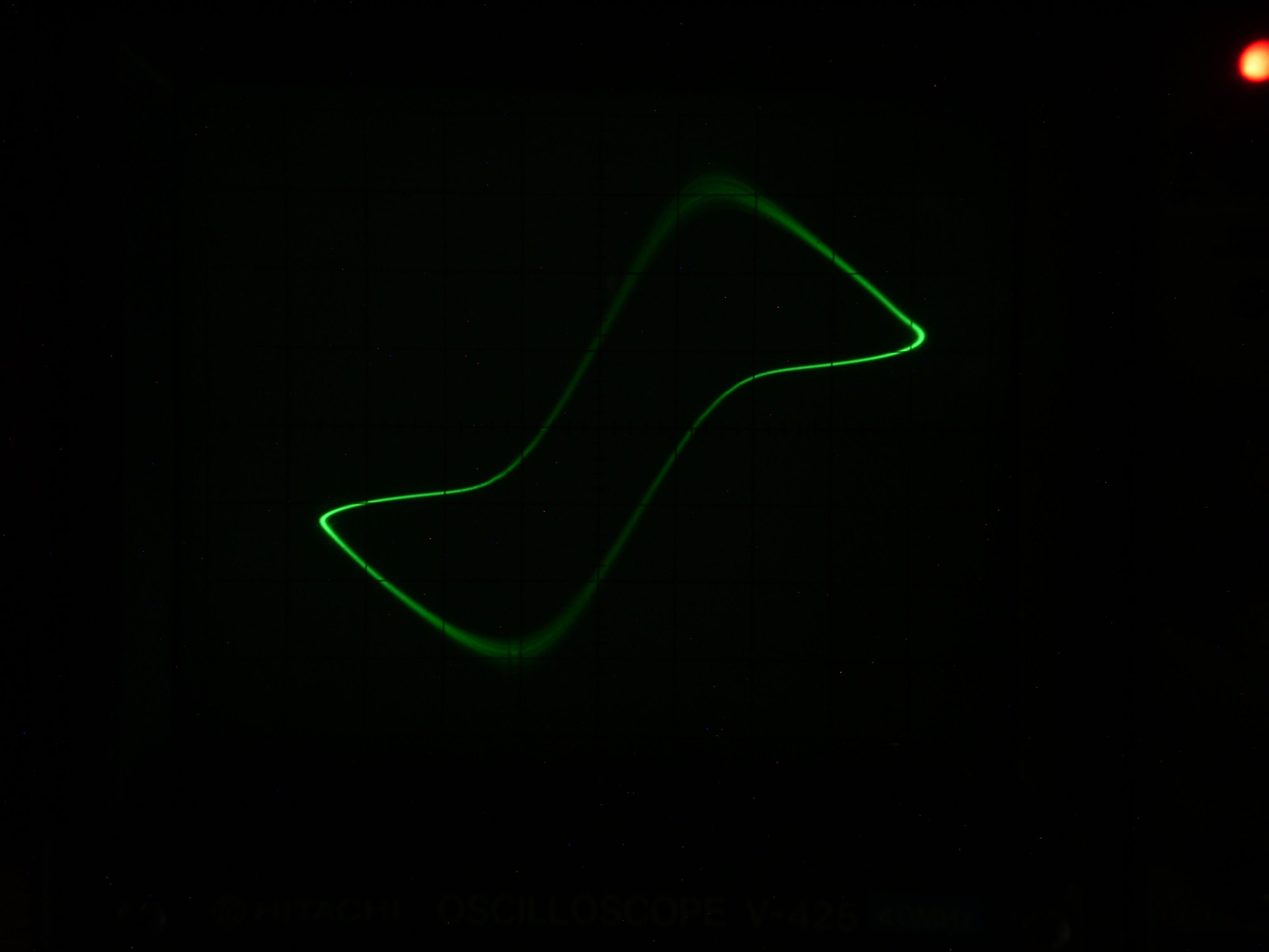

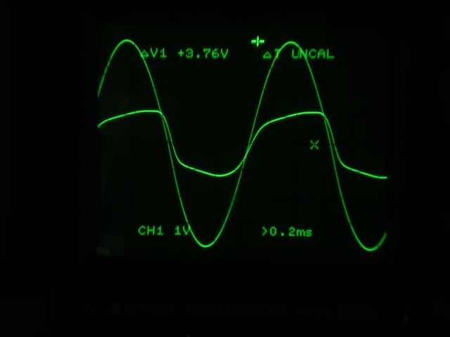

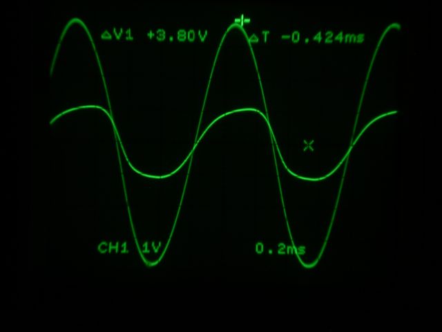

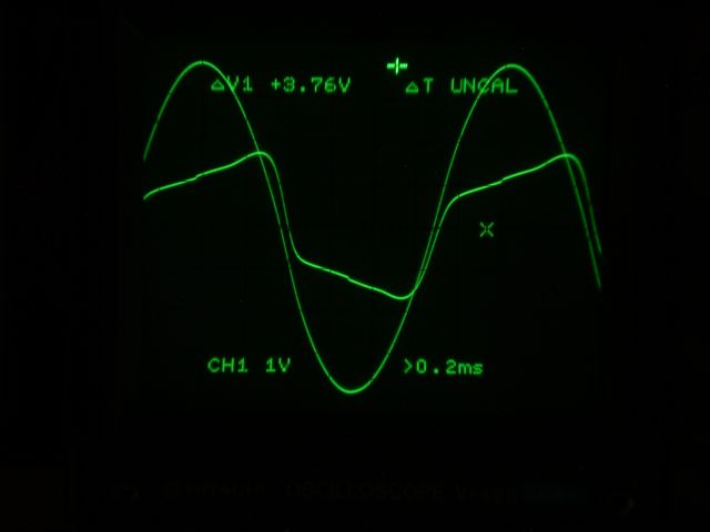

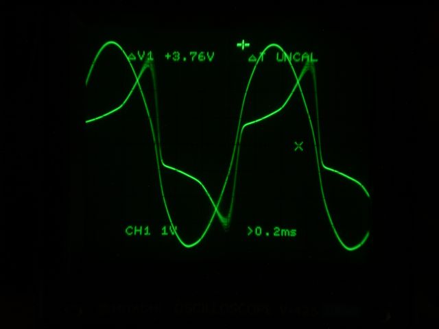

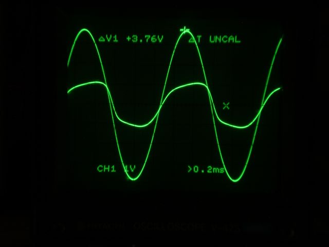

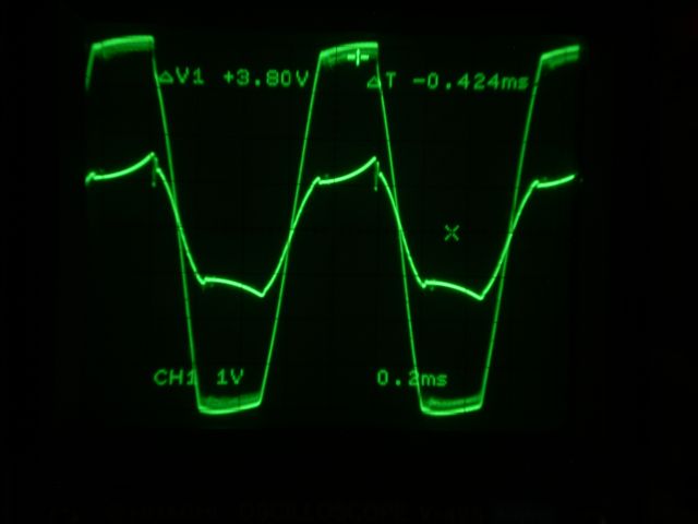

Here is some of the data that I have promised to post using the power toroidal transformers.
I have found using Jelanier's excel program using resonate frequency's, that my leakage inductance is quite high at 65 millihenrys and was much more than I had expected.
In the next series of test I will show the results of how to reduce this effect as much as possible and I will try to show some simulations with circuit maker2000 as well.
So I will try to keep this as simple and scientific as I can.
So bear with me.
Using Jim’s format I have found the capacitance of the transformer to be around 400pf to 450 pf with a 31khz resonance, which seems kind of high but actually better (I have found) than the commercial product depicted in Jims example.
This much capacitance (compared to the 70pf of my little panel) represents a load as low as a .5 ohm at 20khz with a 1:200 transformation ratio and not the 8 ohms I was expecting
This becomes a waste of power.
Which was causing all the havoc along with the low resonate frequency!
Especially at 31 kHz and 20 kHz.
Anyway, here is some data that shows the effect of frequency vs. saturation level of the core I am using.
With the same voltage level for all of the tests.
The large waveform is the input to the primary at 10v per division and the little waveform shows the current in primary at approximately 1 amp per division (volts measured across two .47ohm resistors in series).
I used a 15-turn primary in these tests this gives me a 1:38 transformation ratio for each 120v windings of 570 turns each.
I have added two curves to the original saturation graph chart.
One shows the complete saturation curve (very distorted).
And the other shows at the edge of saturation curve (undistorted).
This shows the kind of range there is to work with.
At a later date I will measure the amount of distortions that are introduced in this range as right now we are focusing on the charticteristics the transformer itself. jer
So bear with me.
And here are the acutal frequency vs saturation pics starting at 700hz then 600hz,500hz,450hz and unstable at 440hz just before the amp overloaded and shutdown.
Sorry that some are a bit dark as I forgot to adust them up when I edited them.jer
Thanks steve for the PM.
As there is a slight error in the test data picrure.
The schematic is correct but the values are not.
It was for a similar test using the original 570 turn windings to find the saturation frequncy of those windings ,which was quite low I might add.
Here is a picture of the corrected test setup. jer
"It was for a similar test using the original 570 turn windings to find the saturation frequency of those windings ,which was quite low I might add"
Yes, this frequency must be 0.026 (15/570) times lower than the 15 turns saturation frequency!
Can it be that that the magnetic area of your transformer is around 7 square
centimeters? I looked at your nice saturation diagram and used the formula:
Iron Area(cmxcm) = Volt peak-peak/ 0.001 xTurns x Frequency
I wonder why you have a .94 ohm resistor in series with the prim turns, as it increases the saturation frequency over the windings.
A modern amplifier with low output impedance can control the wave shape and thereby distortion caused by saturation to a certain degree,
which it can't if theres is a resistor in the path.
Your estimate of core area is probably pretty close. It all depends on the value of Bmax for his core. I think your formula assumes Bmax of about 10,000 gauss.
The 0.94 ohm resistor in series with the primary was there so he could monitor the current thru the primary to see when the core starts to saturate. In practice, most ESL setups use 1 to 2 ohm resistor in series with the primary to damp the HF resonance of leakage inductance and winding + ESL capacitance.
You are correct though, with a low impedance amplifier, no series resistor, and low resistance primary winding, the voltage induced in the secondary winding follows closely the voltage output of the amplifier even though the primary current is very distorted. This is one of the drawbacks to adding the series damping resistance on the primary side of the transformer, it increases distortion due to primary current not following primary voltage. I usually put some of the damping resistance on the secondary side of the transformer to minimize the amount of resistance put in series with the primary. For full range ESL, it is good practice to leave at least some resistance in series with the primary to protect the amplifier from core saturation. For hybrids, it is not as much of a concern.
You are correct Steve about the resistor In the circuit and your explaination just saved me a whole lot of typing ,thanks.
Jonas,you are also correct as well.
Being as that I am using roughly 1/4 the drive voltage of that of the line voltage that the transformer was designed for ,my saturation frequency starts at around 15hz to 20 hz for a 80v peak to peak signal with that winding.
Acurate measuring at that low of a frequency proves to be a bit difficult with my audio system at the moment.
Everything is run through my mixing board and even though it can do sub 20hz to 100khz okay,the amp won't.
Even with the signal generator connected directly to it.
However the transformer does pickup up the signal off of my 27mhz wireless mouse from about 6" to 12" away.
I have only been able to test to 1mhz due to the limitation of the generator itself.
Pretty neat?
Also to mention that it is very hard to see on a scope with a very fast phosphorus that has a terrible trigger section.
The amp is all I have at the moment to get that kind of voltage swing needed for these tests.
In my preliminary spice simiulations only .2 ohms is required to tame that resonate peak at 30 khz,About that of the primary winding itself.
Anything over .47 ohms I did not like and had noticed a drop as much as at least 6db to start with.
This I believe is due to the high residual transformer capcitance and the high transformation ratio that I have been using.
As .5ohm impedance with a .5 ohm resistor in series yields half of the voltage I started with.
Now,little did I realize how important leakage inductance means.
This is what I am about to demonstrat, as the only inductance's of concern are that of the primary inductance to determine the lowest frequency and the leakage indcutance in conjunction with the transformer capacitance determines the highest frequency it can pass.
And in order to keep that capacitance low is to have a smaller winding on the secondary, and in order to do this is to have a smaller winding on the primary ,and in order to do this one must have a very large core.
To try to give some insight to Paul's question I have found in order to ,at least ,or better than match the efficiantcy of my little sony speakers at 87db at 1 meter,it takes 2 or 3 little panels (about 40 to 60 sq. inches each) with a d/s spacing .050" to .065" and a 1:200 transformation ratio.
This I will confirm at a later date in a new series of study's.
Sorry it has taken so long to get some info going.
I took a long needed break to hash out everything I have learned in such a short period of time ,and I am making sure that my data is consistent before I post anything.
So stick with me here as there is alot of info to cover and hopefully it will help take some of the mystery out of the transformer question for those who don't or didn't understand it compleatley as the same as I didn't ,until now .jer
