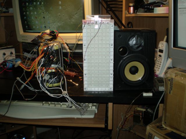

here is my quadstacked toroidal core setup with 10 turn primary.160:1 to 130:1 (gets lower as the voltage goes up?) does 60v p-p at 250hz.
Next I will conenct all of the unused windings to up the ratio some more and add a few more primary's to reduce the leakage inductance.
it does 4v p-p at 20hz,8v p-p at 30hz,12v p-p at 40hz and 16v p-p at 50hz and so on until 60v p-p ay 300hz and max 400hz to 500hz or so.10kv p-p?ah, no problem.
stay tuned . jer

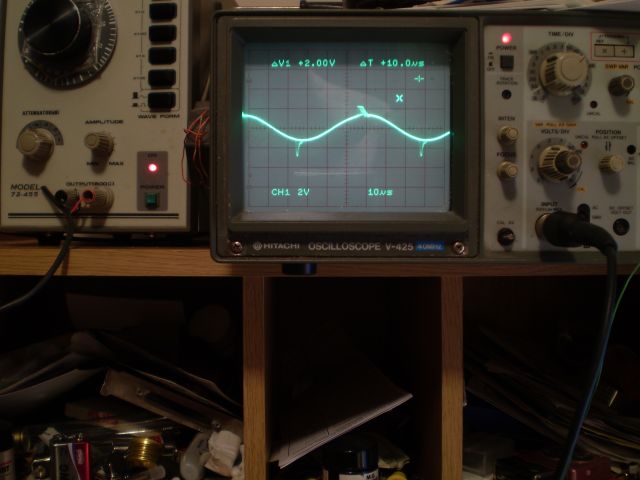

Did some testing and tweaking today. Finely got to push the amp into clipping without shutting down by wiring the transformers in a different order 1,4,3,2.I didn't document the original order.
But it solved a problem.
I was getting a tiny tiny sharp spike near the peak of the top and bottom of the sine wave and by shorting an unused winding the spike would get bigger.
So now I'm thinking, great, i have shorted winding( which I might).I won't know for sure until I test each individual transformer seperately.
I also then spilt my primary into two 5 turn sections.
Using one 5 turn winding I adusted the setup for the pulse and by adding the other 5 turn winding in parallel with the first one.
The pulse got smaller.
So I'm hoping that this isjust leakage inductance and could be solved by adding more primary windings.
Or is it core saturation?
Any opinions please !

please be more exact. Is the waveform of a current or voltage?
Primary or secondary?
What probe do you use?
Saturation could be easily determined by observing the primary current, at low frequencies. Put small value resistor in series with primary. Observe the voltage across the resistor - at saturation you will see peaks or sharp rising of primary current.
@ 20 kHz it is least likely the saturation
By the picture I can see that spikes do not occur at each period of sinewave but once in a while (spontaneously). Try to adjust triggering to see if that's the case. Try increase the sweep time - more cycles on screen.
Try the following:
1. Lower the voltage and see if the peaks disappear.
Then it is definitely the breakdown, not necessarily in the trafo
2.Lower the frequency without changing the voltage.
If peaks stay - it's most likely the amplifiers instability caused either by the nature of load or, being near saturation - feedback disappears at clipping.
Solutions
1. I would try putting resistor of 1-2 Ohm in series in primary.
2. Please be aware that HF components (10-20 kHz) in real signal are of small amplitude - do not try to apply full power at frequencly higher than 2-3 kHz.
3. Turn the lights off, adapt to darkness and look for discharge glow.
Hope this help.
Alex

1. yes, lowering the voltage makes them disappear.
2. lowering the frquency only moves the spikes back down the slope and are consistant with every cycle(i'll take some pictures later).
1.tried a 1 ohm resistor in series with the primary and shorting it made no differnce on the size or shape of the pulse.
2.these pulse's are what is triggering the the over load circuitery on high music peaks at a low level.
The first time before I had managed to reduce them (as they were much worse than this) I couldn't get much more than 10v p-p average (2 to 3 watts) now i'm getting more and able to get into clipping which i could not before.
3.there is no corona glow anywhere.
only three things made a diffirence.
1. changing the order of the windings made it less.
2.paralleling another primary winding made it less,even though it was cut down to 5 turns instead of 10 turns,this shouldn't have any effect above say 5khz.
3. i didn't mention before is by seperating the windings at the piont were my centertap is created greatly reduces the effect also.
The amp is capable of nearly 80v p-p and did so without problem during the saturation tests.
These test are being done with out a load and also showed no diffirence with the 40pf to 70pf speaker and bias supply connected.
The scope measurements are done with a phillips PR200A probe set on x10 at the primary (20v per div).
as per solution #3 i was able to get a much higher level of 35v to 37v peak (close to the limit but no clipping) before shutdown ocurred.
I sort of thinking a high leakage inductance as per solution #2 and/or #3 was the most noticeable.
I too am questioning the amp but it doesn't happen with square or sine wave at any particular frequency just more dominant at the higher ones.
i have an old brute force sunn concert slave amp that I'm ready to dig out and see if it makes a diffirence.
but first I am going to get some more wire and make some more primary's first.
some how I'm not convinced it is the amp by analyzing the waveform I see. jer

Are the peaks present in the primary current?
1. Observe the voltage across the series resistor. Proper way of doing it is to put resistor between amplifier groung(common) and return wire from the primary - this way you could measure the current and voltage simultaneously (in case of dual channel scope). Please be aware that the scope ground can be tied to the PE wire on the power grid.
2. As I understood you have few trafos on hand. Try another one.
3. What is the secondary voltage when the spikes start to appear?
4. What is the bandwidth of your scope?
Alex

I think you are seeing crossover distortion. Crossover distortion happens when the current is zero. For a resistive load, this is at zero volts out. For a purely capacitive load, zero current happens at the peaks of the waveform. Sliding down the waveform would indicate the changing phase angle of the load - or something between a pure capacitor and resistor.
Thank you,damageG, that is along the lines of what i'm thinking.
At the moment I keep getting interupted so I am struggling to keep my train of thought and I will get lots of pics under certain conditions to show you.

I'm pretty positive though I have a very high leakage inductance with only 10 turns of small gauge speaker wire as the primary wrapped around the four large cores giving me only 10% total coverage tops and ,yes, they are evenly spaced.
Could this be the the reactive component that is giving me problems?
The scope is a 40mhz hitachi V-425 and I have been able to display wave forms as high as 80mhz to 200mhz but not very willingly. jer
This amp is not a big heavy duty one so whatever the reactive compont that is causing this ,it can not supply enough current to over come it.
In my theory antway.

Jerry,
Leakage inductance itself is not a problem, but in combination with the capacitive load from the winding capacitance, it forms a series resonant circuit that will drop the impedance to VERY low values(easily 0.5 ohm or less) at high frequencies. I measured the winding capacitance for a few larger toroidal power transformers I have laying around at about 1500pF. That might explain why you aren't noticing much difference when you add your 80pF ESL load. Have you measured the impedance vs frequency for your transformer setup yet to see what the minimum impedance is and at what frequency?
As Alex mentioned, measuring the voltage across a current sensing resistor put in series with the ground wire from you amplifier will help you figure out what it is going on. You mention your amplifier is not particularly heavy duty, so the voltage spikes you see might be it's way of protesting against the low impedance load. Try a larger value of series resistor like 4 ohm to see if this helps out. This will roll off the top octave response a bit, but will give you an idea if it is the low impedance load(combined with high phase angle) that is causing a problem for your amplifier.
Concerning one of your other observations: You said...
"I also then split my primary into two 5 turn sections.
Using one 5 turn winding I adusted the setup for the pulse and by adding the other 5 turn winding in parallel with the first one. The pulse got smaller."
Once you added the 2nd set of 5 turns in parallel and reduced the leakage inductance, the resonant frequency for minimum impedance would have moved up in frequency. With the 2nd set of 5 turns added, try increasing the frequency to see if the spike level increases.

yes,with both primary's connected at 30khz i adjusted for a very small spike.
it disappears as i move up to 40khz and then reappears when I disconnect one of the windings.
also i have tried larger value resistors but that greatly reduces my output to the speaker. jer
I don't have a capacitance meter yet and sure i wish i had one right now!
As I was testing above 20khz was fighting to achieve a flat response with my mixer even though it will pass 100khz with no problem.
so i decided to eliminate it from the signal path.
the amp doesn't go into shutdown any more and i am able to push it into clipping with no problem.
the pulse is still there but not as bad now without the mixer .
the pulse resonance seems to be around 50 khz,just as the amp hits it's rail it goes into parasatic oscillation and starts to draw alot of current and then shuts down.

But with a larger resistor, like 4 ohm, does the spike still appear?
If you haven't already done this, why don't you get an estimate of your impedance vs frequency at the top of the audio band. You can do this be measuring the voltage across the series resistor and the primary at various frequencies. I usually use a 10 ohm resistor, but anything from 4 ohm to 30 ohm will work fine. start at 1kHz and work your way upward. Measure the voltage across the series resistor, and then across the transformer primary. The transformer impedance at that frequency can then be estimated by:
Z = R x VT / VR
R = value of series resistor
VT = voltage measured across transformer primary
VR = voltage measured across series resistor
As you work your way upward from 1kHz, you will probably see your impedance steadily falling till you reach a minimum (at resonance between leakage inductance and winding capacitance) and then rising again after than.
With a 10 turn primary the toroidal power transformer I have reached a minimum impedance of 0.38 ohm at 16kHz.
That's a tough load for any amplifier.

spike seems to be voltage dependent - so I assume the worst case - partial or barrier discharge due to insulation not designed for high voltages. No answer on what voltage it begins... If it moves to the beginning of the cycle as frequency goes down - you need a certain volt-second product to accumulate the charge on insulation layer then it breaks down.
As others suggested it well might be crossover due to the inductive impedance, again you need certain volt second product to recoup the energy in the load to the power supply.
The latter, however, shall be present at any frequency and voltage level, apmlitude should vary.
Can you load your transformer at the secondary? It looks hard to do, but it is not - put about 20 2W resistors in series with total resistance around 100k to 300k and burden the secondary. Impedance, reflected to the primary should become mode dumped out or resistor like and see how it goes.
Once again, can you swap transformers?
Alex
sorry, i didn't get back to you as was trying every possible combination with the windings I could and had a few issues along the way.
the pulse could be crossover switching and causing some rf.
I fried a cuple of meters and two 470 ohm resistors that were in series and a 120v winding on each end forming the center tap in the middle and nothing connect to the other end of the windings.
first the resistors and then the meters then I knew it was rf!
I did start with a new transformer and it does the exact same thing.
then I got two of them and made sure they were identical and not mismatched.
Taped them up and wound 10 turns on them.
here's what i found:
transformer A ,120v (1),120v(2)
transformer B ,120v (1),120v(2)
center tap point ,ct
A(1)+CT+A(2) problem
B(1)+CT+B(2) problem
A(1OR2)+CT+B(1 OR2) no problem at 20 khz
A(1)+B(1)+ct+A(2)+B(2) problem swap (1) for (2) same
only when two windings from the same transformer are connected together does the problem occur.
with all of the windings left open resonance is 50khz.
Then I tried connecting all the windings on each in series with each other this loads the amp down severly 20khz and up with dullpeak at 32.5 khz
Try to connect for a center tap and it draws and maintains an rf type arc with 20v p-p input with nothing connected to the other ends.
it is left unconnected at this point.
the pulse starts to come in at 3khz at 80v p-p and does not change position until a resonate peak of 22.5khz at which point it is positioned at the peak of the sine wave.
tommorrow i will plot the impedence curves to look at. jer
