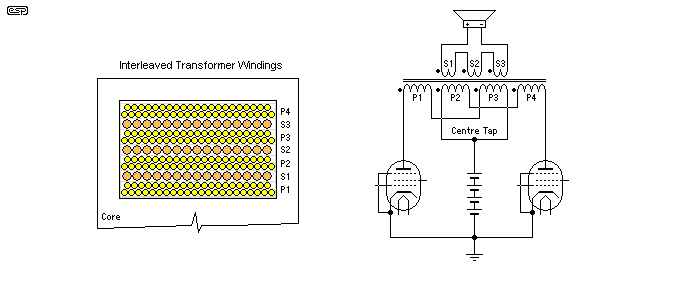

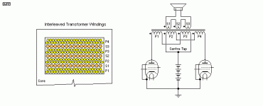

i found this on the esp website it might give you an idea.i found it google'ing.there is one particular article i'm looking for and if i find it i'll pst it for you. jer

Hi, is there anyone that have a description/suggestion/opinion on how windings should be interleaved?
Primary2
Secondary
Primary
Core
Primary
Secondary
Primary2
With the primaries in secondary seems to be the easiest approach.
Regards
Bent
As kavermei mentioned earlier in this thread, the amount of interleaving depends on what your design goals are for your transformer.
To determine how much and what type of interleaving is needed you need to define what you want your transformer to do.
1) What is the core area? ( i think you may already have chosen a core)
2) How low do you need the transformer to operate? is this for full range use? or hybrid?
3) What is the maximum expecting input voltage?
These 3 items will determine the required number of primary turns.
4) What step up ratio are you wanting? (this defines number of secondary turns)
5) What is the capacitance of your panels? and are your panels segmented or not? This will help define the allowable leakage inductance before you start affecting your high frequency response.
6) Do you plan to use 1 transformer to drive both stators? or two transformer with secondaries in series, primaries in parallel. This can change to way you do interleaving to minimize interwinding capacitance.
As Calvin has mentioned many times on the forum, sticking with hybrid designs and lower step-up ratios, the transformer design becomes much easier.
You may not even need any interleaving at all.

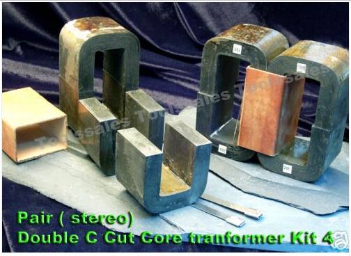

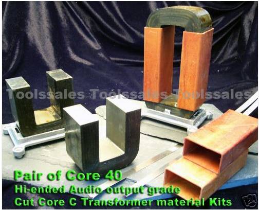

Todays shopping..
I ordered one off the smallest u-cores...and a automatic coil-winding machine as well! (Stops at preset turns count)
I just wonder how I can smuggle this into the house without my girlfriend finding out!
Bent

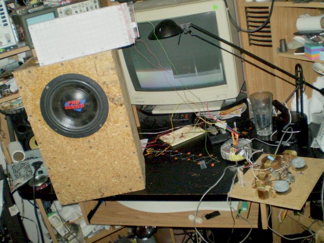

thanks wachara.right now i cobbled from an old marantz crossover that said the woofer was at 700hz ,it a 4 ohm driver so it is cutting off about 1.7khz, and i have 25 uf capacitor in series with a 10 turn primary.it starts coming in at about 450 hz on the esl.
It is a bit low for a 10 turn winding and the amp doesn't like it on some peaks and shuts down.however it gets comfortably loud at full volume.
my db meter is not working at the moment,but im sure it is around 100db or so at 4' to 6' at full volume.enough to make it difficult to carry on a conversation acroos the room at 10 feet and thats just one esl and woofer at the moment.
i'll do some tweaking tomorrow as it took an 11 ohm resistor to pad the woofer down so that they where close but still not quite the same volume.but you sure could tell a big difference when the esl wasn't playing.
i have a pretty good ear when it comes to flatness and with no eq they were as flat as my little sony ss-mb150h's that i have been using except for the extended bass that 8" sub puts out.
in one word "wow" the clarity was night and day. I listened to all types of material on you tube and as you know some of it is terrible and with so much detail alot was not worth listen too.
I now have them each on there own amp and will do some more tweaking tomorrow. jer
Hi Jer,
That's pretty loud. At the loudness, I guess your amp must be clipping a bit.
I've just bought a 300 watts Class D amp to try with my ESL. I hope that I've come to an end for searching the right amp. All I know is that ESL really can suck up a lot of amp power.
Wachara C.
the amp usely shuts down when it clips or overloads from the transformer saturating or a very low impedence.It will tolerate 6 ohms but hates 4 ohms.so i never actualy heard any clipping.
my next project will be a better amp. i have five lm4780'S (dual lm 3886)and doing a parallel configuration of maybe 4 per side to deal with the low impedence to get by with for right now,and in the future maybe a lm49811 running a full 200v to get a real voltage swing to compensate a lower transformer ratio as a 30 turn primary gives me a more manageble impedence range.
Right now with a 10 turn primary i have 1:128 ratio and anything less like a 30 or 40 turn primary( 1:32,1:41) greatly suffers in loudness, even though i can go with a lower crossover(which i prefer).
20 turns is quite manageable with this amp,but 6 db less is still 6db less, as it only produces a 37v to 40v signal.
Parallel chip amps should be able to supply the current and posibly a bridge parallel configuration with 8 to 12 lm3886's.
An 80v peak signal would probably suffice with a bigger core to handle the power.
Comperimizes,Comperimizes! jer
